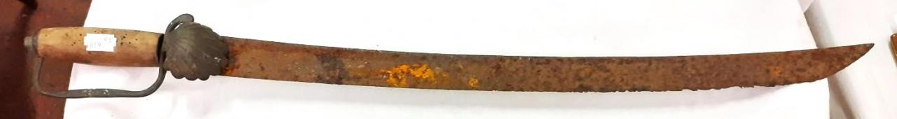

With the ANXI hilts, it seems they formed the basis for hilts produced in Spain in the 1820s seen in colonial settings, so it seems possible that at some point Spanish cutlers might have produced direct copies of them.
This colonial Spanish hilt 'reflects' the style of multi branch hilt which may have some connection (?)
The second example (right) also a Spanish/Mexican hilt of same period but of course brass and again resemblance. It is unclear whether these hilts were produced in Spain or Mexico, but more likely Spain.
