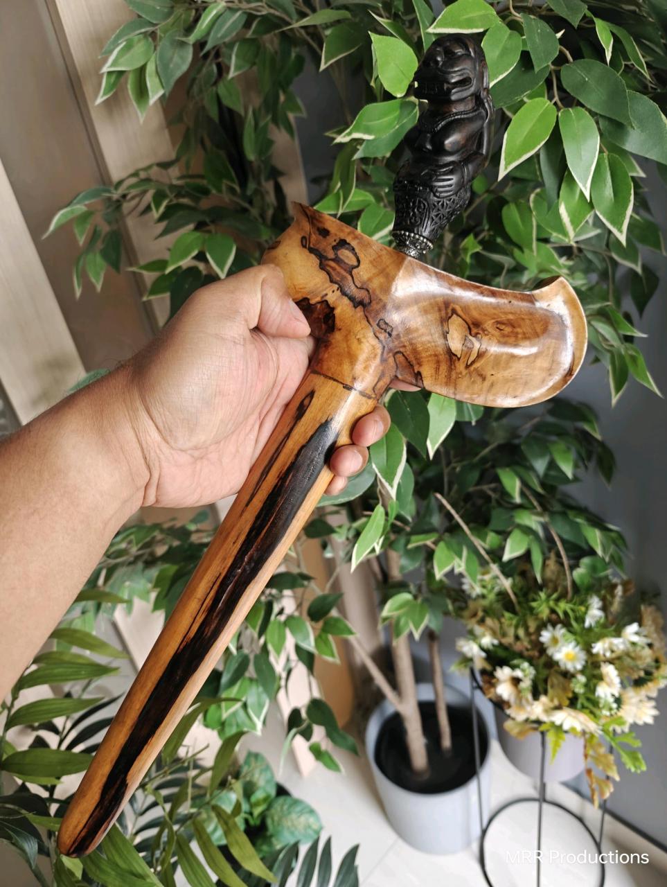

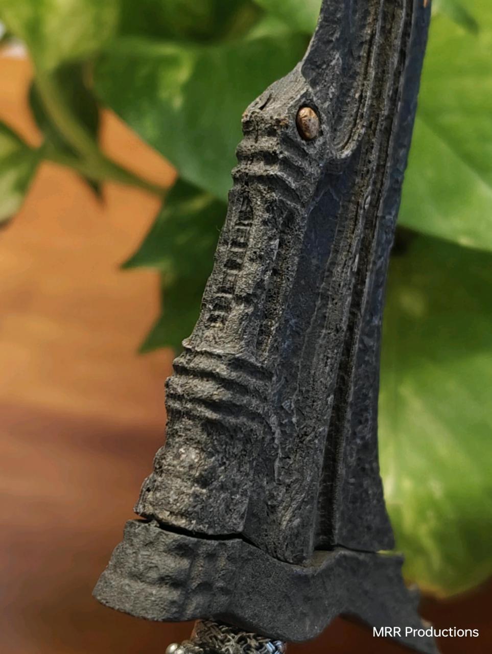

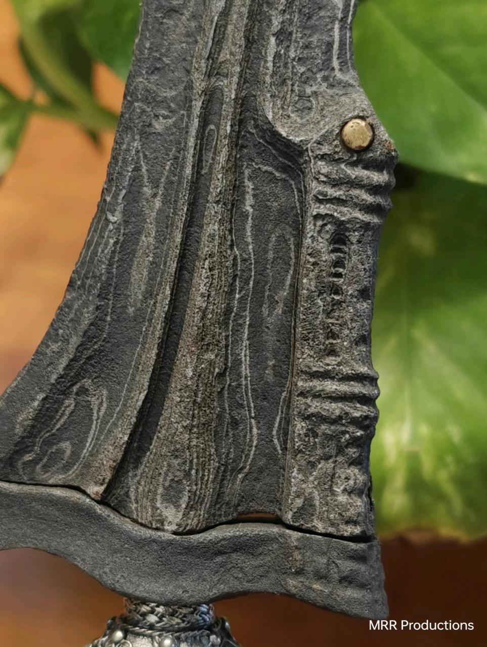

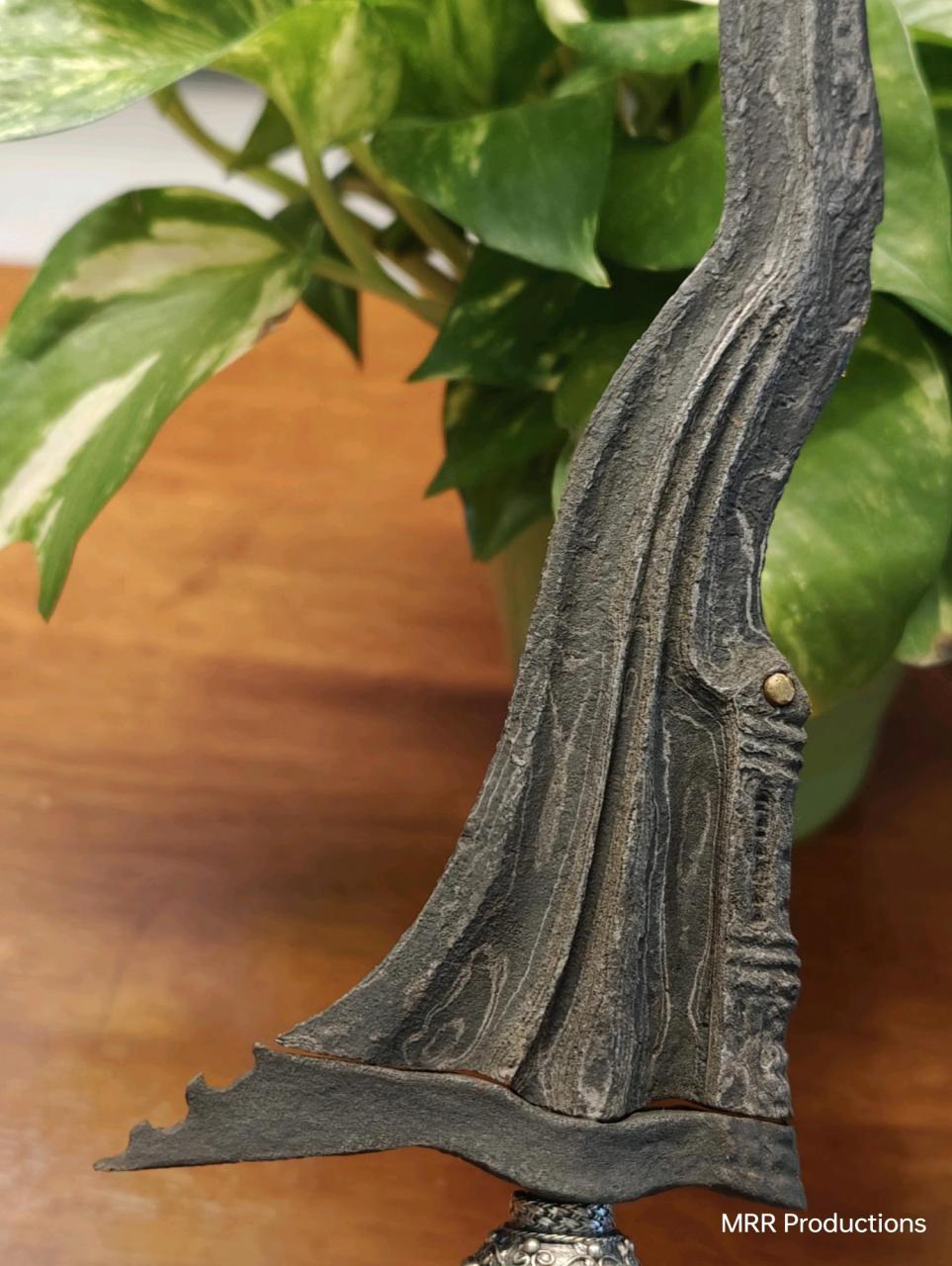

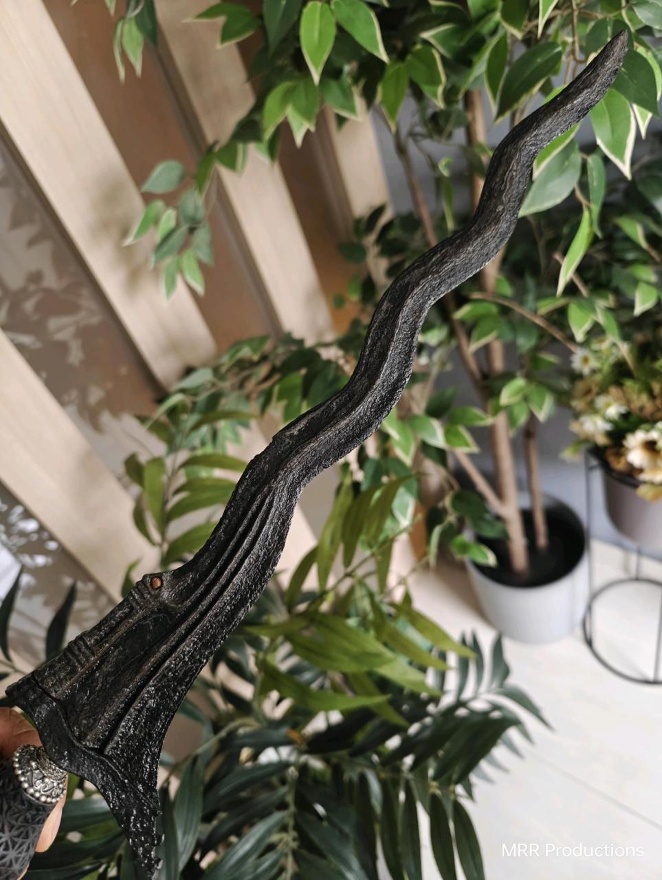

Hi, owned this Keris from another collector. Its unique. Open for discussion for its origin and dapur style as it can't find the answer, Length is about 37.3cm. Thanks
rizramon is offline   Reply With Quote
Old 28th November 2024, 07:03 PM   #2
Posts: 7,297
Well that is an odd bird indeed. Clearly i would place the dhapur in the Mahesa/Kebo family, but this one is kind of unusual. It appears to be both sincerely old and well made, but the style of the ridges and markings along the gandik are unknown to me. Do you know what the inset metal is? Gold, Suasa, Brass???
The hilt is a bit unusual as well, though it doesn't seem all that old and could be somewhat non-traditional, so i'm not sure if it can help with identifying the origins of the blade. Appears to be some kind of wadon hilt though.

Posts: 7,229
Yeah, queer fish.
At this point I need to reserve comment on the blade, as David has said, it is a kebo style, but not like anything I can recall having seen.
The mendak appears to be a bit unusual & probably has some age.
The hilt images are not easy to read, & I suspect a punakawan.
The wrongko a generic Javanese gayaman.
