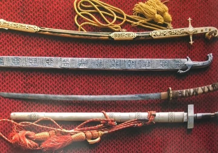

The Ottomans conquest of Egypt was happening at approximately the same time as Muhammed Kanta's rebellion against Songhai, and Ottoman expansion along the African Mediterranean cost over the next several decades was mostly due to the efforts of corsairs, who aligned themselves with the Sublime Porte. I am not aware of any evidence for direct interaction between Kebbi and Constantinople, but of course trade routes reached further than diplomacy.
Trying to study early swords is like trying to figure out the full picture of a puzzle consisting of a thousand pieces based on only a few pieces available. This is why I find the nimcha from the Gold and Damascus Steel exhibition exciting, as its hilt is the closest thing I have seen to the hilt on the "Sword of Kanta".
I tried to search for pictures of the "Sword of Kanta" online and only found the one below. Apparently all of the swords are part of the regalia at Argungu. The top one was a gift from Queen Elizabeth II. Then we have our sword, unfortunately still in its 19th century Bida sheath. The katana like thing is described as a judicial sword for executions in use for the last two centuries - if true, certainly an interesting story in itself. The bottom one reportedly belonged to Muhammadu Sama, who ruled in Argungu between 1920 and 1934 (courtesy of Wikipedia), with the scabbard reportedly having a 25% gold content.
Name:  Sword of Kanta.jpg
Attachment 241523
Thanks for this new picture! This is a beautiful sword.

If the question is whether it is possible for the hilt to date to Muhammed Kanta's time, then the answer is Yes. The guard with quillons terminating in monster heads turned towards the blade existed in the Islamic world as early as the 14th-15th century and the hilt may have been exported to Egypt and from there all the way to Hausaland. This may have even happened before the Ottomans made it to North Africa.
If the questions is whether it is plausible, then things get more complex. The main problem is the lack of similar hilts we can compare it to. In fact the only example of a hilt made entirely of metal with this kind of guard and a pommel in the shape of a monster or lion head is the one on the nimcha, #67 in the "Gold and Damascus Steel" catalogue. Number 1005 in Buttin comes close, but it has a typical nimcha guard.
Hopefully there are other examples out there, but these are the ones I am aware of. A couple of examples are far from enough to establish any trends, but for what it is worth, Buttin dates 1005 as late 16th, early 17th century. Number 67 in "Gold and Damascus Steel" is dated as early to mid-17th century and that dating makes a lot of sense to me.
And then there is the blade on the "Sword of Kanta", which we cannot see in its entirety, but which we know is a European blade, most likely from Northern Italy and dates most likely to the 17th century as well. But the blade itself is not sufficient to provide dating, because as Bivar points out, it could have been paired with the hilt at a later point. Broadswords were preferred over sabers in the Sahel, but then there is another sword in Bivar, from the Emirate of Katsina's regalia, which as a 14th or 15th century Mameluke saber blade. Based on that we cannot dismiss Bivar's point - this may have originally been a saber with the hilt then transferred to a European straight blade.
Overall, it is more likely that this sword is from the 17th century, and belonged to one of Muhammed Kanta's successors, but there is a possibility that the hilt may indeed have been something he held and used.
