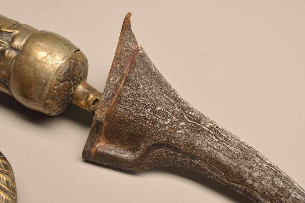

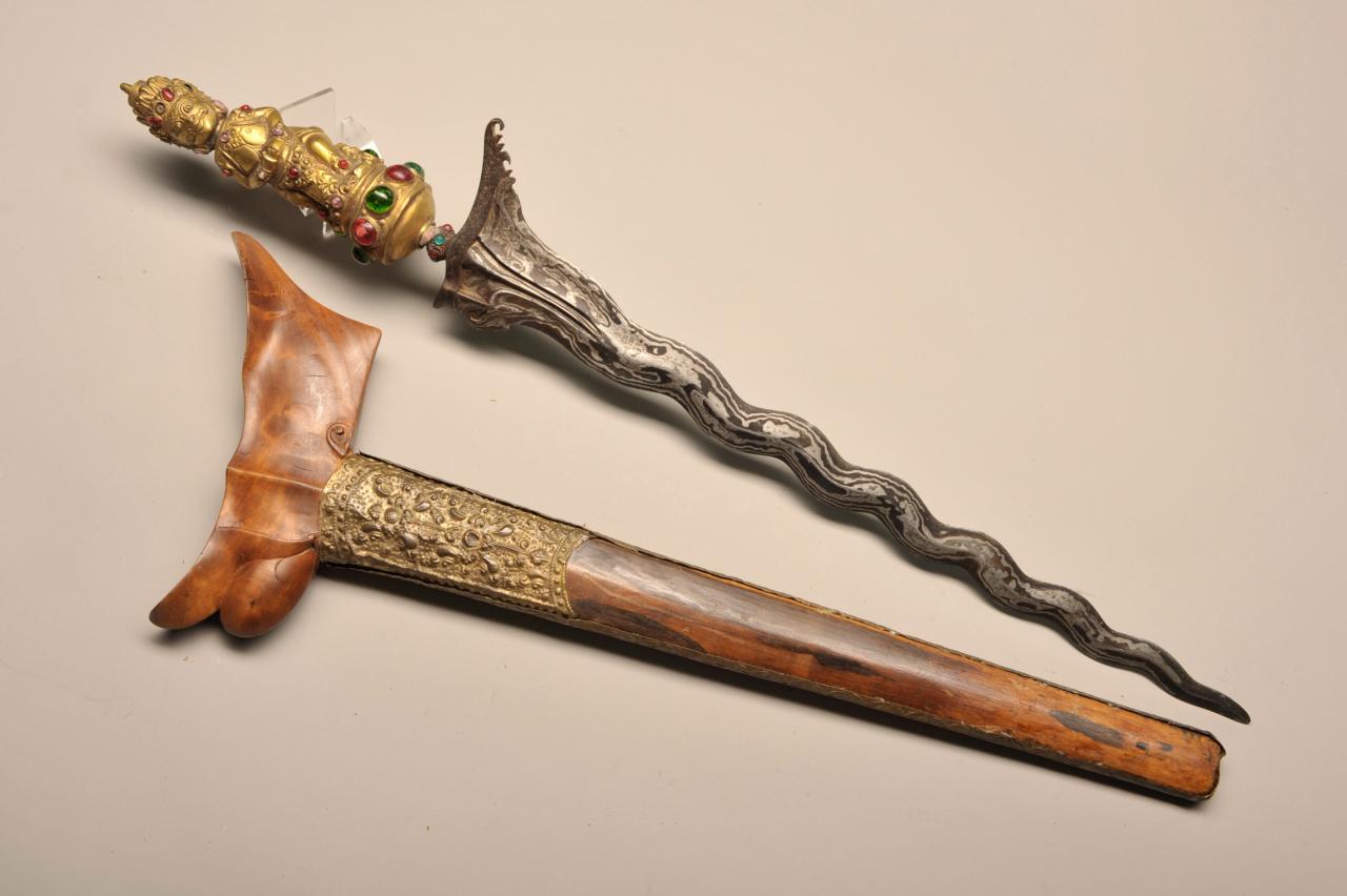

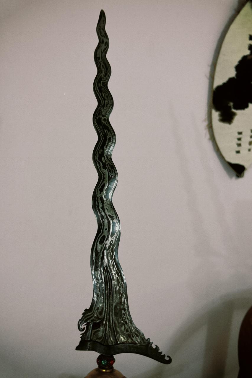

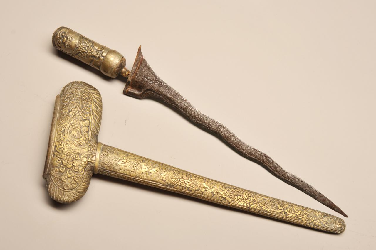

Hello all,
I have 3 Bali Keris in my collections.
The first one is said to be from the nineteenth century, and this one is special because it has a smooth blade and is not as rough as the other keris.
The second one is also said to be from the nineteenth century, and this one has an ugly hilt, and the blade is pretty thin. I think it's used for ceremony or decoration not for combat.
The third one is said to be form the Seventeenth or eighteenth century,it has a very beautiful demon hilt. However the blade is slightly damaged.
Can you help me to identify if they are really old antiques or maybe they are just souvenirs made recently ?

Post More pics of the first Keris

Default More pics of the second one

Default More pics of the third one

the first and the third are krises of some merits, but I am afraid the second one isn't. I see it often as a tourist kris. I doubt the blade is Balinese.
The first kris seems to me more a Lombok kris than it would be a Balinese but I am sure there are other members whom could elaborate more.
I can't honestly say that the 1st and 3rd are antiques therefore more than 100 years old but they are certainly not recently made.

The first shown keris is a nice one, I guess around 1900, not high quality but good, nice and legit. Bali or Lombok I can't say, I think both are possible. You should turn the handle by 180 degree!
The second one has a Javanese Blade, the workmanship of the handle and scabbard is low and I doubt that it's Balinese workmanship, looks Javanese or Madurese to my eyes but I just don't know, mid. 20th century? I've seen similar ones before but I don't know if they are made for selling purpose or for local use.
The third one is very, very nice, I like this blade and the handle as well. Sadly the scabbard is missing, it would be worth it to let made a new one for it. When you mean with "damage" the visible pitting, it's nothing you should bother about!

As Detlef has written:- #1 & #3 are not bad keris at all & genuinely old Balinese --- not super old, but I'd put #1 as pre-WWII & the blade of #3 as 19th century, maybe second half.
#2 is a very ordinary Javanese blade, the hilt & scabbard were made in Jogja, most probably by Bp. Prawirodihardjo(Alm.) or possibly his father.
