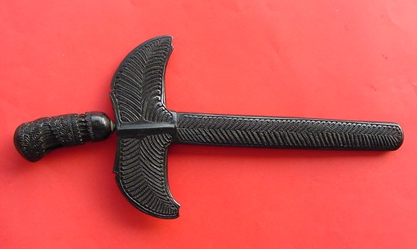

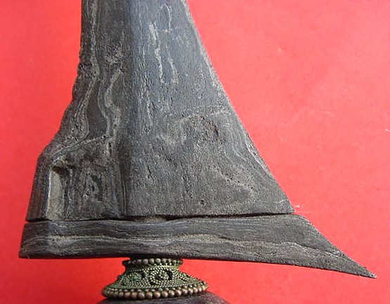

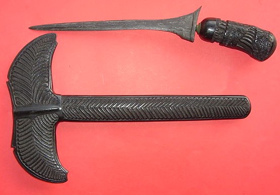

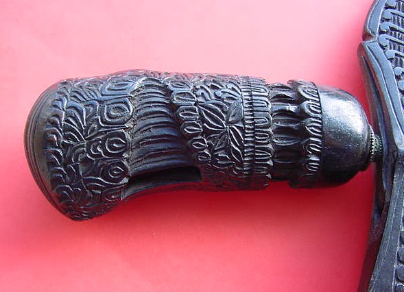

Dear fellow Keris Warung Kopi members.
First congratulations with the new forum and to the moderators who keep us all in check.
The attached photos reflect for me a very unusual dress, which I am having trouble identifying. I have had this particular piece for about 30 years and had never seen anything like it before, so I more or less discarted actually put it in the bottom of the pile as being perhaps a tourist piece with an older blade.
This is where I had it until Edward Frey released the third edition of his book. This book had the addition of the Kris Archives, and there it was on page 57 lower right corner, his photo show the wrangka with the points up, where mine is down. There is also the matter of the size of the wrangka, he show his to be 5.2 in wide, mine is 11 in wide.
I would appreciate any and all information which can be added.

Welcome Naga Sasra, glad you could join us. I have noted the example in Frey and certainly see the similarity. Judging from the quality of the carving and the wood i would have a hard time seeing this as "tourist" dress, but i have no idea of it's origin. The gandar reminds me of a bird with outstretched wings. Seems a nice find to me.
Old 23rd August 2006, 03:08 PM   #3
Posts: 7,303
BTW, if you hold a ruler up to the width of the Frey example in his book and then check the length you will notice that his quoted 5.2 in. measurement must be a misprint. He lists the lenght at 21.5, but the width is clearly far longer than half the length. It would appear that the ratio of width to height are fairly similar in both yours and his example.
Old 23rd August 2006, 03:40 PM   #4
Posts: 7,303
Well, i suppose i would take a guess my first inclination is to say perhaps East Jawa. Could also be Madura and i wouldn't count out the Cirebon area either.{Hope that was non-commital enough )

A very remarkable dress indeed. Looking at it I compare it with the early "tourist" keris the dutch soldiers brought home in the fifties of the previous century. Good blades were redressed in fancy carved dresses to bring home to Holland. I would say just like David East Java, but more possible is Madura.
Old 23rd August 2006, 11:43 PM   #6
Posts: 6,441
Red face
What do I know except what I've learned from books and friends .
The gestalt of the piece makes me lean more toward E. Jawa / Cirebon as the origin .
Naga Sasra ; I did not see this piece at your home (or maybe I forgot I did; so many to see) ; do you have any measurements of it ? The keris looks smallish from the pictures .

Thank you for the welcome and for the observations posted this far.
When I initially discarted it as a tourist piece, my thinking was that I had never seen anything like it before, and nor was anything published on the style of the dress, that I had access to at the time.
Another factor involved was the fact that the market was flooded with very well made carved dresses from Bali in the 50's and 60's. Some of these pieces were extraordinary dresses, some even with decent blades in them.
David, your size observation is right on the mark, and I fully concur that the size in Frey's book is a misprint.
I will also think in the direction of Cirebon, based on the carving of the handle and at the same time not discard East Jawa.
Henk, as for Madura origin anything is possible from there, as they have proven themselves as masters of most known styles, not only blades but dress as well. The keris brought back to Holland by soldiers in the late 40's early 50's were the early "tourist" pieces, the ones most people recognize are the ones with the sitting or laying down lion, or the face of garuda on the wrangka and the helmet style handle. Could the Madura people have made this one? most certainly but have they?
I would certainly like to see if anyone out there have seen anything like it before. Or can recognise the stylistic elements of this dress and the culture from where it originates.
Naga Sasra is offline   Reply With Quote
Old 24th August 2006, 12:23 AM   #8
Posts: 7,303
Well, for me that's quite the point in discounting the "tourist" dress idea. If indeed this style of dress was being used for tourist trade would we not have seen more of them by now? Also i would think the design a bit too abstract for touristy dress which usually tends towards representational figures.
I think i am more inclined towards East Jawa or Cirebon than Madura, but as Naga Sasra points out, all are possibilities.

Rick, I was writing as you were posting and didn't see your questions until now.
The piece was in the hallway during your visit, here are the measurements:
Overall size of the piece 23.5" or 60cm, the handle is 6" or 15.3cm,
the blade is from the tip to the top of the gonjo 13" or 33cm, lenght of gandar 14" or 35.5cm, lenght of wrangka 3.5" or 8.9cm.

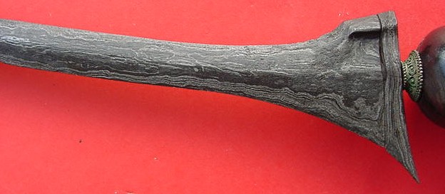

And yes, the blade in my opinion is not the original blade, and is fitted poorly to the top of the wrangka.
This said keep in mind that many an older Balinese blade have a gandar much longer than the lenght of the blade. I am not stating that this is Balinese, (obviously) but merely saying that some cultures purposely make the dress longer.

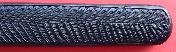

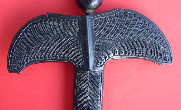

Possibly we should look at the basic elements in this dress ; the gambar has an extremely pronounced mid-rib which is an element I have not seen on Maduran gambars .
The scabbard carving is representative of simple form and extreme *repetition* ; another element that I have not seen on Maduran work . The extreme width of the gambar doesn't seem in keeping with Madurese work either nor does the shape .
Your humble moderator would deeply appreciate some postings of Cirebon kerises so that he might compare forms .
Perhaps the example in Frey III and Naga Sasra's keris are simply anomalies but that answer really doesn't satisfy .

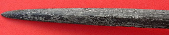

What does Frey say about it?
Let's look closer at the blade also.
Anybody who dares to stick out their neck on this?

Well, i could stick my neck out Michael, but it wouldn't really mean much since i don't really know very much.
I will say that the mendak appears to be an old (not too old, but certainly not new) lung wideng type which i believe (at least according to Solyom) would be a Surakarta form. I am not sure if such a mendak could be properly used on a Madurese keris. The hilt, of course, is not Surakarta, and since Naga Sasra believes that this blade was adapted to this sheath it would seem we have a bit of a mix 'n' match here. The blade looks more Javanese than Madurese to me, but i don't really have anything to back that up with, just a gut instinct.
