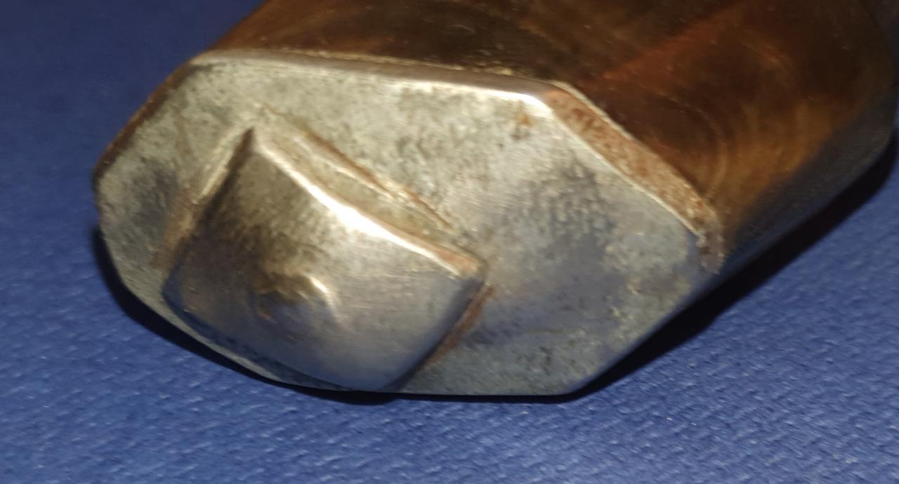

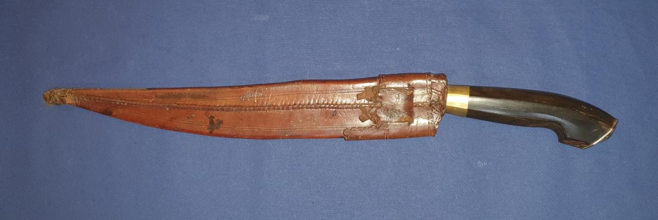

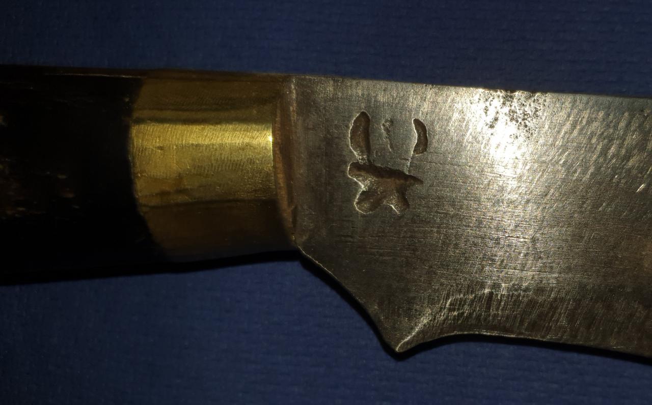

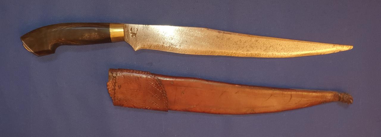

I am in the process of cataloging my Luzon blades and am not 100% sure about this piece. Laguna? Any help is very welcome. As well for the estimated age.
51 cm long, blade 34.7 cm, thickness at the spine of the blade behind the handle 9 mm.

Halloo! This is definitely Tagalog. Based on similar marked samples I've seen, this is likely from Meycauayan, Bulacan, these types already existed late 1800s (with samples provenanced SpanAm war). As for the blade profile...I'll try to remember what it's called
Hello Xas,
I've hoped that you respond! Thank you very much. Have you an age guess for this bolo?

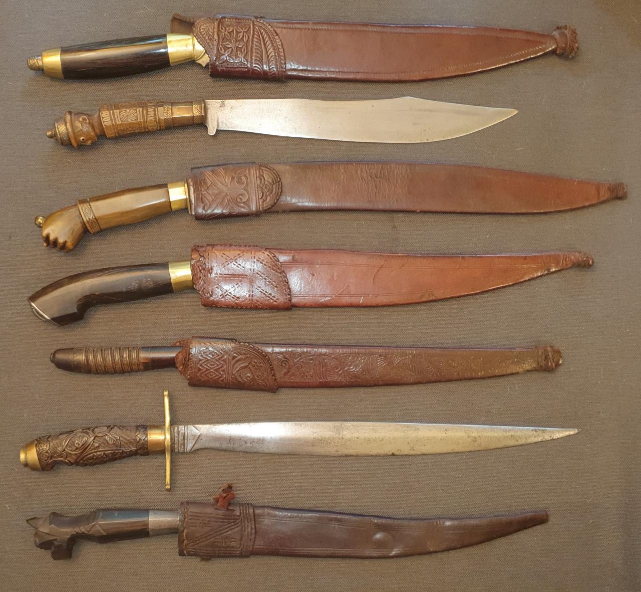

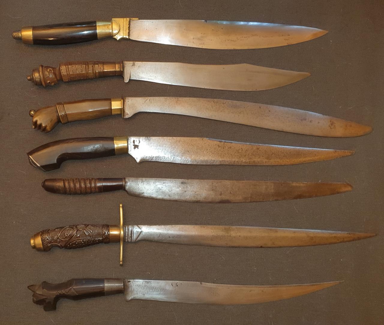

Here a picture together with my other middle sized bolos from Luzon.
From up to down:
1. Pampanga, Apalit
2. Ilocos Sur
3. Pampanga
4. Bulacan, Meycauayan
5. Pampanga
6. Ilocos Norte
7. Pangasinan
Correct me when I am wrong!

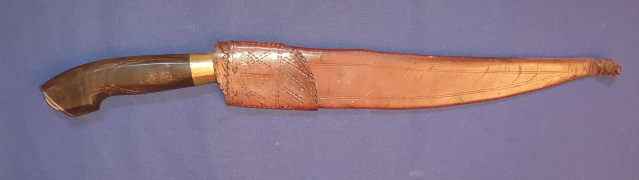

And here with scabbards, so far present.
From up to down:
1. Pampanga, Apalit
2. Ilocos Sur
3. Pampanga
5. Pampanga
6. Ilocos Norte
7. Pangasinan
Halloo Detlef. With my current knowledge, I would classify these as:
1. Tayabas, Quezon (with that brass-encased ricasso consistently attributed to Quezon samples) - "Dahong buho" ("thin bamboo leaf") profile
2. Calasiao, Pangasinan - (sorry, haven't verified this profile yet)
3. Apalit, Pampanga - "Palang" blade profile
4. Meycauayan, Bulacan - (sorry, can't remember this blade profile just yet)
5. Tagalog area, probably Rizal (differentiated from Pampanga because of the hilt- Bulacan/Pampanga hilts usually have a bulge in the middle of the sandwich config)- "Putol na dahong kogon" ("Broken cogon leaf") profile
6. Tayabas, Quezon (hilt config, carving, guard, ricasso consistently attributed to Quezon) - "Matandang dahong palay" ("old rice leaf") blade profile
7. Calasiao, Pangasinan- "Barang" blade profile

Greetings Detlef. I just updated my knowledge thanks to some recent provenanced samples. Please bear with me as I correct some previous IDs.
1. Quezon
2. [correction] Pangasinan
3. Pampanga
4. [correction] Bulacan OR Pampanga
5. [correction] Northern Luzon
6. Quezon
7. Pangasinan
