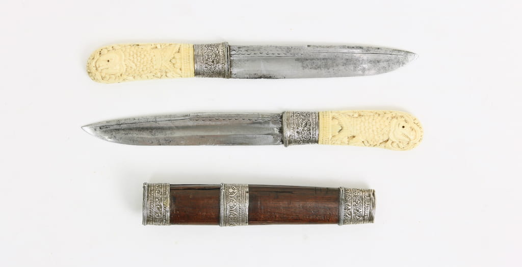

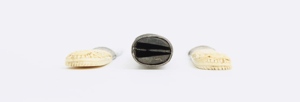

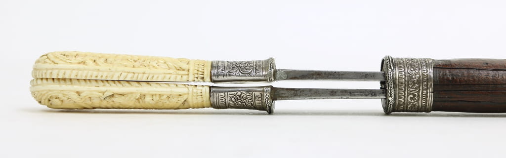

Twin Burmese knives are very unusual in my experience and presumably represent some Chinese influence. The 19th C examples here show two smallish knives (OAL in sheath 26 cm) with back edges sharpened in the distal half. Matching silver ferrules. The silver mounted wooden sheath is likely a later addition. The unequal blade lengths might reflect damage to one (and reshaped), or perhaps they were made that way.
Does anyone here have similar examples of twin Burmese blades?

Are those handles bone Ian?
Interesting how both blades have an uneven cutting edge.
Do they both share the same scabbard?
Old 5th February 2024, 01:14 AM   #3
Posts: 4,396
Hi Rick,
Best I can tell from the pictures, the hilts are bone. I believe they share the same scabbard. These are auction pictures.
