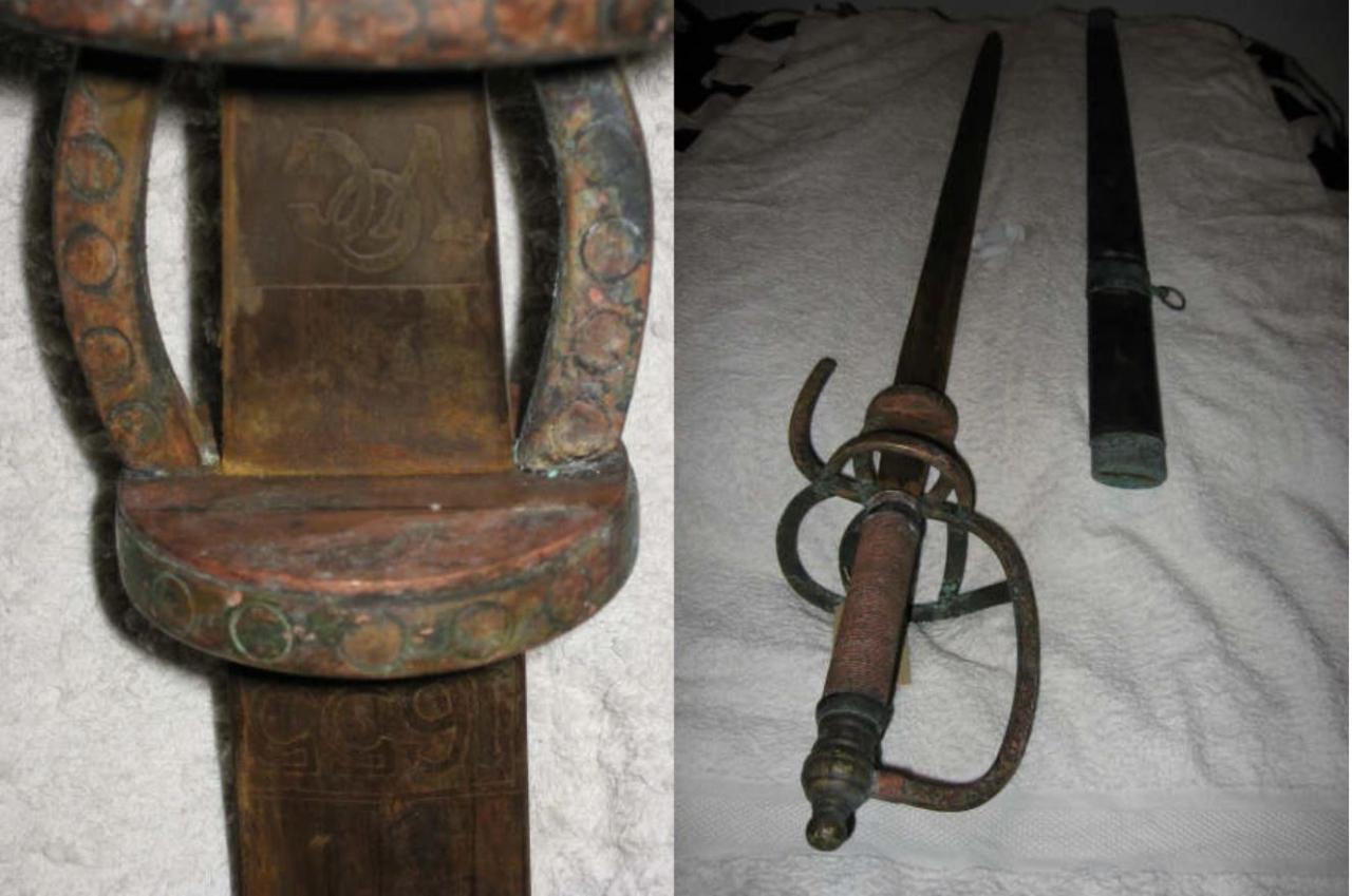

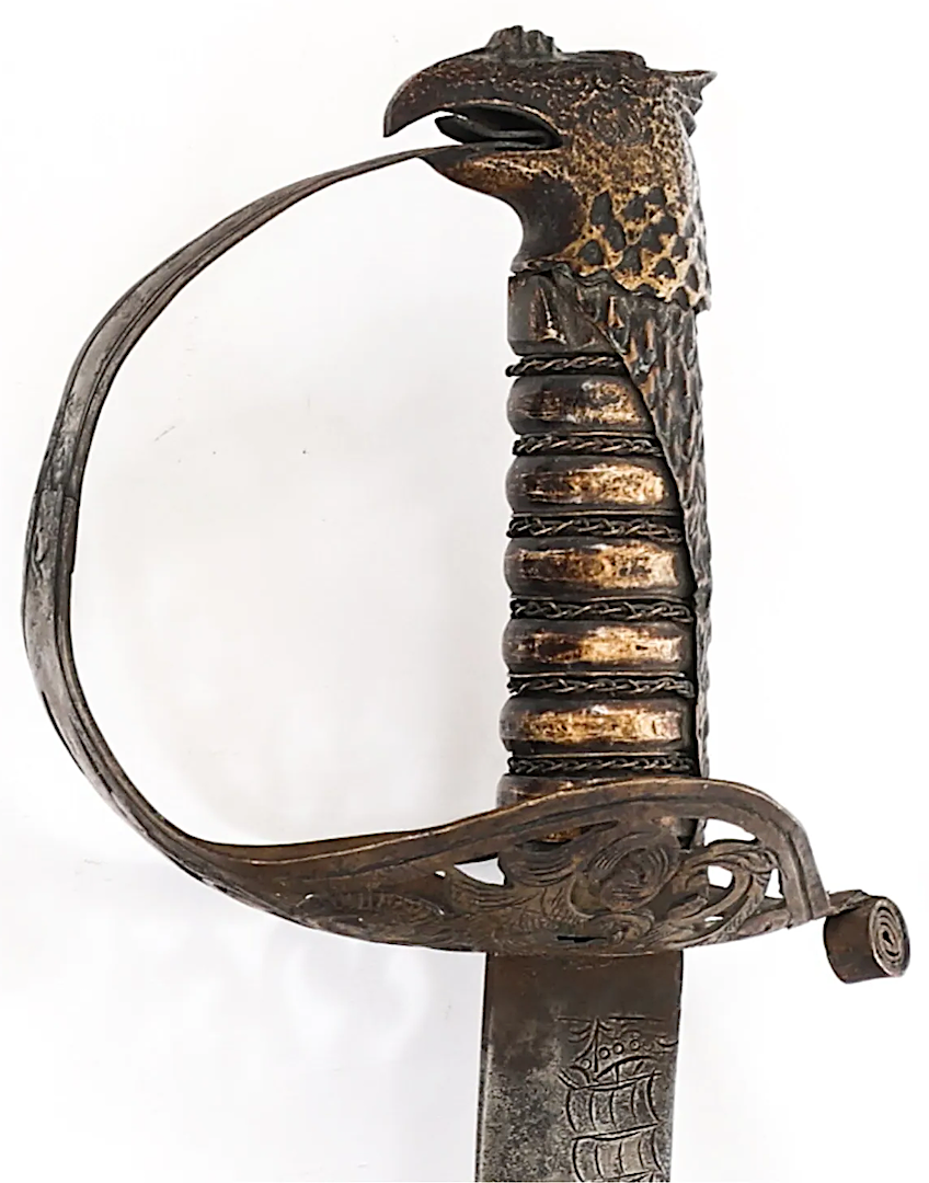

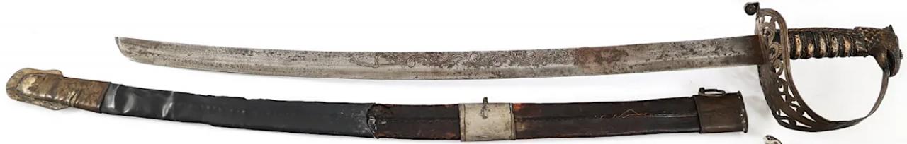

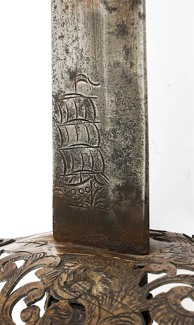

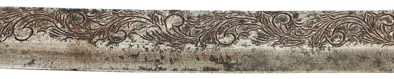

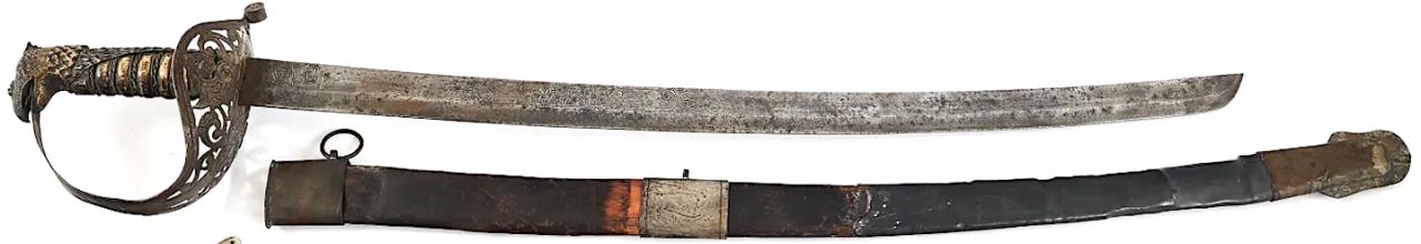

For those members who have been visiting these pages since the early 2000s, I have a little trip down memory lane. You may recall the infamous "Shaver Cool" thread that discussed a sword with the inscription "Shaver Cool" and "Batavia" on the blade as well as a VOC marking of the Dutch East Indies Company. This was a thread that would not die. The subject of the thread bemused the best of minds here for months. Unfortunately, the thread died when the old UBB forum pages were hacked. Perhaps the "wayback machine" can resurrect some of it.

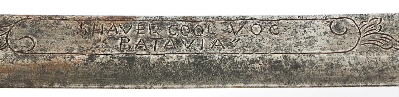

In any case, the purpose of bringing up this subject again is that I had never seen another blade marked with "Shaver Cool" or "Batavia" until a month ago when one appeared on an auction site. The sword was not in great shape, but had the same "Shaver Cool" and "Batavia" marks, as well as an inscribed picture of a schooner and a VOC inscription that was clearly bogus. The basket hilt and garuda pommel were similar to the earlier example also. However, if I recall correctly, the overall quality of this recent sword is not as good as the earlier example.
See also here.
Attached are the auction pictures. This sword appeared in an auction lot of three or four swords. Maybe someone here now has it.

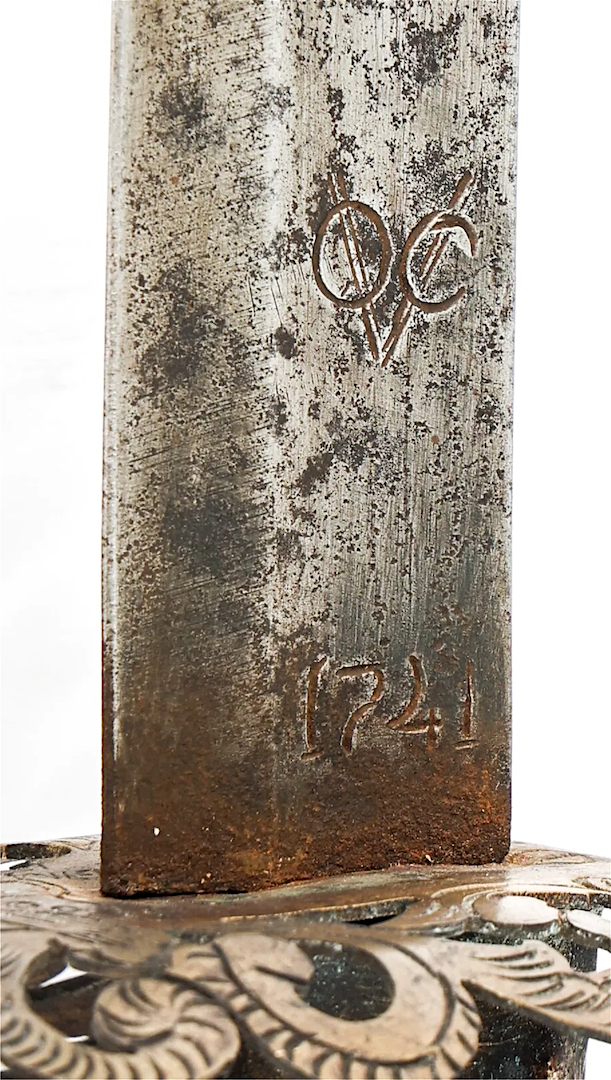

The Batavia sank more than a century prior to the 1741 date on the blade, though that is far from the biggest issue with the inscriptions.

If we look at the various examples referenced here, it is apparent that no two are exactly alike. The quality of workmanship varies widely, and is generally not of a high standard. Certainly not up to the quality of blades coming from Tjikeroeh and other centers in Western Java during the late 19th and early 20th C.
I think all of these are of Indonesian manufacture and it is unlikely that any European was involved in their production. I believe they were intended for sale to the local and overseas European market (i.e., Dutch colonials and homeland), and are not in any way linked to the VOC. The markings are designed, perhaps, to appeal to nostalgia in the intended market. As to when they were made, I would guess in the early 20th C around the same time the better quality European style knives and swords were being produced in blade centers of western Java.
Auctioneers' stories of these swords being supplied to sailors aboard VOC ships are highly unlikely to be correct.

In looking again at the inscription, the quoted "BATAVIA" WOULD indeed not refer to a place in that manner, but directly in commemoration to that ship.
This is of course a 19th century item in that sense, more of a souvenir type weapon? not of high enough quality for presentation or ceremonial.
As you say, the authentic examples of VOC blades have the 'chamber' letter of one of the six kamers (chambers) , which A (Amsterdam) was most common; with M (Middleburg) R (Rotterdam) etc.. These letters were with the VOC and blades were dated with year, seeming to range from mid 18th c. to late 18th.

I believe we're getting sidetracked here - references to VOC and Batavia (town/ship/whatever) are completely spurious.
The quality of these "shaver cool items" definitely points to the post-independence era - no chance that these originated from the 19th century!
I believe we had a thread some years back that showed swords with similar fittings attributed as presentation pieces of the early Indonesian navy. These "shaver cool items" seem to be cheap knockoffs of this style with added spices for making them more palatable to those traveling for pleasure.
