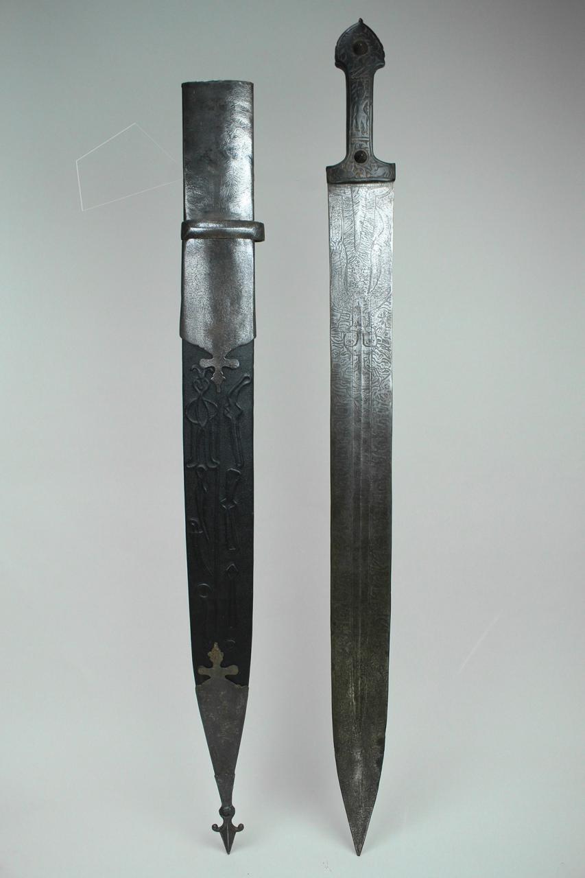

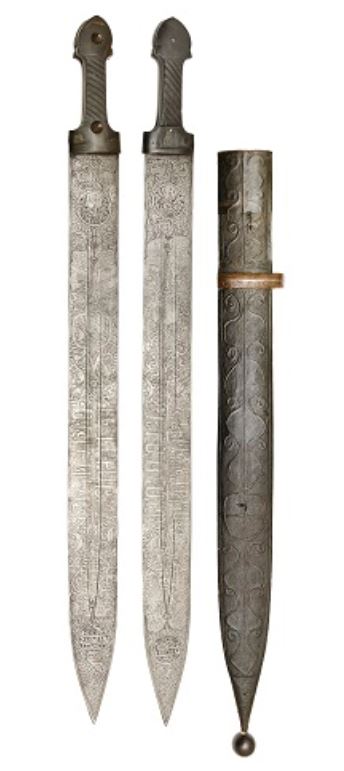

These beasts turn up every now and again, they usually are over 120 centimeters in length.

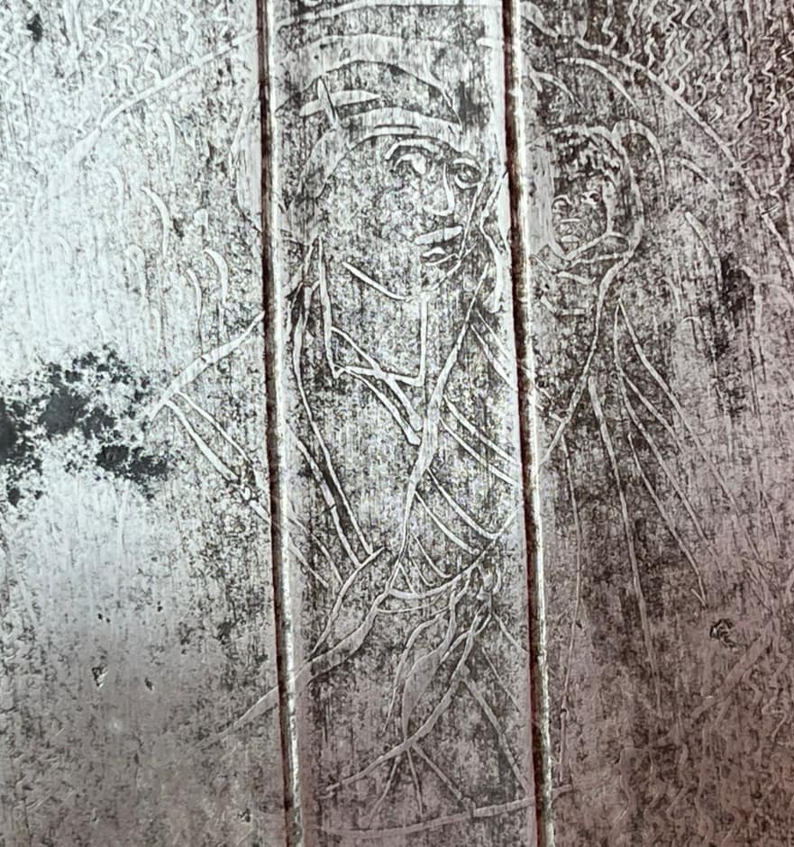

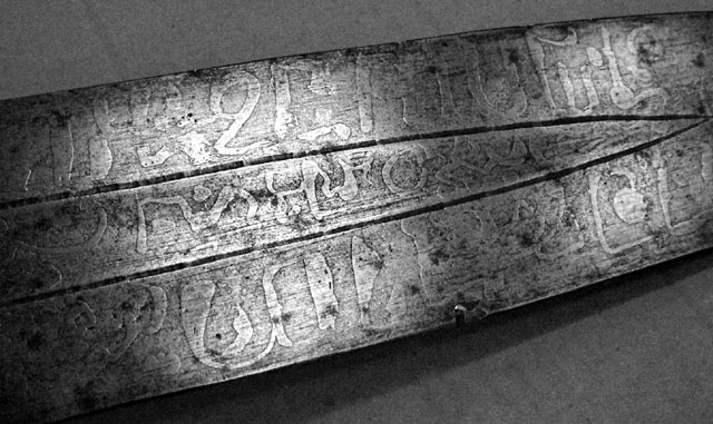

Although these are decorated in a manner very befitting of Qajar-era Persian arms, almost all of them seem to be linked in some way to Armenians. Most of them have Armenian letters etched on their blades, Armenian signatures, or Christian imagery such as images of the Virgin Mary. One of these examples below comes directly from the Armenian state History Museum.
