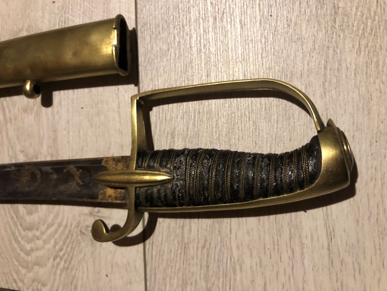

On the last day of 2023 I would like to show you my latest acquisition and ask a question about the manufacturer of the blade.
I bought this last month, not far from me, from a family where someone had passed away. They had no idea how the saber came into their possession, but it hung in their father's office for as long as they knew.

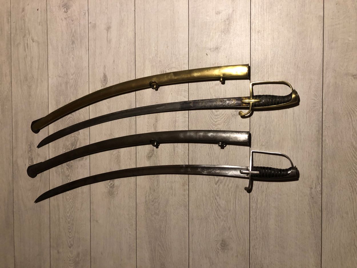

It is the right saber in the first photo. I believe it is a hussar saber for an officer. In the Dutch army and weapons museum they have some almost identical copies. These are referred to as Dutch sabers from the Batavian Republic or the Kingdom of Holland (1795-1806).
Because this one comes from a Dutch family, I assume that it also belonged to a Dutch officer.
Unlike the left example, this one has been ground and is still reasonably sharp. Something that is not self-evident for an officer's saber.

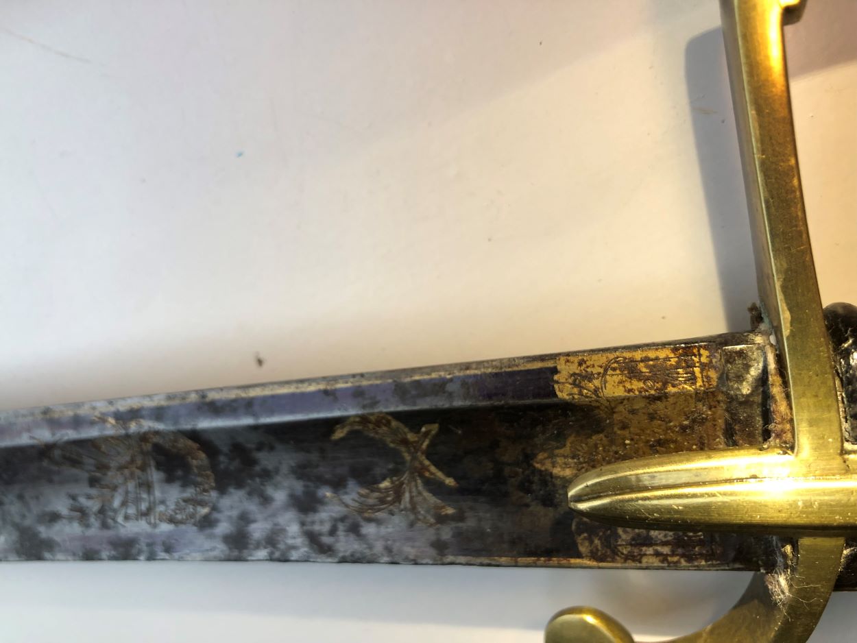

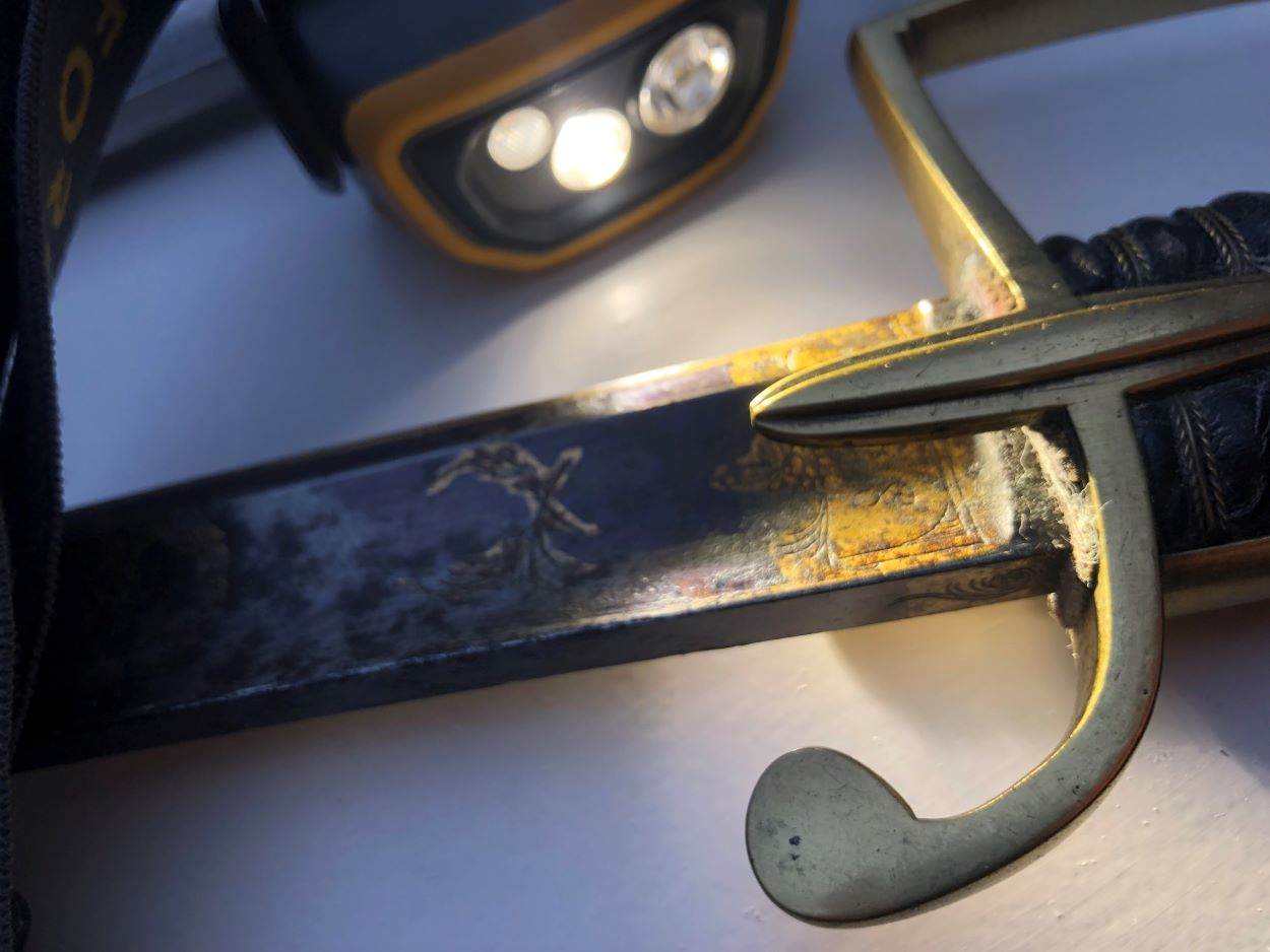

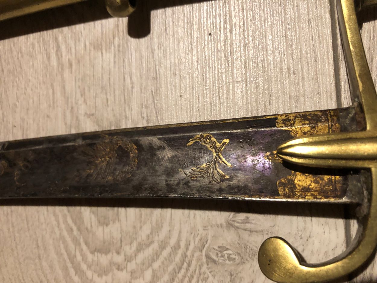

What I would like to know is who the manufacturer is? This could possibly narrow down the time period somewhat. The saber has the Solinger rose on the back and is marked on the ricasso. The problem, however, is that this is not completely visible due to the langet. What I can read is that it says "S & . Followed by several letters that, unfortunately, I can't make sense of.
Who can shed some light on this?

On the maker, I suspect that the S is for S & K of Schnitzler & Kirschbaum who were a prolific Solingen based distribution company rather than a manufacturer. This is the best information I have found online to the origins of the company, one that has a long history:
Thank you, Chape, for your comments, and Cathlineau for confirming the earlier date.
I have known the information from S&K = Schnitzler & Kirschbaum, and like Chape I have seen the period 1811-65 for the company. However, I was a little skeptical of an early date of 1811 as I had seen S&K marked blades of apparently consular sabers. I found the following while searching for German sources online (Google translate very useful!
City of Solingen Archive:
Contains: Bd. 1, 1803-1805 notebook of the company Johann and Peter Pieper & Co., Gräfrath, of the company Schnitzler & Kirschbaum, SolingenBd. 2, 1805-1807 Brief from Abraham Schnitzler, traveler of the Schnitzler & Kirschbaum company.
Also, from a Biography of the Schnitzler family (German)
The family had lived in Gräfrath, near Solingen, since the beginning of the 17th century. Family members have served in the civil service, some as mayors. They sold forged products from Solingen as merchants. As unprivileged merchants, they were prohibited from selling swords and blades. To get around this problem, → Philipp Jacob (1759-1811) founded in 1797 → with his uncle → Wilhelm Bernhard Samuel Kirschbaum (died 1803) of the company "Schnitzler & Kirschbaum". After the death of Philipp Jacob, his eldest son → Carl Eduard (1792-1864) took over the management.
So when we see the blades marked S&K, a date prior to 1811 should be considered.
