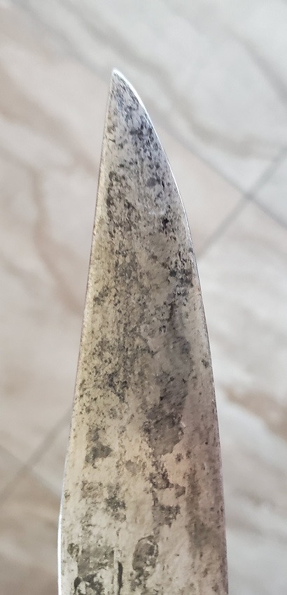

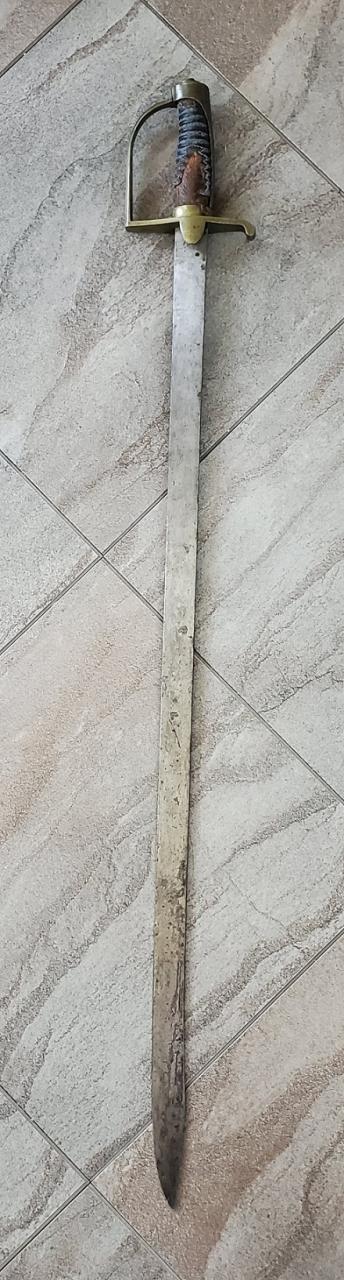

Received this saber today. I saw it at an auction and since no one was bidding on it I couldn't resist. It has quite a curve (11cm) and a clipped point. length 90cm. At the base it is almost 1cm thick. It has a wide fuller all the way to the tip. In my opinion late 18th or early 19th century.
The decorations on the blade are typically European (the cannons with banners). The strange thing is that the last 30cm of the blade seems to have been hammered out. If you run a finger over the blade you will clearly feel a wavy pattern. It may have had some major kinks at some point that they tried to straighten out.
I suspect it is a British flanking officer saber but I could be wrong.
Unfortunately, it does not have a sheath.

Hallo ,
Not exactly my stuff ,but i would say english, second half 18th.century,blade probably German ( Solingen) .A similar trophy bundle i have at the blade of a much older Feldsäbel.In the book "Enzyclopedia of Swords and Sabres", you find a sabre with a similar hilt but with a much less curved blade.

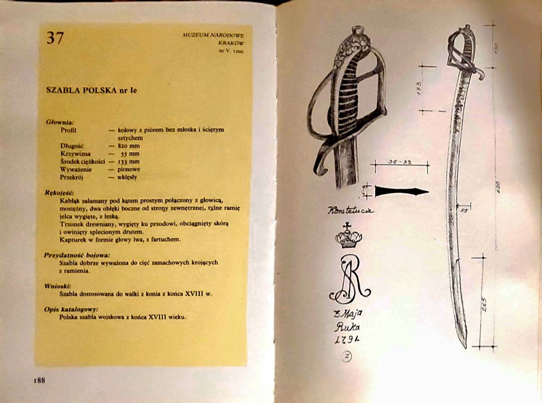

Actually, this is a REMARKABLE acquisition!!!!
While it is of course not surprising to think of this as British etc. given their profound attraction to the light cavalry of Eastern Europe in the 18th century, this is actually a Polish cavalry saber of 18th c.
A very similar example is found in "Ciecia Prawdziwa Szabla", Wojciech Zablocki, Warsaw, 1989,

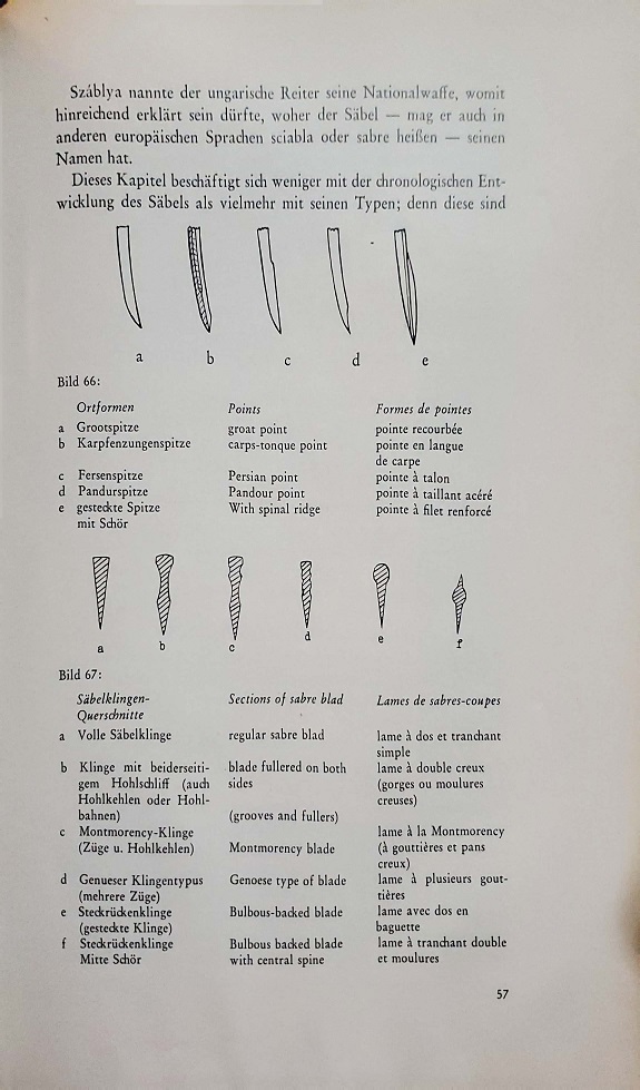

These 'monster' head pommels are seen on several sword types of these regions in 18thc. . I would note that these rather extreme curves on the blades were much favored, and the 'clipped point' is referred to in "Schwert Degen Sabel", (Seifert, 1962) as a PANDOUR point.
The pandours were irregular forces from the Balkans and East Europe, most notably Hungary for Austria during the War of the Austrian Succession in mid 18th c. '
Later in the century these formidable forces were inspiration for similar in other European armies as well.
The absence of one guard bar and the capstan is not unusual with variations in these hilts.
The blades on these were often from Styria and several blade producing cities there. The decorative motif was popular on these sabers, often including royal or personal cyphers and various military panoplies.
An extremely nice saber, regardless of lack of scabbard. These were usually leather and did not survive in many cases. The grip would have been leather wire wrapped.
Please note, I am not saying this is a pandour saber, but that the influence/similarities seem present in this Polish saber of the 18th c.
