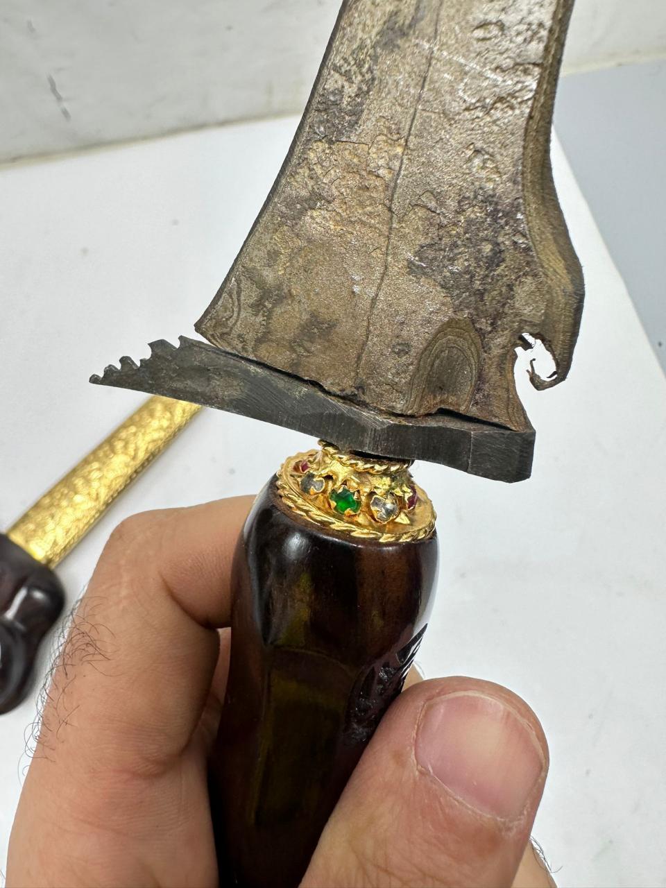

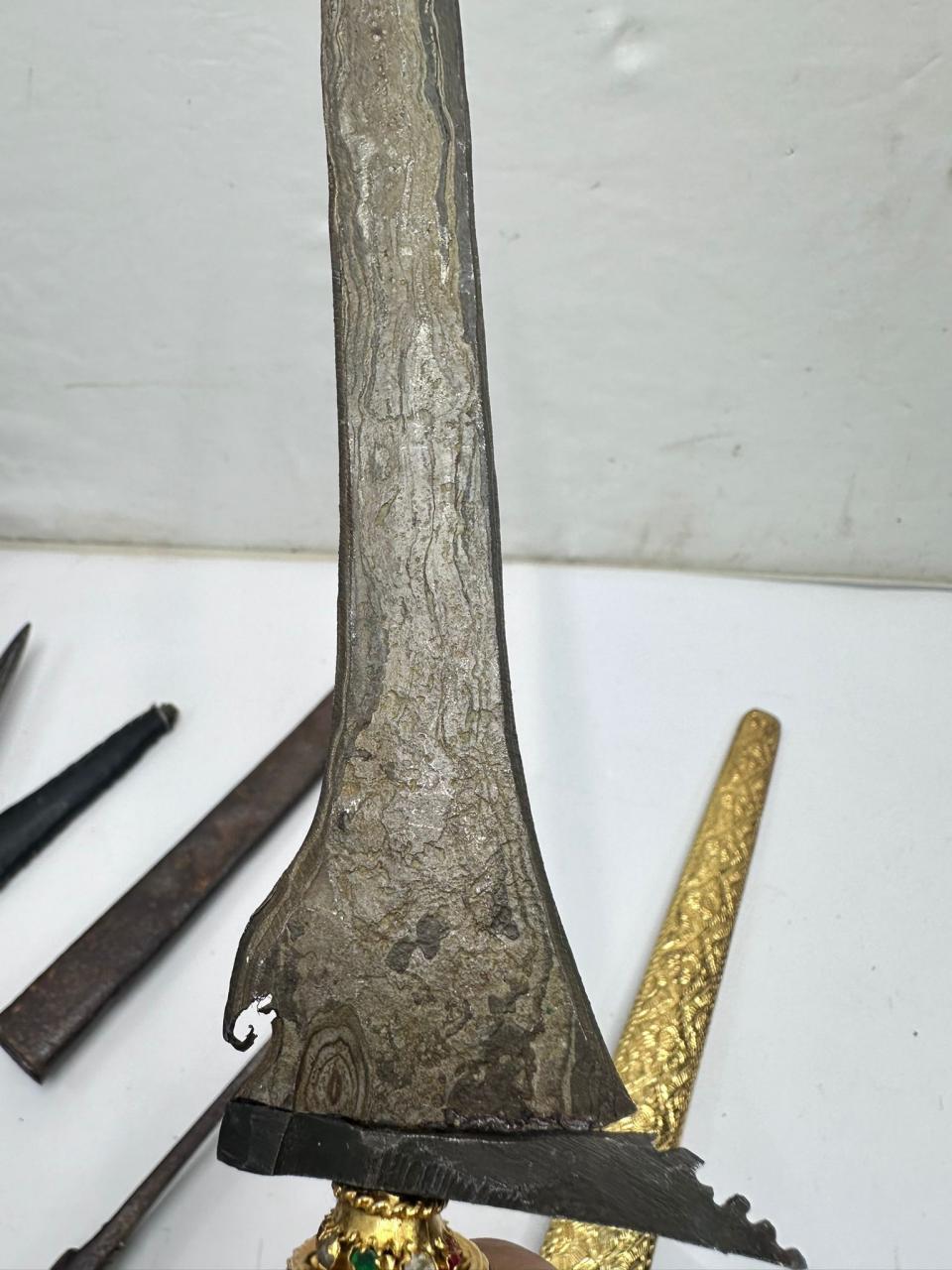

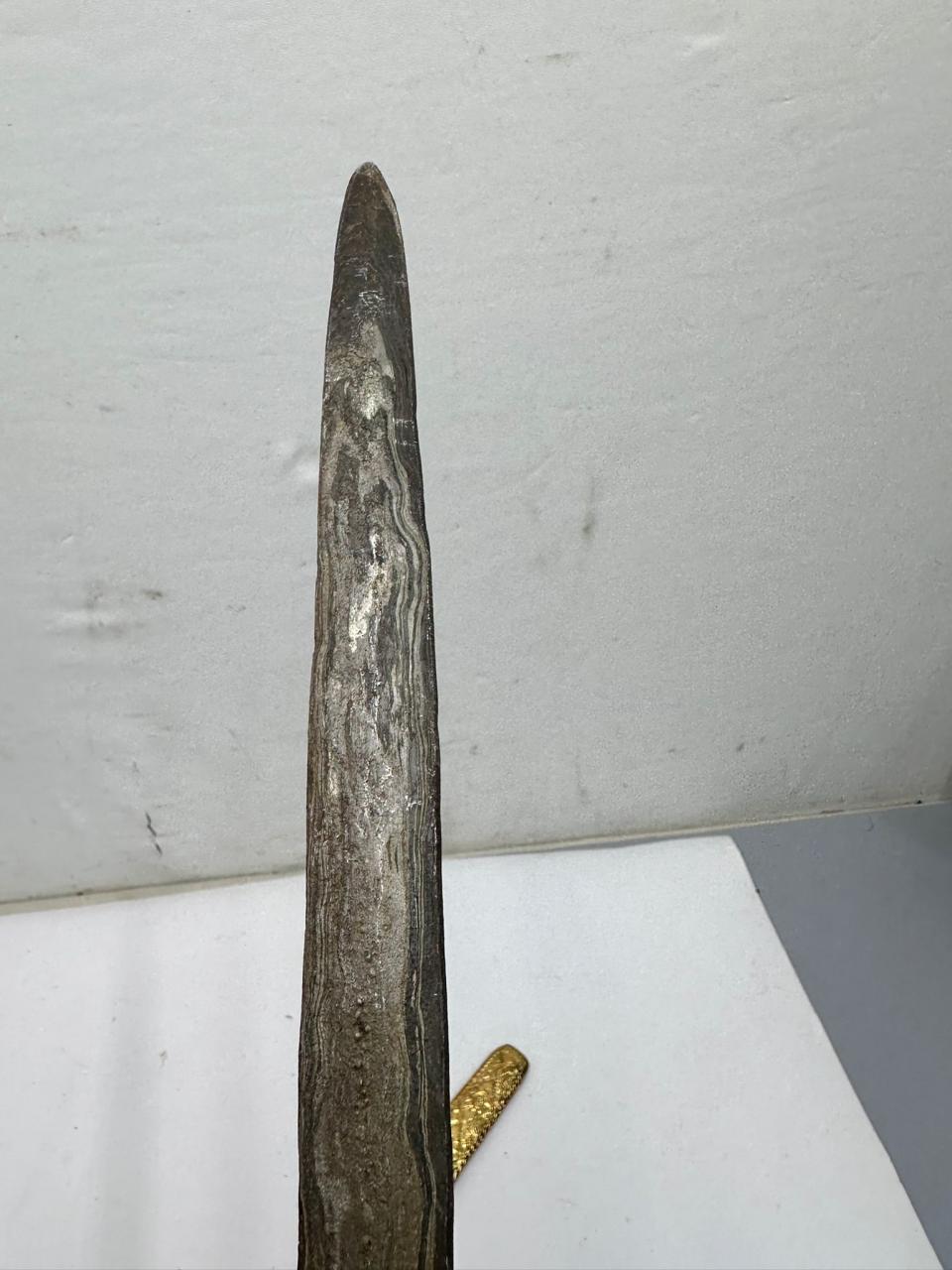

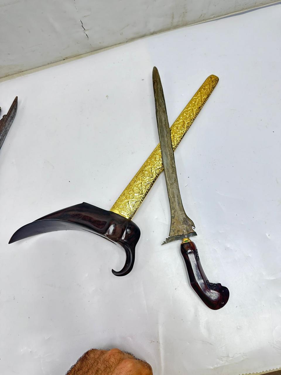

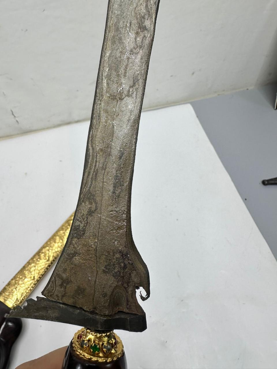

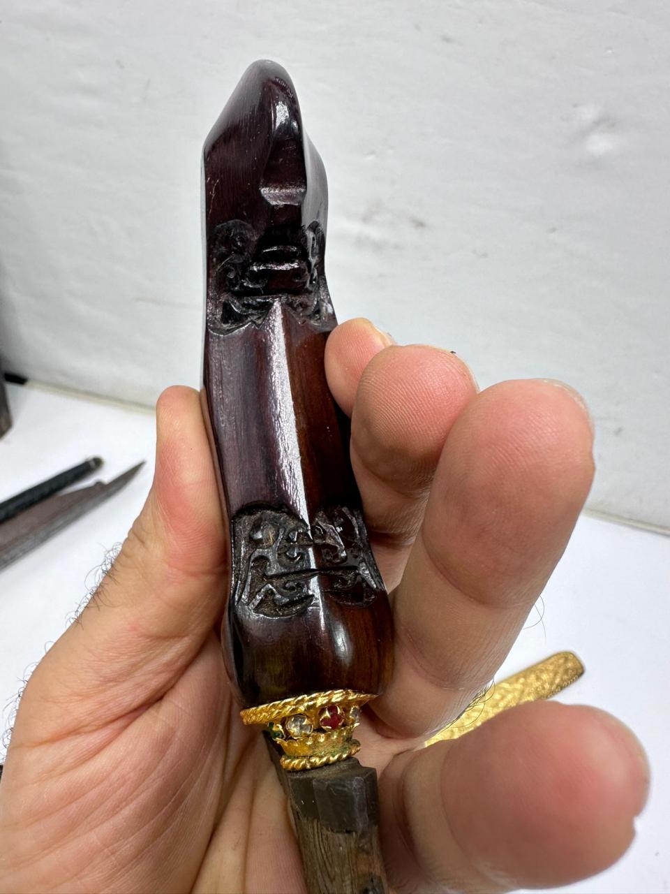

I bought this at a local antique shop a few days back. I know almost nothing about Kerises, so I figured I'd ask you all for specifics (whether it is a tourist trap like I assume it to be, its classifications, etc.). Thanks in advance.

As a totality this keris can be classified as a Surakarta dress keris.
All the dress items are current era and of rather pedestrian quality, the blade is an older one, nothing special, the gonjo has been replaced.
Wrongko style is Surakarta ladrangan, pendok is embossed, probably made in Imogiri, off the top of my head I cannot name the pendok motif.
The hilt is Surakarta planar, I cannot give a tighter classification from a photo, but it is most likely yudowinatan form, the mendak can be given as kendit.
This would be a very low value keris in Central Jawa, but it is representative of a very large number of the type of keris owned by ordinary people as a dress item.

Hello and thanks for the detailed response. I'm not surprised, but I still should've been a tad more careful.

Nothing wrong with it, it is what it is.
It is a genuine cultural item, the blade body has some age, the rest of it fits quite nicely into the dress frame work.
It really comes down to values, a pretty decent older keris will usually cost good money, a somewhat lesser keris will cost less. This keris might not be a masterpiece, but it is complete & in nice condition. Its OK.
