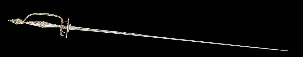

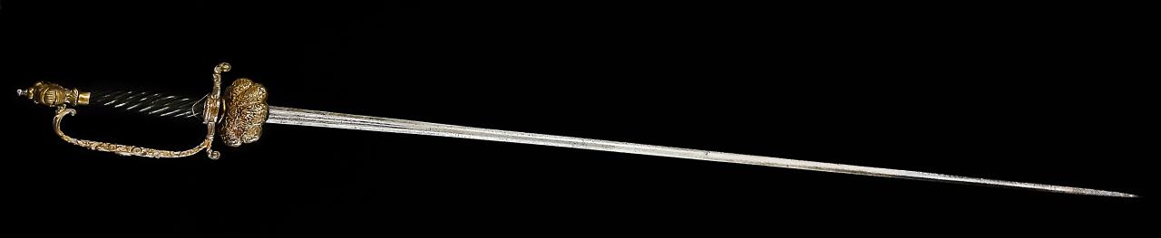

Hi Folks.
Without wishing to put up fences, I suspect Fernando will be able to advise me on this issue, but of course I welcome all input.
I have two Court swords with rapier blades that are certainly re-hilts.
The blades are very thin... delicate almost; great stabbing tools.
I've posted images of the silver hilted one before - but for other reasons.
My question is this:
what is the history of these very fine, slender blades and what sort of hilts would they have had originally?

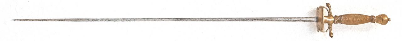

The reason I considered re-hilts was because of the length of the brass hilted version which has a 40" blade; obviously well beyond the common smallsword parameters.
The silver hilt, however, is 31" and as such is within said parameters but has an identical blade profile to the 40" one, so I assumed there was a category of sword of which I was unfamiliar.
Again, however... that brass hilt is actually very, very big, so it may well have been commissioned for a big fellow wanting a proportionate length to his weapon.
The other reason was the dating issue:
they are very late 1700s hilts are they not? If so, I was puzzled as to why they were fitted to blade styles I thought (and here you must pardon my inexperience and ignorance) had long since gone out of fashion after the arrival of the 'hollow' blades.

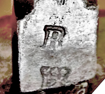

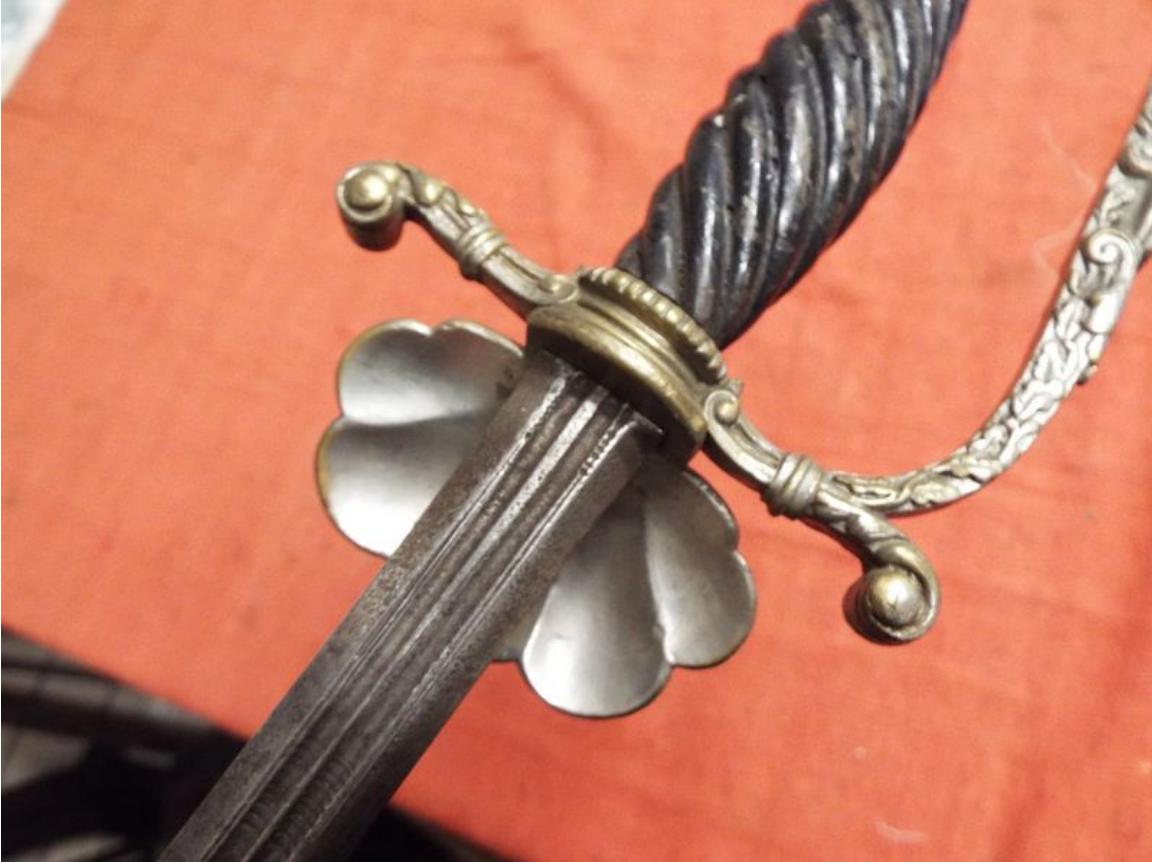

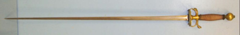

The ricasso on the silver hilt sword shows the maker mark in the squared ricasso cut in half (see attached).
The 40" one doesn't and the blade disappears into the hilt (again, see attached).
I find it hard to imagine that either sword has not been modified or chopped down at their ricassos.
There is definitely no indication of blade thinning on either sword.

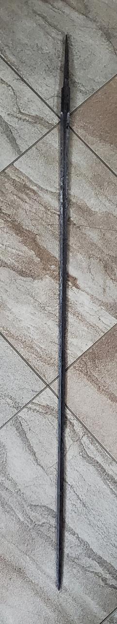

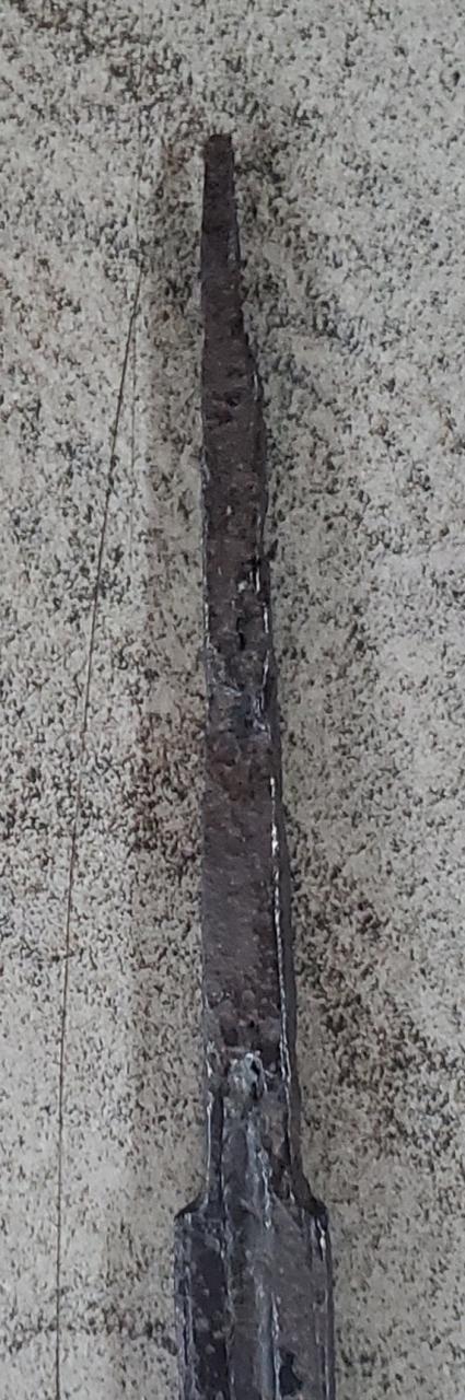

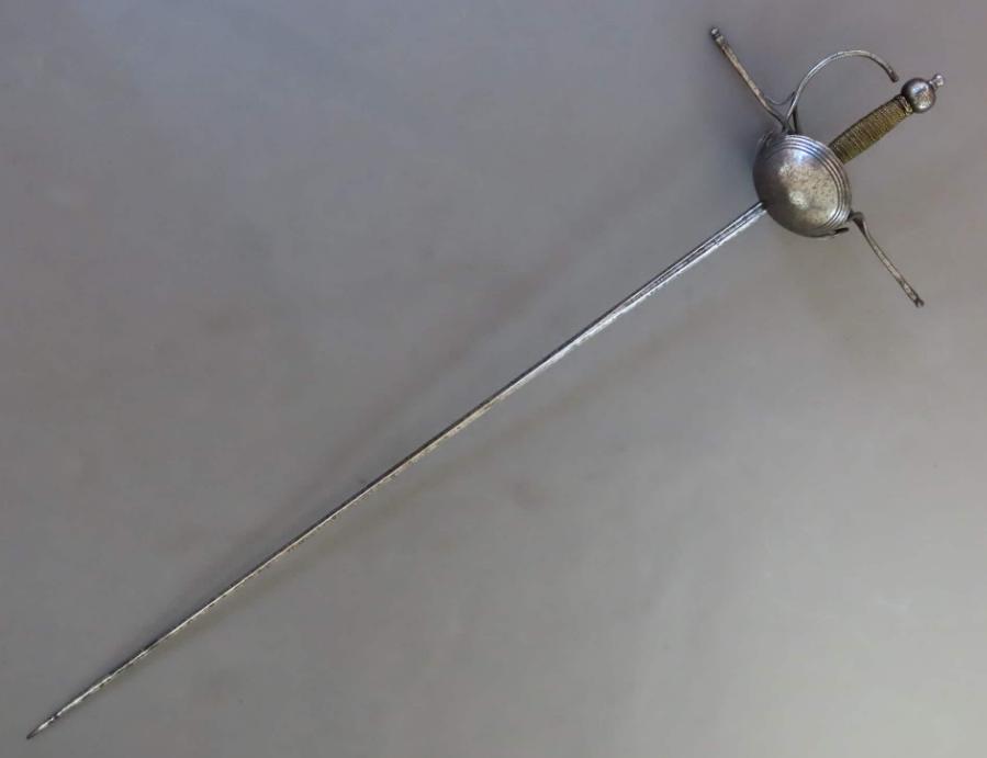

These thin rapier blades were of course prevalent through the 17th century into the 18th. While they seem to have been contemporary to heavier arming blades through the 17th, the rapier and dueling swords were apparently maintained in the court and gentlemans swords. The so called transitional rapiers (a most nebulous area) seem to have been with these slender rapier blades in the small sword and court sword hilts in the 18th.
Attached is a Spanish rapier blade (though probably German made) which is believed from the Spanish nao Encarnacion which sank in storms off Panama Dec.3,1681. It had left Cartagena enroute to Porto Bello Panama, and among cargo had crates of sword blades.
This type of blade was of course known earlier in 17th c. As Toledo was in dire straits in the 17th century, Germany stepped in and produced blades as they were long well established as the key blade producers and continued as such well through the 19th c.

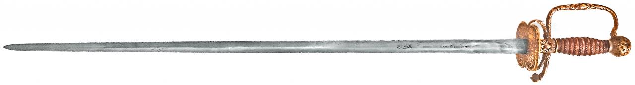

So: I am reminded Jim, of that Dutch duelling rapier/smallsword of the late 1600s... the one you have your eye on (see attached.
I don't know why I didn't hop over to that conclusion.
Here is a virtually identical blade inasmuch as it is thing and sharp and reasonably long.
This must have been before the 'First Blood' rules appeared.
But, I am convinced that brass hilted sword of mine with the 40" blade was longer before it was hilted thusly so my obvious next question is "What sort of hilts did these blades have back closer to the end of the 1600s".
Has anybody seen a long narrow rapier blade hilted as per the end of the 17thC?

The brass hilt with the extraordinarily long 40" blade may have similar circumstance, and is more aligned with the court sword styles popular in Georgian period but recalling the down turned guard on earlier swords such as hirshfangers or cuttoes. Again, it is a matter of personal preference, but for dueling as well as for court wear, such a long blade would be detrimental as awkward.

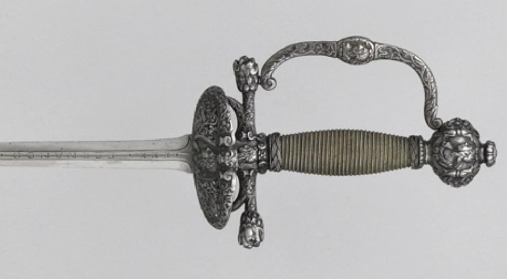

As an example of the Colichmarde blade being used in the late 18th Century, this is a French m1767 Infantry Officers epee with one:

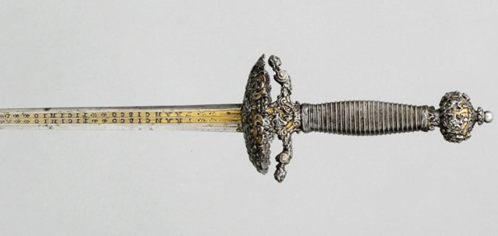

Name:  m1767 Epee officer of Infantry 35.jpg
Such an example with a fairly precise date makes applying hard and fast rules difficult.

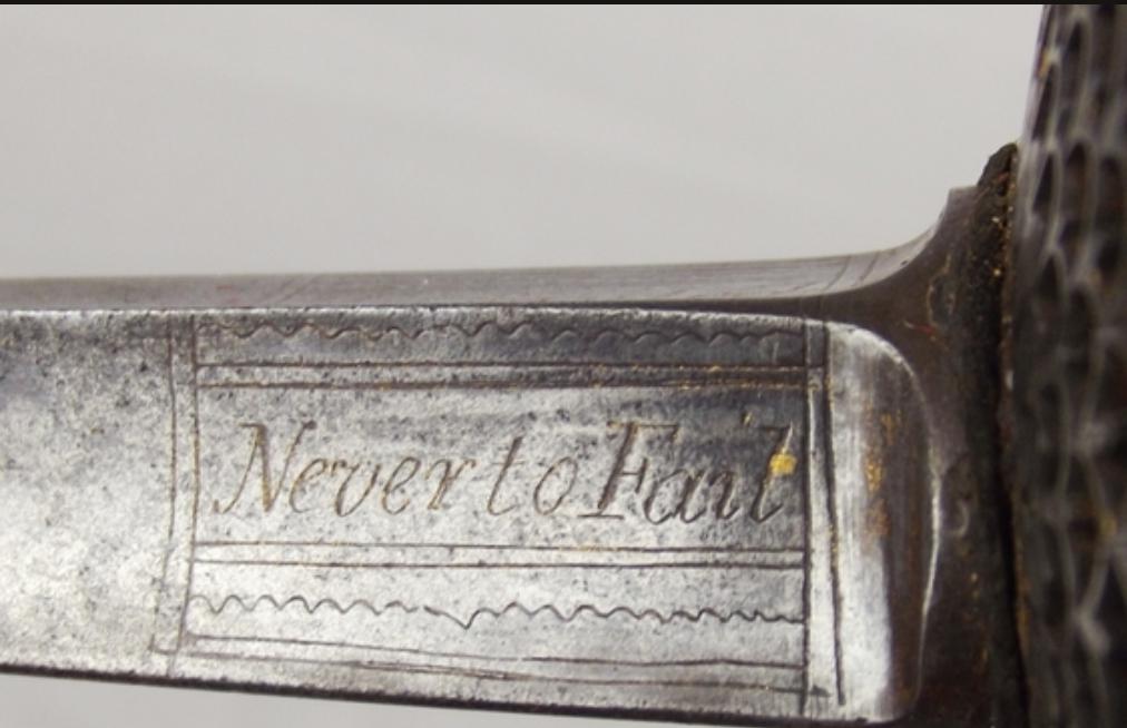

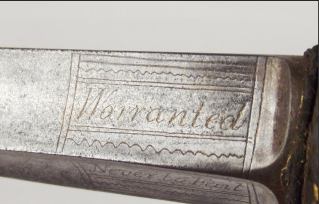

Old 21st September 2023, 10:44 AM   #19

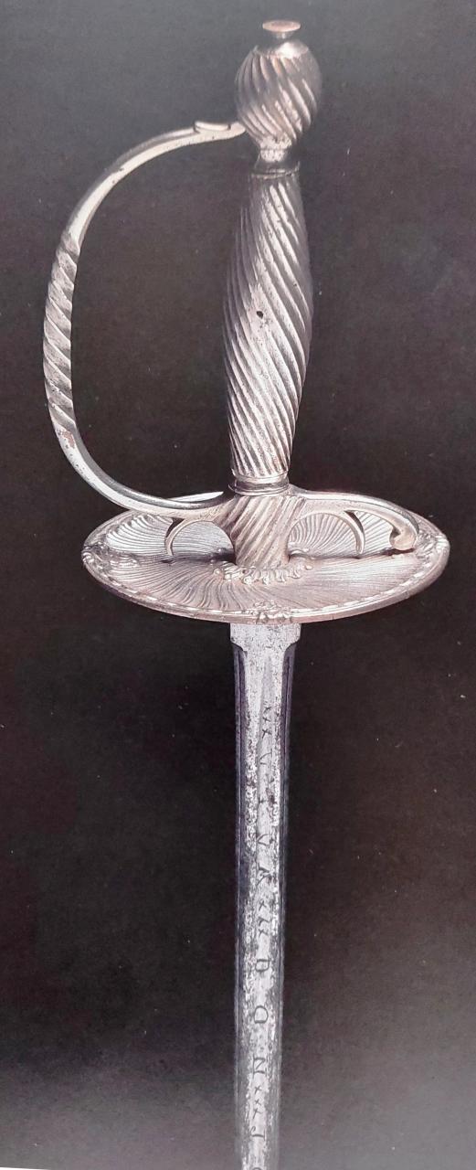

Say Keith, what do you think (or know) is the word/s in the blade spine, after "warranted"; not the usual "never to fail" ...
Old 21st September 2023, 10:57 AM   #20
urbanspaceman
Join Date: Sep 2017
Posts: 736
Default Gill
Hello Fernando.
It is a very unusual sword in more ways than one - to coin a saying from our vernacular.
I am enclosing a variety of pics of the sword.
The hilt is almost certainly from Matthew Boulton and is a work of art but much too fancy to suit active combat,
It also features a groove in the lower face of the blade which tells of a tale too lengthy for this thread.

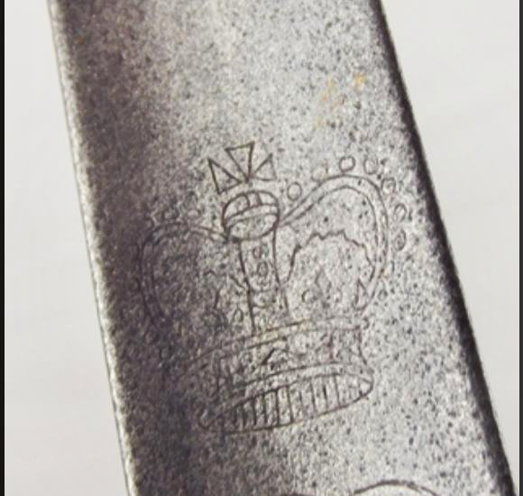

Old 21st September 2023, 08:18 PM   #21
urbanspaceman
Join Date: Sep 2017
Posts: 736
Default ps

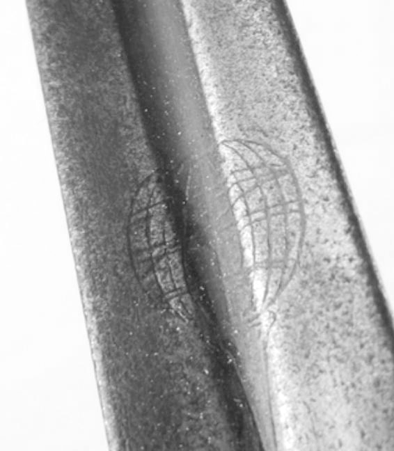

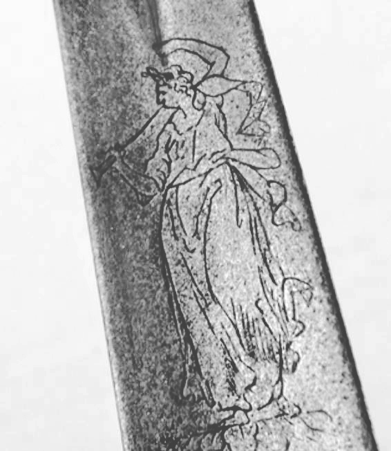

here's the last picture: this globe is at the top of a trumpet? in the figure's left hand;
apparently this figure is of some significance; anyone know what it represents? It's too early for Britannia Rules the Waves (1745).

Posts: 303
Why do you say it's too early if 'Rule Britannia' is from 1740? Thomas Gill Snr was born around 1743 and died in 1801. He is first listed as a file cutter and maker of watchmaker tools in 1767. It isn't until 1788 that we have a listing of him as a sword maker (along with other things).
On the balance of the evidence it's reasonable to believe that Thomas Gill didn't start making swords until the mid-1780s, meaning the figure could well be an early representation of Britannia.

Yes Radboud, you are perfectly correct; I don't know what I was thinking about... not thinking ....more's the case.
