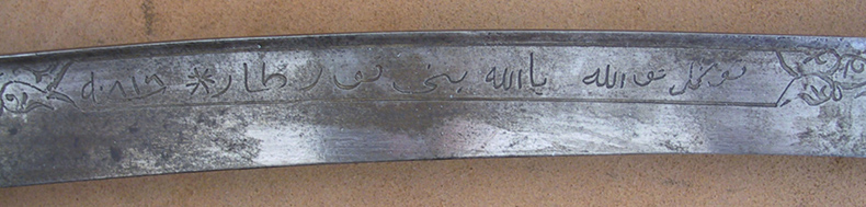

Well,
Just want to tell that this is not mine, it belongs to a friend here in Chania, so no jealous comments please...
Anybody can translate?

Hi efhitis,
the first inscription is
Tevekkeltu alallah ya Allah beni kurtar Sene 816 : I put all my trust to God, O God ! Protect (save) me. Year H 816/ Georgian 1413-14

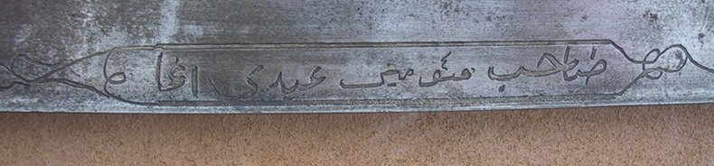

The second one is:
Sahib mu'min Abdi Ağa : muslim (or believer) owner Abdi Ağa

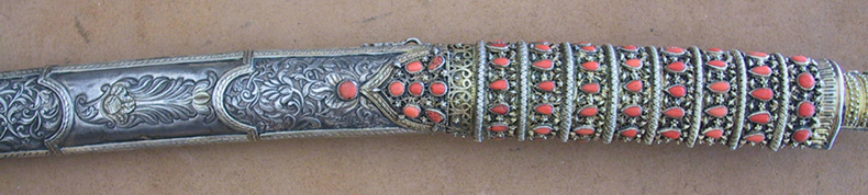

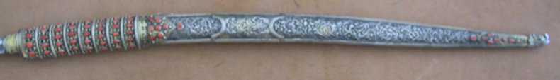

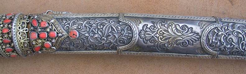

Posts: 7,415
Is there any way you could post the hilt as well?
Beautiful silverwork and coral gems.
Old 4th August 2006, 07:15 AM   #4
eftihis
eftihis's Avatar
Location: Chania Crete Greece
Posts: 517
Zifir, many thanks for the translation!
Battara, the hilt is for retoration, and i do not have photo, i will post as soon asit is ready.

Old 4th August 2006, 02:42 PM   #6
Zifir
Zifir's Avatar
Location: Istanbul
Posts: 228
I am definitely not an expert in paleography. Yet I can share a few points which attracted my uneducated gaze about the inscriptions.
The second inscription is a very nice nesih and it is possible to see documents, texts written in nesih for the early fifteenth century. Yet, the first one is a very indecisive script. It starts as a rika and ends with like nesih. Rika is a script which was widely used from the 18th century to the end of the empire.
The word "kurtar (meaning to save, protect)" is also problematic since kurtar is written with 'te' not with 'tı' in Ottoman Turkish. We cannot expect from swordmakers to be highly literate persons and punctual about the spelling, but the person who wrote the script seemed to me following the turkish wovel harmony and assumed that kurtar should be written with a "tı".

Old 9th August 2006, 01:52 AM   #8
Originally Posted by Zifir
Hi efhitis,
The second one is:
If your dating is correct, this makes this Yataghan ~150 years older than the one belonging to Suleiman Kanuni (By Ahmet Tekelu) considered to be the oldest known example. I doubt it very much.
Old 9th August 2006, 03:42 AM   #9
Zifir
Zifir's Avatar
Location: Istanbul
Posts: 228
I can say for sure that the script in the first picture has nothing to do with the early fifteenth century. I think the original script was the second one and the yatagan had no date. It is highly probable that someone later added the first script and the date.

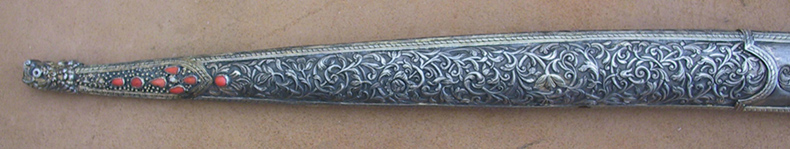

Old 9th August 2006, 11:39 AM   #10
I will sleep better
The entire ensemle looks 19th century to me and the blade is far too pristine for 15th century. I agree: latter addition of the inscription and a bit exaggerated to boot.
Also, the middle panel of the scabbard looks somewhat different from the rest. I suspect it was "renovated'.
