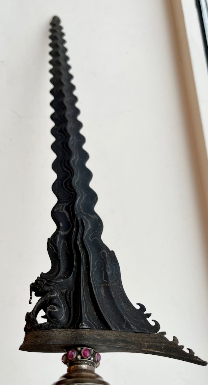

I have taken the liberty to post this Balinese keris photo of a friend. Can anyone advise what is the motif? It does not looks like Ganesh.
Could it be Lembuswana which is a unique Indonesian mythological creature.
Old 14th March 2023, 12:56 PM   #2
Posts: 7,297
In all the depictions of Lembuswana that i am seeing the tusks always seem pretty prominent. But i agree that this does not seem like a depiction of Ganesha.
It's a beautiful and unusual keris.

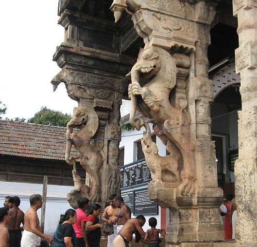

A type of Yali, perhaps?
From wikipedia:
Yali (Tamil: யாளி, IAST: Yāḷi),[1] also called Vyala,[2] is a Hindu mythological creature, portrayed with the head and the body of a lion, the trunk and the tusks of an elephant, and sometimes bearing equine features.[3]
That said, I know nothing about whether that fits with what we know about what figures are depicted in Balinese hinduism as it relates to the keris. I don't know if Yali's feature in Bali at all and I've never seen one being depicted on a keris, but again, I wouldn't know.
Whatever or whoever this figure is, as we've seen many times on this forum, in absence of glaringly obvious features or by-the-book details by a craftsman intending to do faithful depictions, it can be difficult and sometimes impossible to know for sure unless we ask the maker themselves.
Nevertheless I'm interested to see whether this can lead to a positive ID of this figure so that I may learn more about it.

The idea of "Yali" is certainly a part of Hindu mythology, there are a number of different types of Yali, and they serve a number of different functions, they also have a number different names.
However, Bali-Hindu is not mainstream Hindu.
I do not recognise this figure under discussion, I do not know of the representation of Yali in any of its forms in Balinese art or mythology. This does not mean that such representation does not exist, it only means that I have not encountered it in Bali, and I feel that if it does exist in Bali, I probably should have encountered it.

For me, one very troubling feature of this keris is the obvious replacement of the gonjo.
The material used is not at all what I would expect to see in even a halfway competent restoration, it looks more like a deliberate attempt to deceive:-
old keris often have the gonjo replaced so let's make that replacement so obvious that even Blind Freddy cannot miss it; & they sure managed that:- spongy, half washed iron, deep acid aging.
Too, too obvious. But maybe only to somebody who has had close contact with the Shonky Boys in certain markets of Central & East Jawa.
But then again, I do tend to doubt almost everything.
It would be useful to see the entire blade & together with its dress.

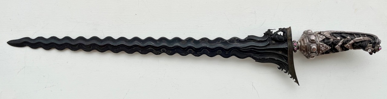

Hi All
rest of available photos, pics not mine and courtesy of the owner.
Old 16th March 2023, 02:06 AM   #11
Posts: 7,229
Thank you Anthony.
That does not look like Bali to my eye, 35 conventional count luk?
Then the sogokan with luk?
Not a real good idea to diss Siwa. Not good at all.
come on --- pull the other one.

Thank you Anthony.
Nice one Alan,
Possibly the punchiest and best comment I've read on this forum thus far! Yes, not a good plan to diss the Destroyer (or the Renovator as I prefer to refer to Lord Shiva) !
SidJ is offline   Reply With Quote

The inspiration for this specimen, so it seems, can be found in Hales book, p. 125, Nr. 306.
I agree with everything Alan has said regarding it, would like to add an observation about Pamor. There are only three layers of Pamor material on a side, which is absolutely OK for Bali/Lombok Keris - but this Pamor material is very thin, very uniformly thin, and of very uniform consistence/colour. It seems, whoever made it, likely did have access to prefabricated (in a Western way) material in plates/sheets.
I know of at least one Keris with long Sogokan following Luk, which is genuine Bali. It was taken after the Puputan in Denpasar in 1906. I have seen a couple of other old Keris with this feature, but they could also have been from Lombok.

The number 11 is significant in Balinese society and in pre-Islamic Javanese society as the number associated with Siwa, and with a ruler, the representative of Siwa on earth, as the appropriate number of roofs on a meru dedicated to Siwa, and also to a ruler, not only upon the ruler's personal temple, but also upon his bale, the cremation tower.
If we can assume that the ornamentation on the keris in your possession was placed there at the time of manufacture --- & I believe we can assume this, since it is the foundation for kinatah work --- then this would seem to indicate that the keris itself was made in Sumatera, if indeed this ornamentation can be confirmed as being of a Sumatran style current in the 1500's.
The keris Si Ginjai was supposedly made by Empu Kinom & was gifted by Sultan Agung of Mataram to the ruler of Jambi in the mid-1500's by Javanese dates, or if using the Western system of dating, the first half of the 1600's.
It seems to be generally accepted that it was after this gift of Si Ginjai that the Modern/Islamic form of keris began to proliferate in Sumatera.
If all the above is so, ie, that the keris in your possession is a keris of Sumatran manufacture that dates from the early 1600's or earlier, then this does indeed seem to indicate that we all need to have a little bit of a re-think about the recorded history of (probably) the Archipelago in general.
However, it is --- to me at least --- quite understandable that we do find many more keris with a proliferation of luk from locations outside Jawa/Bali, than we find originating from Jawa/Bali.
