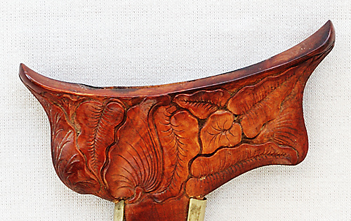

I have often been amazed at the variety in the dress of Keris coming from Madura.
I wonder just how many different types of Keris dress can be identified with a Madura origin?

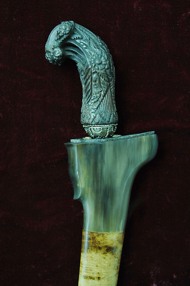

Old 17th September 2006, 04:18 PM   #2
Alam Shah
Alam Shah's Avatar
Join Date: Jan 2005

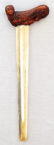

Location: Singapore
Posts: 1,248

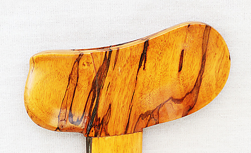

Default Another...

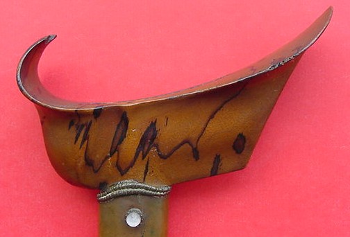

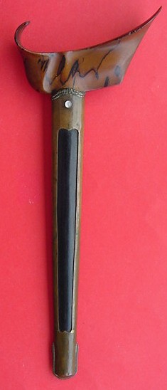

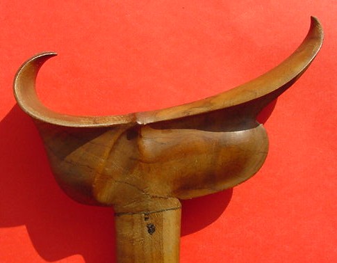

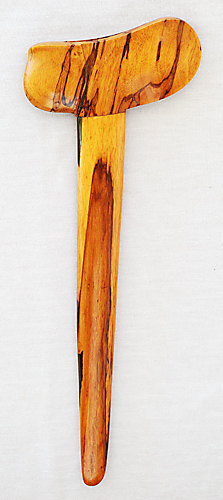

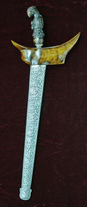

Another Maduran form.

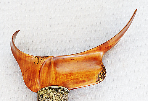

Old 17th September 2006, 05:27 PM   #3
VVV
VVV's Avatar
Posts: 1,637

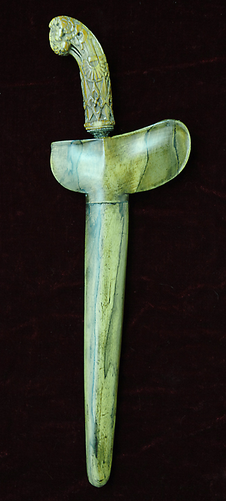

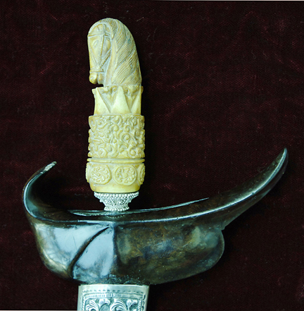

The Gayaman sheath, Solo version, is also seen sometimes.

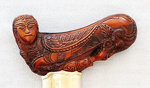

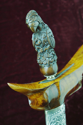

Old 17th September 2006, 05:45 PM   #4

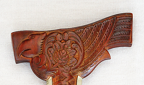

Posts: 6,436
Default Another Gayaman

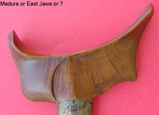

This combination seems to have been together for a long time .
The pesi is wrapped with human hair.
I've never had this one apart; I'm kind of superstisius about this one.

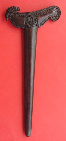

Old 17th September 2006, 08:39 PM   #5
Freddy
Freddy's Avatar
Posts: 830

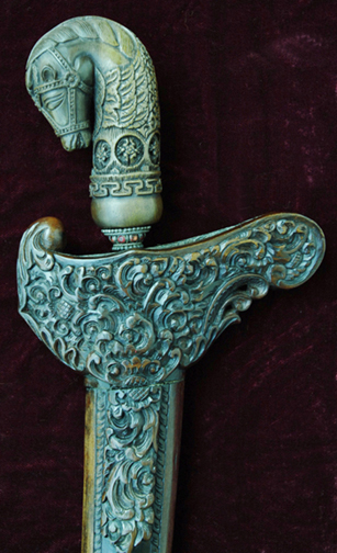

Thumbs up Another Maduran form

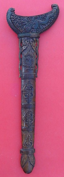

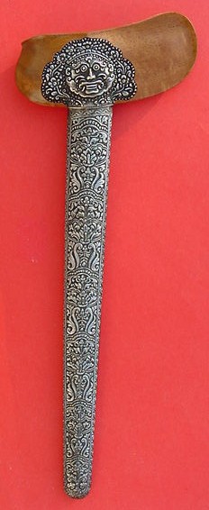

Here is a Madura keris in my collection

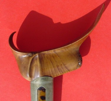

Old 17th September 2006, 11:30 PM   #6

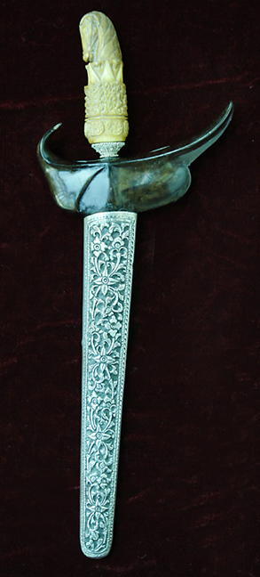

Posts: 7,297

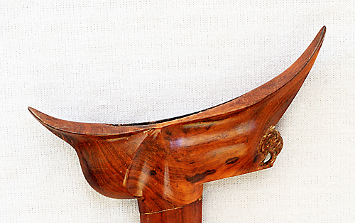

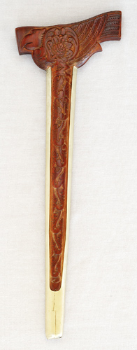

Here are a few more examples. Please excuse the image quality, as i shot these very quickly on my porch this afternoon :

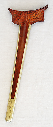

Old 17th September 2006, 11:40 PM   #7
Posts: 7,297

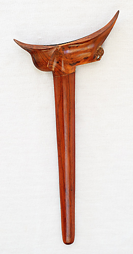

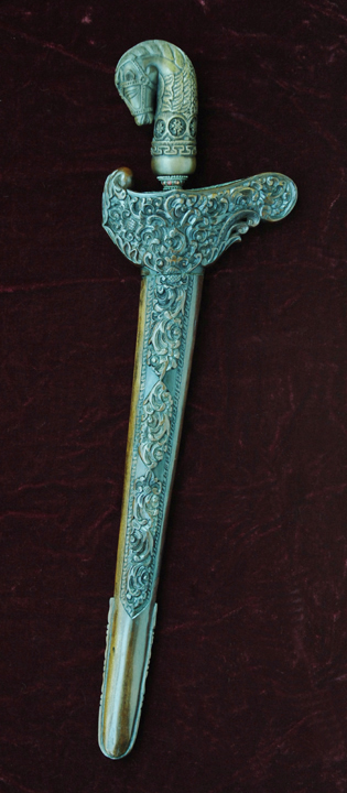

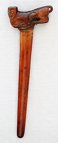

Here are three patrems from Madura in three basic sheath forms:

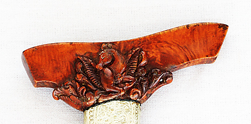

Old 17th September 2006, 11:41 PM   #8
Posts: 7,229
Yes, I have also often wondered at the variety in Madura wrongkos. There`s a lot of variety in the handles too.
Regarding the photos that have already been posted:-
VVV--- I don't think this is a Solo style wrongko, it appears to me to be East Jawa; Madura is of course a part of East Jawa. The handle looks like an old North Coast one, not Madura.
Rick---why do you think this is Madura dress? The wrongko is Jogja, although the handle is Madura.

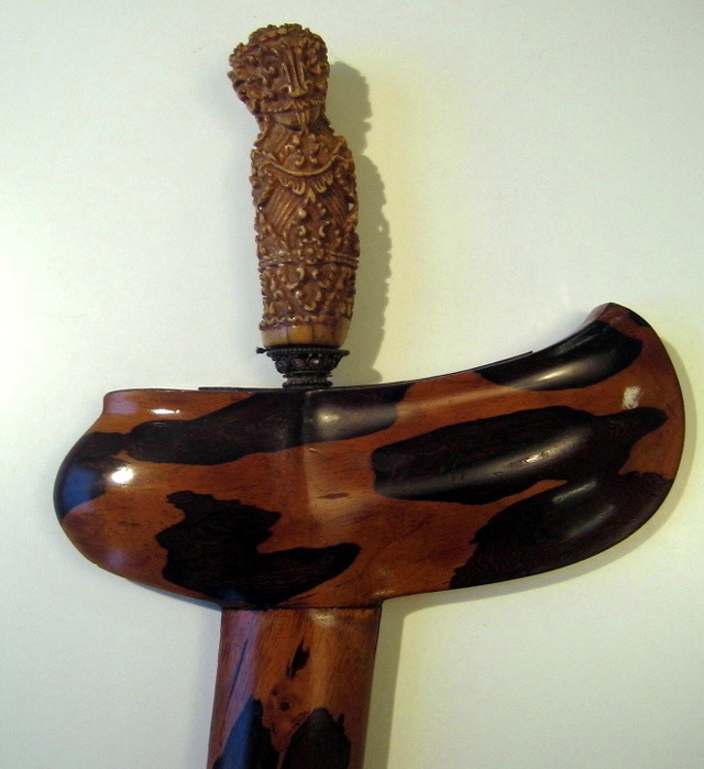

Here are few Madura wrongkos from my own collection. I`ve left handles and blades, and mendak out of it for the time being, to allow us to focus on just one element of dress at a time.

And a couple more.

[QUOTE=A. G. Maisey
Because the shape is so similar to the one you present as Madura and the one David also presents . I perceive a similar certain lack of 'belly' on the left hand end .
I guess I need a finer eye to discern Jogya gayaman wrongkos from Maduran .

Afaik, from the pictures... Ladrang Madura, Gayaman Madura and Sandang Walikat Madura in general.
David, your 1st piece, the sheath form is interesting and a beauty (the bird hilt too.) Your horn Sandang Walikat sheath is exquisite.

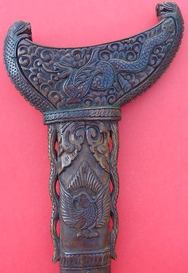

Alan, what are these type called? This one, the wings reminds me of the piece from Nagasasra's "Unusual Keris Dress from where?" thread.
http://www.vikingsword.com/vb/attach...id=13594&stc=1
This one, the central panel is typical of Maduran carvings, common especially on Donoriko hilt form. But its unique on this sheath form.
http://www.vikingsword.com/vb/attach...id=13613&stc=1

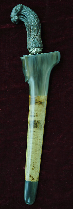

Here are a few more:

Posts: 7,297
Humanise David`s and again I see a fairly substantial lady who is fond of food, and who could do with a bit of a bath and some make up.
Hey....wait a minute....a bath?!
That green tinge is bad color balancing BTW. Part of why i apologized for my picture quality. The horn on the sandang walikat is green horn, but the color isn't quite that green. Hey, maybe they all need a bath.
Alan is right, of course. There are lots of small subtle differences which seperate these sheaths as specific variations on a form.
As for the name game, i tend to agree with Alan, though i guess it helps to at least have names for the general form types. In that sense i would guess that my first two examples are ladrang forms (formal), the bone horse head patrem is also a ladrang form, the ivory patrem is gayaman and the horn sheath is obviously sandang. The problem with this though is that i have no idea which of these catagories some of Alan's pieces would fall into. Would the sheath with the bird w/the floral design in the center be a formal dress sheath. What about the one with the horse that is basically the same shape. To me the lion sheaths that are known to be connnected with keris taken home by Dutch soldiers appear to be based on a gayaman form. Do these sheath always have the Dutch soldier connection or were some made for indigenous consumption?

"VVV--- I don't think this is a Solo style wrongko, it appears to me to be East Jawa; Madura is of course a part of East Jawa. The handle looks like an old North Coast one, not Madura."
Alan,
Thanks for correcting my description.

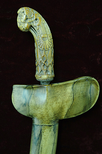

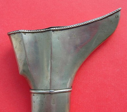

Alan, I knew that there would properly be a reaction with the photos of the mamas sandang walikat, and generally speaking it is perhaps more prevelent to say that the mamas wrongko is associated with East Jawa more so than Madura, but there is a fine line (and a short distance) on this one as I have seen many mamas attributed to Madura.
In my humble opinion it is sort of a "cross dresser" much like the wrongko's with Kala Langgam which as a Madura fashion can be seen in Bali, East Jawa, Central Jawa and even as an ornament on a presently listed Bugis Keris.
A few more:
Naga Sasra is offline   Reply With Quote
Old 19th September 2006, 12:31 AM   #24
Posts: 7,229
Yeah, those kala topengans seem to crop up all over the place, but although the motif is found in a number of places, the interpretation is always different. I have often seen pics of the Madura style attributed to Bali, which is understandable, because although it may be "made in Madura", the root is Bali.Just as with the bright yellow gayam style wrongko that I posted a pic of.
With the mamas sandang walikats, I have seen them, and owned them, with Madura blades, and Madura handles, and as Madura is a part of East Jawa, I don`t have any problem at all with recognising that we can find the mamas SW in Madura, just as we can find it in East Jawa, Central Jawa, North Coast Jawa---in fact all over the place.
However, going back maybe 35 years a very well known collector who lived in Malang, East Jawa, told me that this was a uniquely East Javanese form of wrongko. He may have been wrong, but he should have known what he was talking about , because of where he was based.I have never come across anybody in Central Jawa who wanted to give these wrongkos anything other than an East Jawa attribution.
A big problem with something like this is that we just do not know where it originated, when, or for what reason. We can't associate it with a kraton---which would make things easy for us. All we have is this pretty scarce form of wrongko that is a more or less Javanese form, but in metal.
On Madura you have two major centres:- Suminep, which has a Kraton, and Pamekesan which is a Kabupaten, or regency. The towns associated with these places are just like country towns. Suminep is like a little country town, but the area it governs is very broad, because it covers a lot of little islands.
The countryside in Madura is dry, and poor. Wages there are depressed, there is virtually no industry, tobacco is grown, cattle are raised, and rice is almost in the luxury class.This is today I`m talking about.
Take it back 100 years or so.
I have a wee bit of difficulty in thinking of these mamas wrongkos as the product of a place that would have been essentially a poor, rural area.
A short journey by ferry from Madura we have Surabaya. Big, populous, lots of industry---currently drowning in mud from an uncapped oil test drilling. Been a big city for a long time.
These mamas SW's are never gimpy, cobbled together things---at least not in my experience---they show precision and skill in manufacture. The type of precision and skill one would expect to find in a city like Surabaya.
On the other hand, the keris fittings from Madura demonstrate lavish detail in carving, the type of thing that artist/farmers can do when they are filling in time before or after work, or in between seasons.
To my eye, the stern simplicity of the mamas SW just does not fit into the Madura artistic template.
But it does look like the product of advanced metal working techniques.
OK---here`s one of those hypotheses that I dislike so much:-
mamas sandang walikat wrongkos were possibly initially manufactured in Surabaya, and exported to other parts of East Jawa, including Madura.

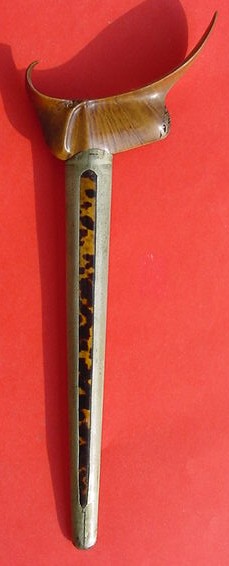

Mamas Sandang Walikats.
The problem with attributions is, a large percentage of them are inaccurate in nature, that be weather from published Keris literature and most often from sales catalogs, including those from the larger specialty auction houses.
That said, your logical explanation of the Maduran artistic template is well taken, and I for one would tend to agree with your post and certainly honor the opinion of the very well known collector from Malang.
Attached a few more. One highly carved wrongko is quite common and of very recent make, the second one is more of a question mark, and I would really like the forums opinion on this one??

Posts: 7,297
That first modern example is quite nice. The Madurese knack for wood carving doesn't seem to have diminished much over the years.

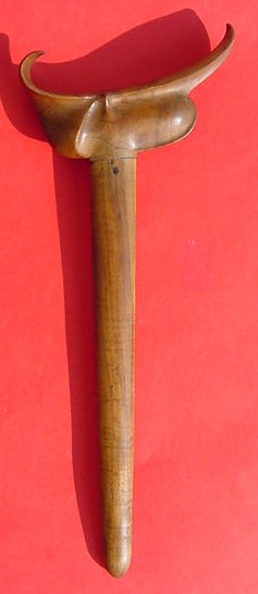

That second one is a puzzler. I can't say i have seen this style of sheath from either Jawa or Madura before. To my eye it is more like a cross between Bugis and Madurese forms. The pendok looks more Javanese to me though. Hopefully other will know better than i.
Old 23rd September 2006, 05:22 PM   #27
Alam Shah
Alam Shah's Avatar
Join Date: Jan 2005
Location: Singapore
Posts: 1,248
A similar wrangka... (ignore the fittings), what do you think.
Old 23rd September 2006, 09:34 PM   #28
Naga Sasra
Naga Sasra's Avatar
Location: Boca Raton, Florida, USA
Posts: 108
Yes, the Madurese has not lost their flair for wood carving and even though this is a decorative wrongko most likely made for the tourist trade, they tend to apply that unmistakable level of workmanship.
As for the second one, it certainly look like Shahrial's wrongko is from the very same culture, one thing noticeable is both of them have a pendok in the Yogya/Central Javanese older style with the top edge arched.
Shahrial, do you know the origin of the wrongko on your piece?

Old 24th September 2006, 01:23 AM   #29
Alam Shah
Alam Shah's Avatar
Join Date: Jan 2005
Location: Singapore
Posts: 1,248
Originally Posted by Naga Sasra
... wrongko is from the very same culture, one thing noticeable is both of them have a pendok in the Yogya/Central Javanese older style with the top edge arched.
Unfortunately, I do not know either. General discussions amongst local collectors had pointed in the direction of Pesisir, Java North Coast region.
Old 24th September 2006, 03:22 AM   #30
Naga Sasra
Naga Sasra's Avatar
Posts: 108
Lightbulb
I just read the entire thread from post number #1, if we look at post #9 the last two photos, look at the wrongko, imagine it without the leaf and flower carving.
Now is it my imagination, or is this wrongko formed just like the one from Alam Shah and mine as well?
