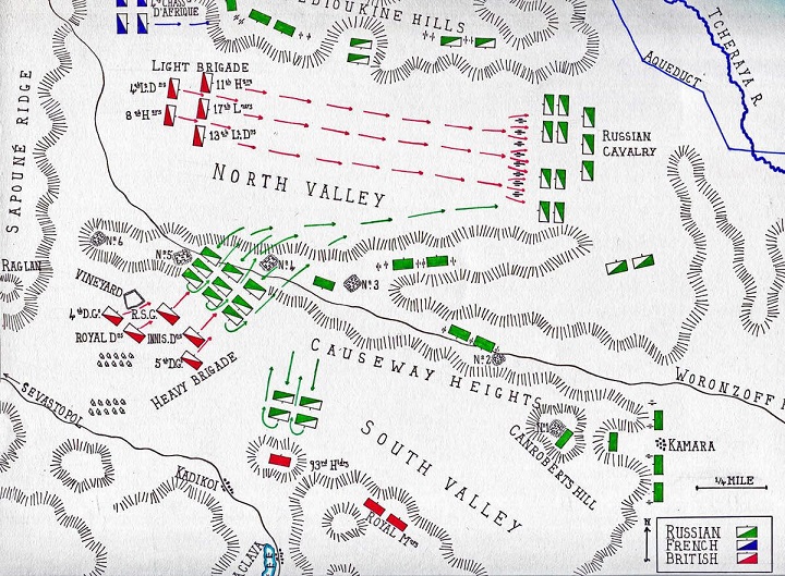

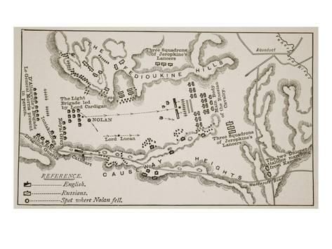

The fateful charge into the 'Valley of Death' resulted from an unfortunate misinterpretation of a written order from the commanding officer of the British cavalry which was carried to the ranking officer of the cavalry. There was considerable distance between them over notable terrain and the order was carried by a young officer who was anxious to begin the action.
The order had intended for the cavalry to advance and to keep the Russian enemy from carrying away captured British guns from redoubts to the right.
Not having the scope of vision that Lord Raglan had overseeing the entire valley Lord Lucan could not see what was meant, visually. When he asked the young aide 'what guns' , he frantically motioned ahead to the North Valley. While this seemed ludicrous to Lucan, as there were heavily armed positions on all sides there, he ordered the advance ...it was the order.
Though Tennyson's poem suggests the entire body of the force (600) were all lost. and while numbers seem varied, one of the largest losses were the horses, almost 475 killed. The men lost were 118 killed, 127 wounded, about 60 captured.
Despite the terrible carnage, many of the survivors were prepared to 'go again' however only 195 still had mounts, and they were told they had done enough for that day.
The order carried would have been held in a pouch which was slung from the same straps as held the saber scabbard, called a sabretache. This type of pouch would likely have held the fateful order carried by Lt. Nolan, the aide who was attached to the force despite being from another unit, 15th hussars.
The front line of the charge was the 17th Lancers, whose emblem was the skull and crossbones, motto "Death or Glory". The sabretache attached is of the type worn by them at this time and can be seen in some paintings of the charge (though the skull device not always discernible).
The 13th light Dragoons and 11th Hussars were also first line,
the second line were 4th Light Dragoons and 8th Hussars.

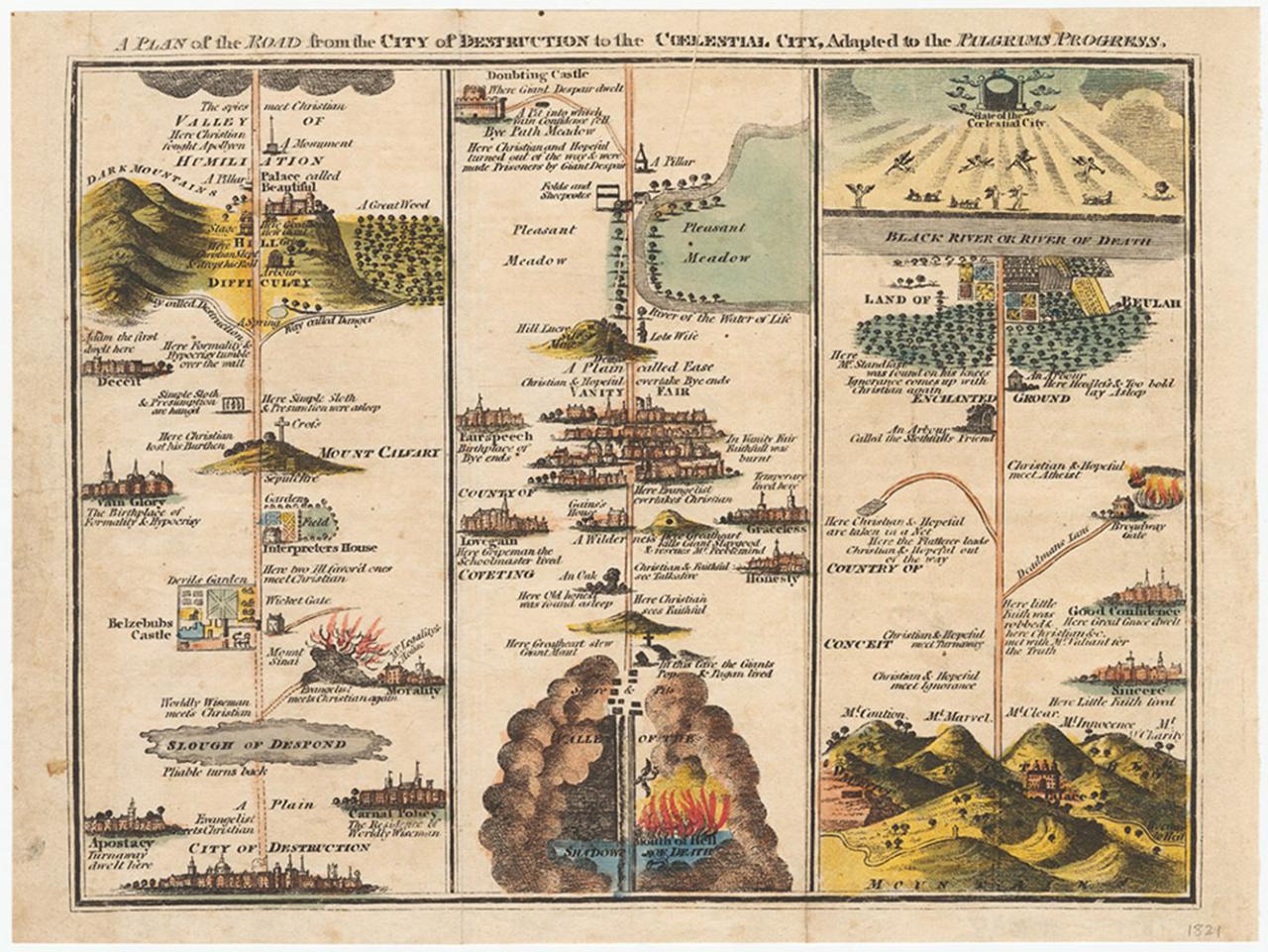

The Valley of the Shadow of Death is also where Christian spends a night and described in great detail in John Bunyan's 'Pilgrim's Progess'. Published
in 1678 and never out of print.
This allegory would have been known to every Englishman in the mid 19Cent.
It is at the bottom of the centre column.
Richard

Richard thank you for responding! and this is a great illustration of the allegory with this phrase, which is of course also Biblical. It most definitely brought forth the impact Tennyson intended with his 1855 work, which was motivated by his desire to raise funds to help wounded veterans. Many of the wounded were terribly maimed in battle, and in this debacle at Balaklava the graphic detail of the effect of cannon fire was devastating.

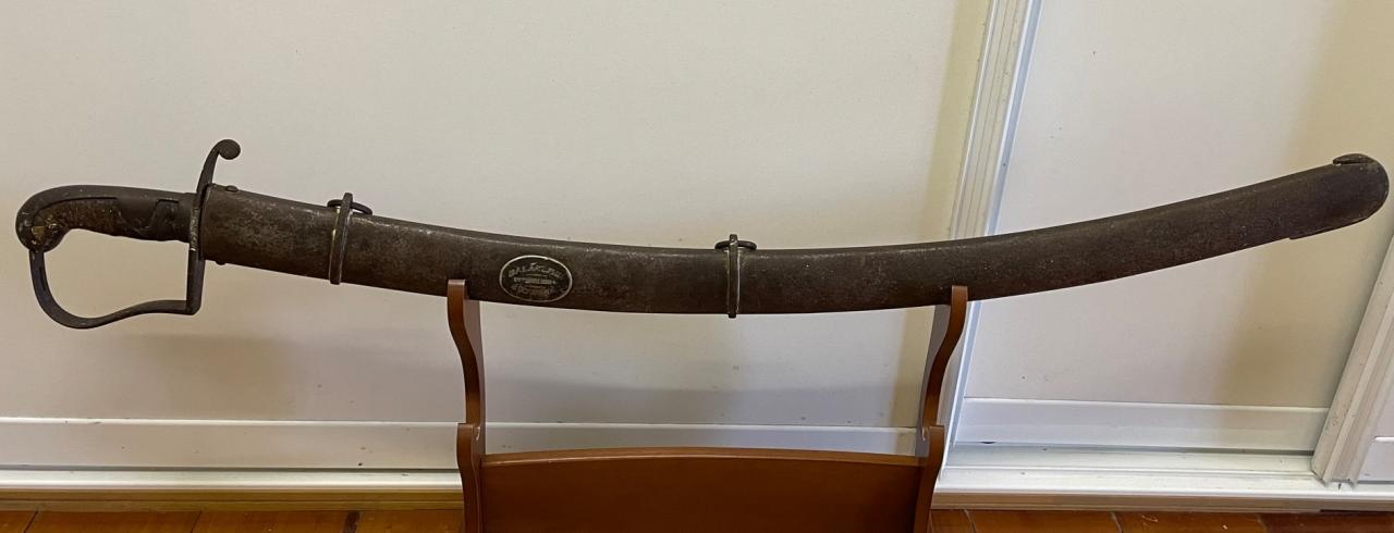

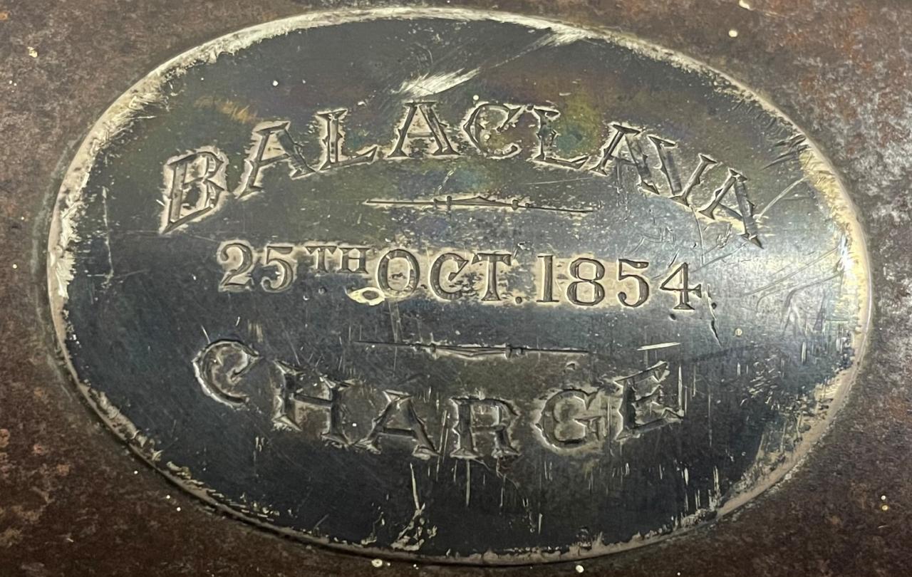

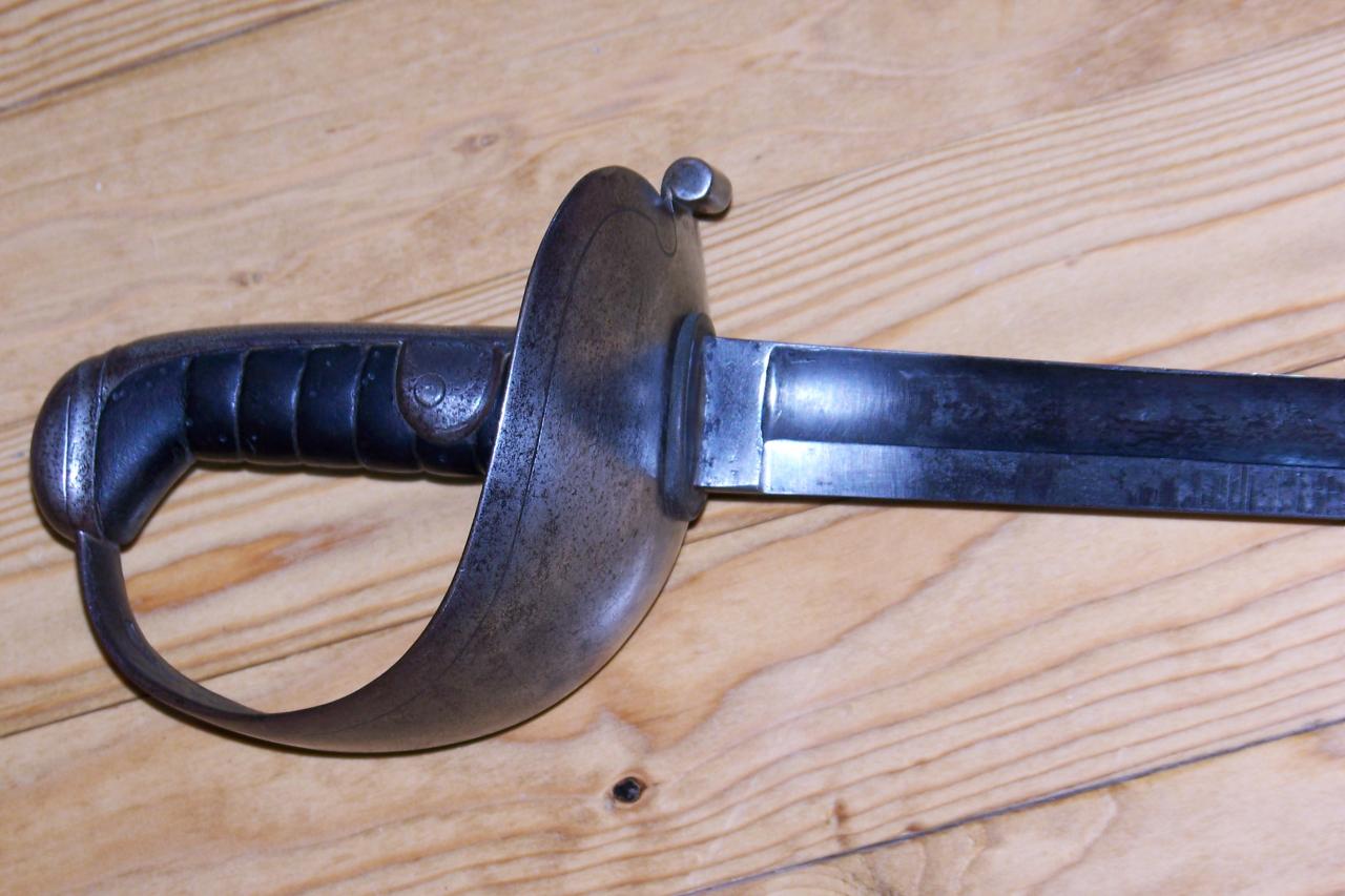

Jim I've occasionally seen souvenirs from the Crimean War at auction with old engraved plates or painted on. I've seen some horseshoes with silver fittings engraved.
Presentation swords of the Charge of the Light Brigade are the older 1796 pattern LC swords. Of course they could not use the swords they carried being current issue at the time.
I have trooper swords with correct early maker and inspection markings and regimental markings and would most likely have participated in the charges. I believe that is as close as one can get.

Robert and Will, thank you very much. After checking further in copies of "The British Cavalry Sword 1788-1912" (Richard Dellar, 2013) and "Swords of the British Army" (Brian Robson, 1985) I can recall some of the particulars on these light cavalry swords.
The M1821 light cavalry troopers saber indeed had a new type blade for both cut and thrust which was not with pipe back, while in many cases officers swords did have them. The production of these m1821 swords began in 1823, with about 6000 done by 1825. While there were some complaints about them by 1827, it was mostly about being 'too light' but the scabbards were most of the issue. It seems these complaints were finally set aside and the swords remained in use until the introduction of the M1853 (for both light and heavy cavalry troopers).
In these transitional times there surely was confusion on designations etc.
Richard Dellar discusses the 'Balaclava presentation swords' in a chapter of his book, and three of these swords which are all M1796 light cavalry sabers which all have oval escutcheons with "BALACLAVA OCTOBER25, 1854"

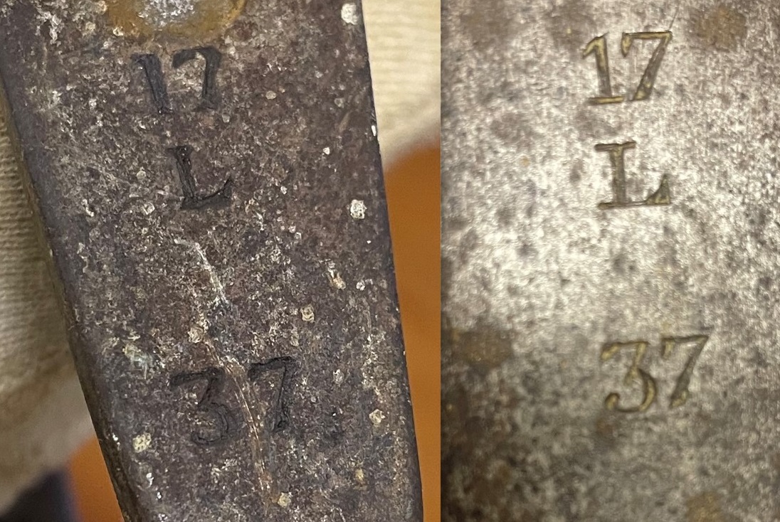

There are regimental markings on the guard bottom, two for 17th Lancers, one for 4th Hussars (4th Light Dragoons at time of charge).
It is believed these were likely issued by the Balaclava Commemoration Society, which was begin in 1875.
The unit markings it seems were intended to align with those of the men these were presented to, but do not seem purported to have been carried in the charge.
I agree with Will, swords with proper unit markings and other markings which set in correct period can possibly have been in the charge, but no way to prove without proper provenance.

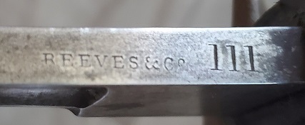

In Dellar (op.cit. p.120; 13.6, 13.7) a M1821 light cavalry saber is shown as by Charles Reeves & Co. of Birmingham, with notation of 'Reeves hilt' . It says this form is believed to have started in 1829, which is about the time some of the consternation on these swords was taking place, partly noting the hilts were of concern. I have always wondered what the number 111 was for.
It is tempting to think perhaps numbering in test examples but no record of such tests are recorded, and these remained in service until arrival of the M1853.
Interestingly Reeves held the patent for the 'sandwich' application of the new grips to tang of the new M1853 sabers. It has been noted that some of the first examples of these had blades from Solingen by the maker Kirschbaum, as in this example to supply to troops departing for Crimea (op. cit. Dellar, p.136, pl.15.9 showing knights head mark).

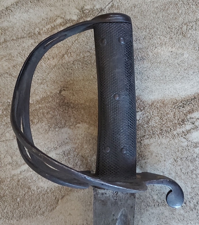

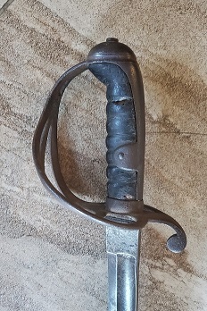

An 1821p HC 4th DG sword
Old 5th October 2022, 05:16 AM   #11
Posts: 10,867
Thank you Will! excellent example, especially with regiment markings.
These heavy cavalry versions of the 1821 swords are one of the tougher patterns to find, as I recall when I was collecting these back in the 70s.
It seems many of these ended up being repurposed into practice swords with rebated blades, and I think many in stores were lost in a fire in the Tower.
On the 25th, prior to the Light Brigade action, the Heavy Brigade was involved in action at Balaclava in quite a successful, as well as incredible battle against huge odds vs. the Russian army. With the Light Brigade advance into the North Valley the Heavy Brigade followed for a distance, but as the Light Brigade was decimated by the murderous fire from all sides, they were held back so as not to be lost as well.

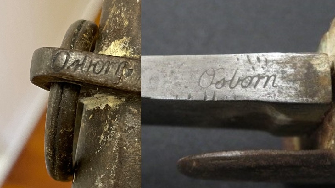

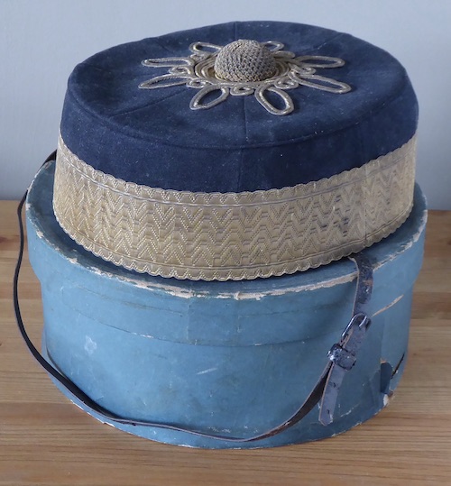

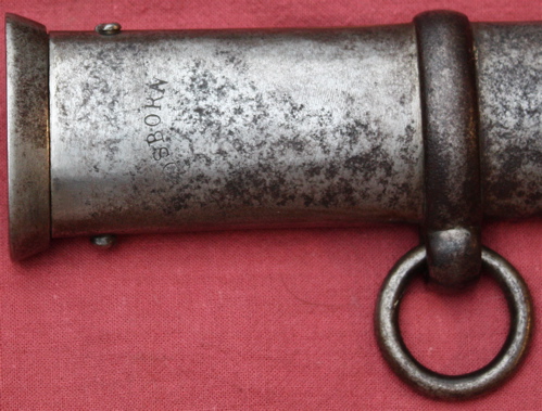

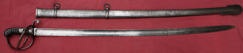

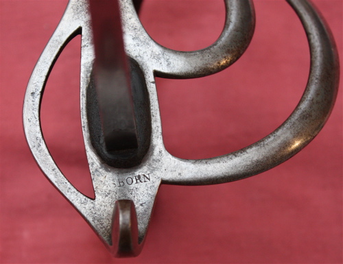

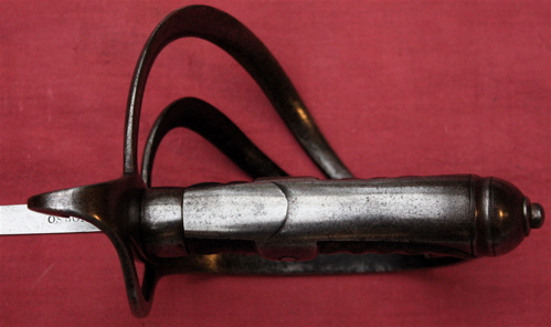

An 1821 LC sabre marked to Osborn, a mid Victorian regimental, Ayrshire Yeomanry, pillbox hat of the type common to the British Army of the time and a few photos one showing an 1821 pattern being worn and a retouched and coloured photo of Cornet Wilkin of the 11th Hussars. Both photos are by Fenton.
Norman.

Norman I've owned two 1821p LC troopers by Sargant , identical to the Osborn pictured with washer and tang peened over it. Also marked A/4. Both had 33 inch blades and were for the American market.

Hi Will,
With the sword in hand I'm sure it is a crowned 4 which is of course a British acceptance mark. My sword has a 35 1/2 inch blade and is 7/16 inches thick at the ricasso. The blade is sharpened for the first 25 inches plus 4 inches at the false edge. I've no reason to suspect that this sword is not British issue. Thanks for the info, I did not realise that these were exported to the U.S.
My Regards,
Norman.

This is an great M1821 example, and interesting with the Osborn markings. According to Robson (1975) this would date pre-1844 so was well in use by the Crimean War. That pillbox hat is amazing! I dont think I've ever seen an example of one of these.

It has been a bit confusing sorting through accounts of the charge in quite a few books etc. as I wanted to understand just how many guns were the Light Brigade charging into. The numbers and positions of some vary, but it does seem mostly the Russian guns were of course field or horse artillery.
As earlier noted, the original intent of the order to the Light Brigade was to 'advance' to prevent the Russians from taking away the British guns in the redoubts on Causeway Heights.....NOT to charge the Russian guns down the North Valley!
The British guns were in four of the six redoubts captured earlier in the morning by the Russians, and believed two per redoubt. These were 12 pounder naval guns from the British ships and actually hastily constructed using boards from those same ships. Manned by Turks, they were abandoned after while under attack, no British support was forthcoming.
When Lord Raglan ordered the Light Brigade to advance to these guns, the order went to Lord Lucan, who was with the Heavy Brigade but in command of the entire cavalry there. He could not see the guns Raglan referred to, and Nolan , the officer delivering the order, in frustration pointed to the North Valley without pointing out the guns Raglan meant were on the Causeway Heights.
The Russians were using horses and lasso to move the British guns in redoubts 1,2,3 in #4 the guns were spiked and thrown down the hill.
The Light Brigade advanced knowing they were going directly into a gauntlet of Russian guns, not realizing they were meant to wheel right to the Causeway, not continue in a suicidal charge. The Heavy Brigade as well as the Royal Horse artillery were following to strengthen the potential action at Causeway.
As they advanced, the Russian guns on the left on Fedouikin Hills opened fire, there were 10 guns, the Brigades were moving at a trot and the pace gradually quickened, then as the other Russian artillery at the right on Causeway opened fire. Ironically, these were in the positions near the redoubts where the Russians were removing the British guns.
As this crossfire continued , the Light Brigade pace was feverishly increased as numbers of men and horses fell;
The French cavalry at that time took out and silenced the ten guns on the left, the Heavy Brigade seeing the cannons directly ahead at the end of the valley could see the hopeless situation and dropped back to retreat. With the guns silenced they were under no threat on the return.
The Light Brigade however, now moving faster, though no charge was ever sounded, were being torn to shreds by the Russian batteries to the right, along with musket fire from the flanks. The cannon at the end they were now riding directly into were the 3rd Don Cossacks with 6 pounder guns as well as the formidable 12 pounders known as unicorns. They had been firing round shot but were now firing exploding shells as well.
Almost ironically, among the men who had made it into the battery, in the chaos and melee, some were preparing to take the Russian guns! as I found in one reference. They were unable to regroup, and Cardigan told them they had done enough when the men insisted they were ready to 'go again' What was left of the Light Brigade straggled back down the valley.
As was well said in one reference " this charge was glorified by a poet, not a soldier".
The tragic sacrifice had accomplished nothing strategically, and in most military histories of the Crimean War, gets scant notice in the overall study.

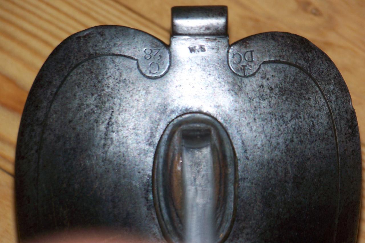

G'day Guys,
I was lucky to acquire this sword recently. It is a standard 1796 light cavalry trooper's sword maker marked to Osborn. What makes it special is that the scabbard has a silver plaque inscribed "Balaclava Charge 25th Oct. 1854". Both the sword and scabbard are also marked 17L 37. Richard Dellar in his book "The British Cavalry Sword 1788-1912" describes three similar examples. Two of these are also marked 17L and one 4H. Richard thinks 17L stands for 17th Lancers and 4H for the 4th Hussars and that these swords were presented to the survivors of the Charge of the Light Brigade. To date only these 4 examples have been documented. I have been searching for evidence that these 1796 sabres were presented to the survivors of the Charge, but haven't been able to uncover any new evidence. Later photos of survivors show them with all sorts of swords, but I haven't yet found a photo of a survivor with one of these 1796 sabres.
Cheers,
Bryce
