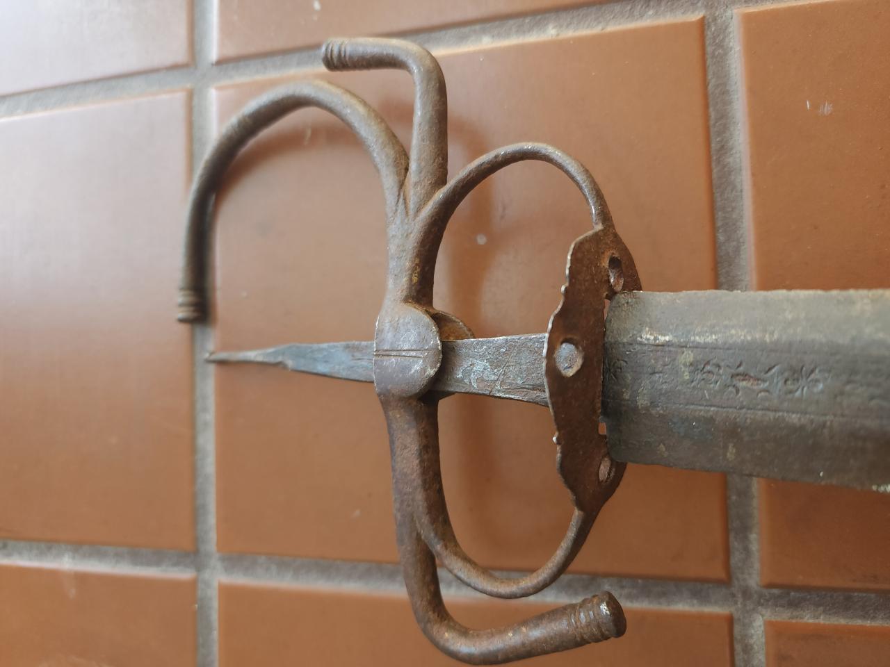

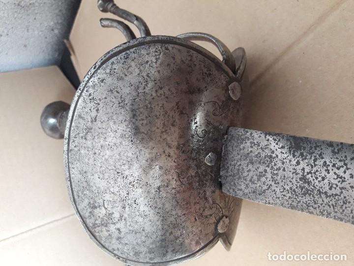

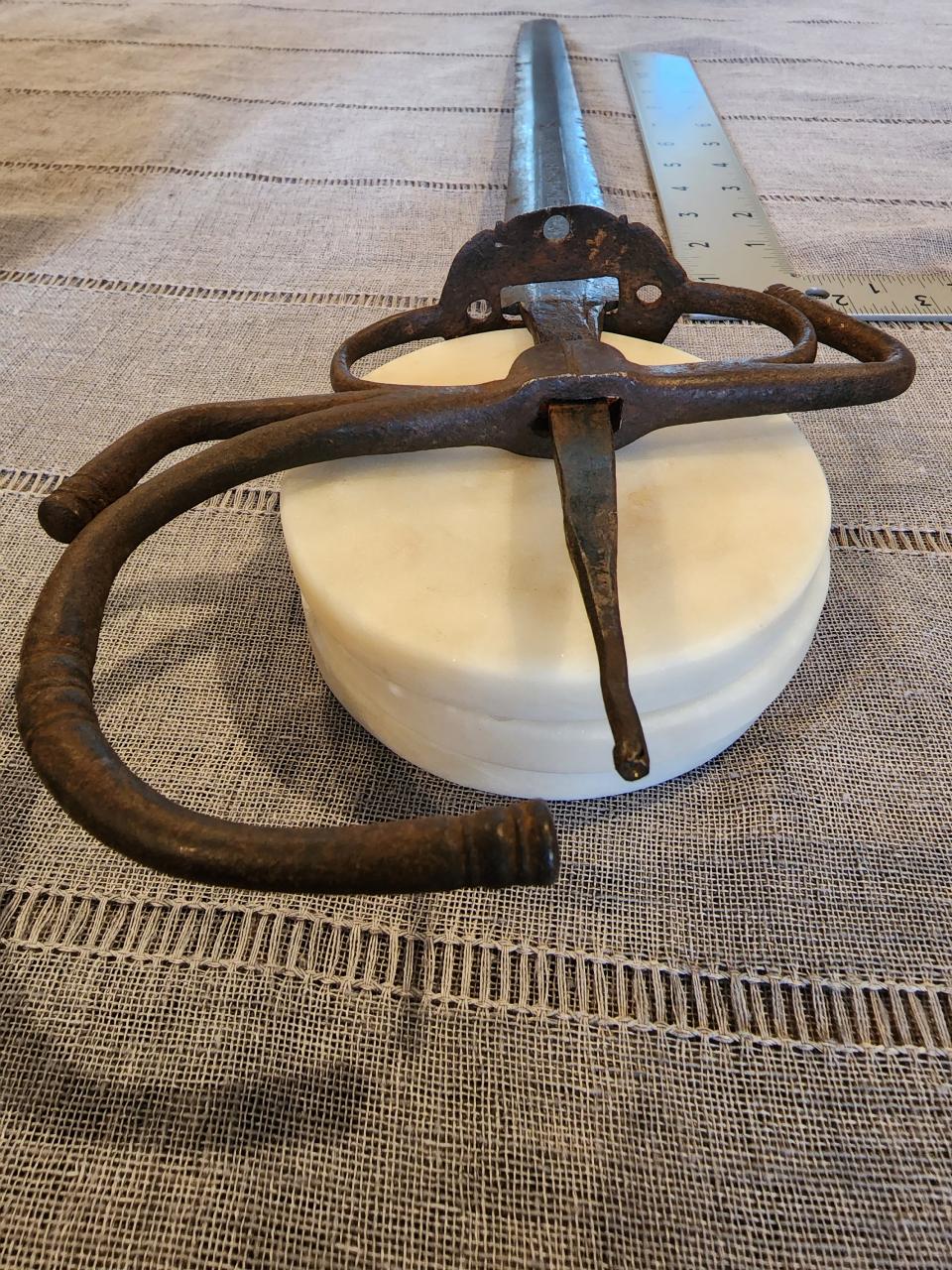

I recently received this sword of which is outside of my normal collecting area. Without having any idea of what kind it was, I later gathered that it likely fit the 1728 Pattern Spanish cavalry sword profile. The sword is in excavated condition, missing most of its components such as the hilt, pommel, and shell guard. The blade has an old break around presumably the halfway point of its original length and the edged are littered with contact slits and rolls. After researching some of the type, I had gathered a few questions that I would like to present here. Maybe others can add some information.
Firstly, of all the examples that I have seen either have two or four screw holes to mount the guard. With the examples with four holes, the holes are located in pairs on only two sides, opposite of each other. On this example, the holes are located at one each of the four sides. As this seems irregular, is this actually a pattern 1728, or a local version of the form?

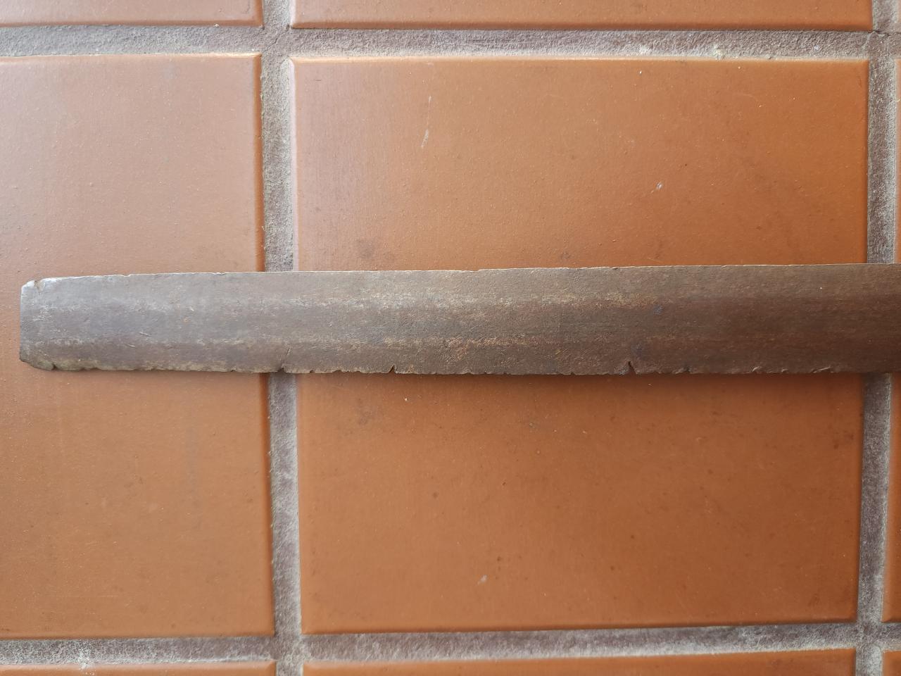

Secondly, I would like to know more about this rapier blade. Many examples are sourced Solingen trade blades or Toledo, ect. I could not locate another one with this type of maker marks or motifs. If I remember correctly, I have seen similar marks before which thought to be Italian, but I cannot find the source of that.
I understand that these were popular from the late 17th to late 18th centuries and made in various styles with different mounted blades, sometimes much earlier blades than the hilt. They were exported to many European countries and was very popular with naval units and privateers alike, especially in the colonial period of the New World.
Whether true or not, it was stated by the seller that this sword was found in Martinique in the 1950’s by the seller’s wife’s grandfather when he was working as an engineer there. It was approximately two feet deep in sand and this is all that was found, without locating any of the other components of the sword. It had been in that family for the past 70 years. If anybody could add anything about the type, I would greatly appreciate it.
Geoffrey

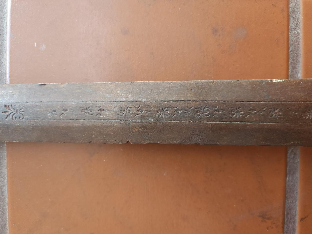

Unusual (not rapier) blade decoration, apparently not seen in these swords ? Could it have previously been mounted in a different type of sword ? .

this sword looks and seems amazing to me, looks like the sword got a tattoo somewhere exotic, to me looks like spiders or ants transporting eggs..
Is that what you see, Joe ? Weird !

I know right... but I am being honest.
what do you see first glance?
aside from the fleur de Lis on top.
(the fleur de Lis looks to me, a little zoomorphic like an, Aso)

We all have different eyes; some more imaginative than others !

There appears to be the remains of a pean at the end of the tang suggesting that the tang is complete. This suggests that the guard is not original to the blade since the shell mount doesn't fit over the ricasso and the remaining tang behind the quillons is far to short.
Robert
toaster5sqn is offline   Reply With Quote

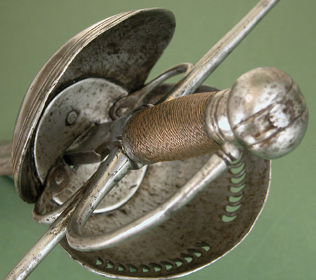

I agree with Robert; the blade doesn't belong to this guard. In the examples, I've seen the ricasso (in the correct meaning of the term) is straight-sided and there is a secondary shoulder where the tang goes into the grip:

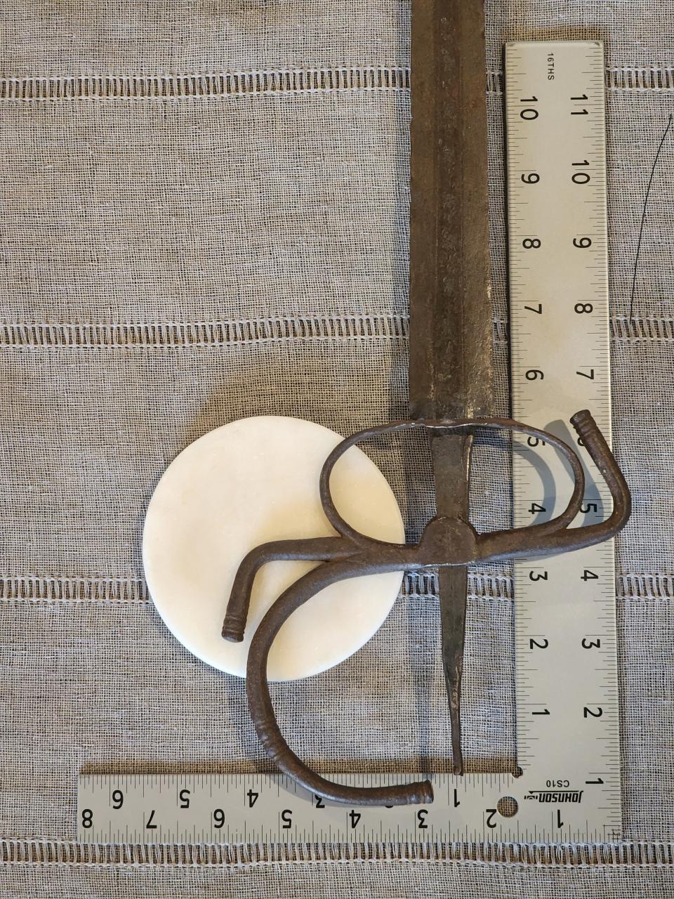

Thank you for your thoughts. The tang in total is about 5" where 2" is riccaso and the remaining 3" of grip/pommel. This does seem short, too small for me use but somebody with smaller hands possibly. What about the other irregularity with the location of the screw holes? Could this be a French/ Dutch replicated guard in the pattern 1728?

That's not a riccaso, it's just all tang. Remember there should be approx 1 1/2" of pommel on the end (the same length as is thinned down to round cross section at the end of the tang). If you replace the guard with a simple cross you will find the grip length is about perfect.
Also the slot in the guard should match the cross section of the blade at whichever step it ends but it's way to big for the tang and not big enough to go over the blade.

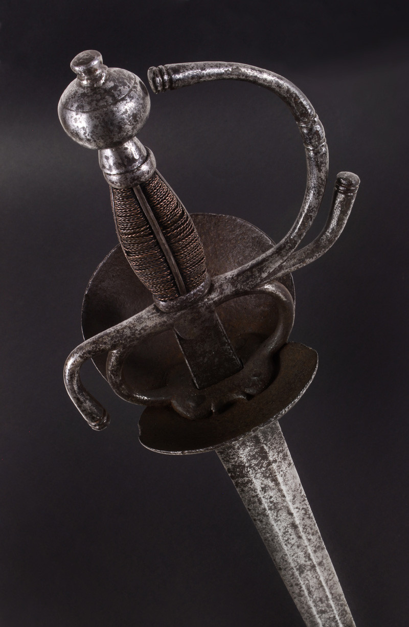

I'm sorry, but that blade and guard do not belong together. If you look closely at the 1728s I posted, their ricassos are clearly defined and properly finished.
The entire tang of your blade has a raw finish as if it was never intended to be seen.

As firstly suspectd that hilt and blade had different origins (2#) and now well established, we might speculate that, the person that digged both items would have found them in the same location but separated one from the other; could then infer that they would be originally set together (or not) and join them as if they so were.
Notably the blade would (also) deserve some ID; it sure is a peculiar and genuine early item... wouldn't you guys agree ?

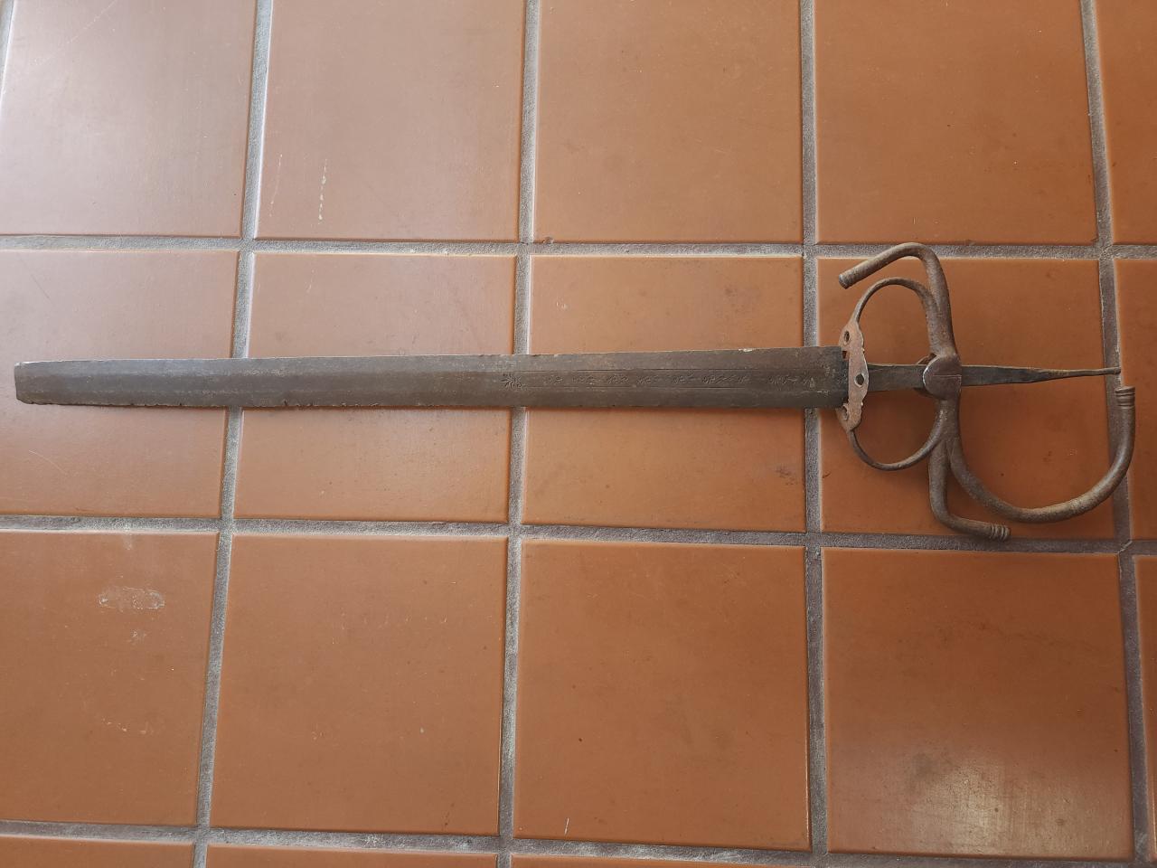

Fernando, that is a perfectly stated forensics perspective , and of course entirely plausible. I agree that this blade is a most unusual example of these early arming sword blades, and would warrant a look into other examples to compare. The decoration of course has nothing to do with makers marks but is filling aesthetic as often seen on colonial weapons.
It would seem there might be a reason for the apparent incongruity of these two contemporary sword components, which seem of comparable age and circumstantial consistency. In the colonies, weapons were constantly being reworked to maintain serviceability, and it is well known that large numbers of blades alone were part of the commerce aboard trade vessels. I know of numbers of wrecks in these areas in which boxes of blades were found, and of the period suggested for this sword (or paired components as it were). This is of course c. 1690s into years of 18th century.
I had thought that possibly the blade and guard component were perhaps in the process of being assembled at the time they were deposited into location perhaps during the volatile weather events known in these Caribbean regions. The thing is that the blade is clearly not one which would be in such process as it is broken and has marks of very rough existence already, not a pristine blade being used in remounting .
This suggests the blade was already mounted at the time it was broken, and perhaps the disassembly here was work in progress? The open screw holes seem to suggest that, typically there would be some residue of at least one instead of cleanly empty holes.
The fact that the aperture in the guard plate reveals disparity in the two components goes to the fact that it was necessary to use whatever was available, not necessarily exact matches in these colonial settings.
I have a sword from Mexico fashioned from components of three entirely different swords, and congruent fit was hardly a concern.
Possibly whatever components that once were with the sword were fabricated in this manner, and now gone, there is no way to know what the assembled sword looked like.Often these kinds of 'assembled' swords have been dismissed by purist collectors as put together by innovative sellers etc. But it would seem that such 'fabricated' efforts would at least try to approximate the sword as in original state.
It is certainly a mystery, which is in my view, the joy of studying items like this which come from such colorful periods in history. Though the 'story' of course is always in question, this one seems perfectly plausible as in the 1950s many of these Caribbean islands were relatively quiet and not heavily traveled.
It is well known that the dynamic storm activity in the Caribbean has often brought items up from wrecks on the sea bed, notably coins etc. and deposited them on beaches. In the same manner, items on beachfront can be moved about, and remarkably these two pieces remained in proximity. If the man who found them looked further, possibly the shell guard and pommel might have been found, perhaps not.
This sword (or components of it) in my view should be deemed as together with reason, not exception, and more research on the most complete item, the blade, should be carried further. While these blades with this section were present through the 18th century as 'dragoon' blades, notably on the so called M1728, later M1769 Spanish arming swords (called bilbo by the English)....these hilts and blades existed some time earlier, and likely into 17th c.

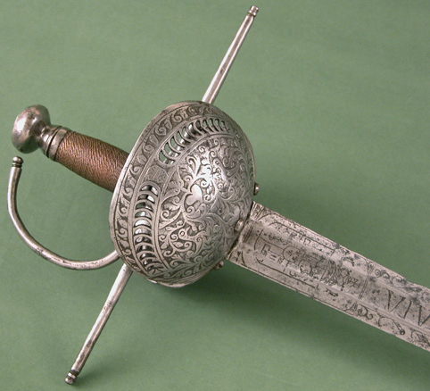

Think of the 'Spanish ' cuphilt.....while popularized by the Spanish, to the point of cliche', these were often made in Italy (particularly Brescia, Milan), and in limited degree some were German. I have for example one from c.1640, of Milanese style (per Boccia & Coelho) but I know the provenance, and it was found in France. It had clearly been where it was found for a very long time.

Ah ... the 'Spanish' cuphilt, Jim. Never miss the whole route. Look where you can find a unique example in the hands of an angel, on the top of a Portuguese church not far from my hometown.
Very true Fernando, and please pardon my inadvertent forgetting to specify the importance of Portugal in the legendary use of the cuphilt. Over many years here you have included valuable insights into many examples of these.

I believe both parts belong together.
Typical 1728s as the ones shown here are rather post 1760.
From the end of XVII century there were a series of experimental designs.

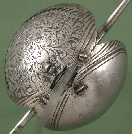

We have to think that boca-de-caballo swords in aspect evolve from the two shells Brescian hilts, and eventually from the Pappenheimer.
http://www.vikingsword.com/vb/showthread.php?t=27384
But as a construction, because of the use of screws, they are related to cup hilts. And there are cup hilts with screws but shaped as Brescian hilts.
Initially boca-de-caballo swords had only two screws, but this made the two shells prone to colapse and break at the middle of the line between the two screws.
One of the solutions was to add a second set of screws at the sides with a reinforcement piece (later was welded to the pass de ane). I call these rhomboidal 4 screws hilts.
The blade seems to come from the same Solingen workshop as the "Enrique Coel" blades, just with no lettering.
I would not wonder too much on the Martinique subject. We know cavalry swords were sometimes embarked in the Spanish fleet, and the Royal Armouries at Leeds has a bilbo captured at Trafalgar. Any shipwreck could carry the sword to the island where most probably was used as a machete.
That the square has more room than needed for the ricasso is not new, as the structure is there to hold the shells not the blade.

I believe both parts belong together ...The blade seems to come from the same Solingen workshop as the "Enrique Coel" blades, just with no lettering...
....And as for the atypical decoration; a later work, under onwner's commission ?

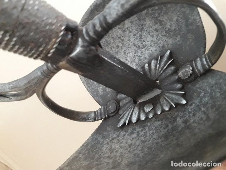

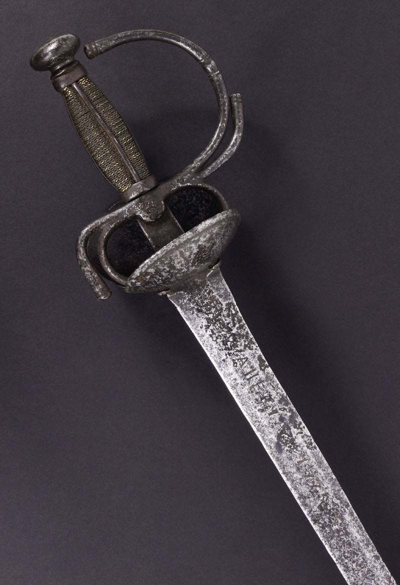

My experience is that the later the 1728, the more similar blades you find. For example, there are 4 different "Enrique Coel" formats, three of them common. Probably they are batches ordered in different years. In what I think are boca-de-caballos from the later XVII century, you do not find two blades alike, and blades from 50 years earlier or more are not rare.
Sometimes they do not have a real ricasso and it is just a tang. And sometimes there is a brass piece covering it.
At the end of XVIIth century there is fashion for flower scrolls at the sides of the blade channel. I suspect this is an Italian fashion and did not last long. Possibly they did anew on older blades too. In a simile, Victorians engraved often flowers on plain Georgian silverwares, for example.

The decoration looks to me like a specifically Rococo version of a fleur de lis with a running knot and ribbon, or knotted vegetal motif. We can also see the decoration continuing onto the tang for half an inch, which may be an indication of good quality craftsmanship.
My other thought is in regards to the edge damage. Usually I'm of the opinion that so called 'battle damage' is simply the grandkids destroying antiques in the back garden, but I'm interested in the different angles and depth of penetration on this blade. It speaks to me of close quarters fighting with both head and body attacks. If it is what it appears to be, then it's very interesting to see, because most weapon damage gets cleaned up after the action is over, unless of course the weapon is lost or discarded, as this one may have been.
