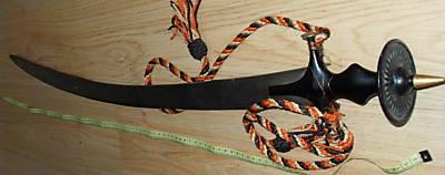

Hi All,
Looking for some practical ideas on this one. This was described as an 'Arab Sword' with 'teeth marks' on the blade. It was removed by E-Bay U.K. because it had a curved blade longer than 18 inches (U.K. knife and sword legislation 'anomaly'). To cut a long story short I bought it privately very reasonably which might be just as well but you never know! As you can see from the sellers photograph the hilt has been painted and the blade may or may not have been varnished. The question is what to do when I get it i.e. the best way to remove aforesaid paint and varnish? Thanks for all and any replies.

Hi Norman ,
it really depends on the type of paint. The hilt appears to be 'sprayed' ....so likely cellulose or acrylic ...spray 'thinners' on a cloth would probably work well ....mind bare hands though...this stuff removes natural oils from your skin (almost instantly) ....Oh and no smoking whilst you clean highly inflammable....although flames and heat will also do the trick (if you do decide to ignore the warning)
Nitromors (trade name), a paint stripper available from DIY stores will also do the trick but is likely to slightly discolour the surface of the metal below (caustic reaction lifts the paint, nasty stuff if you get it in your eyes and chemically burns your hands)....brush it on leave for a few minutes...the paint /varnish/lacquer will react and sort of 'bubble' , use a stiff nylon brush to rub off the paint....may need further treatment to remove 'stubborn areas' though.

Hi David,
Thanks for the info. I'm thinking, from what you've said, regardless of which method of paint removal I use the metal will react to some degree or other. I suppose the first thing, after receipt, will be to post photos and get some opinions as to the age and quality of the piece as a whole and that may determine a particular approach. It looks as if it may be a nice piece but as we are all well aware sellers photos can be 'misleading' at times. Thanks again.
My Regards,
Norman.
P.S. I've had a particularly nasty run in with caustic soda so I'd be happy, if possible, to give anything along those lines a wide berth.

Hi Norman,
when I said 'caustic' I should have said 'alkaline'. I suppose the effect on the metal surface would be akin to an etch with ,say, vinegar. The 'thinners' is a solvent and would not react with the metal, but can be a little messy, but it works extremely well. I have a Finnish Puukko which some fool had daubed with red paint (all over the curly birch handle.) Thinners and several cloths later, I easily removed the offending paint without damage to the birch Hope this clarifies things.

Hello Norman,
I think you got nice and lucky!!
I don't know if you can get a product over there called "Circa 1850 finish remover" (or something close to that)
I've found it works awfully well and doesn't even eat your hands. It doesn't discolour metal and removes most paint. I have used it on a gun painted gold all over, and on another painted black!
I just applied it pretty thick, let it sit a few minutes, then rubbed it with fine wire wool. Don't appear to have to wear gloves but it might be smart!
I once used Polly-stripper on something and got some in my eye, it felt like a cat was in there clawing to be out!
Old 14th March 2009, 05:33 PM   #6
Posts: 6,442
If you are going to use a solvent based remover you might want to protect the mastic that holds the blade in the hilt . There's always a chance it may soften along with the paint . You might want to melt a little paraffin wax and paint a few layers of it over the mastic .
I would think any decent gel type paint remover will do the trick quite well .

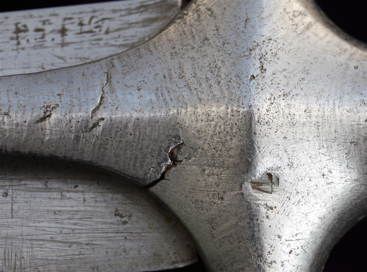

Hi,

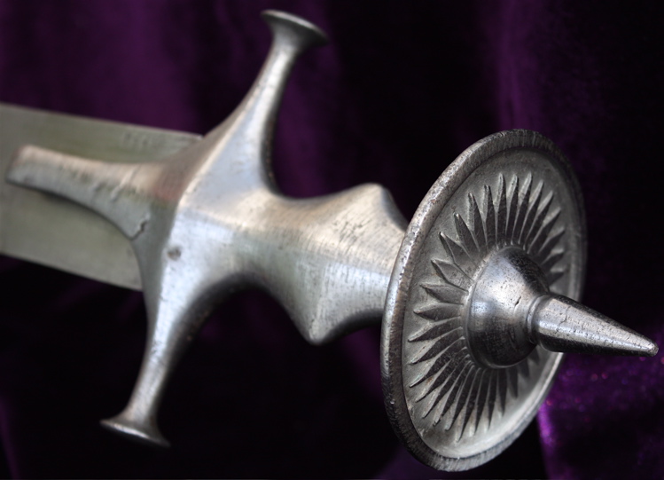

Stripped the hilt and I am very pleased with the results. David kindly suggested an early 20th Century date on the basis of the previous photos, looking at these photos do you think it might slip into the 19th? The removal of the paint revealed a 4 stamped into the hilt, any suggestions? There also appears to have been numbers/letters stamped into the blade at the hilt but unfortunately they seem to have been lost. Any ideas welcome.
Norman.

Hi Norman,
I don't see anything that would suggest a date later than mid-19th century really, other than the blade doesn't look to have been re-sharpened as have many.
If I guessed, I'd say 1850 -75.....but there are many here who know more than me!
Armoury stamps suggest this isn't a real late piece.
Best wishes,

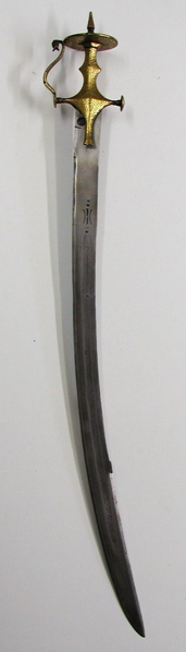

Old 26th March 2009, 12:58 AM   #16
Norman McCormick
Norman McCormick's Avatar
Posts: 1,657
Side by side.

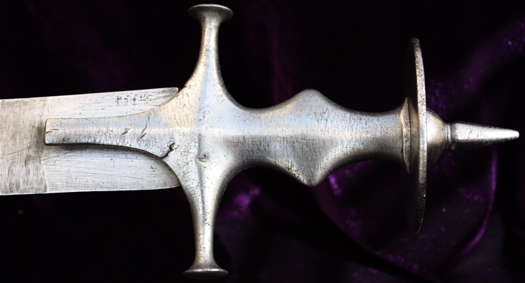

Hi Norman,

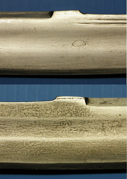

There is something which I did not show you yet, and that is that on my blade, the two sides are different. I believe that one side is mono steel and the other side could be wootz, but I have not yet tried to prove it. Blades like this are fairly rare, and I find them very interesting.
On the other picture you can see the result, before and after I used the Dremel.
Jens

Hi Norman,
Jens
Excellent work Jens!
May I ask a question though?
How do you get a 'flat' surface with a dremel 511?
How many did you go through on one blade?
Do you finish with paper on a flat block?
your results are impressive.
Gene

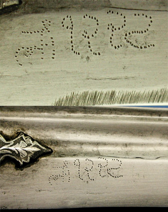

First of all, Norman, my congratulations to your daughter as well!!!! and to you, you deserve to be unabashedly proud!!!
Great contributions on this trusty tulwar, and its great to see Jens' example as a wonderful benchmark. With the comparable markings it would seem that this tulwar is likely Rajasthan regions and the 1870's into latter part of the century seems quite plausible. If I'm not mistaken, the dotted script on Jens' example suggests Bikaner armoury, which is in Rajasthan.
The interesting symbol enclosed by the sickle marks seems to recall the same practice used by European makers on thier blades. There is still a long way to go in trying to understand the more temporal possibilities in many of the stamped symbols on these blades beyond simple commercial or inventory uses.
David is quite on target noting the Mole blades, and by the 1880's it seems that this producer from Birmingham (working in contract with Wilkinson) was supplying blades to India for the Raj. I believe the cavalry units were issued blades in either 31" or 33" increments, one for Bengal the other Madras, I cannot recall exact details. The blades were more like the standard hollow ground forms and I have seen them, by Mole, mounted in the three bar (Gothic) type hilts similar to the British M1829 light cavalry.
I have seen tulwars by Mole (as noted) which seemed cast white metal hilts from latter 19th century, supplying cavalry troopers of the Native regiments.

Hi Gene,
Sorry for the late answer, and merry Christmas to you all – while I still remember it .
I don’t know if it is a Dremel 511, on the thing is says Dremel Multi, so I suppose that is what it is .
I used abrasive buffs fine 512 S – but before you start I would recommend that you get a handful of these abrasive buffs as the steel is very hard, and the buffs relatively soft in order not to scratch the blade.
