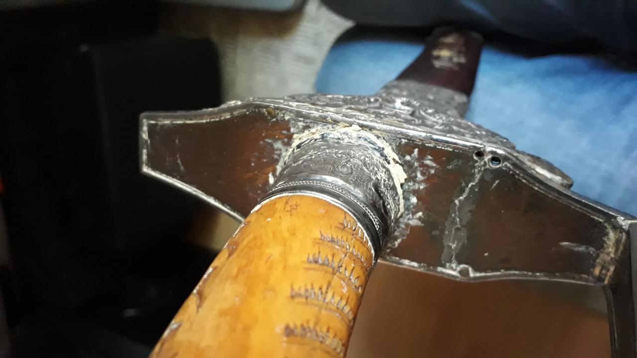

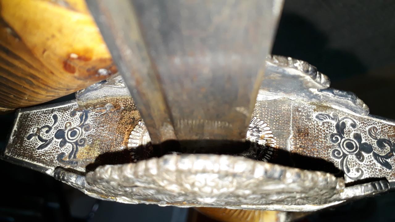

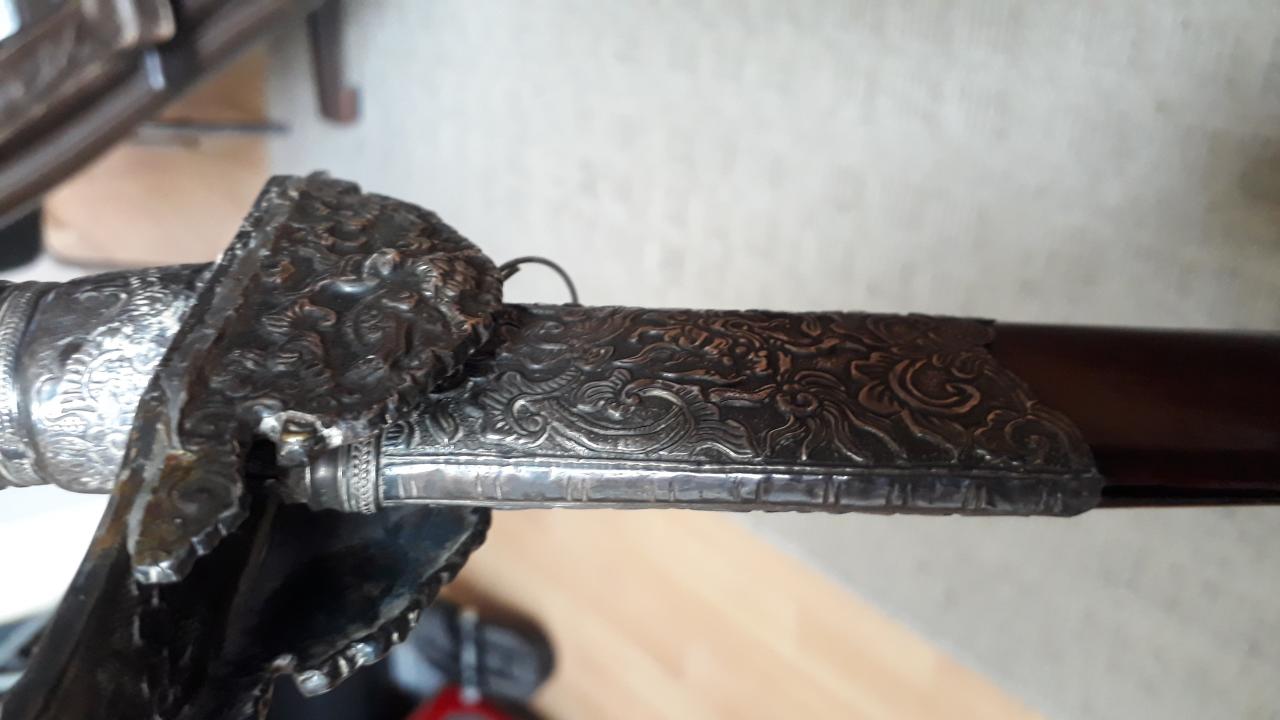

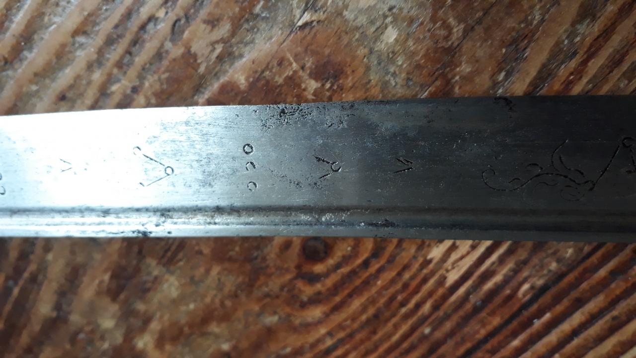

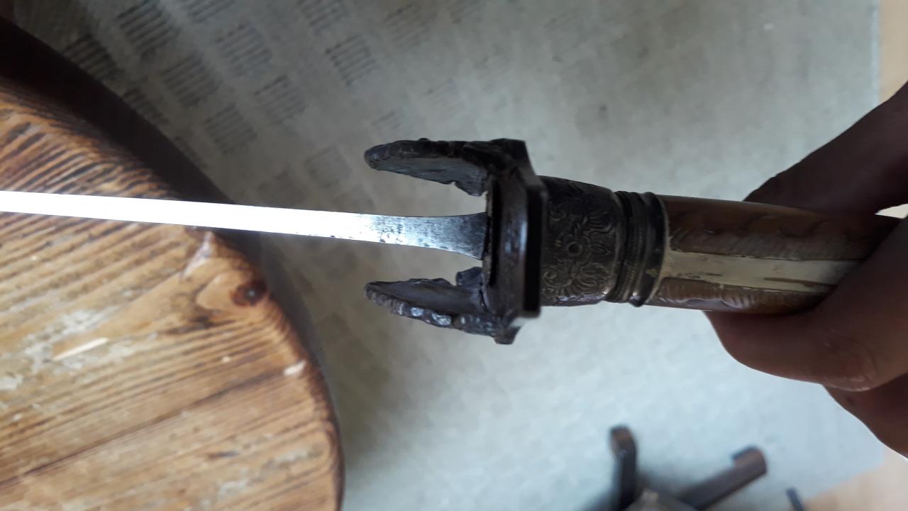

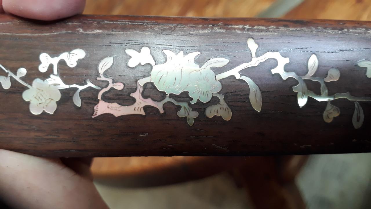

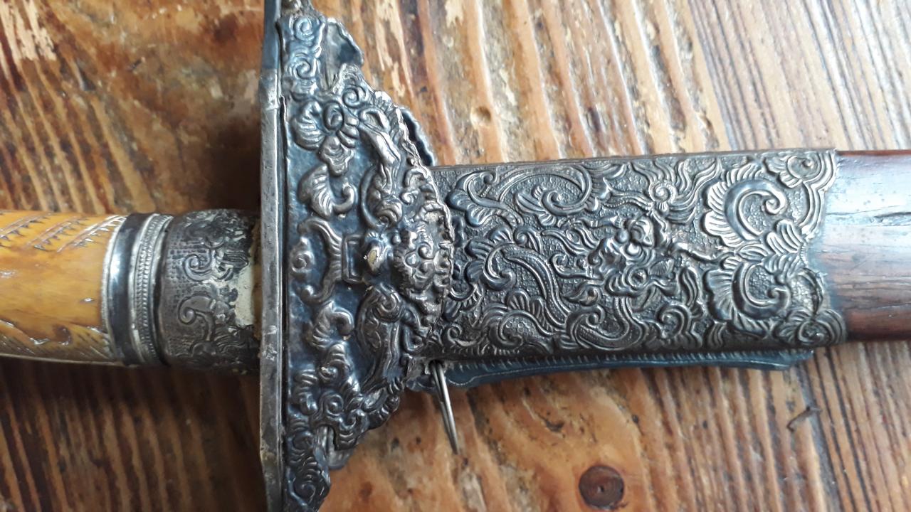

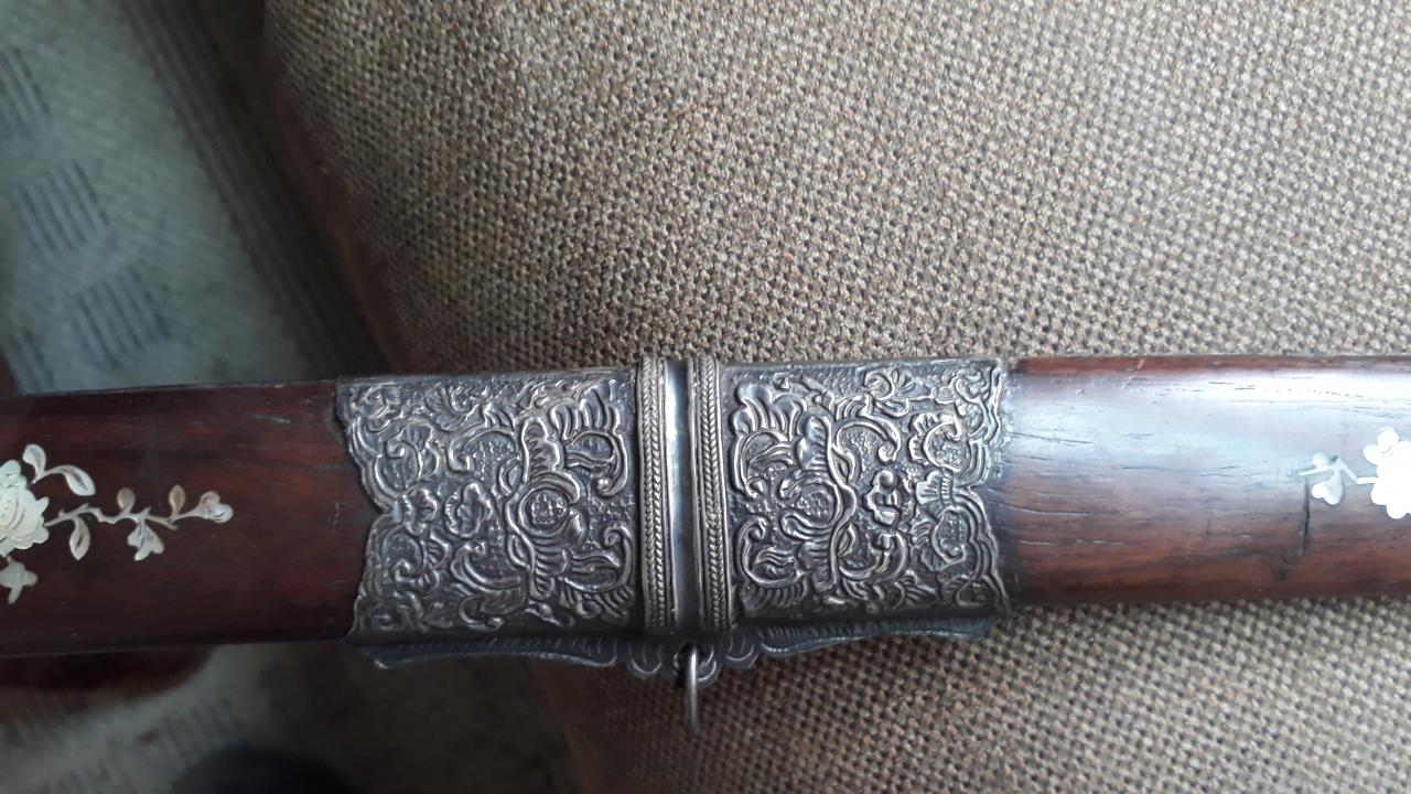

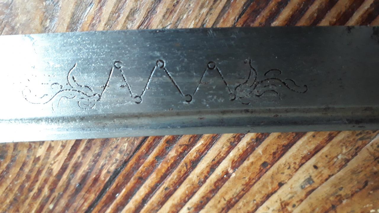

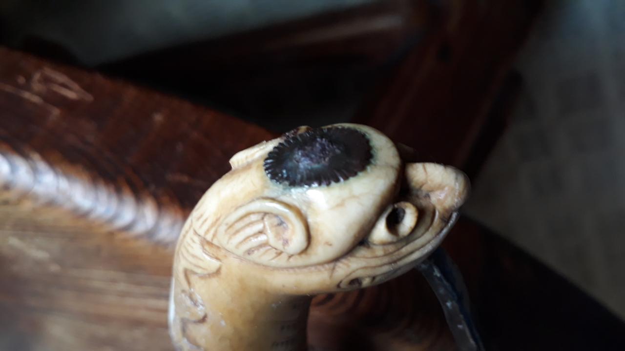

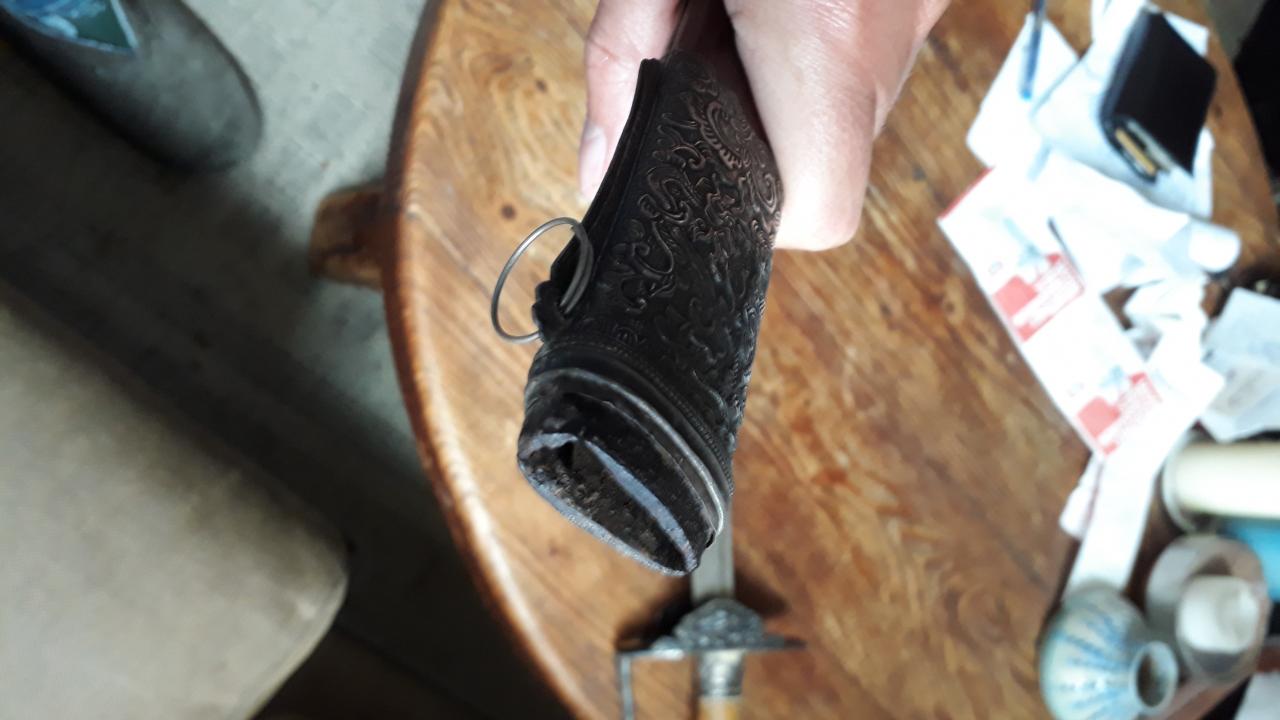

Well, 95% of my pictures were blurry again, but here are some of the less disastrous ones.
It's clearly undergone significant repairs to the grip. Something I failed to notice before is that it looks like the guard may have been broken and welded back together at one point. The sides of the crack line up well so I assume that the parts do belong together. It looks like the plates were riveted to the guard as can be seen in the pictures; the rivets are missing in one corner, leaving two little holes.
Some measurements: I can't quite get my calipers between the plates on the guard but the blade is about 2.6cm broad and 9mm wide at the base, then (distal) tapers quickly to about 5mm 10cm down the blade, then a gradual taper to about 3mm at the end of the fuller, then down to 1mm near the tip. The length of the blade measured from the tip in a straight line to the shoulders is about 67cm. From the tip to the peen is 81cm. 87cm total inside the scabbard. POB 10.5cm from the base of the blade. I don't have good scales here so unfortunately I can't give an overall weight.
The scabbard grips the blade well enough to hang suspended from it by friction without support when I'm holding the grip of the sword, but not well enough for it to hold the sword in when I hold it upside down while holding the scabbard.
I wish I had a better replacement ring for the scabbard as it looks a little silly. }|:oP

Thank you very much for these photos!
I see that this sword had a long and hard life. But he is still a strong and cheerful old gentleman
In my opinion, the blade is quite typical for this part of Indochina. The decor is a stylized image of the constellations. The same or very similar ones were depicted on ancient Vietnamese flags, which, for example, were used in Nam Giao - the ceremony of sacrifice to the Earth and Sky. On Chinese blades, the stylized image of the seven stars of the Big Dipper can often be seen, but this is the first time I see it on a Vietnamese blade. And the style itself is different from the Chinese.
The crack on the handle looks too regular and symmetrical for accidental damage. I can assume that there used to be a decorative insert in this place, for example, a silver stripe.
Thank you for the wonderful input so far, it adds a good deal to what we know about a field about which so little reference material exists.
On this blade, yes, the arrangement is different from the usual Chinese, but I still see seven "stars". As other readers are no doubt familiar with, the typical Chinese arrangement on double-edged blades is a simple zigzag to accommodate the overall shape of the space; on sabers you occasionally see them as inlaid dots, typically between segmented channels along the dorsal profile.

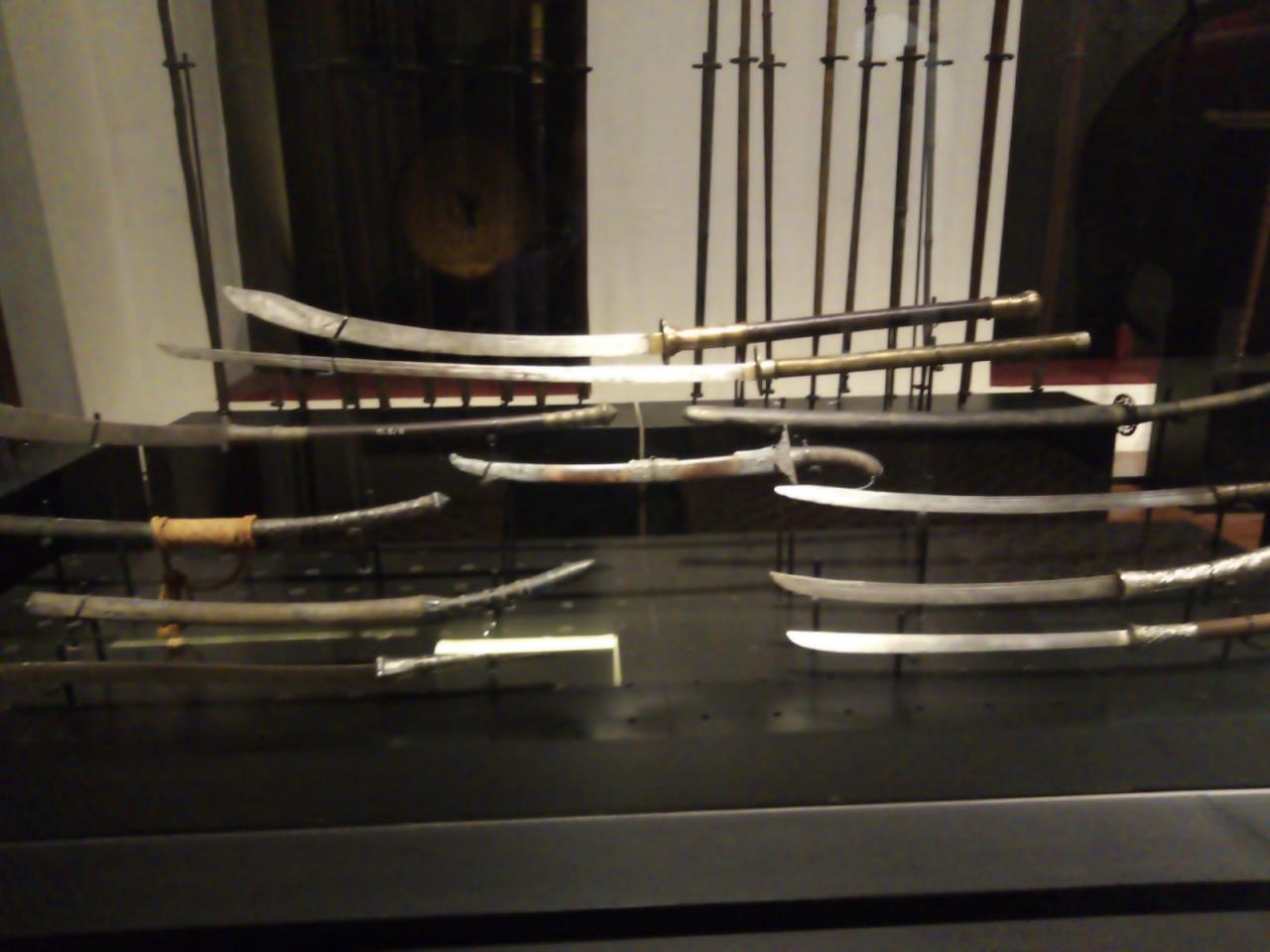

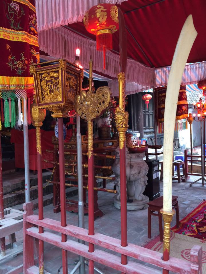

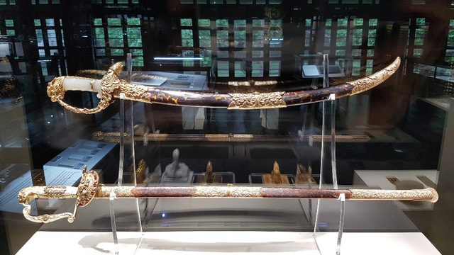

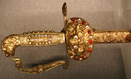

A friend of mine is currently on holiday in Thailand and he just sent me the picture attached to this post, taken at the National Museum in Bangkok. It's interesting to see that there are more of these around with those plates projecting from the guard.
EDIT: My friend is also interested in anything you might be able to tell us about the other swords (particularly the large ones in the back).

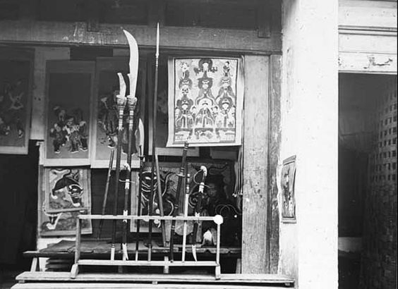

The large swords in the background are called trường gươm 長劔 in Vietnamese - a long sword or a long saber. In the late 19th and early 20th centuries they were exclusively ceremonial weapons and many painted and varnished wooden models survive. Here are some pictures from this period.

Thanks Ren Ren.
The second one from the top in particular seems to show strong Japanese influences. Is that a correct inference?
werecow is online now   Reply With Quote
Old 19th December 2022, 01:24 PM   #13
Ren Ren
Ren Ren's Avatar
Join Date: Jun 2011
Location: Russia, Moscow
Posts: 379
Quite right, werecow! Japanese influence was very strong in Vietnam and much of Indochina in the first third of the 17th century. Later, the influence also took place, but not so direct and strong.

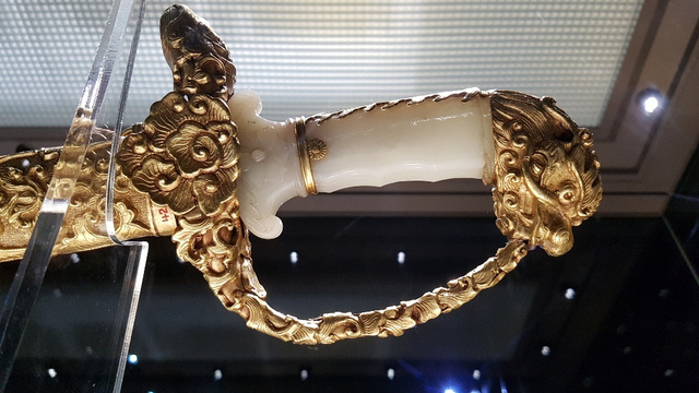

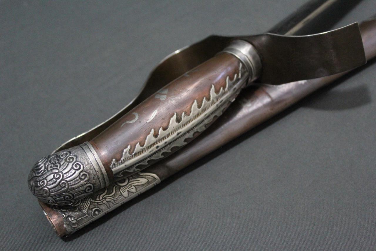

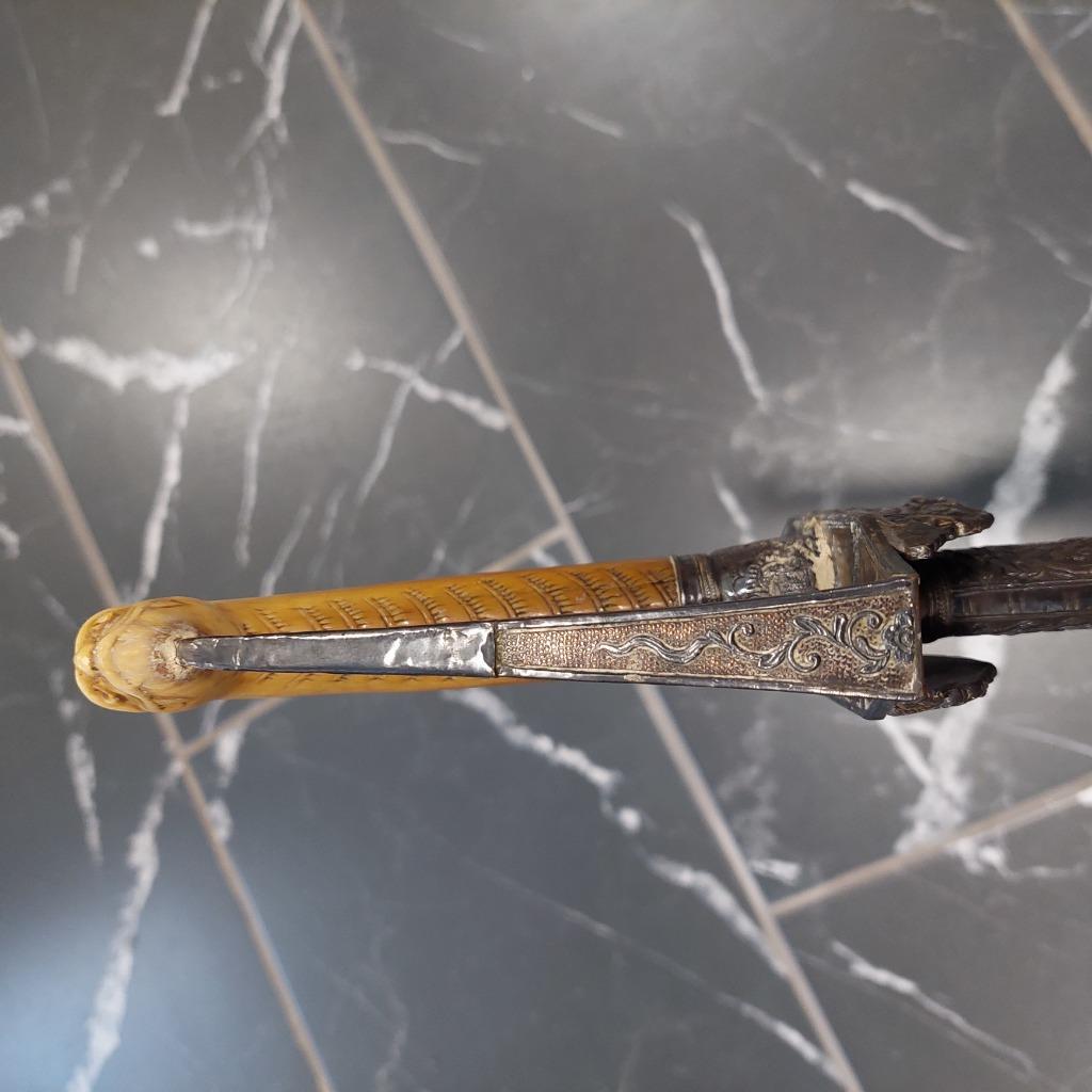

I look forward to reading it! If you want any more closeups of a specific part of the sword or the scabbard, let me know. }|)
I apologize, the search process was somewhat delayed. Here are examples of guards with a shield that have a clear French influence.
And also an example of a hilt with an insert, where the curls are facing down. I'm assuming that this hilt was made much later than yours.
