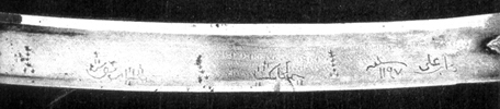

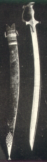

Maybe I have bent the rules, just a little bit, by showing these pictures, but I did it to the benefit of the members. So I don’t hope the moderators will quarter me and put me on a wheel, as I have done this on my own risk, and that is risky enough as it is. I know the quality of the pictures is bad, but that is all I have - sorry.
What is this?
It is Indian, but from where in India is it?
What is so special about it?
What is it called?
I know the answers to these questions, but I thought it could be funny to see if someone else knows, or can guess it. I will bring the answers later, but until then gentlemen, please take a number and wait for your time to give your answer to the questions.

Obviously we have two different swords here.
Jens picture shows an Indo-Persian (tulwar) hilted sword with recurved blade and T-spine. The blade resembles a yataghan, but as Rob has noted it is probably a sossun patah of Islamic form (versus Hindu form). We have seen T-spined yataghan before, I think with Ottoman hilts, but I don't recall one with a tulwar hilt. I agree with Rob that the T-spine suggests the NW Frontier region: Afghanistan or nearby. The scabbard seems unusual also in that the suspension system is two rings mounted at the throat of the scabbard, similar to Moroccan swords and knives. I'm out of my depth trying to expain the origin of that feature.

It is Indian, but from where in India is it? It is a special sword from Hyderabad, Andhra Pradesh, Deccan.
What is so special about it? The T spine.
What is it called? Sailaba.
Hilt 17 cm.
Blade 65 cm.
18th century
In ‘A Catalogue of Arms and Armour in the State Museum, Hyderabad’, 1975, I found this picture, and found it interesting enough to show. Had I not known from where the sailaba came, I might have guessed on a place far more to the north, but the text to the illustration clearly states that it is a special sword from Hyderabad. What is even more interesting is, that in the catalogue they have a kind of an inventory list of the weapons in the museum, and here it states that they have twenty-seven sailaba’s.
In the catalogue they have sailaba’s from 17th to 19th century, and the length of the blades are from 44 to 77 cm.
The sailaba shown have an inscription on the blade with the name ‘Saheb Ali’ and the date given is 1194 H.
Rick's sword is of course a kirach, but it is an unusual kirach as the false edge is very long, just as the heavy reinforcement of the spine is heavier than normally seen. Tulwar/basket hilts are seen, but not so often.

Hi Jens,
Is the date 1194 or is it 1197?
Jeff

Hi Jeff,
Why do you ask? The catalogue says 1194 H., so I have to believe in it - this should be about 1780 our time.
Btw I see on another thread that you have chosen to show a weapon - in detail - shame on you, I thought I had the rights.

Hi Jens,
I am trying to learn to read Arabic dates and if you look at the detailed photo of the blade that you posted , on the right side you see signs that look like this; '119V' . I think that is the date but V is arabic for 7.
As for the Nordlundesque photo's, you may have been the first and possibly the best at it, but you don't have exclusive rights! ask Wolviex. .

Hi Jeff,
That you can see the numbers on the photo is beyound me, buy the catalogue says 1194 - well what are a few years between friends?

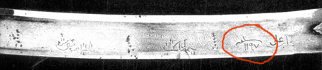

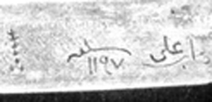

Maybe I am seeing things but here is what I was looking at;
Jeff

Jeff:
I think you are correct. That does look like a date of 1197 H.

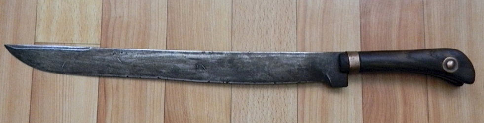

And here is a real old Kazakh selebe.
