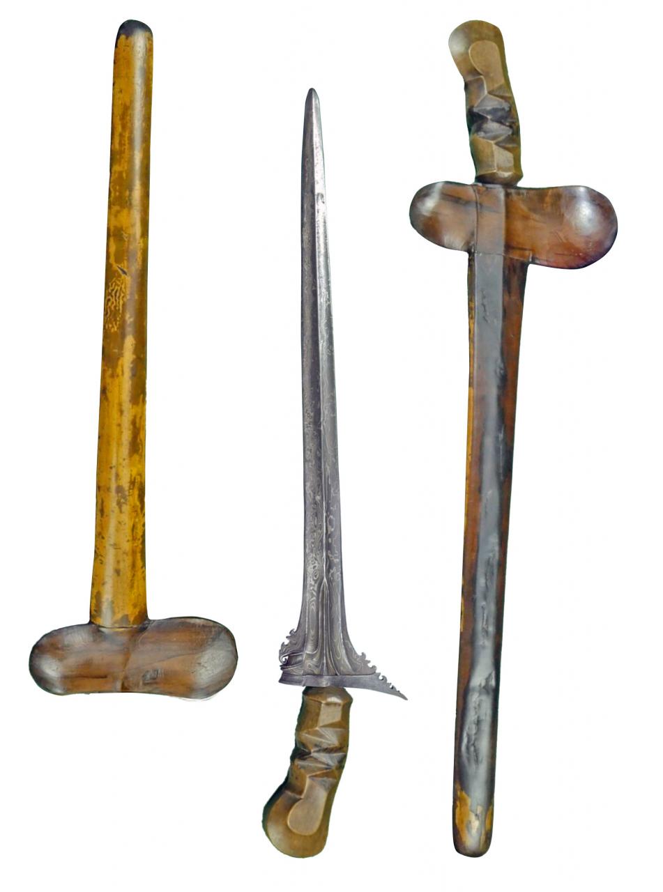

This is a new purchase but it will be several weeks before I get my hands on it. However, I'm impatient and hope to get advice/comments so I can consider options to dress it. I've (poorly) Photoshop'd the image below from the sellers photos which had watermarks. To my eye, this is a classic Bali keris with decent execution, likely late 19C or early 20C based on other examples on this forum. It looks quite serviceable as a weapon with a 45cm blade. I'm liking the warangka, a bit worn with character. I'm uncertain on the age/quality of the bebondolan(?) style hilt. I would like to think it is something a Balinese warrior might carry. Am I way off base? If not, I would love to hear suggestions for dressing it (selut, mendak, hilt) to match this period and function.

Looks like a nice example of a late 19th century Bali keris. The hilt form here is called Cekah Solas. You can find more information on these hilts here:
http://vikingsword.com/vb/showthread...7827#post87827 I would not say you are necessarily off-base on your assumption. I have heard that such hilts were favoured for fighting and this is the kind of basic, unadorned dress you might expect for a soldier's keris i think. |

If what I think I can see in the photos is correct, this is a very, very good keris.
The blade style is classic, the garap appears to be detailed and neat, the forge work looks to be better than competent. The dress is classic. Old keris of this style of keris in Bali itself have been highly sought after for some years, especially so since the monetary crisis of the late 20th century. I would not be so inclined to think in terms of Balinese warriors, out of context this can be a pretty misleading thought, similarly, in the Balinese context the keris should not thought of just in weapon terms. It seems that you might be considering changing the dress, Jeff? This could be one of the greatest errors in your collecting life if you do. The only thing I might suggest is the addition of an old wewer (hilt ring), but undamaged old ones are very difficult to obtain. This keris is perfect & beautiful exactly as it is. |

I also agree with Alan that you should not be thinking about changing anything about this classic keris dress. The sheath, though worn, looks to be in pretty good condition, made from select and desirable timoho pelet wood, as is the Cekah Solas hilt. While perhaps not exactly rare, old examples of these hilts are at least less common and it suits this keris quite well. As Alan mentioned, the only thing i would consider changing about this ensemble would be to add a wewer/uwer (hilt ring) to it. While old, undamaged uwer may indeed be more difficult to find, if you look around some you can probably find a fairly decent new one that might fit the bill.I used to see these quite often on eBay. When you think about images of "rough looking armed men" carrying keris you may well be thinking about this image. You will note that the gentleman on the right carries a keris at his back and the hilt on his keris is indeed a the Cekah Solas form. This image presents these gentlemen as warriors, but it is obviously a set-up photo so it's impossible to say for sure how much of this image was orchestrated by the photographer for effect. But as i mentioned before, it is my understanding that these Cekah Solas hilts were favoured by warriors due to their grip. When i went searching for where i had seen this before it does seem to be information that was suggested by Lalu Djelenga. Still, i believe it is important to approach keris form a position that focusses on far more than martial applications. |

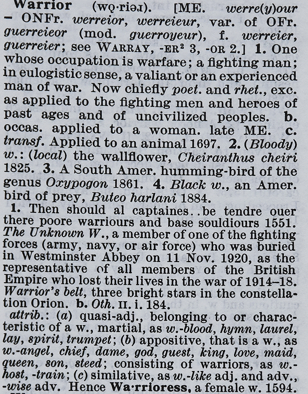

Miriam-Webster: "a person engaged or experienced in warfare" Cambridge: "a person who has experience and skill in fighting, esp. as a soldier" Collins: "A warrior is a fighter or soldier, especially one in former times who was very brave and experienced in fighting." Oxford: "(especially in the past) a person who fights in a battle or war" Nowhere is there a mention that a warrior is someone who fights wars in exchange for money. I do acknowledge that a couple of these definitions mention "soldier", which certainly can be considered a profession, though soldiers can be conscripted as well. Though even when someone becomes a soldier for pay it does not necessarily mean that soldiering is their intended profession. Many soldiers serve their nation in times of war and then return to their regular lives as farmers, carpenters, and tradespeople. When we speak of Native American warriors, surely fighting wars was not the sole occupation of these braves. They fought where and when they were needed and hunted and/or farmed also when needed, all as a service to the tribe. And certainly they weren't paired for their warrior skills when they did go to war. So i am afraid that this connection you are making that demands that "warrior" only be used in the context of a "profession" does not really ring true for me. |

However --- dictionaries, and "profession" or "occupation" or "job". This is an English language forum. When I get paid for what I have done for a living for most of my life, I need to use the English language. When I use that language in a strictly Australian context I try to use the Australian form of the language. When I am required to use the language in some vehicle which will travel beyond the borders of Australia I try, insofar as it is possible, to use what I have been taught is Standard English, and if I need to go to a dictionary, I use the Shorter Oxford English Dictionary on Historical Principles for general writing, and specific professional dictionaries when these are required. If I'm talkin to me mates I use whichever jargon best suits the situation --- bush lingo with me cockie mates, accounting, audit, & legal jargon with my professional associates. The word "warrior" can be used in many ways, we can find "keyboard warriors", "weekend warriors", we can find football teams that are some sort of warrior or other. When we get into colloquial usage there is no end to the warriors we can find. But when I write in this forum, I try my best not to diverge into colloquial usage, and since what I write might be read by a person literate in English, but from a large variety of cultural & social backgrounds I do try to write in Standard English. You have referred to a number of dictionaries, I checked what I wrote about warriors being those who have war as a profession --- meaning of course that they are paid for engaging in warfare --- I think I am writing in Standard English, so I used my normal Oxford dictionary OHP to check. Here is a photo of the entry:- |

The four different dictionaries i quoted were all online editions. The Oxford example i used was the Oxford Learners Dictionary, so not their regular edition. But i would consider ALL these sources as legitimate sources for "Standard English" usage. Surely you don't believe your Oxford dictionary is the sole source for such information. I have no reason to believe that i am using the word "warrior" in anything but a standard English context. The examples of uses you used above were not ones that i was considering at all. We are quibbling about semantics here Alan, but some of your response seems to ignore everything else i stated. No one claimed Bali was a "warrior society" or that the entire population of Bali are/were "warrior people". But clearly the Balinese did occasionally engage in war, and when there are wars, there are warriors. In my comments you will find that i agreed completely with you that the nature of the keris should not being connected to warfare and also related this to Jeff. I will say now that i also agree that what happened in Bali in the 1960s has nothing to do with warriors and understand your reaction to Gustav's comments. However, in discussing the Cekah Solas hilt of his keris my research brought up writings by Lalu Djelenga stating that these hilts were favored by warriors. What am i to make of this source? And numerous sources do indeed refer to the Satrias, what is the Kshatriya caste in Bali, as members of a "warrior" caste. Yes, i completely understand the these aristocratic knights should not necessarily be seen in the same light as, say, an Apache warrior, but the term warrior caste is associated with them in many references so it is hard to ignore. Again, i think this becomes merely a matter of semantics. My point in bringing up this information was only to try to establish some further information about this hilt form and it's possible place in the world of Balinese keris culture. To keep the discussion focussed on the object at hand. Unfortunately this debate about the word "warrior" has somewhat derailed my intent and we are no longer discussing Jeff's keris at all, but rather word usage and what each of us feel is "Standard English".

Firstly, I do not use online dictionaries. The professional writing that I need to do often finishes up being used in a legal context, so I use hard copy, published dictionaries, I've got about two meters of bookshelves given over to dictionaries in several different languages, I need these as tools of trade, it can be pretty embarrassing to have a lawyer read out something that one has written, and then have that destroyed by some smart-ass barrister -- not one who makes coffee, but one who keeps people out of jail. It is not open to each of us to independently determine what form or style of the English Language qualifies as "Standard English". In another lifetime I taught English to new comers to Australia, I did this as a community service, it was not paying work, however, it did require a qualification to be permitted to undertake the work. One of my teachers who helped me to gain this qualification was a linguist who taught me and his other students, that the best example of "Standard English" was the form of English spoken by educated people living in a certain part of England, I think that part of England might have a location somewhere about 16 miles south west on London. Well, he might have been right, or he might have been wrong, but what I have learnt about "Standard English", as that term is understood by linguists at the present time, is that "Standard English" can no longer be restricted to a single ironclad idea, thus "Standard English" can now be defined in a rather loose way that involves the application of varying measures in order to determine what is, or is not Standard English, in other words, Standard English is no longer something that is inflexible, but rather something that can flex providing that it adheres to a standard of intelligibility. So I assume the idea of "Standard English" now means that as long as an educated person can understand the message of the spoken or written word that message has complied with a standard. Thus, the standard with which Standard English must comply is a standard of intelligibility, and this standard cannot be not one of individual interpretation. In respect of the version of the Oxford English Dictionary that I prefer to use for general writing. I use this because I was advised by a couple of lawyers that for courtroom usage this particular edition was perhaps the most practical. The complete Oxford runs to something like twenty odd volumes and is constantly being revised, for general usage it is not really practical to use, but the edition I use is apparently well suited for use in defensible legal argument. Moreover, it is only two volumes, and is always within arms length, so even though I began using it maybe 40 or 50 years ago, I now habitually use it whenever I have to look at a dictionary. As to your semantics comment, yes, I do agree that I sometimes tend to consider exactly what a word means. I'm sorry, this is the way I was taught to think, it is the way I do think, if I write something I do want to be able to defend what I write. If I'm talking to somebody, I'm not as particular, particularly in a social setting, that is because when using the spoken word for communication we usually do have the opportunity to correct a misunderstanding, when we write we do not have that opportunity, thus when I write something I want that writing to say just what I want it to say. Thus, if I want to refer to a person who is operating in a military capacity I might use the word "soldier", but if I wish to refer to a person who follows the occupation of war, I might use the word "warrior". These are different words with different meanings, and I have worked too long in an environment where use of the wrong word can get you hung. True David, I did not address everything you wrote, but did I need to? Why recap on things that need no comment? I agree with you completely in that all this discussion about warriors has derailed this thread. This sort of discussion, or if you wish debate, is something like the sort of discussion that undergraduates have in order to try to elevate themselves in the intellectual hierarchy. All I really wanted to do was to cause people to think about why I wanted to disconnect Balinese keris from Balinese warriors, and the answer to that is pretty simple, it was because the keris was not, is not a weapon of war. All the rest of this garble is just so much piss in the wind. (fifty years ago this would not have been accepted as Standard English, but by the current standard, I think it might be) |
