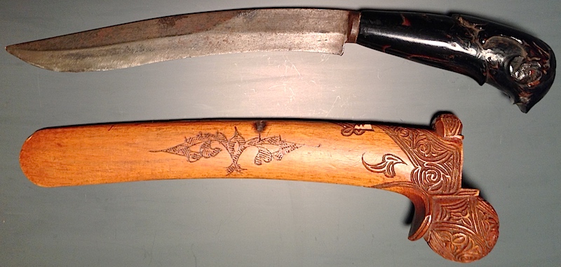

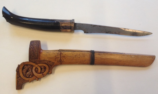

Good things come in pairs.

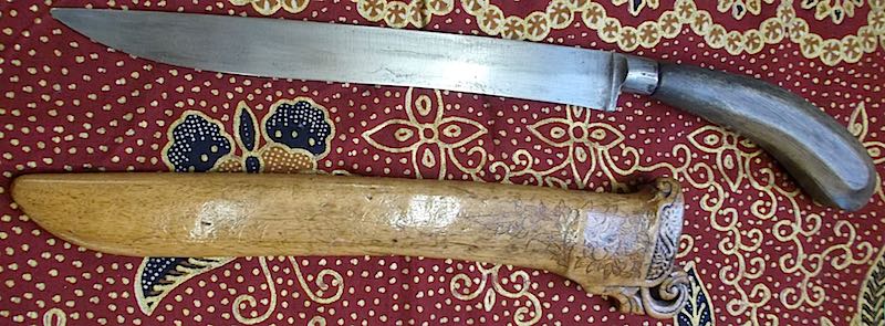

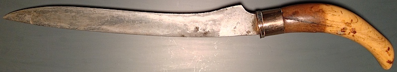

I have been looking for a peurawot for years and then I found two in 2013.
I know that Gavin has one, too (could you please post yours here?).
Anyone else who feel to contribute so we can have some more here for reference?

That's a great one Michael. Congratulations. I was too late on this one... Great that you've got it!

What is the handle material on the second one ?
It looks almost like akar bahar .

Rick, I am waiting for a "material expert" collector friend to come over and help me make up my mind about what it is.

Beautiful pieces Michael. First ones I've seen. I really like the scabbard carving.
I am assuming that these are utility knives?

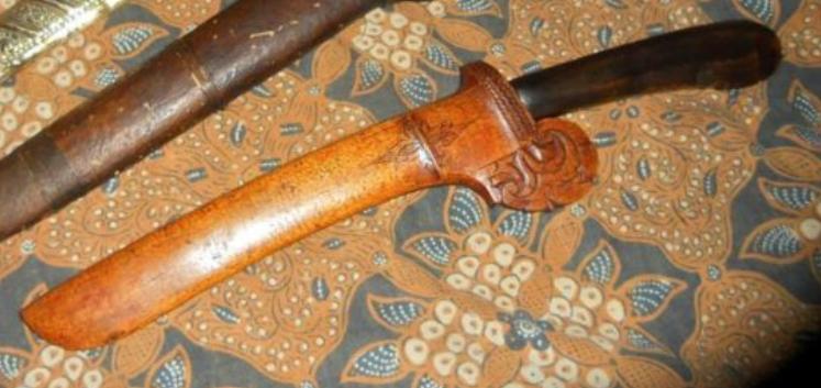

I also saw this "sold" item in Awe.
I missed out on 2 of them in 2013.
This here below is the other one that I noticed but could not buy.

Michael, I will post mine as you ask later this week. Congrats on a beautiful example of a strong and interesting form.
Charles, I understand they are used for Betal Nut. Others may advise further.

Hello Michael,
Congrats, nice examples! I'm glad you snapped that up when most of us were busy with Christmas...
Your first one looks more like a rough specimen. I have a similar one of large proportions - what is the blade length of yours?

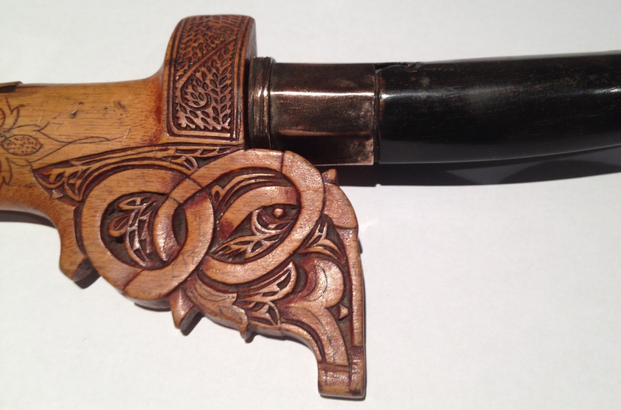

The second has the text-book (and status) hilt: curved away from the edge, with carved tampo design (pommel), and an - especially nice - sampa (ferrule) from suasa. I really like the variant scabbard carving! Please post some more close-ups of these features - thanks a lot!
The blade is much shorter than the hilt: Any hints that the blade tip got reprofiled?
Yep, good idea, especially since there is quite a bit of variety in peurawot blades, hilts, and scabbards!
With the deeply appreciated and hopefully ongoing help of some very kind friends I managed to assemble a small peurawot collection. Will try to take pics when weather and time permits.
Agree with Rick [I wrote Willem originally - sorry for the error] that it does look a bit "suspicious" - experienced seller says black horn though. If the hilt feels more like stone/bone (harder; colder to the touch), it most likely is Akar Bahar. Close-ups!

Hello Gavin and Charles,
Peurawot come in very different sizes and blade/hilt configurations. Thus, I have a difficult time to see it as a specialized tool. I haven't found any historic records that mention that peurawot are limited to working pinang (betel nuts). Given that there is a broad variety of examples (from basic to high status, small to large, different edge/hilt configurations), I reckon it originally was more like a general utility knife with the main sidearm and the rencong taking over the primary and secondary weapon function, respectively.
It is obvious that the highly decorated status peurawot for nobility and other luminaries were important parts of the attire. I have no qualms to accept that in priviledged social strata these may have been mainly or possibly even exclusively utilized when chewing betel (pinang); with mere mortals, however, it seems to me that the peurawot was a Aceh piso: cutting anything that needed to be cut including the socially paramount pinang usage...

Hello Willem,
Sorry for the glitch: I meant to respond to Rick's comment regarding the hilt material.
I don't see anybody calling the hilt material suspicious. I am not anyway.
Suspiciously looking like Akar Bahar (at bit at least) - that's why I put "suspicious" in quotes. Forgot to add a smiley for increased safety though...

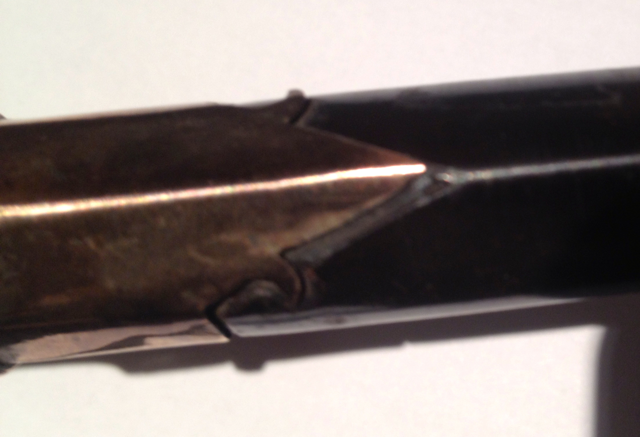

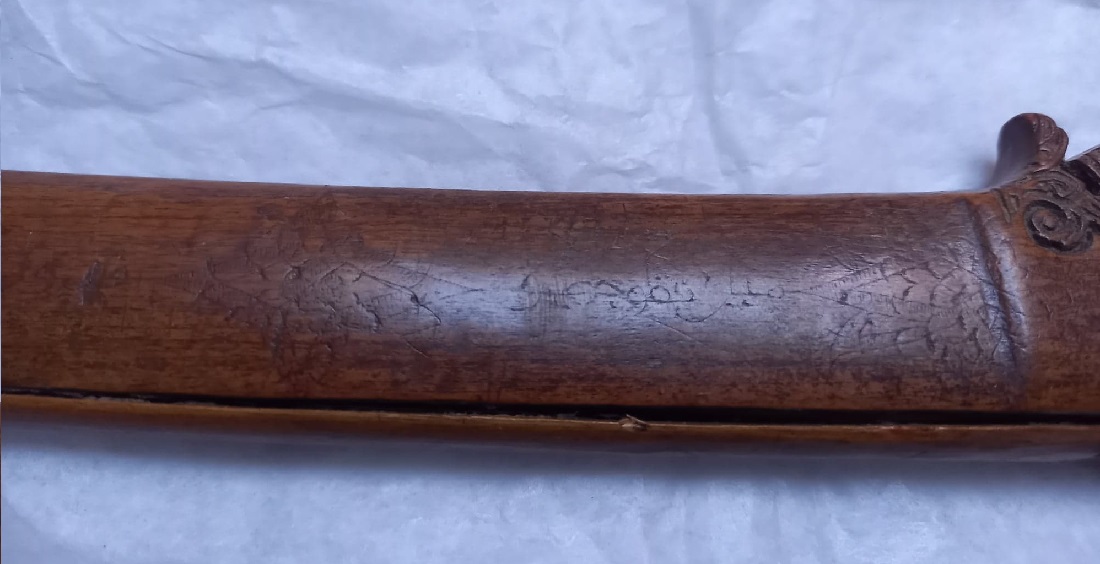

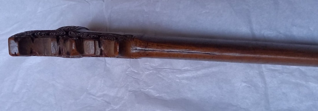

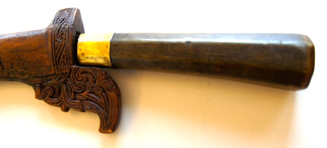

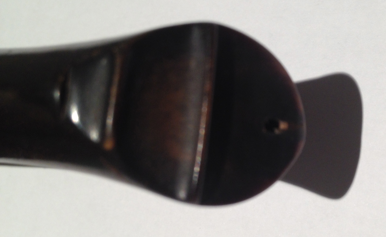

Hi all,
I also "suspect" that it is akar bahar but I don't want to claim it until I am sure.

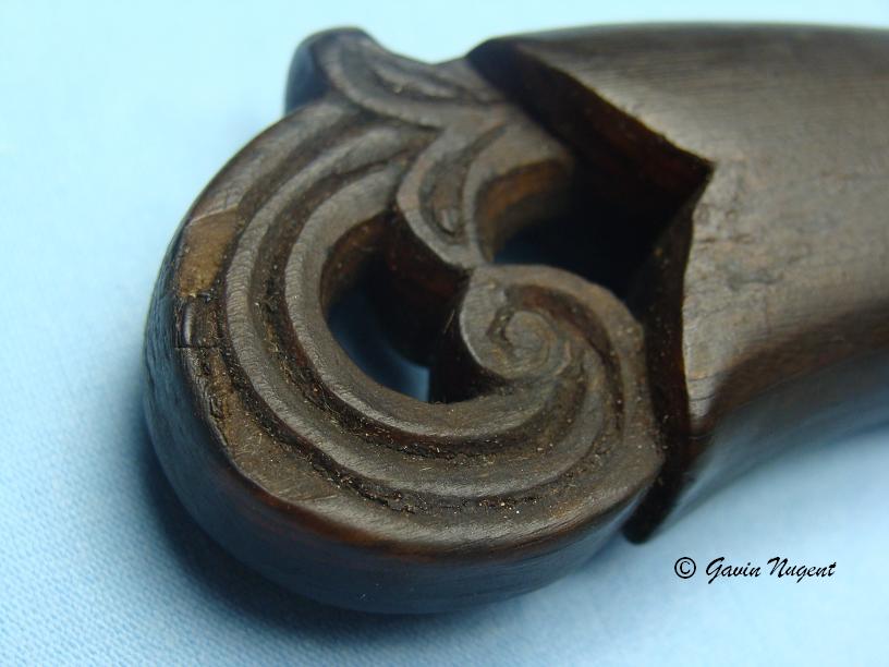

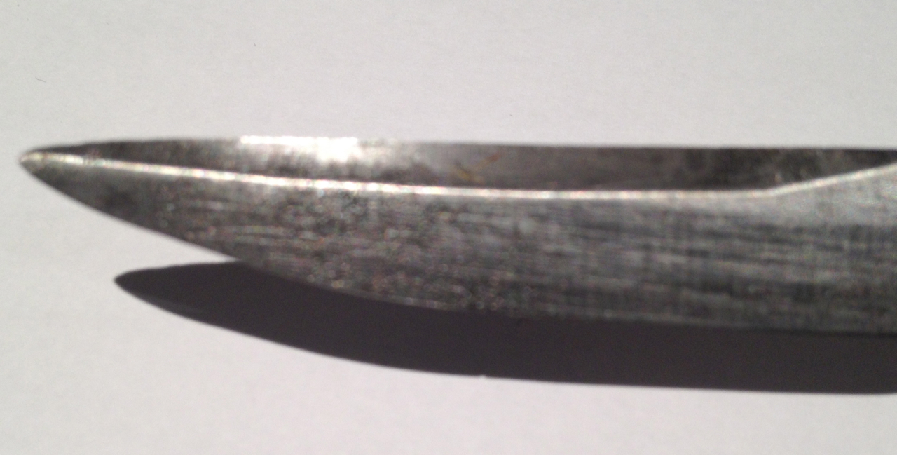

Here are some additional close ups regarding your questions on material, design and if the blade has been reshaped
(quite possible because this is not the traditional blade shape for this knife but a early/mid 20th C version).
On it's use, in all references I have read it is described specifically as a knife for betel nuts.
Maybe it had some status implications to have a separate knife solely for this?
I look forward to Gavin's and Kai's coming picture contributions.

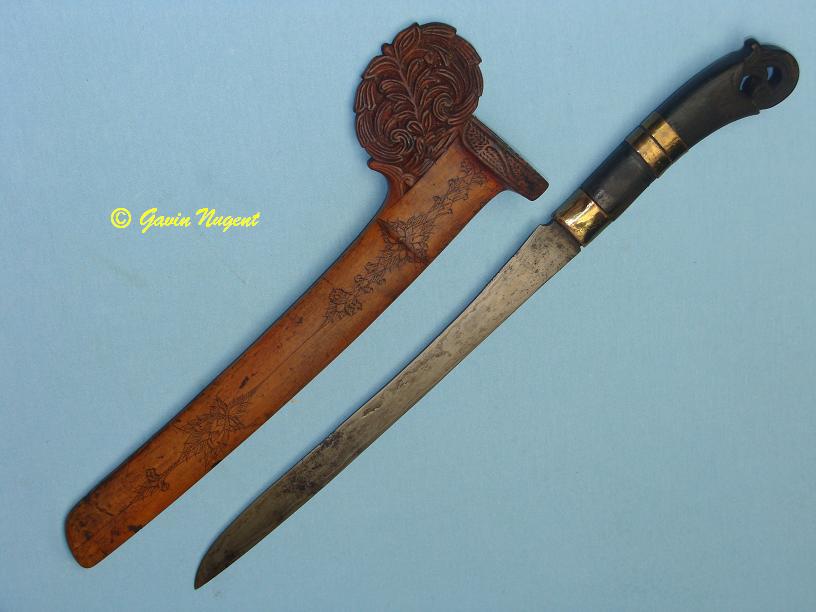

Old 7th January 2014, 05:13 PM   #15
Gavin Nugent
Gavin Nugent's Avatar
Very nice Michael,
I would, based on the images call this a horn hilt.
Gavin
Old 7th January 2014, 05:24 PM   #16
Gavin Nugent

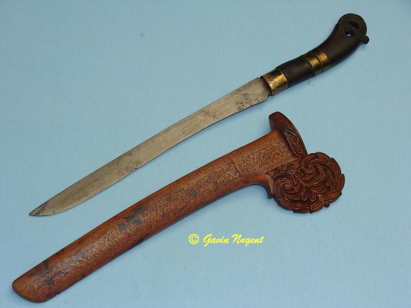

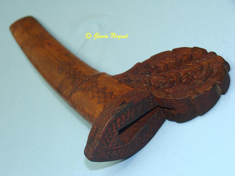

Default Sir Henri Deterding's Peurawot from Kelling Hall
Michael,
As requested.
Horn, Suasa, timber and ink.
Gavin

Hello Gavin,
I am now also leaning towards horn (despite the unsharp pics). Please keep us posted with the final assessment, Michael!
BTW, neat peurawot with beautiful scabbard and special hilt!

Hello Michael,
Thanks for the pics! I've seen the blade shape varying quite a bit with these - are you going to etch it?

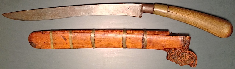

Posts: 2,238

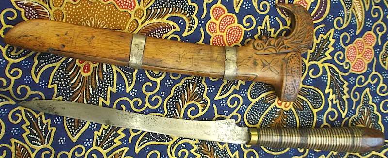

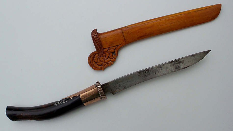

Just adding an old picture from another thread

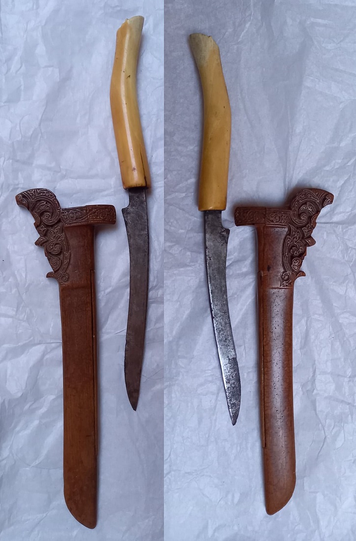

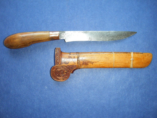

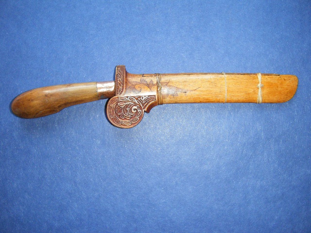

Old 18th February 2016, 01:38 AM   #21
Arrow

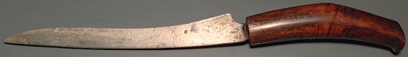

Here some examples from my collection, finally.
Most are clearly status pieces while the last one appears to be a multipurpose tool rather than a specialised carving knife; note the similarity with Michael's larger example at the start of the thread (both blades not displaying the typical peurawot blade shape).

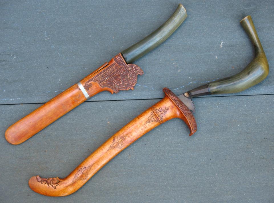

Old 18th February 2016, 12:27 PM   #23
Maurice
Maurice's Avatar
Join Date: Jan 2007
Posts: 1,464
Some beautiful items you have there Kai.
Good to see that your camera is working finally. :-)

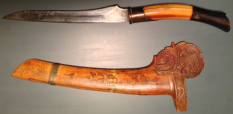

Here two that went through my fingers.
One has a hilt made of akar bahar and suassa, which has a length of 32 cm (in the scabbard).
The other one has no scabbard, a hippopotamus / suassa hilt, and has a length of 27 cm.
Kind regards,
Maurice

Wonderful pieces. I love the akar bahar and then the contrast between the ivory and the suassa!

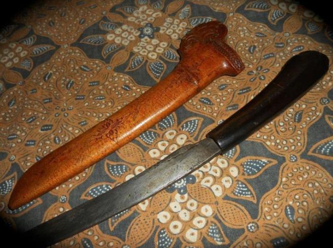

Adding my humble example to this great reference thread.

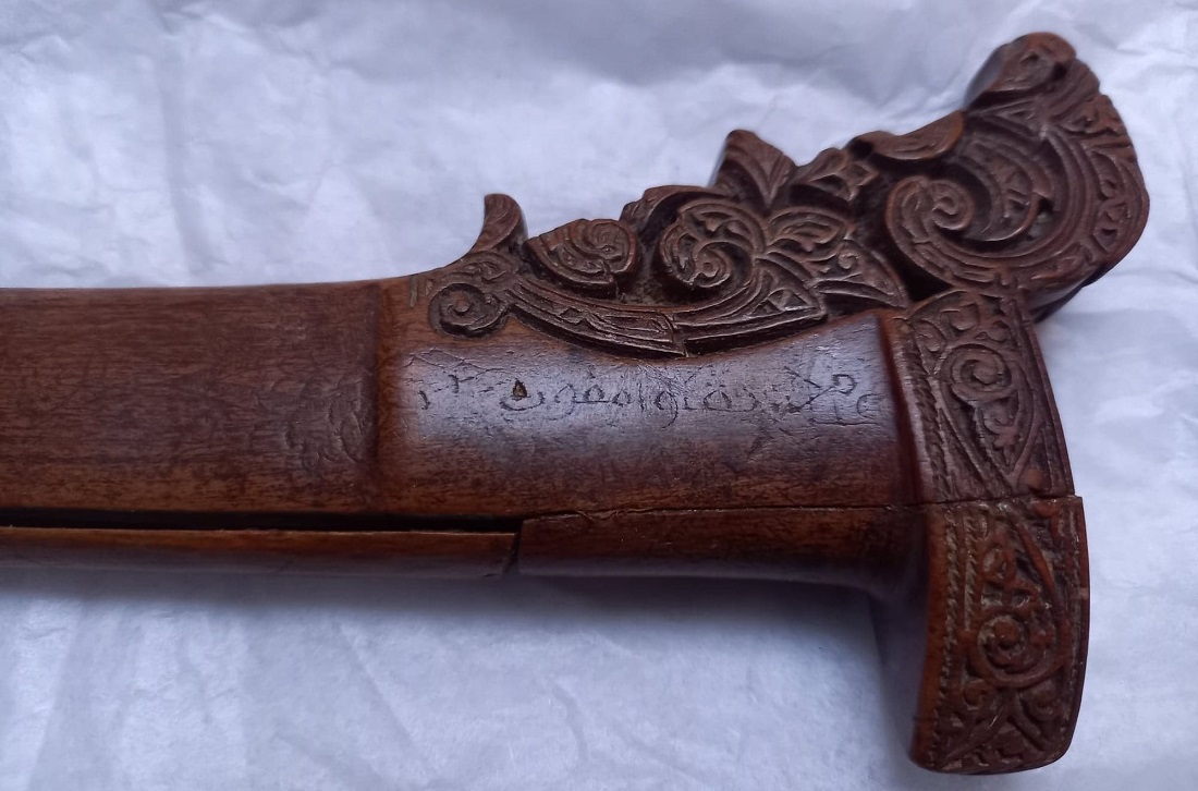

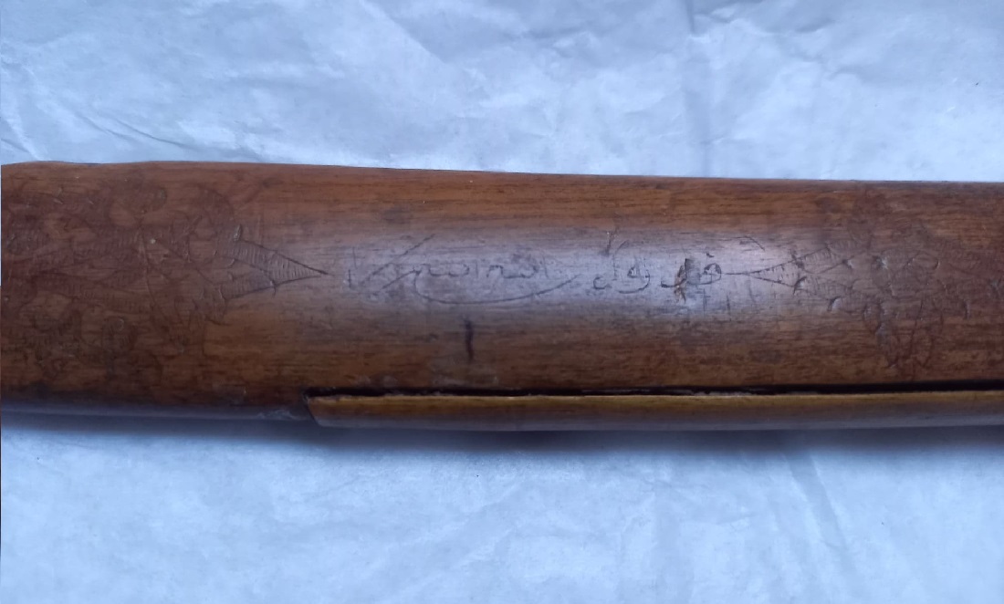

I finally managed to get my first Piso Peurawot.

Hello Séverin,
Very nice example! Let me know...
How long is it in total and the blade only?
I especially like the carving and hope someone can decipher the scripture.
