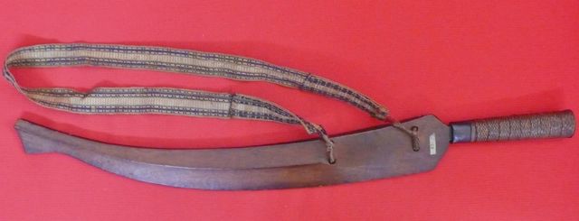

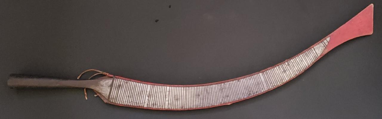

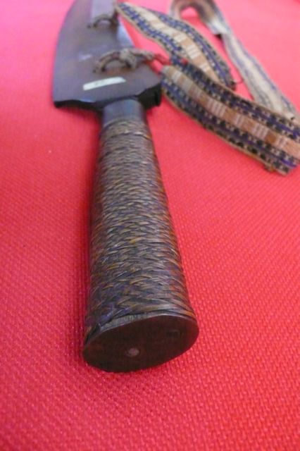

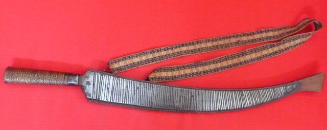

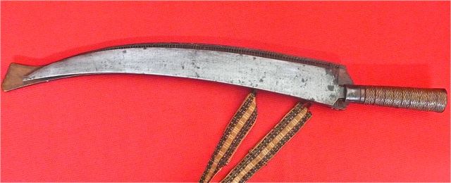

First, here is a very nice and quite complete Atayal/Seediq/Truku knife, with its fabric belt and rattan handle (Total 67cm, blade 45x16cm, handle 15x3,5cm, blade 45,5x6,5cm). Old collection labels can be seen. some pictures are in the swap section: http://www.vikingsword.com/vb/showthread.php?t=13645
Here are few additional pictures.

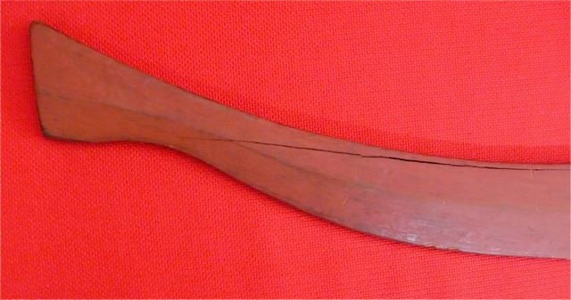

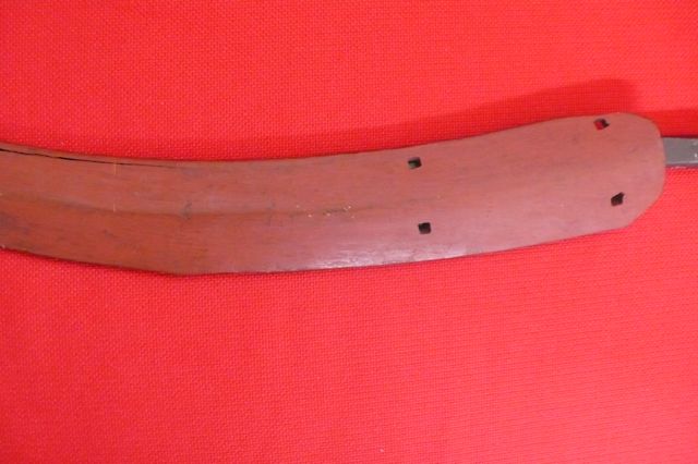

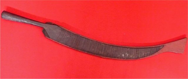

I also found this other Atayal/Seediq/Truku knife, more basic and in a little lesser shape (crack along the sheath). Because of the red color of the sheath (for protection against the evil spirits), I would risk labeling it Truku, but not sure. The handle is in the more basic socket shape to fix it on the top of a shaft (wood) and improvise a pole weapon useful when hunting wild boar (Total 72cm, blade 46x5cm, handle 17x3cm, sheath 56x6,5cm)

Very nice laraw yuanzhumin! It seems with most Atayal (Dayan?), Seediq, and Truku blades, the sheath is the most artistic part of it, with the higher status individuals having nicer sheaths -- since the blades all seem relatively similar (some straighter, some more curved, some a little rough finish, some finer, some wooden handle, some metal socket, etc.)... the sheaths are very graceful looking, like a fish, no?
Saisyat blades (malat?) seem to be stylistically very similar to, but distinct from Atayal/Seediq/Truku knives... I wonder why they preferred straighter pointed blades and sheaths without wide flares at the end.
Nicolas, after viewing your website a while back, I am happy this has gone to a very good home. There was a little more help by another in the journey to you too, you know who you are

Beautiful pieces, Yuanzhumin! Congratulations! I really like the solid one piece blade...no worries about a handle breaking down on you, and the more cone shape handle would grab well in your hand when swung. Thanks for sharing with us your interests in Taiwanese aboriginal culture and craft

You pointed at the fact that the Saisiat have similar knives, except they are straight. In fact, despite similarities, the Saisiat are a very different ethnic group, distinct from the whole group of the Atayal, Seediq and Truku. It is said that they were initially plain aborigines that were pushed up in the lower mountains where they had to deal with the Atayal. What better solution than adopting part of their culture to avoid the clashes and survive ? That’s what they did - it seems. They adjusted themselves to the Atayal culture while remaining different. In consequence, that can explain why their knives have also the wood scabbard open on one side with metal staples, looking like Atayal’s ones, but their blade is straight and therefore quite distinct. I have one knife in my collection that I attributed to the Saisiat, but I’m not 100% sure and any other opinion would be welcome (I have seen Amis with very much looking like knives). See here:

I do agree with you. The solid one piece blade with the socket shaped handle is my favorite. It is so cool! And also very devastating in the hands of someone that know how to use it.

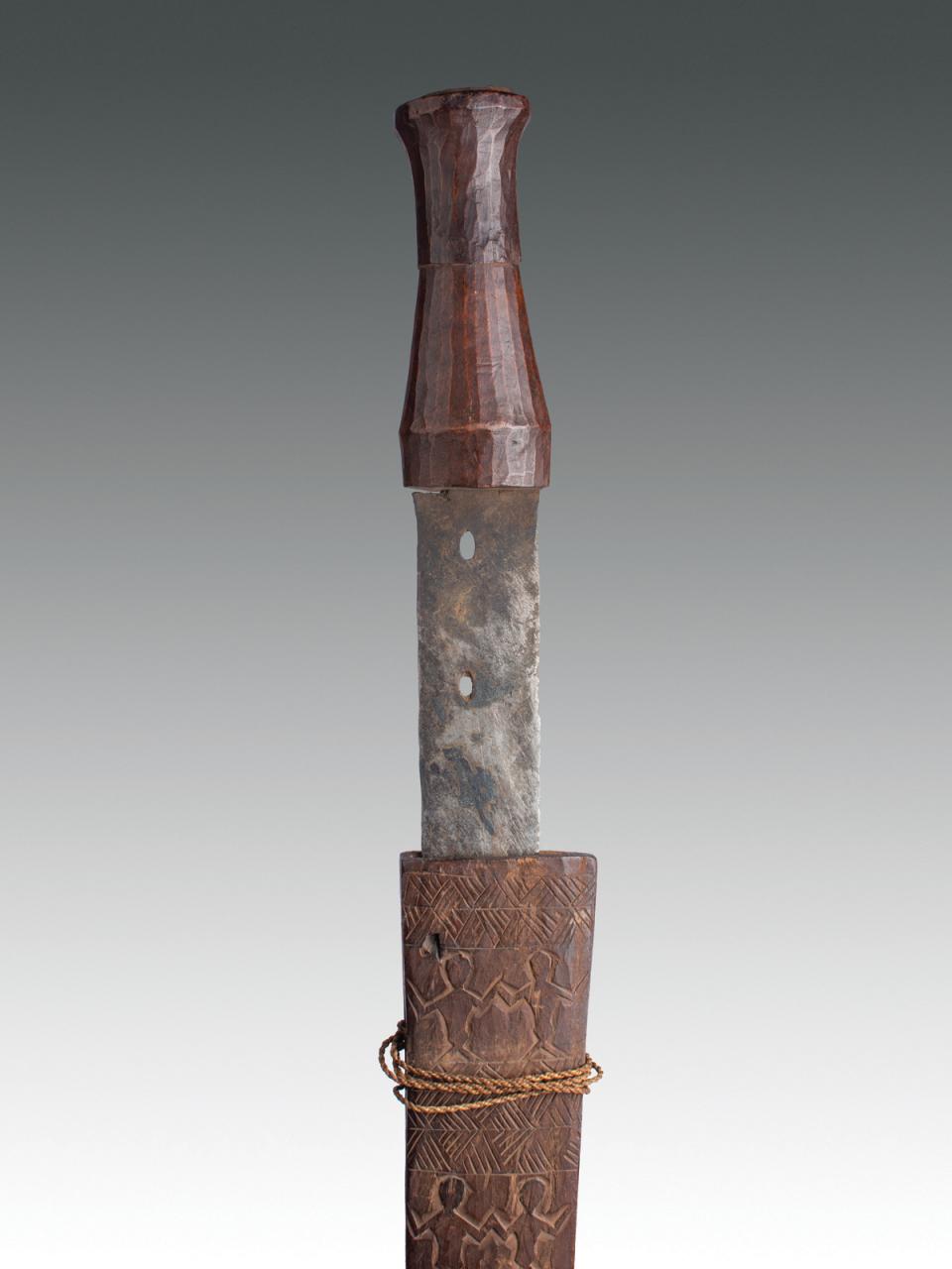

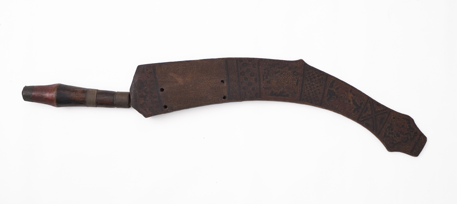

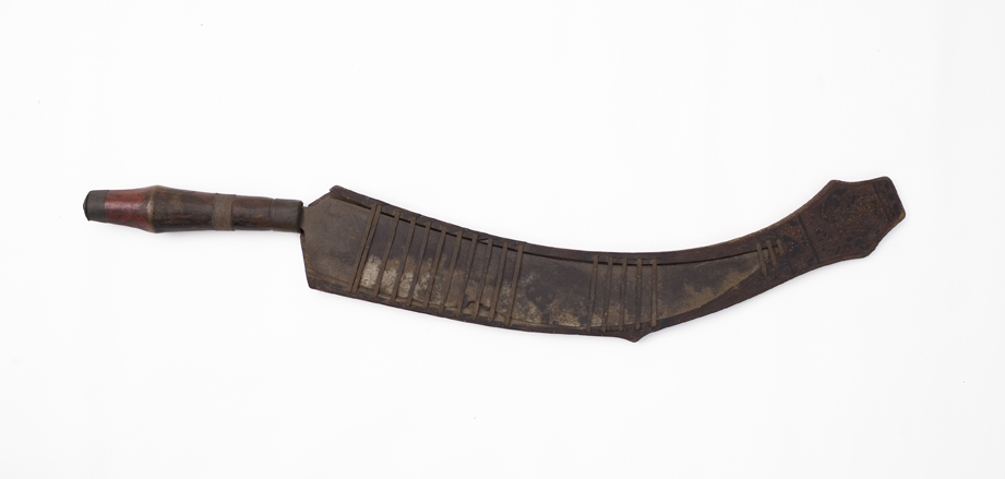

This is an Atayal knife, not a pingpu knife! (Please check the informations Yuanzhumin gave about cooked aborigenes)
It is old, possibly nineteen century.

I have seen pictures of those! Though I had heard that sheaths with those designs are pingpu, but perhaps I heard wrong? I wonder what time period or group within the Atayal had handles like that.... they are definitely not common today.

Pity that you did not sell your Pingpu knives to me! This, above, is the only knife of this shape I have.
The same shape do exist for Pingpu, you are right.
In fact, it is the inverse, I think that the Pingpu had these shapes before and some Atayal used them. From sea level to high montains, the direction of the trade makes sense as the blades were imported, no?
Anyway the decoration is very different when considering Atayal's or Pingpu's scabbard. Atayal use abstract drawings, the same one could observe on tatoos, weaving, bambou earring etc when the Pingpu use flowers, chinese words, in brief, sinizised ornements, sometimes coloured. See below; unfortunately I have no other pictures with me, to show examples with the same curved shape as mine, but for Pingpu people.
(These two are not mine. I would love to have them… any tip?)
In the case of my Atayal knife, the decoration is made of crosses, bars, dots they call "eyes" etc (you could see one example in the" Chen-Cheng Ching collection" as far as I remember, or at the University of Taipei)
When we speak about Atayal, we make a generalization and we gather under the same name a variety of villages with different habits, different weaving, different patterns, different rules. For example, headhunting was a practice which required no ID: an Atayal could cut the head of another Atayal, from another village. It would be romantic to consider each tribe as a coherent identity. From Ylan to Mioli, there are many differences and we should try to find out the geographical origin of items when it is possible.

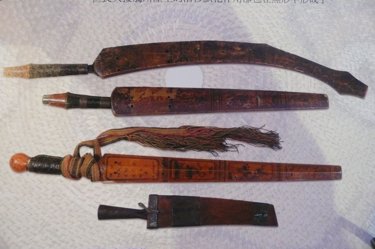

Varta, here is my tip ;-) : without knowing it, you already have seen two of the items from my first and sold Pingpu collection. These are the 2 knives you just showed as an example in the previous post.
Yes, these knives were mine at once. I bought them earlier from a dealer that is still a member of this forum, if I don’t make a mistake. I collected these 2 knives, and few others that I all sold to a Taiwanese private collector. As a collector, I needed the money to buy more stuff from the ‘raw’ mountains aborigines, which I focused on.
I know where these knives are now, and I still see them sometimes with the others I sold, when I go back to Taiwan. Were mine all the Pingpu knives that have been exhibited in 2007 in the prestigious National History museum of Taiwan, Taipei, during an important exhibit about Koxinga (also known as Cheng Chen-kung), the adventurer that drove the Dutch out of Taiwan in the 17th century. (http://en.wikipedia.org/wiki/Koxinga)
Here are the pictures taken from the catalogue of the exhibit (GPN 1009601014 - the catalogue cover is also pictured here after).
Varta, you can clearly recognize the 2 knives that you just showed us in your previous post, and other knives that were also mine at once. I considere all to be Pingpu, and they are described as such by the museum (see the museum Chinese comments).
Nicolas

I have just joined this forum and have a couple of items to share.
A Tao (Yami) knife with magamoag ancestor figures and a lalaw with red scabbard.
I have very much enjoyed this thread. Thank you all.

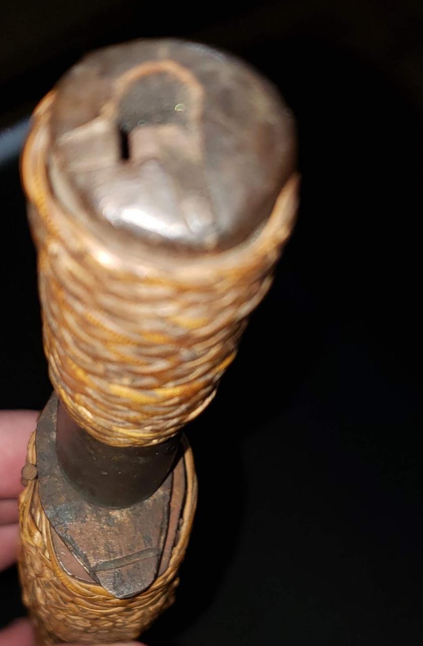

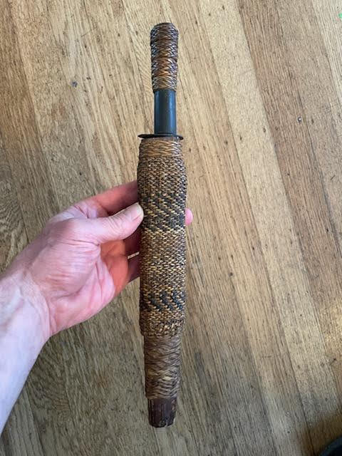

Recently procured this knife even without knowing its complete story. From an estate of an anthropologist who was on Orchid Island in 1937 and attributed as Yami (Tao), but not similar to any knives that I have seen associated with that tribe.
One potential idea is that it is from Philippines but transported to Orchid Island. He was also in Japan, Philippines, Indonesia and Malaysia.
What do you all think: Yami? Atayal? Batanes/Igorot? Naga?
Any help appreciated.
majacobson is offline   Reply With Quote

I'm not particularly knowledgeable, but interesting to ponder. The rattan bands on the handle handle would be equally at home on a Igorot or Atayal. The conical scabbard design is distinctive, some of the Formosa designs, under Pingpu, per Preliminary Classification of Indigenous Taiwanese Knives, have a similar shape. The ferule/guard is interesting but difficult to make out, is it painted? How thick is the spine? Perhaps a higher resolution photo would help.

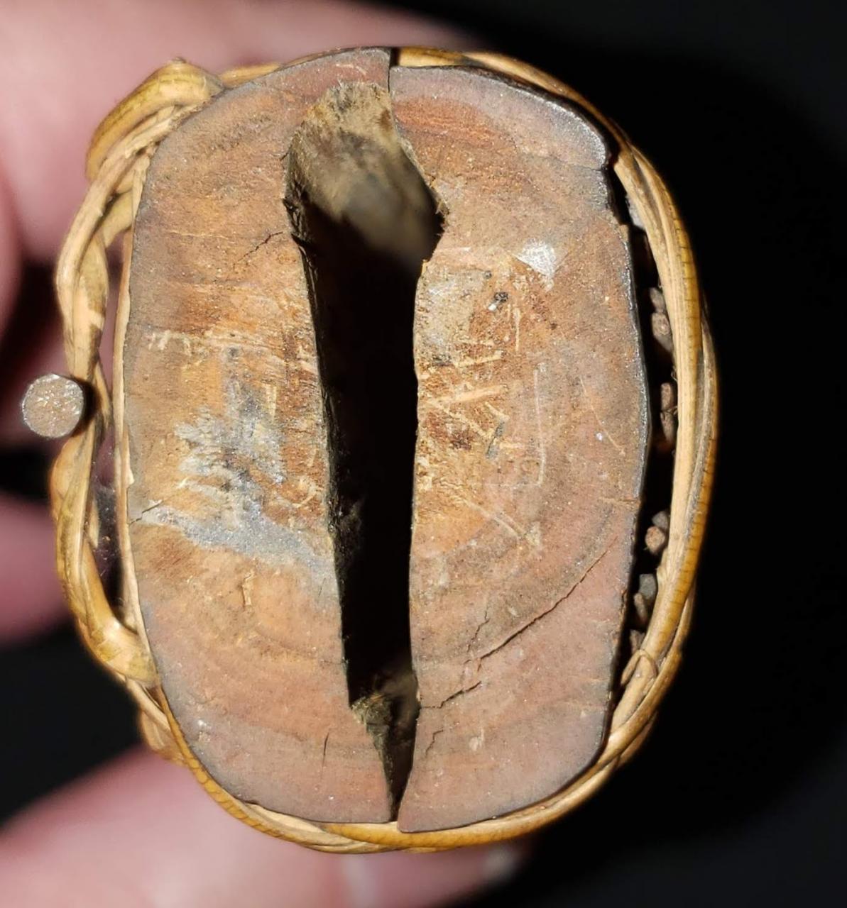

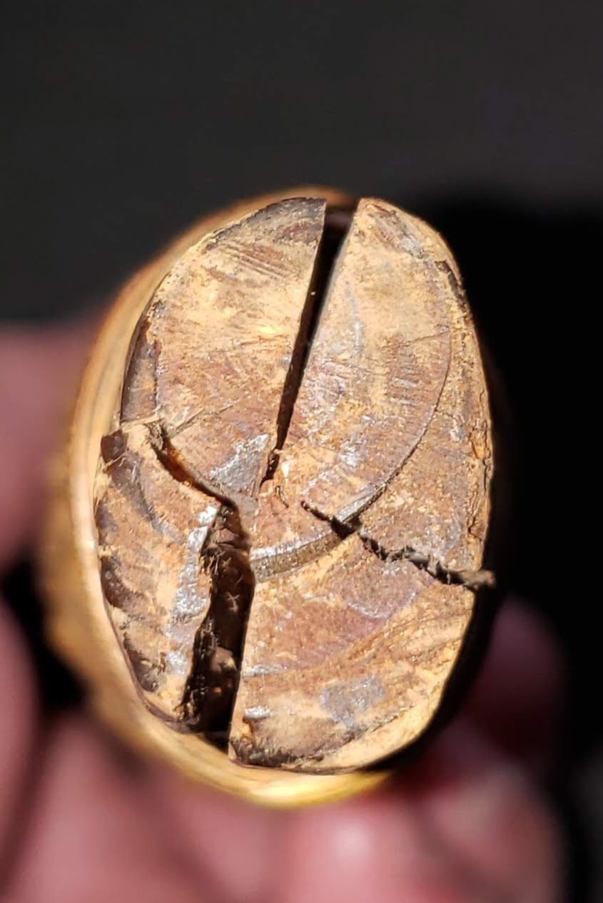

Thanks. Here are some addiitonal images. No paint. Guard, end of scabbard, opening of scabbard, spine (2 views)
Almost has a Montagnard feel to ferule and guard, perhaps also the pattern weave on scabbard. I wouldn't rule out mainland SE Asia from the broad geographic range it could originate from...
