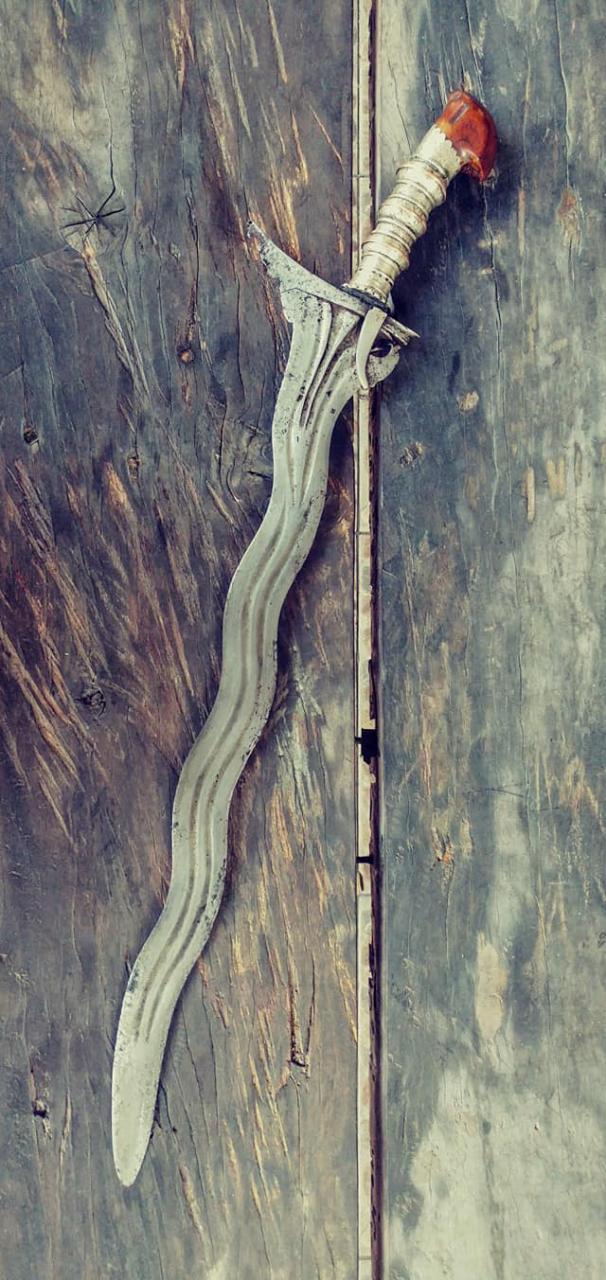

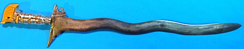

Just got this kris with a Luzon animal horn hilt. Open to comments and analyses. My initial assessment is that it's a late 1800s kris blade that was re-hilted in Luzon sometime during the American era, early 1900s-preWW2 (the knot holding the scabbard looks non-Moro). Also wondering if anyone else has a similar hybrid combo (Luzon peened hilt + Moro weapon). TIA!
#2 |
Join Date: Jul 2021
Posts: 58
Always interesting to see hybrid Filipino blades. I remember seeing kris with traditional hilt from Aklan or Iloilo and another one with traditional hilt from Rizal, it never looks bad.
#3 |
Posts: 7,422
From the top of the blade, the okie, and the scabbard, this was originally a Maguindanao kris that might have belonged to a datu, but rehilted and "roped" at a later time.
I LOVE the blade. I finished re-inlaying the missing silver into a similar design in another Maguindanao blade not too long ago. (I'll be working on the hilt sometime in the near future....). |
#4 |

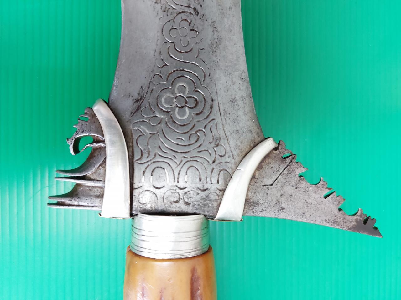

I agree with Jose that the blade and scabbard are Maguindanao.
Blade looks turn of the century to early 20th c. to me (a close-up of the base of the blade taken exactly vertical from the plane of the blade really helps). I doubt that this is a peened tang though: While it is possible they extended the original tang, this looks more like a nail holding the pommel plate and washer IMHO. Xas, can you possibly sense with a really strong magnet? The hilt looks like Filipino work but could as well be US/European (that's quite a big piece of stag). Ferrule is Moro. The rope/knot work on the scabbard most likely being added by an US service man or later owner. Regards, Kai |

Kai, here's the gangya pic. The blade measure from the base of the gangya is 20 inches long. It's monosteel, very light, and flexible. The fuller is wide and deep. It's the lightest sword I've ever held for its size, to the extent that I can do flicking moves with it. I ran a magnet over the hilt; it's confirmed that it's a peened setup. A guy familiar with Tagalog peens commented that the "punch" used (the 'nail' at the butt) looks very much like a ship rivet. It's the largest punch he's seen used on a traditional blade. I've disassembled kris before with abnormally long tangs- some had their original tangs extended (additional material welded), or seemed to have been grafted with replacement tangs. Whichever the case it was for this particular kris- whoever put together this peened setup for the kris had a good sense of the wield "balance." Also to add, regarding possible location of retrofitting: I've seen a few American-era Batangas or Cavite-made blades utilizing the same material (antler) and peen setup, so I'm betting this piece was modified there. There were also Pangasinan and Ilocos Norte blades of the same era made of antler, but their peen setup was different. Last edited by xasterix; 27th August 2022 at 10:45 AM. |
#6 |
Posts: 7,422
Kai I agree with your dating of the blade. My nearly identical blade has lamination, and thus I would put mine at a little earlier.
Xasterix, I would agree that this type of peening or nail is Tagalog. |

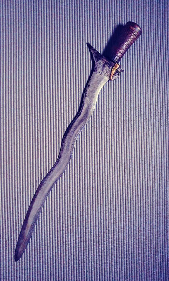

Sorry I don't have better pictures...but here are two of my friend's archaic krises which are both monosteel.

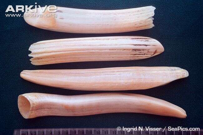

Also wondering José, how you have identified this pommel as Dunong (sea cow). Dunong tusks can be up to about 25cm, but they tend to be rather slim. I'm not sure they have the mass for creating a pommel like this. Is it possible it might be whale tooth instead. And also also wonder how you place this in the 17th century? It is a simpler form than what we generally consider to be "archaic" form keris from that era. Is there something besides it being a slim stabbing style form that leads you to such an early dating? |

Hi José. I don't know if you missed this question or not, but i am still curious. I am just not sure how one can carve a relatively chunky kakatau pommel out of dugong ivory.

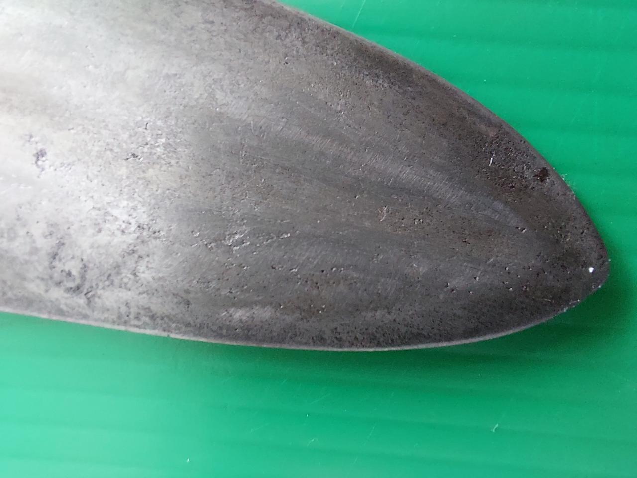

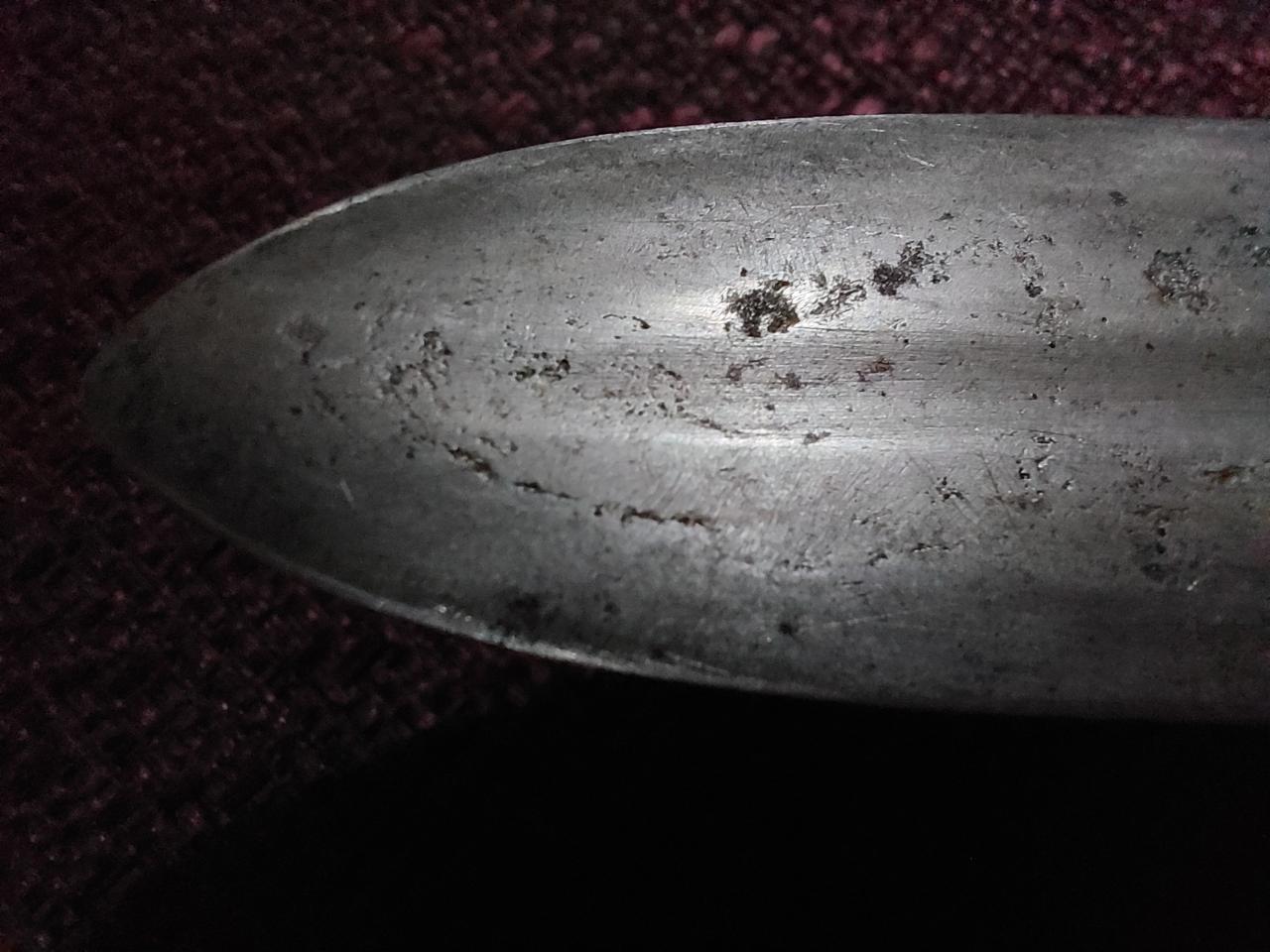

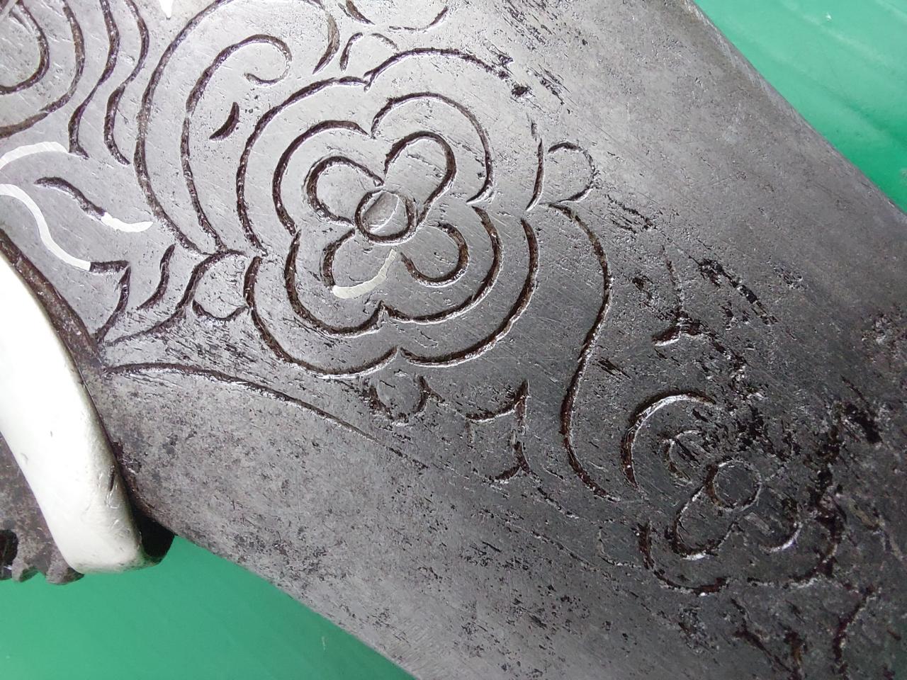

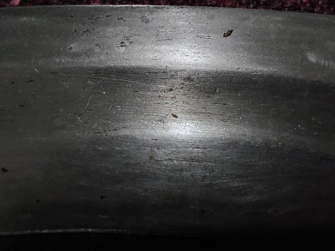

Here's some pics...I only used the "macro" mode on my mobile phone camera though, and the shots appear somewhat dark even with adequate lighting...hoping they'll still offer clues.
#25 |
Posts: 7,422
There is another possibility that occurs to me years later - could what I have be hippo ivory, because the grain structure is not elephant.
#26 |
Join Date: Sep 2019
Location: France
Posts: 209

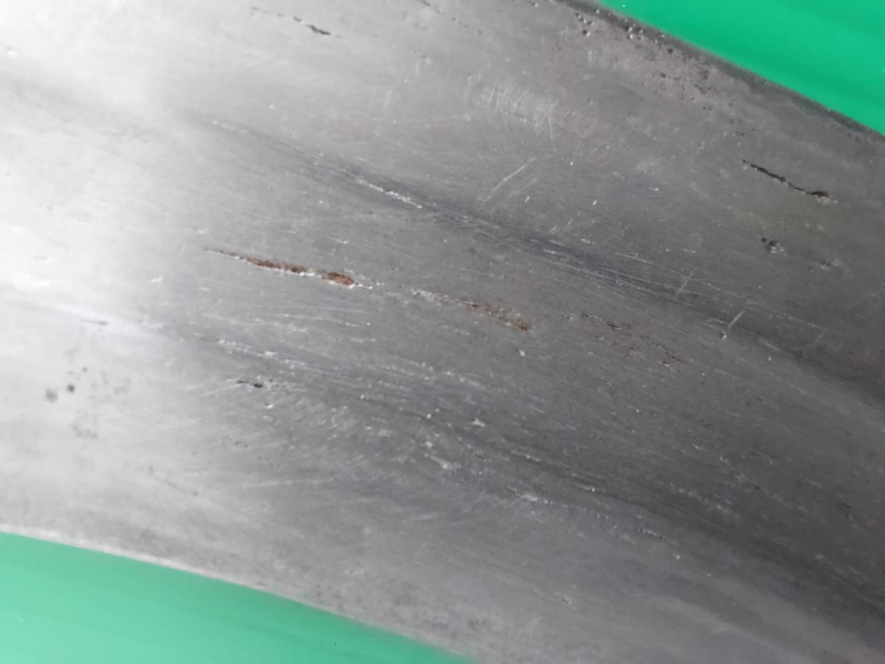

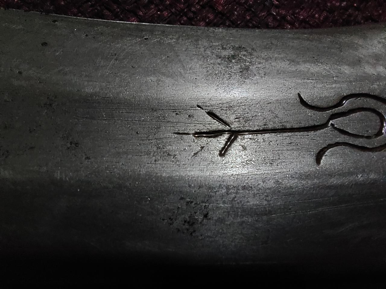

Hi XasteriX (
) In my opinion, some of the visible flaws would indicate a forge folded structure. Did you do the etch on it ? (it seems to me from the quench line quite discernable on your above picture that it was etched). I think it could be worth to open a window on some part and to etch it again. Could show us more. Last edited by JBG163; 5th September 2022 at 08:05 AM. |
#27 | |
Join Date: Oct 2018
Posts: 716
I'll etch it again as you suggested though. The previous etch on it was a side-effect of cleaning it via white vinegar (it originally came to me partly rusted).
#28 |

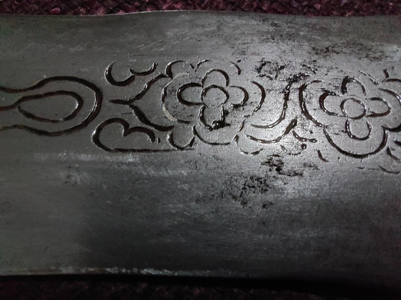

Posts: 7,422
In the tip of Xasterix's kris blade it does look like laminaton. Sometimes an etch will not reveal this because the steels are too close in carbon content, but etching will usually bring most of them out.
Also it looks like the groves once had silver inlay. |

Can you show us some close-ups of the pommel. It could be hippo or possibly whale tooth. I was just remarking about your original statement as seacow because i don't believe dugong tusks have enough girth to be able to carve such a pommel from it. It certainly looks like some kind of ivory though. Close-ups might help answer your question.

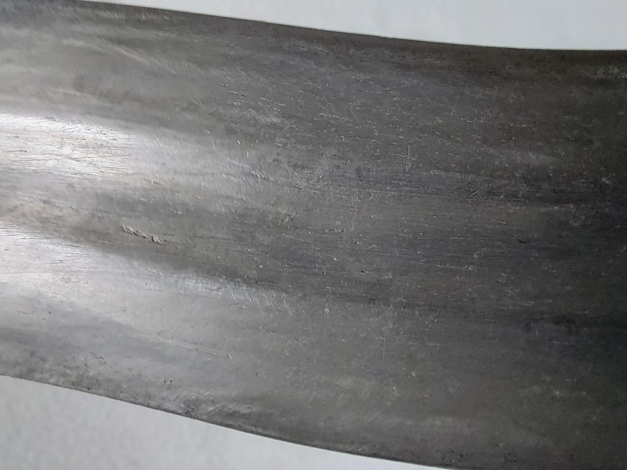

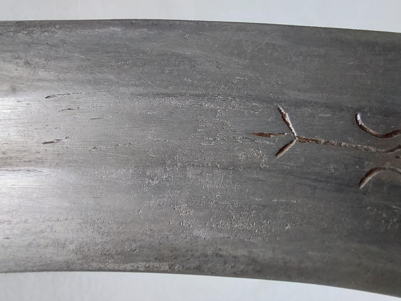

Join Date: Oct 2018

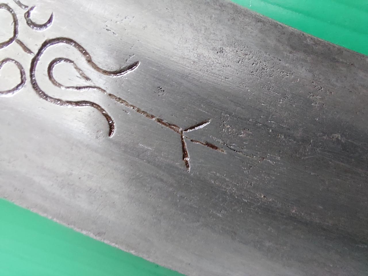

Posts: 716
Finally got to etch and take better close-ups of my kris blade:
