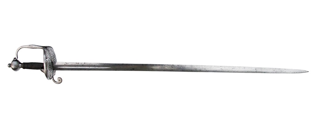

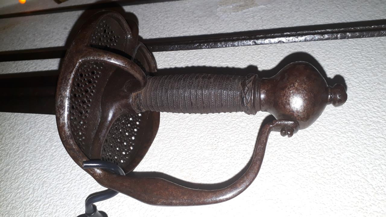

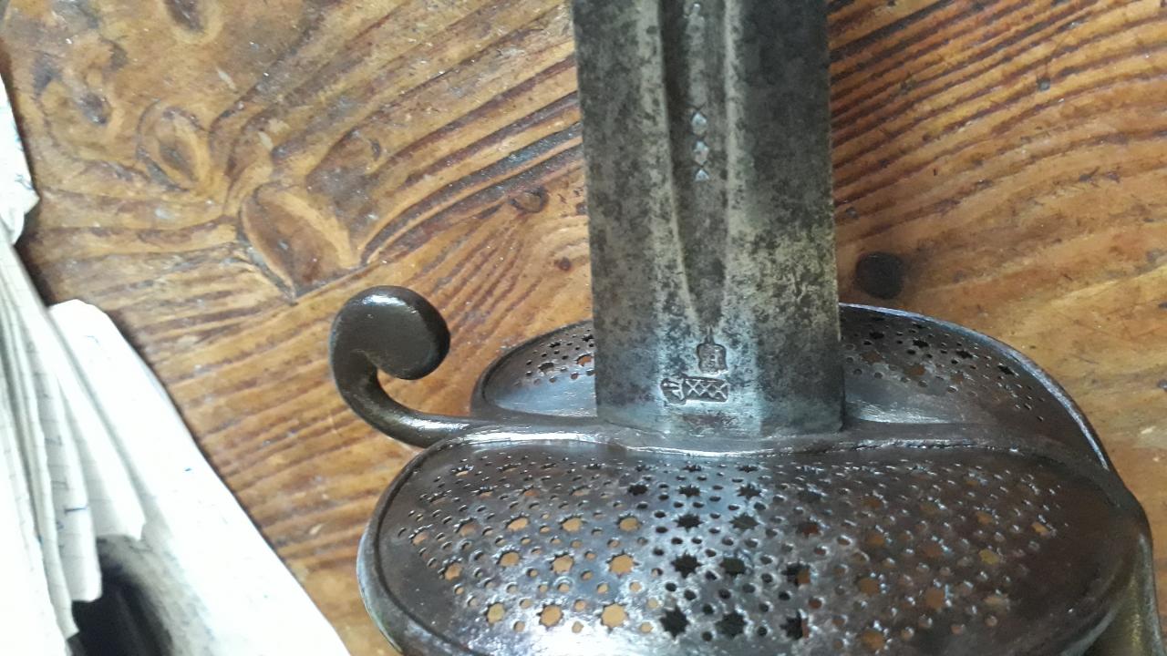

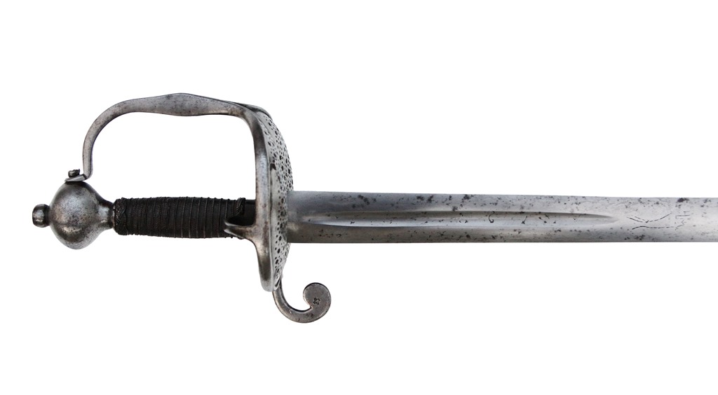

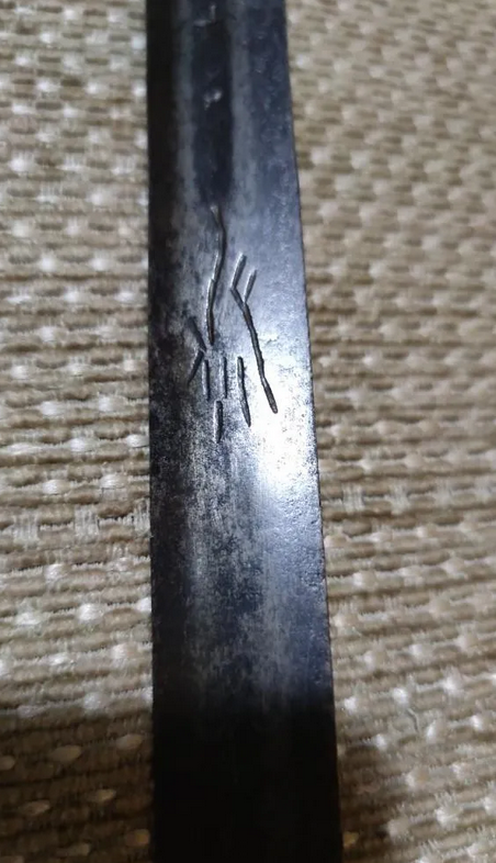

O.L.106 cm ; blade L. 91 cm; blade width at hilt 3.4 cm.

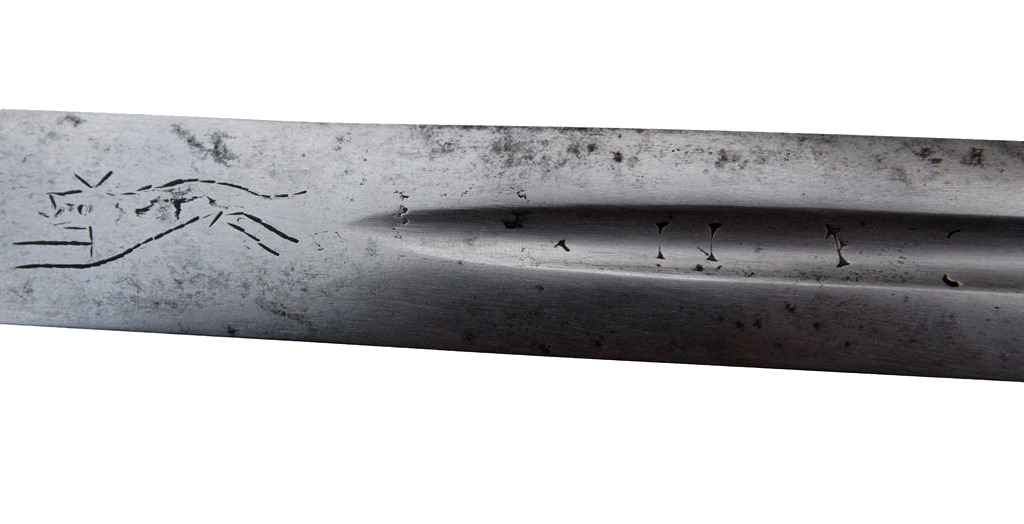

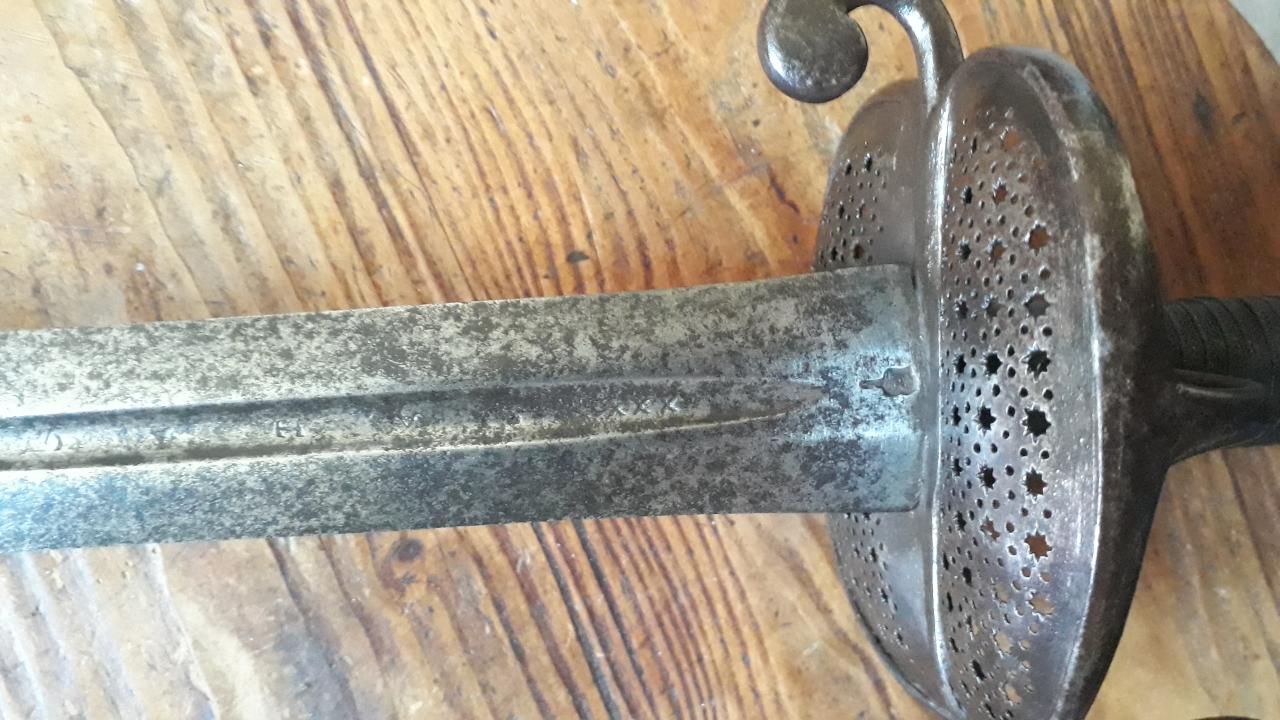

Passau wolf in the the two sides.
Any comment on it would be welcome.
Best
Cerjak

I think the mark under a crown with threes stars/crosses is probably the townmark of Amsterdam/NL
corrado26
Exactly!
Rotate the image 90 degrees counterclockwise and you get a shield with triple "x" and a crown (partially ground) on top.
Amsterdam.
Old 12th November 2016, 04:08 PM   #4
Posts: 10,862

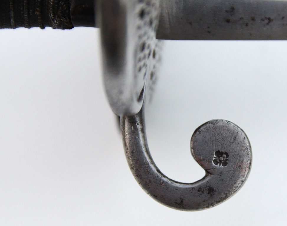

I think the mark on the quillon is termed the kleeblatt and represents a clover, but need to get into notes for more. In any case it was often on the quillons of these Dutch swords. The running wolf is interesting as there were a number of Solingen smiths who left and went to the Netherlands as well as those going to Spain, England, Russia.

Thank you all for your answer about the marks so it is a dutch wallone ,

The belief is that these walloon swords are made in Solingen, as evidenced by the fact that some swords have Solingen maker marks.
This is supported by the running wolf, typical for Solingen in the first half of the 17th century.
almost all walloon swords of this type bear an Amsterdam town mark and a flower on the quillon final. This flower mark can be a mark of Solingen Smith.
fe Johannes Kirschbaum has a three petalled flower.
most of those walloon swords are signed with Sahagun or misspellings like
sahagom sachgom Sahacun ea but not made by this famous swordsmith of toledo.the name Sahagun was only used to designate a certain Quality.
These swords were made on commission for amsterdam arms Dealers in great numbers. It is an assumption that the French captured These swords
in 1672-73 in the Netherlands and introduced the epee Wallone in the French army.
a nice Detail is that the pommel is hollow and made of two halves.
best,
jasper

I have seen noted that the distinctive four petal 'kleeblatt' is characteristically on the quillon on virtually all Dutch Walloons.
I am wondering if this four petal stamp is indeed on all, if not most Dutch Walloons, and would this convention have been placed at assembly in Koln along with the stamp or mark of the intended chamber to which the sword was destined?

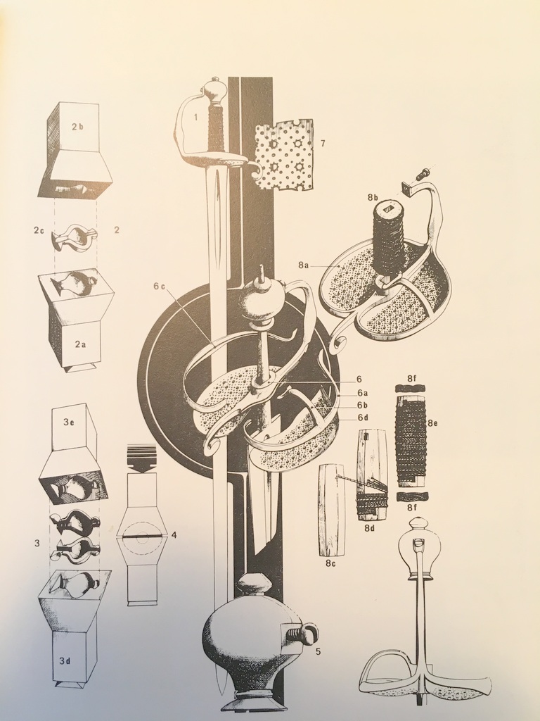

Really amazing ! From where did you find this document ?
Best
Jean-Luc

Hi Jim,
JP Puype dedicates the manufacture of this epee wallone to Solingen,see Attachement, Köln is very interesting, do you also have support for this.
all dutch epee wallones have the four petalled flower and the Amsterdam mark. other marks on this dutch type are not known to me
one exception is known to me, an epee Wallone ex Visser collection with Toledo TO mark, a running wolf and 1414 inscription, maybe the blade is a replacment blade.
I have no record of solingen blacksmith who went to the Netherlands, I know a few who went to spain. (a much better climate )
but... there was a lively arms trade between Amsterdam, solingen and Passau.
best,
Jasper

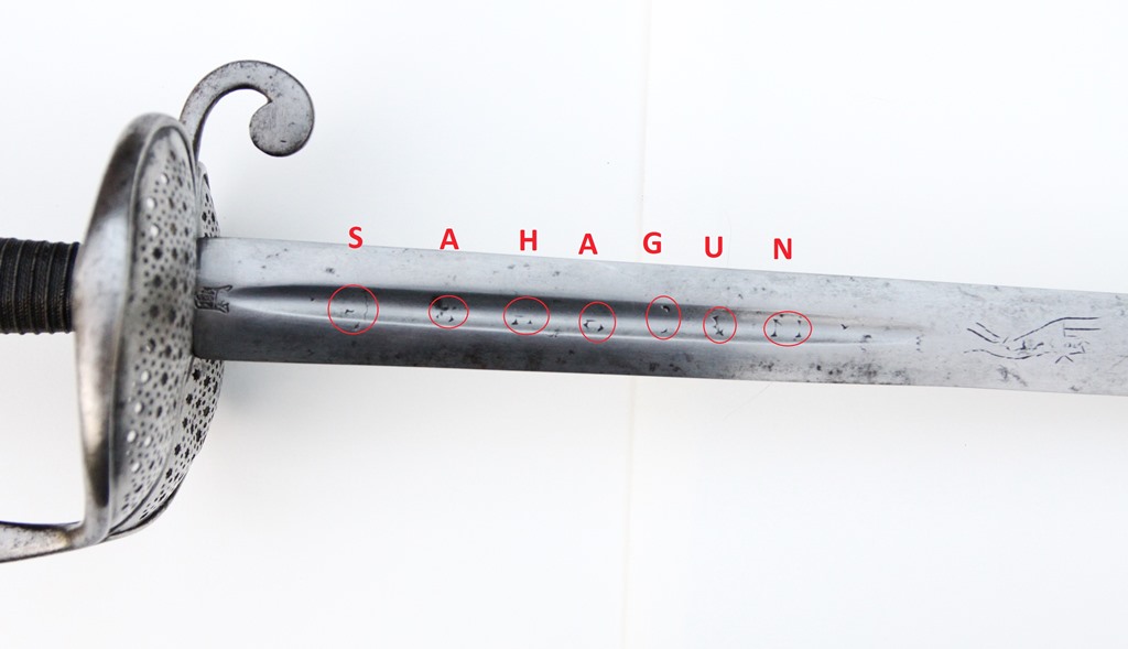

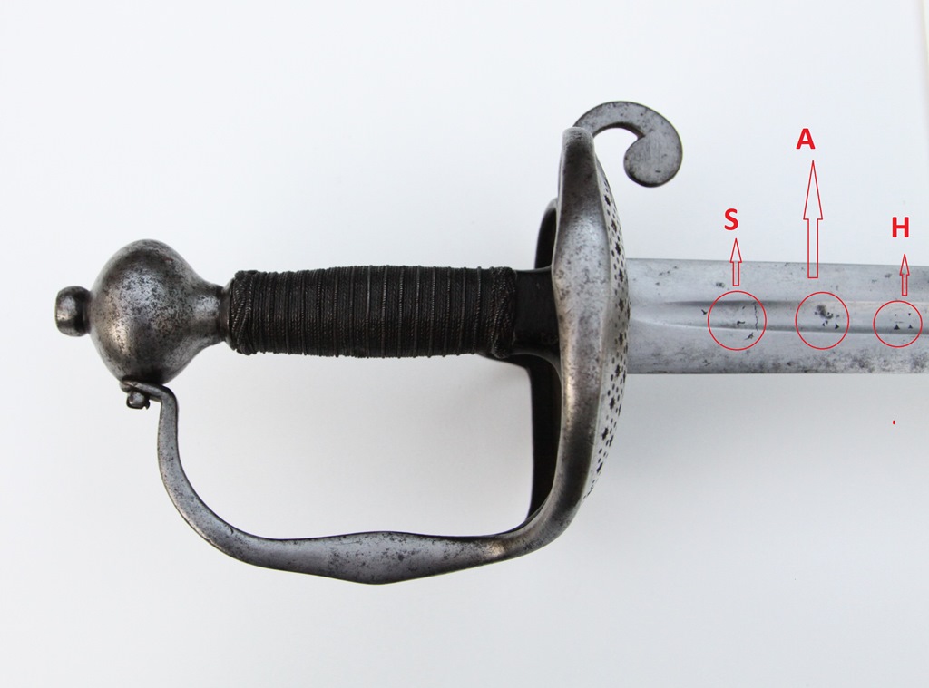

@Jean Luc, what is written in the fuller.... Sahagun?
@Jim
It is possible mowbray refers to Dutch because Sahagun and other spellings of it occur on these wallone swords, nevertheless they are made in Germany.
Old 14th November 2016, 04:25 PM   #14
Cerjak
Cerjak's Avatar
Join Date: Jan 2012
Location: FRANCE
Posts: 1,065
jasper,
Yes with good eyes no doubt it's Sahagun !
I will pm you the hd pictures.Thank you Japer you made a complete analysis for this sword .We even have the original draw !
Best
Jean-Luc

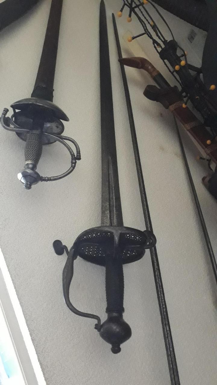

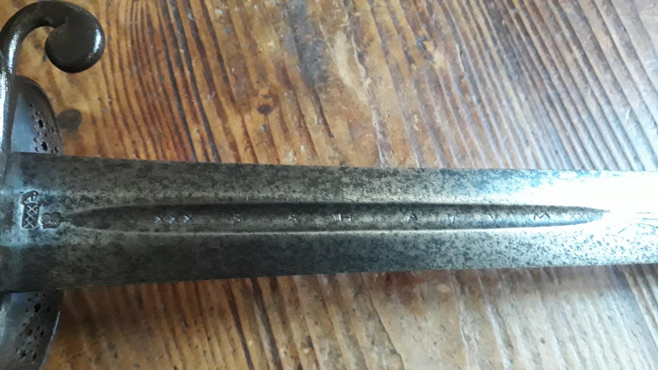

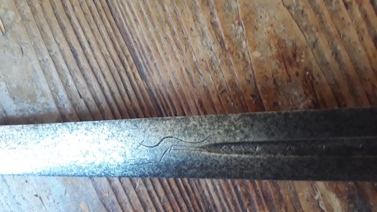

Both numbers 1414 and 1441 appear together with the Passau wolf in XVI century sword blades. These magic numbers are multiples and combinations of the number "7", a divine number, thought to be a cry for God's help, like the Arabs used the "Allah il Allah". Reference to the bible ', from the book of Job (old testament) chapter 14 paragraph 14: Do you believe that dead a man will live again? Every day that i spend now in this war, i'm waiting until my mutation arrives.. Luther, well heard in XVI century German, interpreted that from the Greek as: When a man dies he will be reborn. So i will continue to fight until my time comes.
See here a XVI century Portuguese Colonial sword with the magic number "1441" and the Passau woolf engraved on the blade (Collection Rainer Daehnhardt).

Quite possibly. I first encountered the idea that these numbers could refer to bible verses in a museum in Northern Sweden, and find it plausible. Not sure why the colon doesn’t appear though. Bible verses were familiar with most in the Protestant Northern Europe (including Amsterdam) and a reference like that would have been understood at the time.
It could also refer to John 14:14: ”12Verily, verily, I say unto you, He that believeth on me, the works that I do shall he do also; and greater works than these shall he do; because I go unto my Father. 13And whatsoever ye shall ask in my name, that will I do, that the Father may be glorified in the Son. 14If ye shall ask any thing in my name, I will do it.

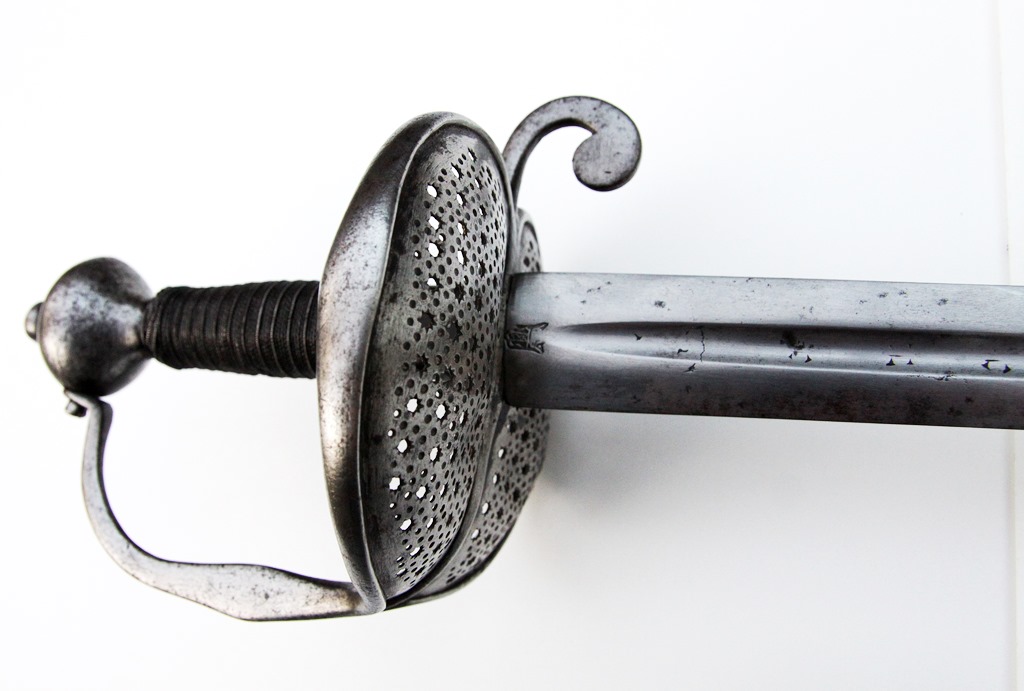

It's been a kind of Walloon-themed week for me. I've been looking to acquire one of these recently, and today by sheer coincidence I ran into one with a scabbard at the Lakenhal museum here in Leiden. It's missing one of the guard plates, but it's an impressive sword to see in person. It has sahagum and a stamp on the blade, the running wolf, and I think I saw the flower on the bottom of the quillon bulb. They even made a copy of it in glow-in-the-dark plaster! My phone/camera ran out of batteries (and is terrible in low lighting anyway) but next time I'm there I'll take a few more closeups of the markings.

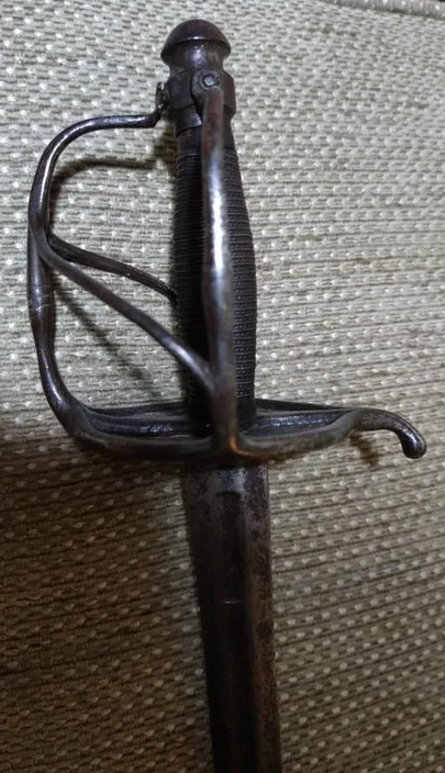

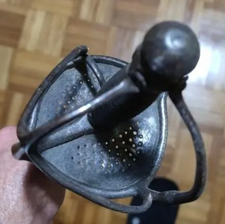

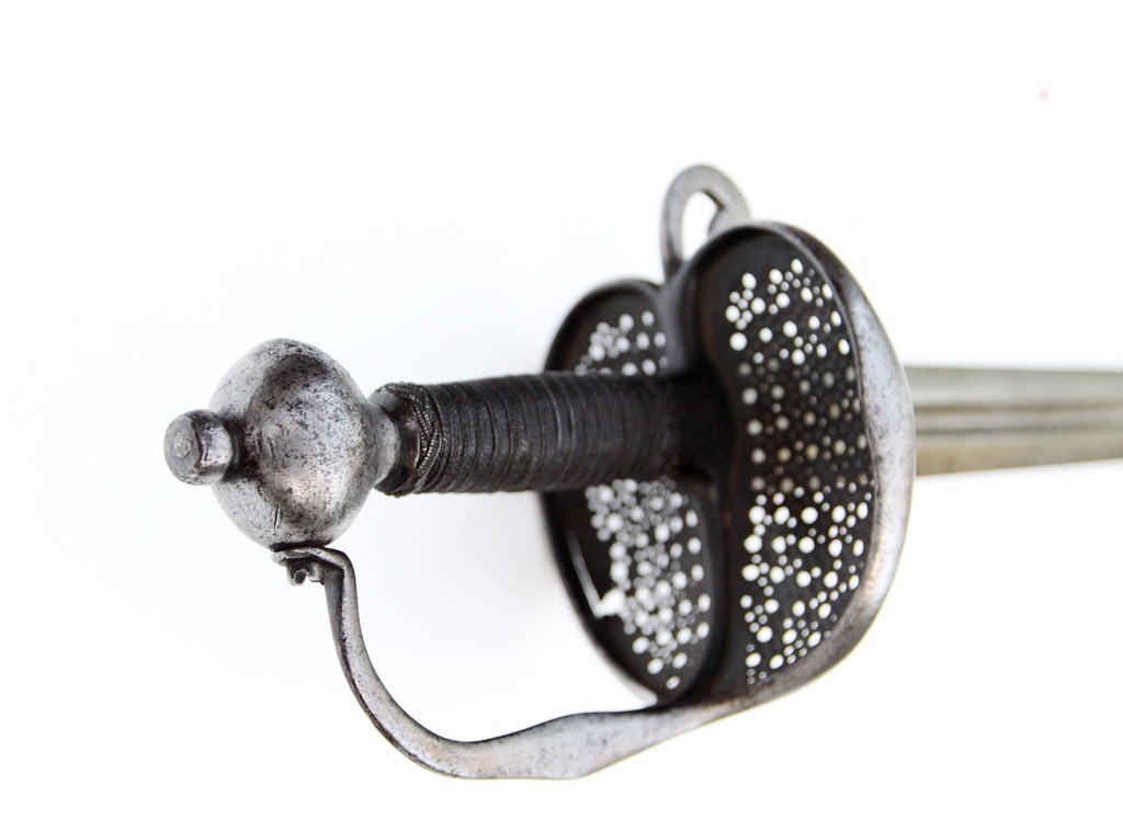

I have also one of those walloon swords made for the French, with the Solingen wolf and 1414.
What I have never seen before is a pommel like the one this has.
I think the Pommel is new

Originally Posted by cornelistromp View Post
Hi Jim,

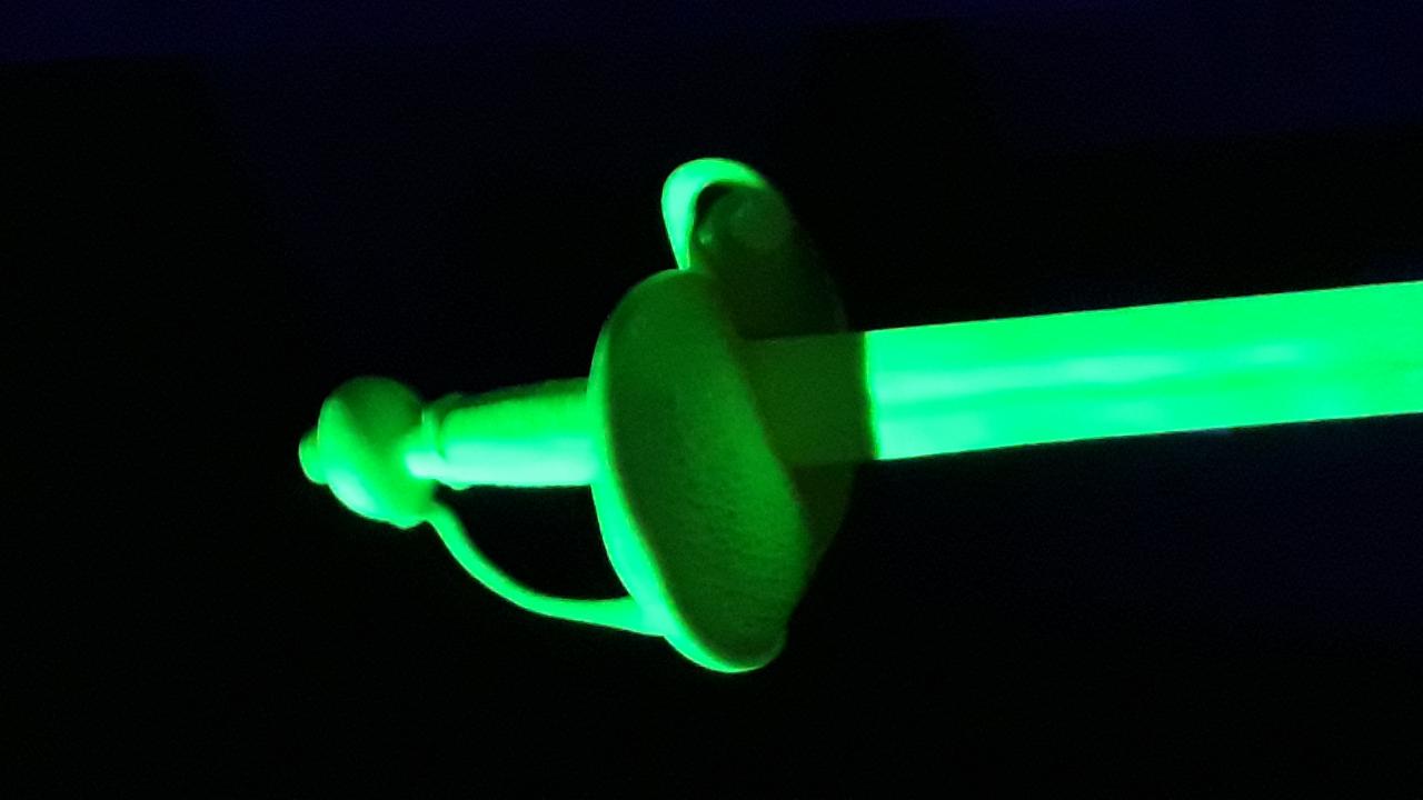

I bought a Walloon sword of this type recently (with a bit of help from ulfberth who helped confirm its authenticity), right after I saw the one at the Lakenhal museum here in Leiden. A bit more patina than the one in this thread, but most of it superficial, and I kind of like this look (and I like that it's quite sturdy).
One thing I found interesting, and the reason I'm adding it to this thread, is that it is lacking the kleeblatt on the quillons. It is still rated tripple-x, however , and has "xxx S A H A G V M xx" markings and of course the Wolf of Passau on both sides.
(As usual, sorry about the slightly jittery pictures. I only have my phone's camera and it seems to be literally impossible to take a picture that isn't motion blurred or out of focus.)
