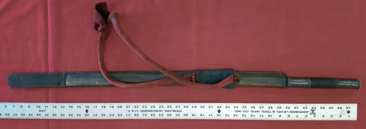

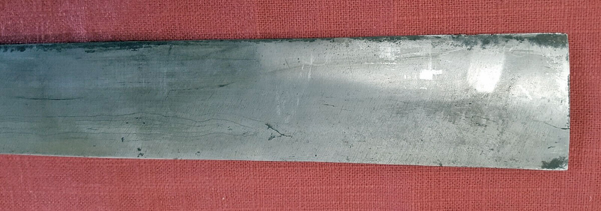

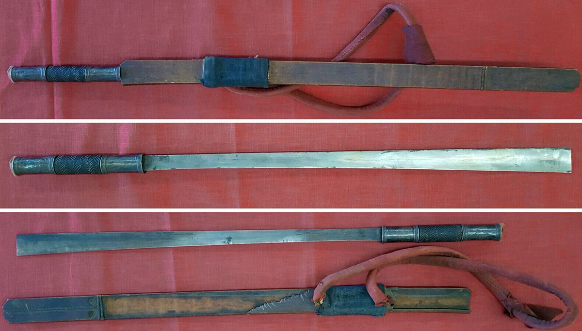

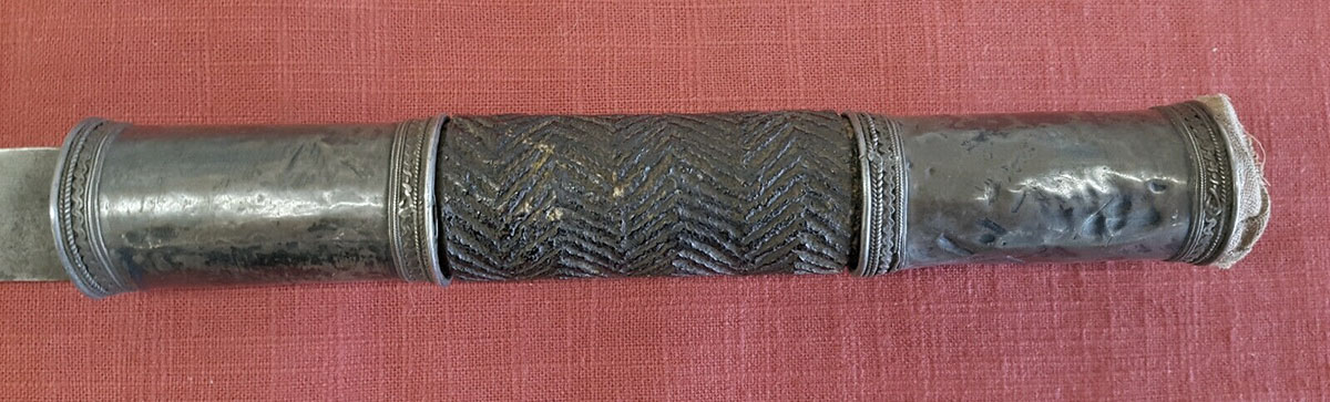

Just picked this up off Ebay. It has an interesting mix of design features such as the hairpin blade, silver work, and strange jagged carving on the shoulder-carry open-scabbard. Photos are from the Ebay sell page.

Would agree with Kai, look like you have got a nice Achang HuSa dao!
http://www.vikingsword.com/vb/showth...highlight=husa
Old 16th October 2020, 01:26 AM   #4
Posts: 4,396
Hi Jeff,
While the maker of this blade is most likely from Yunnan, the customer was probably some distance from the HuSa homeland. There are Achang living in northern Burma/Assam. These long-bladed, straight, square-ended dha/dao are most commonly found in Assam and north-west Yunnan. The most common group in Yunnan to use this type pf sword are the Lisu (who are related ethnically to the Kachin). Scabbards are typically open-faced, and the toe projects well beyond the end of the blade.
You have found a nice example. The hilt looks to be Shan in style, and there is a close relationship between the Shan and Achang in south-western Yunnan.

Very cool sword. Do I understand correctly that Robert did the silver restoration work on the scabbard?
Originally Posted by Ian
Hi Jeff,
Ian.
Thanks Ian. Great info.
Old 17th October 2020, 01:51 PM   #6
Posts: 9,207
Hi Jeff,
Thank you! Yes, Robert did the restoration of the scabbard and worked the fittings new from brass, they are silver washed.

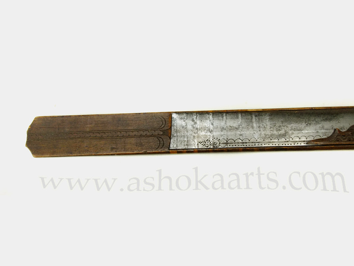

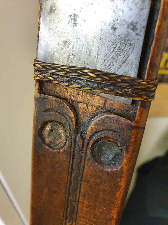

Any thoughts on what was set in the two round depressions on the scabbard foot? There is a gummy resin at the bottom that was likely the adhesive used. One of these has shiny foil-like residue stuck to the resin.
Incidentally I found another example of this scabbard style on Ashoka Arts website.
Old 1st June 2022, 12:15 AM   #11
SidJ
Join Date: Apr 2020
Posts: 207
Those depressions contained circular raised metal button like fixtures.
