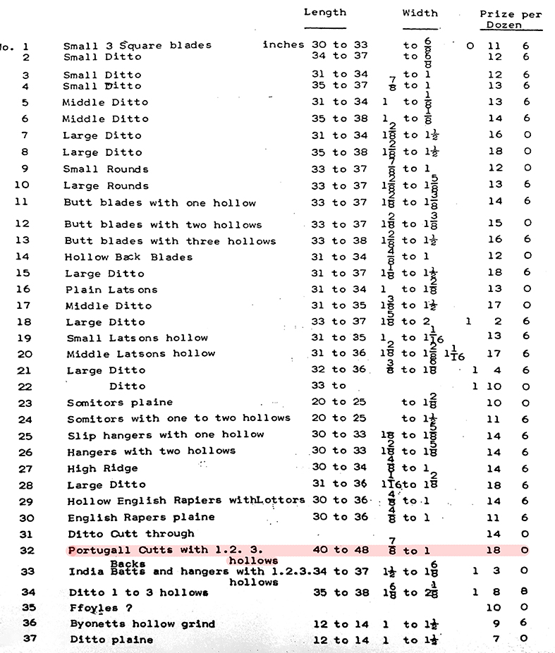

Perhaps someone can help me with this issue:
I've previously published a list of blade types Shotley bridge workers were contracted to produce in 1703 (I've attached it again below) but I am at a loss to know exactly what styles of swords would have been in use at that time.
I am aware of the various smallswords (civilian and battlefield) and the brass hilted (Walloon?) horseman's swords (see below) but these were not munitions grade.
Shotley Bridge were turning out thousands of blades for the Tower armoury's general issue, right through the first half of the 1700s and a bit beyond, but it is the early ones that escape me: what was the common British cavalry/soldier/seaman carrying in 1703?

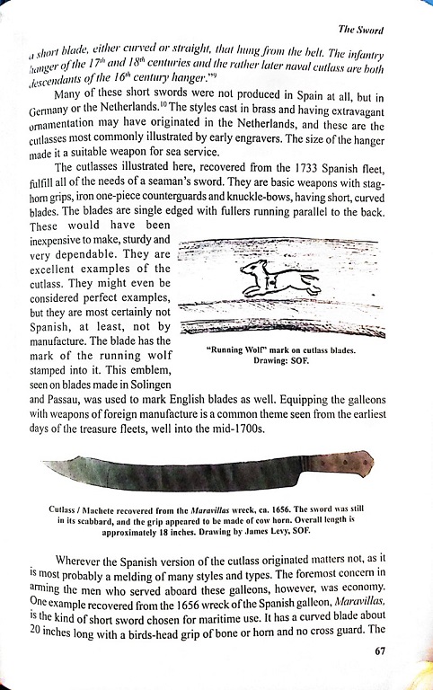

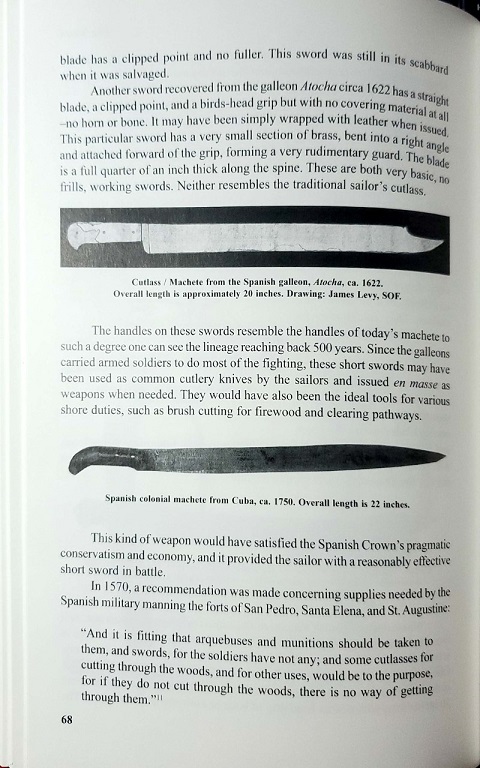

From 17th century Spanish wrecks clipped tip machetes are seen.
Were clipped point swords being produced as seen here as hangers and.or machete/cutlasses, and were these indeed the mysterious 'scimitar'?
As seen in illustrations: Figure of Avery shows clipped point (1678); next is machete from Spanish galleon Atocha (1622); an example from galleon Maravillas (1656); plate from "Schwert Degen Sabel", Seifert (1962) which shows that by mid 18th c. these clipped points were in some degree termed 'pandour point'.
The two pages from wrecks are from "Small Arms of the Spanish Treasure Fleets" Noel Well, 2006, Keith you will note the obvious error referring to the BTF (bushy tail fox) with H as a running wolf with no reference to the profound differences in the German 'running wolf' and Harvey bushy tail fox, suggesting they were the same as used in both England and Germany.

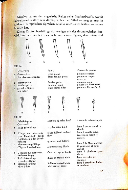

The details of blade shapes – especially the cross-sections – captured my attention in several respects, mainly however: Bild 67: blade B. refers to 'grooves' and fullers, which is certainly at variance with common parlance that refers to all as fullers, and should also actually indicate the shape of blade C (a Montmorency) not B.
A fuller is actually the name of the tool used to hammer in a groove and is now called a former; what that page refers to as a fuller is actually a hollow.

Firstly: Fernando, in the list of blades required of the SB smiths that I include in this thread there is something I highlighted called a Portugall Cutt 40 - 48 inches long with 1, 2, or 3 hollows.
It is quite long at 48 inches; do you know what this is?
Jim, Noel Wells talks about "cutlasses illustrated here" recovered from the 1733 Spanish Fleet and having the BTF on the blade; did he provide illustrations of these swords?

Old 19th April 2022, 06:12 PM   #7
Red face Just speculating ... that's all.
Have i not seen this chart before ? .
Not so easy to figure out what the 'CUTT' term is, most probably old English, even lexicon, that i can not relate to Portuguese terminology. But judging by the specs and the period in question, these would be blades for cup hilted swords. Those were what abounded by then; you can see everyone holding one, even portraid Kings, during the war of restoration 1640-1668 ... and long after. The 48" length is o.k. for these swords ... and within the law. Assuming these lengths in the chart are for the blades including the tang, this corresponds to 'little' over the full (1539 law) sword length, which was 5 palms (spans)... although we know these were 'regularly' exceeded. Concerning the width, 7/8" to 1", this seems to be that of non military cup hilts. As for the 'HOLLOWS', we certainly assume this means fullers. Over here we call them gutters (goteiras), following the famous jazz talk:
The names «bleeder» and «gutter» are alluding to a supposed effect, attributed to this type of notch on the blades of white weapons, of promoting the bleeding of the victim stabbed by the weapon, by offering a channel through which the blood could circulate to outside the body, while the blade was lodged inside the victim. In theory, they could also be used to combat a putative suction or suction effect that could be provided by sticking the blade too deep, which would make it difficult to remove the weapon from the victim's body.
However, such effects have never been scientifically confirmed, and the medieval accounts that mention them are currently believed to be mainly apocryphal.

Old 19th April 2022, 06:57 PM   #8
Default Further speculation ...
But if we look at blades #30 and #31 in the chart, the refference to the second one only appears to raise the price, for cutting through a blade identical to that in #30. Could in this case the term CUTT mean blade piercing ? And the double TT only due to the chart writer poor spelling ... as seen in other terms in the said chart ...

Default cut and thrust

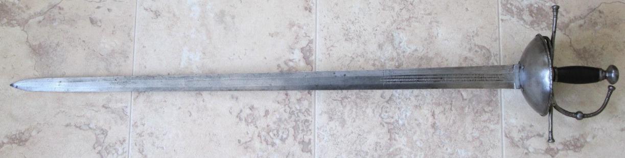

Hi Fernando. It may well be a spelling error.

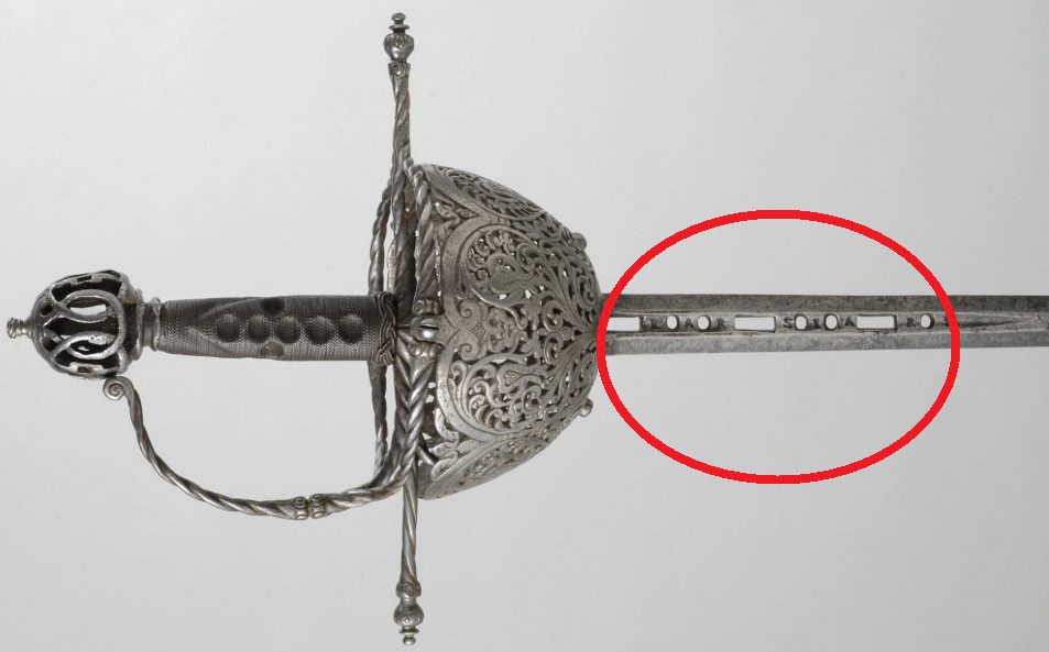

Is this what they mean by three hollows perhaps (see attached, found online):
What is a cut through blade? I'm not certain I am aware of this.
Old 19th April 2022, 07:50 PM   #10
Originally Posted by urbanspaceman View Post
... Hi Fernando. It may well be a spelling error. Is this what they mean by three hollows perhaps (see attached, found online):...
Yes Keith, that's what i (i) figure.
A pierced blade ... i (i)would say ...
Old 19th April 2022, 10:20 PM   #11
Posts: 10,858
Was Birmingham selling swords to the Spanish at that time?
Sorry forgot to add that page. Birmingham was a recipient of blades from Germany in degree, just as was Spain in this period. It does not seem that Harvey used the BTF until 1740s, though as you have discovered the BTF may well have originated with Oley in Shotley prior to this.
If not mistaken, this drawing of the hanger blade from the 1733 wrecks with running wolf seems a bit out of context with the Spanish fleet. As seen with the hanger from Henrietta Marie, these staghorn hangers were more English than Spanish, and the Running Wolf appeared on blades from Hounslow.
Birmingham wasnt producing much in 1733 as far as Ive known.
Perhaps these details out of context ? we know the H was only on BTF, never on the running wolf, and it seems only SH occurred....there might have been an H only case.

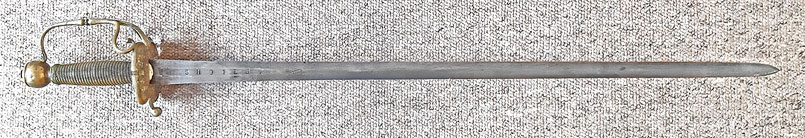

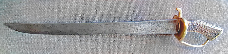

This brings to mind my curious clipped point, brass hilted, stag grip machete (see attached) which you suspected might be for sea-going work.
