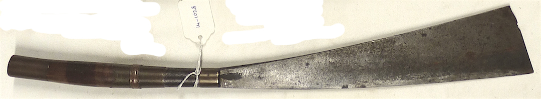

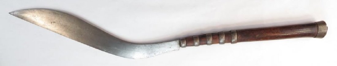

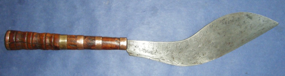

Greetings, in the tradition of the other "show us..." threads, was curious how many members have panabas. To start off, here's mine. 17-inch blade, 14.5-inch handle. There are geometric patterns on the handle that provide a secure grip. Thickest part of spine is 0.5 inches or 1.27 cm. Looking forward to seeing more panabas, TIA!

Red face
Hello Xas, that begs the question: How do you differentiate between panabas of Maguindanao vs Maranao origin? Thanks in advance!

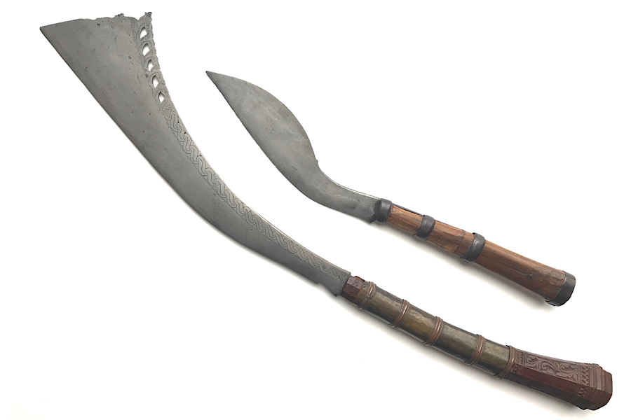

To start things off, here a few examples I'm currently taking care of:
(Pics courtesy of Gavin & Oliver)

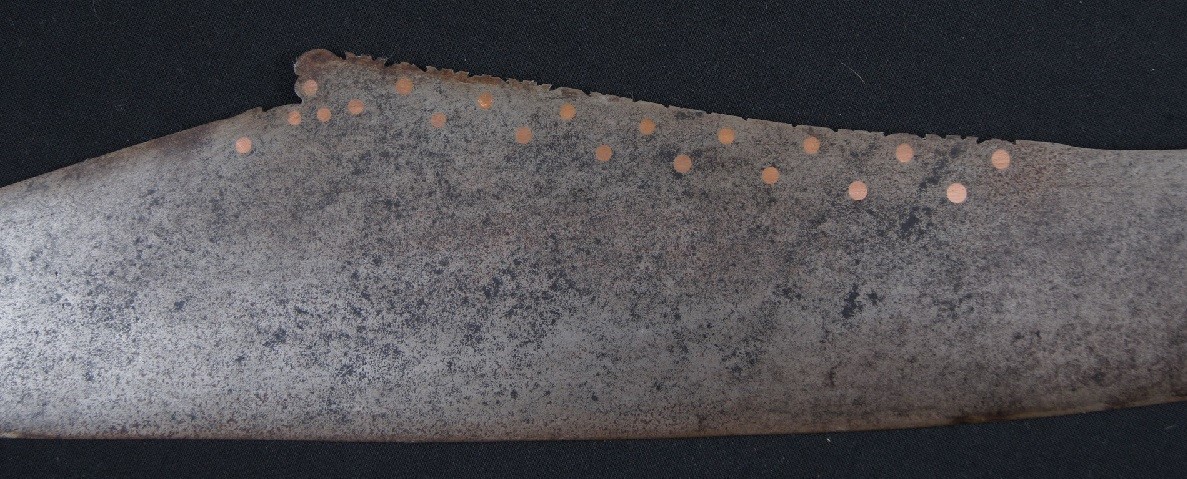

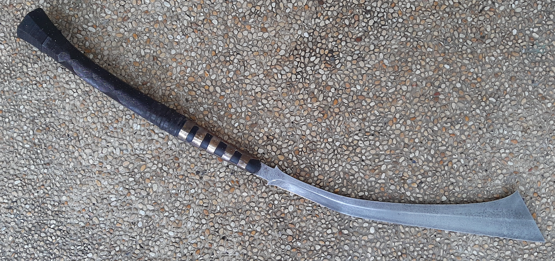

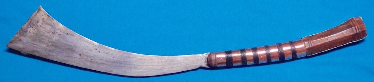

Here's mine. Interested to see what you knowledgeable folks think of it.

Hello Chris,
Nice one! (Let me know whenever you decide to let it go... )
It sure does look like it was ready for a spike; seems it was originally intended without a spike though. Any hints from close examination?
Old 14th February 2021, 09:18 AM   #13
Mefidk
Join Date: Nov 2005
Location: Denmark
Posts: 157
No indication that it ever had a spike, looks like it was made this way. The blade is heavy duty, 1cm thick at the base - I would definitely not like to be in the way of anyone swinging this!
Are the copper filled holes common decoration on these?
Chris
Mefidk is offline   Reply With Quote
Chris
Agreed, would hate to be on the receiving end of that! Uncommon decoration IMO, I've only seen 4 so far with that inlay, yours is the 4th. Great piece!

I believe there are a couple of examples in the archives - some in the now defunct UBB forum though. Certainly not common but usually similar to decor on kampilan.

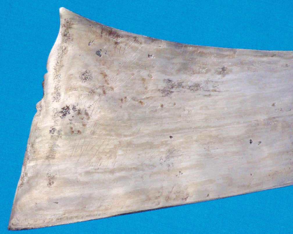

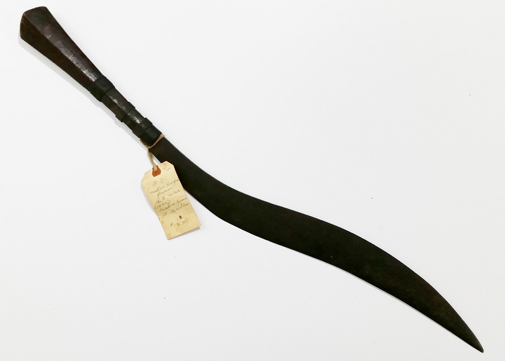

Here are my both examples, both are padsumbalin panabas, one big and a small one. The big one I don't have at hand but will receive it soon back with cleaned blade.

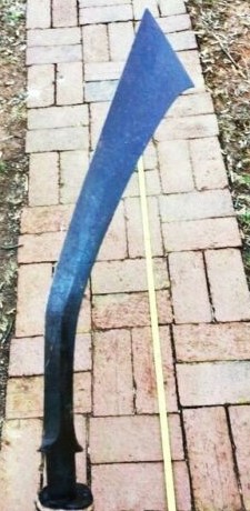

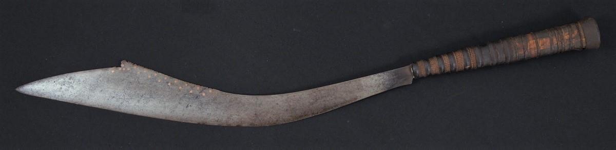

And I have this small one but only the blade, the handle which comes with it isn't the original one, it's a small one as well.

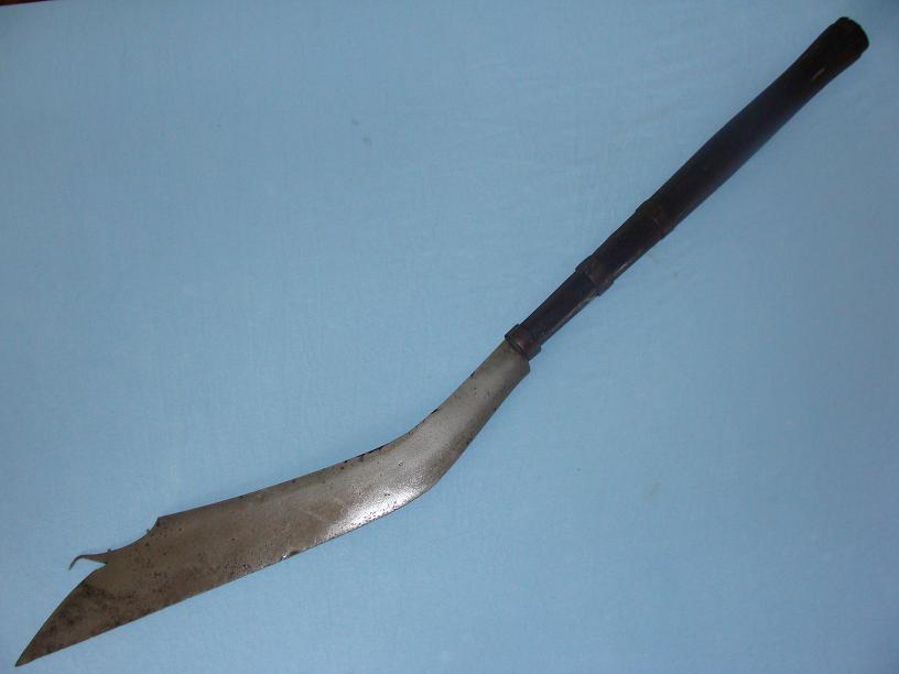

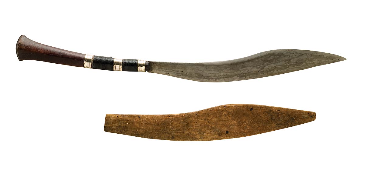

Here’s a couple more to add.
Chris
Hi Chris.
Not very common to see brass inlays on panabas and, as Kai noted, the same inlays occur on a minority of kampilan too. I'm not aware of any specific significance of brass dots on these weapons. Some of our Filipino members might be able to help.
Interestingly, inlaid brass dots appear on Lumad blades as well, especially on T'boli tok. Again, I don't know about their significance either.

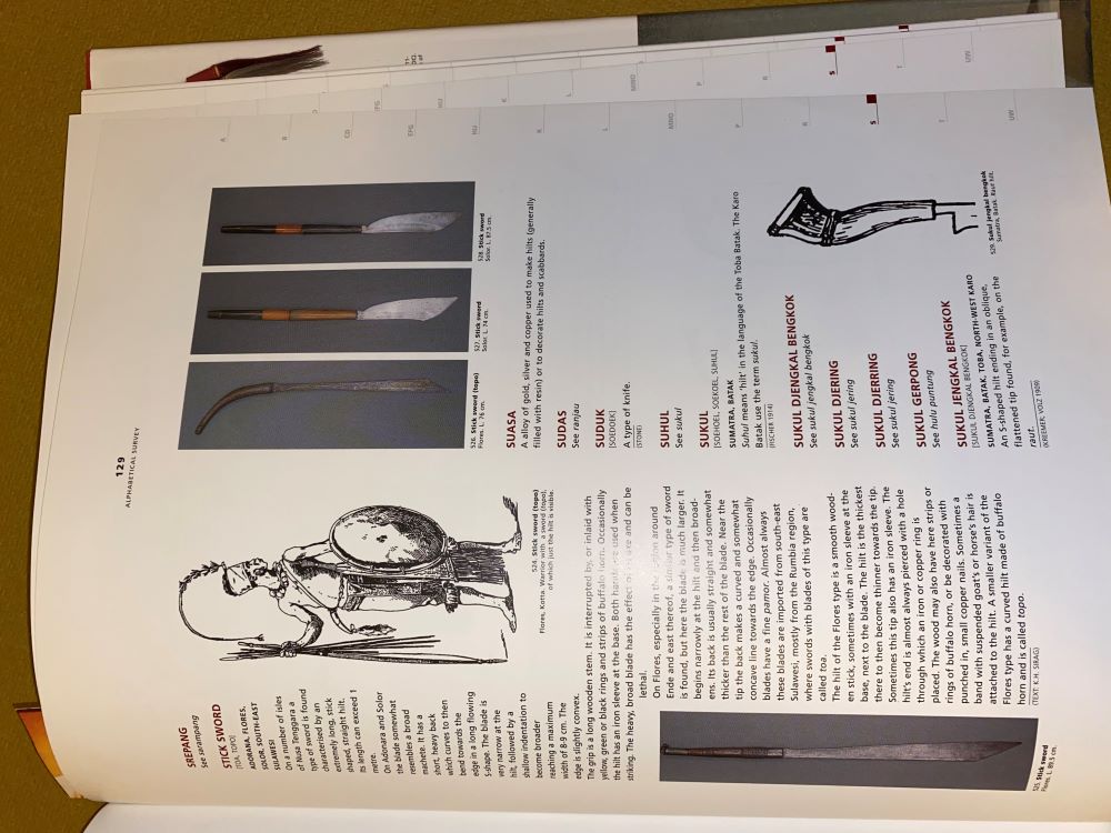

Xas, this is the little bit I know. It is from "Traditional Weapons of the Indonesian Archipelago." Pictures 525 in particular and 526 somewhat reminded me of the panabas so I thought i would ask the experts.
Ian thank you very much for the explanation. It helped.

Sorry for the bad picture. I had lighting issues and was more interested in presenting the text. When I looked at the originals with a jeweler's loop 526 appeared to have a Indonesian or Sumatran style pamor. 528 had a cloudy line down the longitudinal center of the blade with a light towards the cutting edge and a dark side towards the spine. I can't tell if it is a lamination mark or a differential temper.
Thank you all for explaining the ancestry of these weapons. Am I correct in assuming that they occupied similar places in the relative martial traditions as heavy choppers? I would imagine that given proximity these are cultures that had some contact with each other. I have been noticing that posted examples have very little edge damage. Does this mean that there was little blade to blade contact in this martial arts system, i.e. no or few parries, or are surviving examples ones that did not see use?

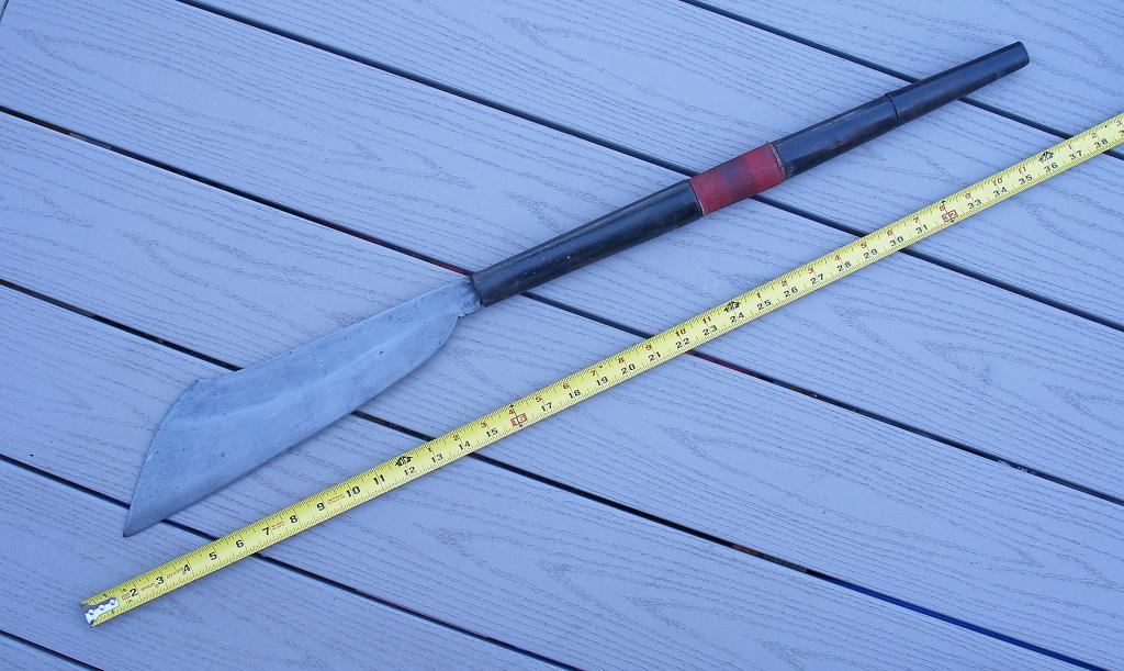

Sajen, what are the dimensions of your Panabas with the blue background?
Hello Albert,
This small panabas was once discussed here: http://www.vikingsword.com/vb/showth...hlight=panabas
It's 55 cm (21.65") long, blade is 31 cm.
