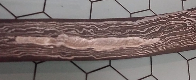

I understand that this is probably against any normal practice but any norm knows exceptions so bear with me and stay positive i am only asking for technical advise.
I have a Bugis style keris which I like in many ways. The blade is not what one would probably identify as typical for a Bugis keris but I like it and it is what it is anyway. My question is about an area of the pamor where there appears to be a large chunk of nickel(?) only on one side.
I was wandering whether applying gun blue with a felt pen would be a good idea to darken this are even further. In the end it is what it is, but I feel that It would look nicer if it were a dark area rather then being a light hue.

The blade does not look Bugis indeed and the shiny spot seems to be a manufacturing defect which may have been filled after completing the blade? I won't touch it personally.

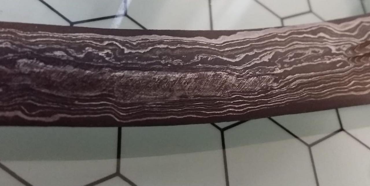

I have touched it up with a different product than gun blue and it looks a lot better now.
The question for me remains whether it would be any better with gun blue

Well, that isn't anything that i would do personally. You say "I like it and it is what it is anyway". If that is the case you should leave it as is. I have never heard of coving up pamor because you don't like the look if the bright spot. So what you are asking seems very strange to me.
I cannot tell much about this blade from this close up. Can you provide a photo of the entire blade?

In my experience cold blue, I normally use Birchwood Casey, will only act on ferric material, it will not darken nickel plating, thus I do not believe it will darken pure nickel on a keris blade.
However, an artist friend tells me that nitric acid @ 50% dilution will darken nickel, you need to get the nickel a bit warm, +/-50C, soak the nickel for up to 30 seconds. She is an artist, and she does SOAK the material in the dilute nitric acid, not paint it on.
Frankly I would not touch nitric acid with a 40 foot pole, it is very nasty stuff, and my belief is that it would be impossible to isolate the effect of the acid so that it only touched the nickel in the blade leaving the ferric material untouched. I think the fumes alone would be sufficient to adversely affect the rest of the blade finish.
To be clear:- I am not recommending the use of nitric acid for anything, least of all to attempt to alter the appearance of this blade under discussion.

thank you for your, to my point, answer, after looking at several videos on Youtube , and reading this, I’ve decided against it.

while I thank you again for your to-the-point answer ( and by the way , methinks that there are plenty of metallurgic points made in several threads that I’ve read, as for example about on how to etch blades ) I have learned to appreciate and perhaps even love this blade.
I like the way the light catches and reflects on this spot, it goes from light to deep dark, as you move the kris creating a very vivid effect.
Intended or not it lives now, and it lives with me. I have abandoned any retouching desire. there is , of course, no account for taste and I have no doubt that people will disagree
