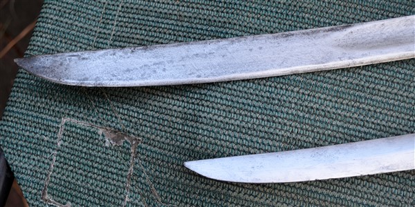

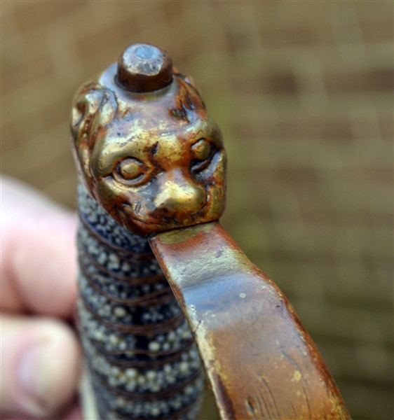

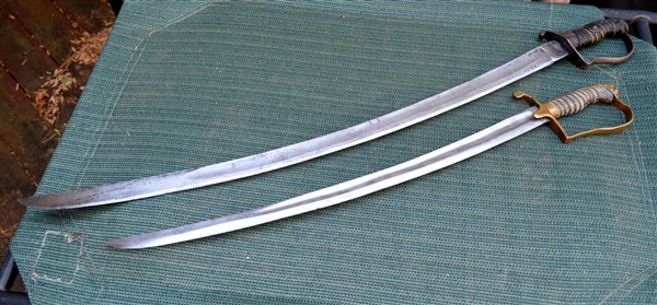

Funny, as things go in Batches; I just acquired my second Lion-headed sword in a month and what I believe to be a British 1796 Light Cavalry Officer's Sword.
The first questions are on the 1796 sword; am I correct in its attribution and does anyone recognize the maker's mark? I can not make heads or tails of it.
The second sword is unknown to me; I am assuming that it is also British, circa 1790-1812, but I can not find a similar example.
Any help would be appreciated!

I don’t think either of these swords are British.
The top one isn’t a 1796 LC in any case. The blade shape is wrong, the ricasso too large, the guard too thick and it’s missing the langets… to name a few of the issues.
The hanger might be British, but I suspect it’s more likely to be from one of the German states. Especially with the marking on the grip furrell.

Thanks for your response Radboud, but I'm pretty sure that the long sword is the 1796 Light Cavalry Sword. It measures 33.5" long, it has the hatchet type end and as per "Swords of the British Army," by Brian Robson, there are examples without the langets.
I think that you could be correct in attributing the lion-headed sword as being German.
Thank you for your comments

I'd be inclined to agree with Radbound that it looks slightly off for a 1796 LC. The heavier guard is generally an indication of the Prussian Model 1811 Light Cavalry sabre which was a copy of the 1796.
But there is still that very short quillion and long ricasso that seem off even then.
That makers mark could be the clincher but I haven't found it in any of my references.

The '1796' could be a British officer's private purchase sword. Doesn't appear to be a Prussian Blucher 1811 variant. Officers ones vary considerably, have different grip 'ears' and even languets shapes – or missing them entirely. Officer ones were lighter and quite flexible. The Indian Army liked them, and made their own versions, I'd bet with larger ricassos. Officer ones frequently had the Mfg.'s name on the spine. Trooper ones were mostly all marked with regimental/troop/rack numbers.
I'd guess German (Prussian) officer ones also would vary.
With no markings other than that on the ricasso, no bluing, or blade decorations, unless someone else knows whose it is, you may be out of luck for more details.
What is the weight of the 1796 lc? My officer's one weighs 698 grams and the balance is about 6 inches in front of the guard. It also has no markings surviving.

I agree with the previous comments that neither sword is British. The top sword isn't a British 1796 LC sabre. Can you please post a better photo of the hilt?

I could only add that in my opinion when one is talking about certain models (f.e. "M1796 LCS") there is often a relative narrow spectrum in which a thing can vary. I would therefore not describe your sword as a british 1796 light cavalry pattern sword because it´s missing too many criteria swords of this model had in common. I´d point out the difference in hilt, as well the blade design.
The lionhead sabers brass hilt has a "Patina" which is not fitting my personal experience with old brass. Suggestion: Maybe red/orange paint remainings?
The argument "it could be a German state" is too often brought when the origin of a sword is uncertain. I do not see this sword come from the germanic influence sphere. My "guts tell me" it could be dutch colonies, but I am far away to be in any kind educated on these swords.

Thank you all gentlemen for your informative posts; I guess if it quacks like a duck and walks like a duck, it still might not be an LC 1796 sword.
The man I got it from said that he purchased it in London; I know him and he tells the truth, however, he has bought so many swords, he might just have been confused . The sword looked worn to me and some aspects, such as the hilt seemed a bit off.
Based on the place of purchase, the variations, and the armory mark that looks like it could be Indian, I think that kronckew's theory of an Indian copy of an LC 1796 could be the most plausible conclusion. I will post better pictures of the hilt tomorrow.
In regards to the lion head sword, it doesn't look like paint, traces of gilding possibly or like old Confederate swords, sometimes the brass has a coppery patina(I am not suggesting that this is a Confederate sword).

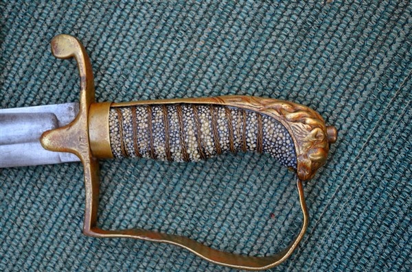

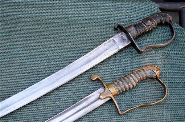

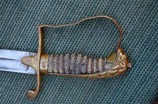

Better pictures of the hilt.

Thanks for the additional photos, is there any leather remaining on the grip? Also what is the length of the grip?
Old 22nd January 2022, 07:13 PM   #13
drac2k
Posts: 1,334
Almost all of the leather and the handle is 5" long.

Thanks, photos can be deceiving when trying to gauge proportions and it looked small. 5 inches is an appropriate outside grip length.
Without wanting to be malicious my concerns with this sword are:
1. The blade profile is wrong for a 1796 patten Light cavalry sword. The tip should become broader at the end. They flare out.
2. There is too much ricasso before the fuller starts.
3. The langets are missing. As you have pointed out, sometimes these did break off but there is no evidence of that on your sword.
4. The Quillon is too short.
5. The grip ferrul (the band between the leather and the guard) is too broad and the fit poor.
6. Trooper swords didn’t have grip wire, and Officer swords (when present) the wire was silver or silver plated and finer than what is present here.
7. The fit of the blade to the handle is poor, like they do not belong together.
8. The overall fit and shape of the grip and blade is poor especially if it is an officer’s sword.
9. The knuckle guard is too thick for a British 1796.
If I purchased this recently and it was sold to me as a British 1796 pattern light cavalry, I would take it back.
