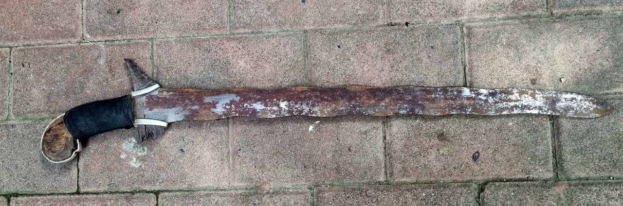

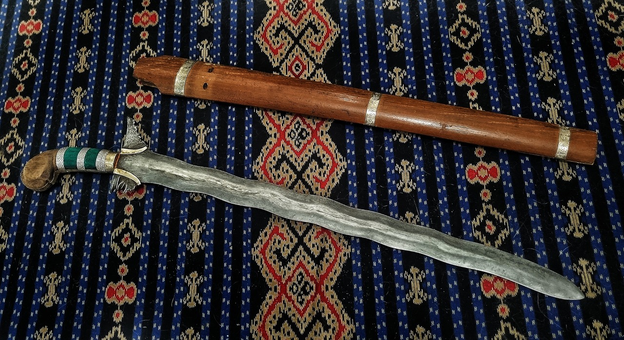

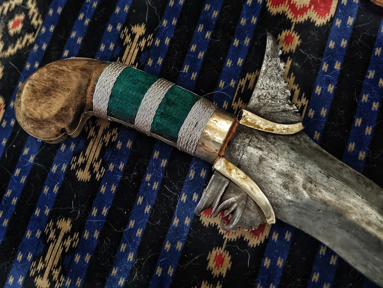

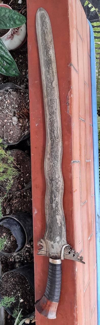

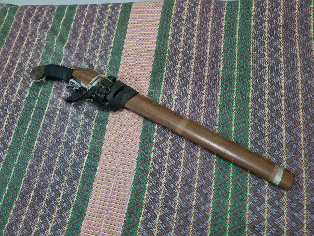

I already partially restored this kris (blade only) and posted it in this forum a few months ago.I do not have the materials to restore the hilt and scabbard. Hence ,I sent it to Jolo for restoration. The handle was originally wrapped with rubber so I asked the artisan to replace it with silver wires. Upon removal of the rubber there was a green textile wrapped around the handle which I decided to retain. The stirrups and scabbard fittings are also replaced with silver.

Looks much better as before also when I am not a fan of the green fabric.
But what disturbs the overall impression is the wooden pommel IMVHO.
It looks very dry, oil it with linseed oil and polish it with steel wool 000 and antik wax. It will be a nice wood but needs some care. Just my humble opinion.
Old 8th November 2021, 07:12 PM   #3
Posts: 9,573
BTW, the same is guilty for the scabbard wood.

Were the green fabric and the wire there originally, and if not what was was there before your cleaning?

I'd guess that the green fabric is about as old as the plastic tape.
The pommel does not seem to be banati/bunti wood; it certainly deserves some TLC as suggested.

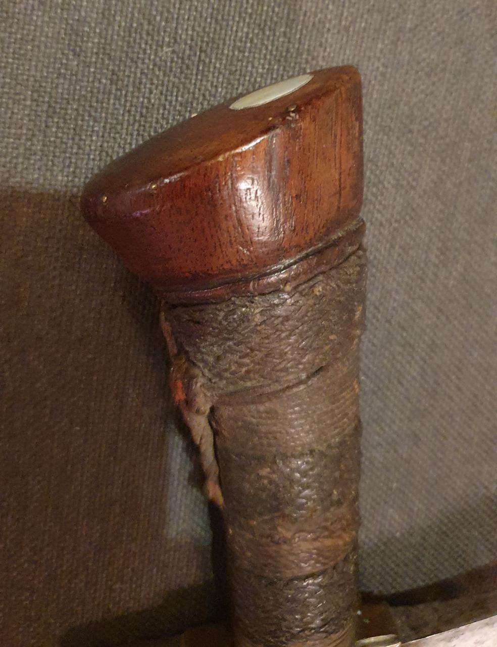

Agree again. It will be a wood like from this pommel in the picture. But it should look similar.

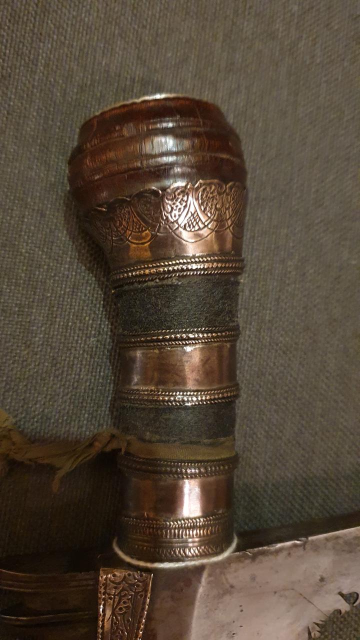

Another non banti pommel.

thank you for the advice Detlef. I just applied linseed oil on the pommel and scabbard.

There are some good suggestions here for the replacement of the green fabric. It is not terribly hard if you can find the right gauge of twine. You may have to paint and lacquer it once applied.

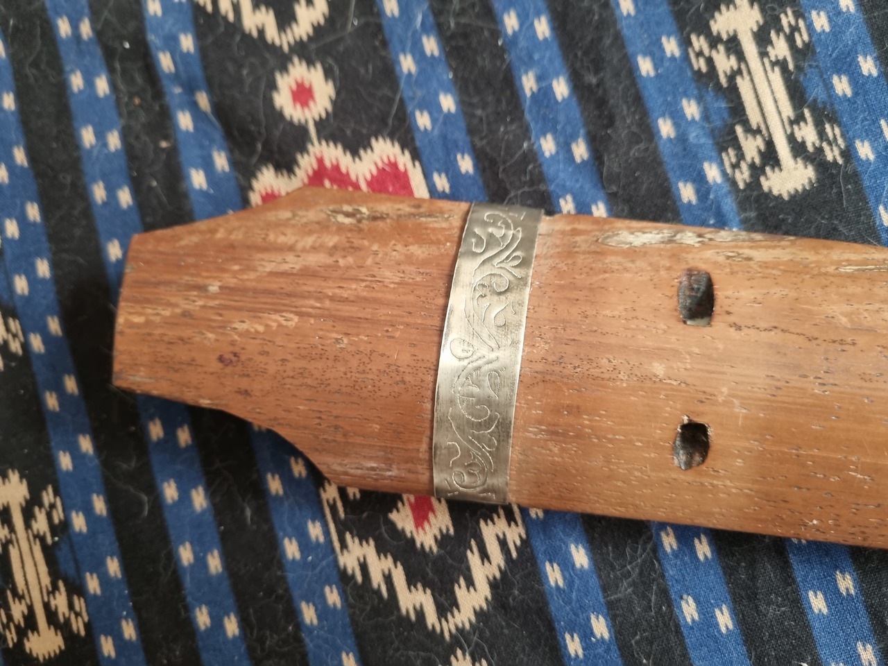

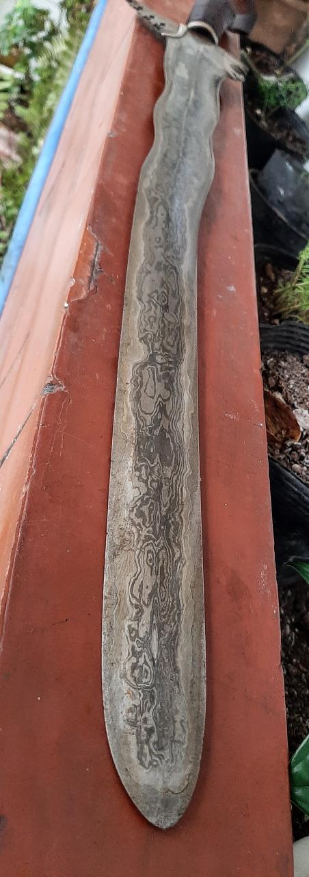

I suggest trying a lighter etchant as well...so that the blade would not look burned. Here's an example I'm working on right now.
