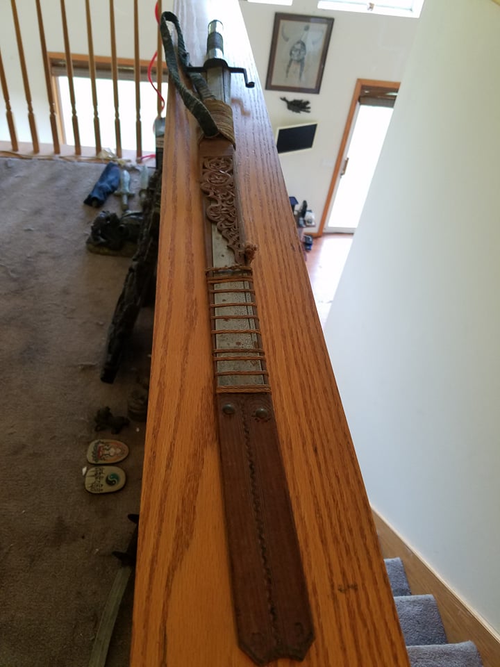

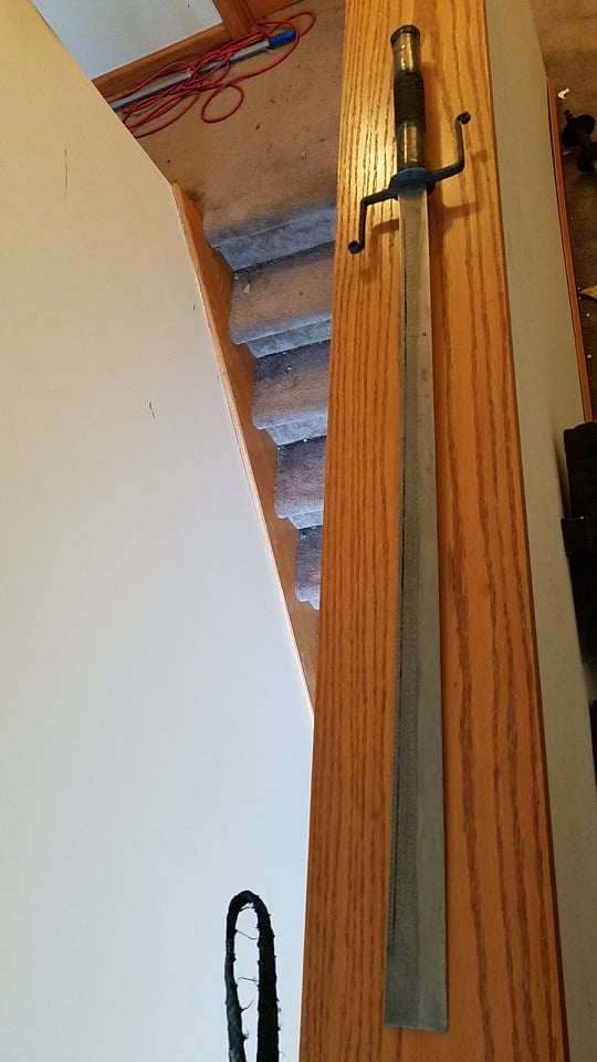

Hello
I would be grateful for any advice on this Achang Dha(?) please.
Thanks
Sid
SidJ is offline   Reply With Quote
Old 27th August 2021, 06:38 AM   #2
Posts: 4,664
Hello Sid,
Welcome to the Forum!

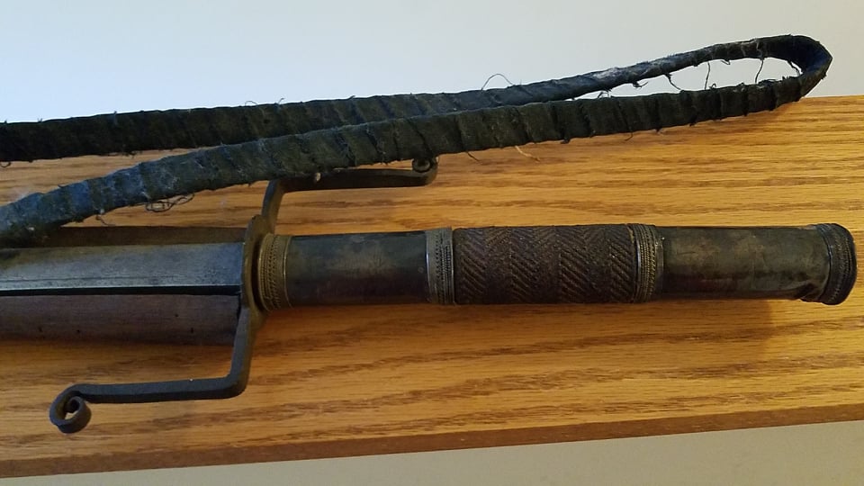

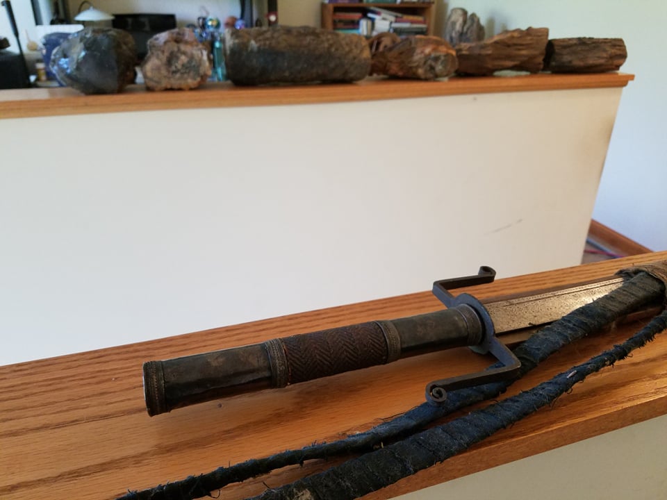

That's a strange sword that seems to have been assembled with parts from different cultures. It is, as you noted, most likely a HuSa dao from Yunnan, made by the Achang people. The guard could be Chinese in style, while the hilt is similar to the three-part Shan/Burmese style. The blade has been quench-hardened, as is the custom of the Achang. Their blades are usually good quality and well forged. The scabbard resembles the long, open-faced scabbards to the north of Burma, notably Assam and neighboring areas, as well as among the Lisu in NW Yunnan. There has been a close connection between the Kachin/Lisu peoples and the Achang for at least the last 70+ years, and probably longer.
Such mixes of cultural elements are not uncommon among the swords the Achang make for areas of northern Yunnan and north of Burma. The blades are almost always flat-ended in the Kachin manner. The long scabbards are sometimes made in HuSa although they may be added later at their final destination.
The Achang trade widely in countries north of Burma, and I have knives from Tibet and Bhutan that are clearly stamped "HuSa."
Thanks for showing this interesting sword.

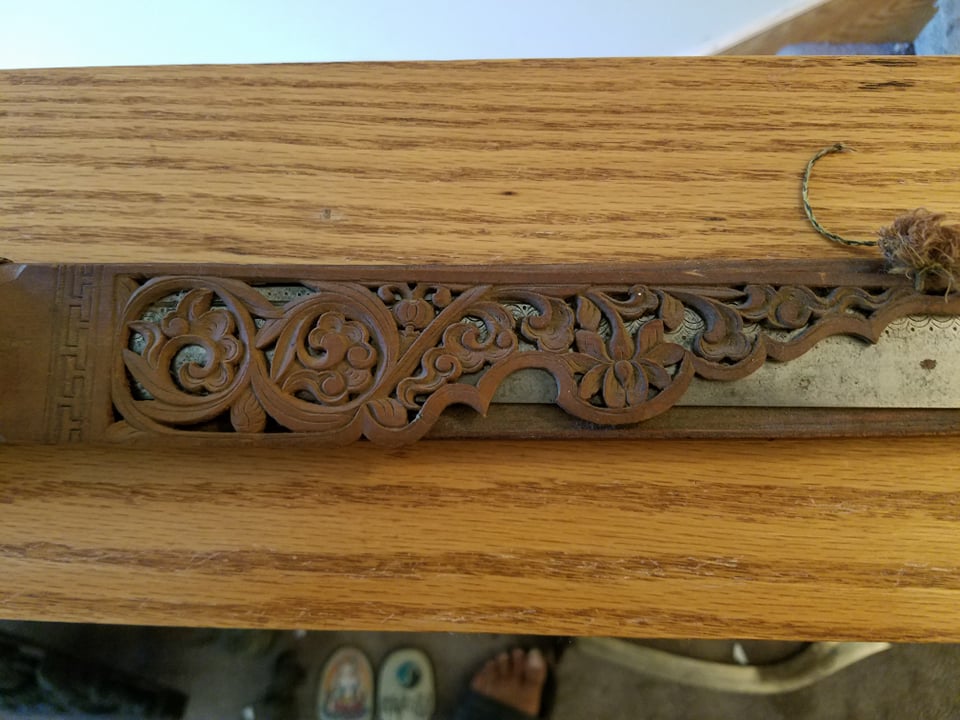

G'day Ian et al,
Thanks for your informative reply. I am grateful. I note the scabbard carving is quite ornate compared to others I've seen and appears to me to have distinct Chinese influences. As you say, presumably this all forms part of the variations that these blades come in given their location of origin and the areas they are traded in.
It's my first foray into blades from this area and I'm quite intrigued by them already.

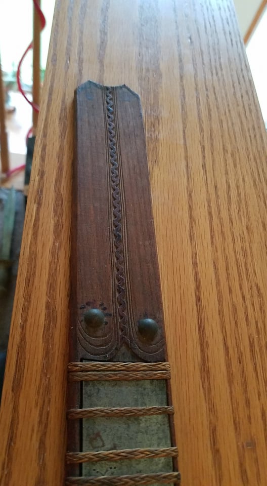

This is a close match to one I collected last year, though mine lacks the iron guard and your scabbard carving is much nicer. Glad to see an example of something mounted in there. What material are they, from the photo they look like brass or bronze studs. A really nice hairpin pattern emerged when I etched mine.

Hi JeffS
Not sure what material the studs are as yet. I might etch mine too to see if I can see anything.
