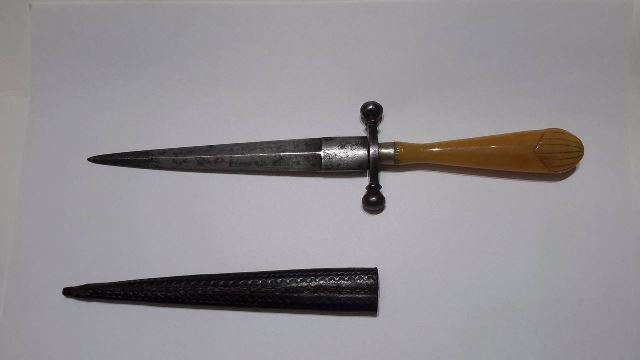

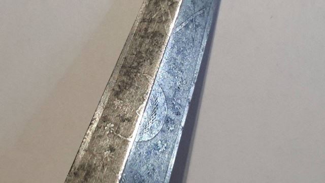

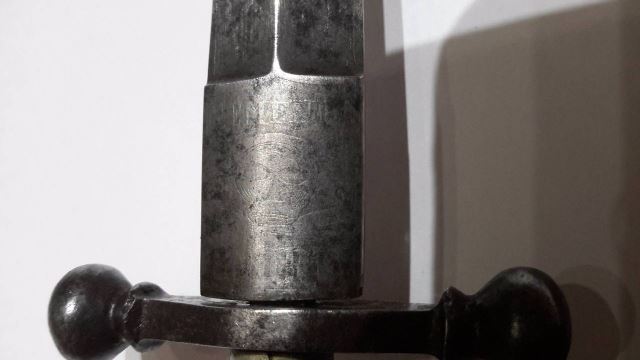

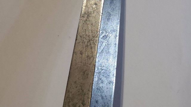

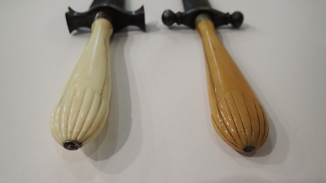

Hi, Detlef. On the two that I can show, the tang are riveted to the handle. Both have a gap at the guard and it rattles. It is interesting that both are marked with Masonic symbols. Legendary_Jarl, if the handle your dagger is made of wood, then you can try to wrap it with a damp cloth and give it some time. I think it might help. The handle will restore the lost moisture and eliminate the gap.

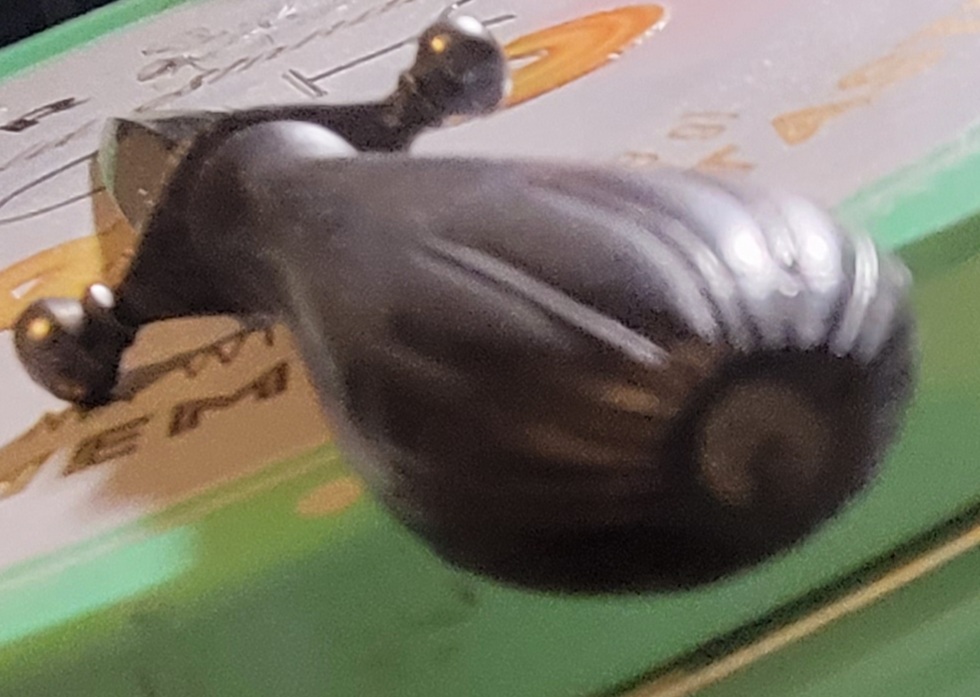

This is the best picture my phone could produce. I guess it was riveted before and it lost it but somehow it is still in one piece?

Yes, peened. A repair is possible but needs experienced hands. So I would follow Saracens advice.

yeah best to let it be if you havent somebody veyr exprienced to assist you. as this tang will probably be tapered and if the wood has shrun the tapered tang youll be peening may just be driving up against the wood of the handle and crack it.
youd have to remove the handle completely and re fit it ..
if it was a tool like a billhook or some heavy agricultural tool with a softer wood handle just repeening it would work as beach or ash would just compress and tighten the handle up..
but these are ebony, horn ect ect much harder.. and are carefully fitted at the time they were made. the tang would probably be a close match to the interior of the wooden handle and the handle is thin it may split when its compressed. id say there is probably pitch in the throat of the handle though.
