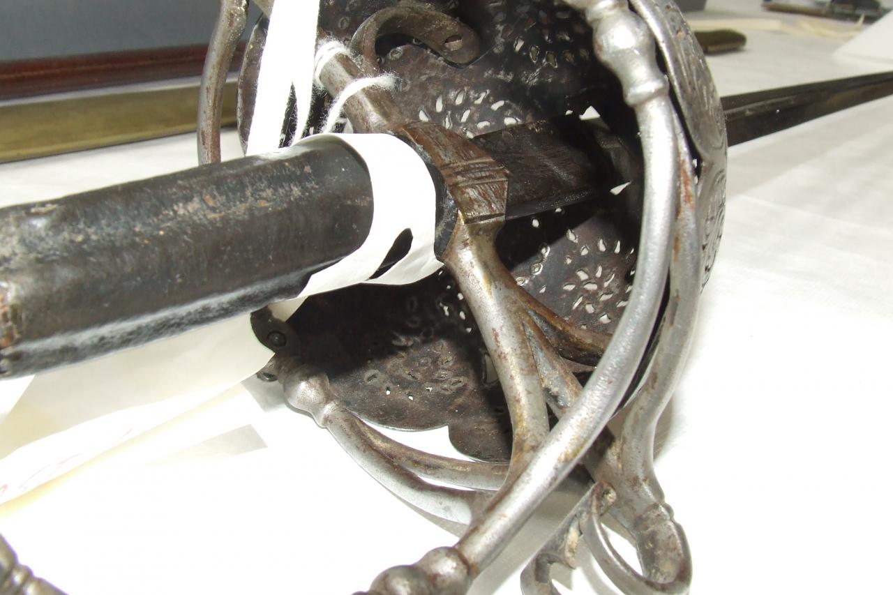

Also, as noted by Fernando, it would be good to see the ricasso to look for markings, and images of the pommel as well as inside of guard would help.

While screws seem unusual, and I am inclined to think these appear modern, Norman ("The Rapier and Smallsword", 1980) does describe various means of attachment where screws are used. Since they were often used inside the cup for securing the guardopolvo (dust cover) it would seem possibly for arms as well.

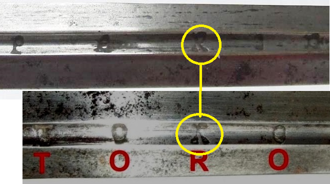

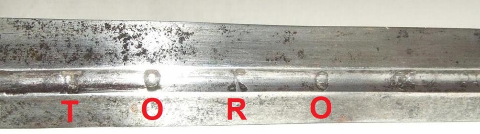

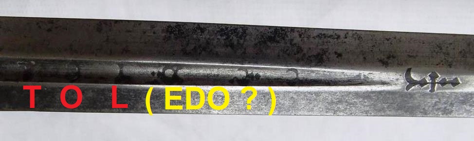

A certainty ... and an attempt ...
Very good attempt I would say! and almost too tempting, given that those symbols I mentioned in the inscription resemble the zodiac glyph for bull. (Toro=bull).
It seem that in many inscriptions regarding place 'in Toledo' etc. use various spelling and abbreviations.
In one case N T O L is used and the separation of the entire phrase or wording ends up on both obverse and reverse on the blade.

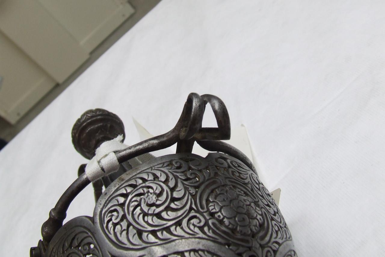

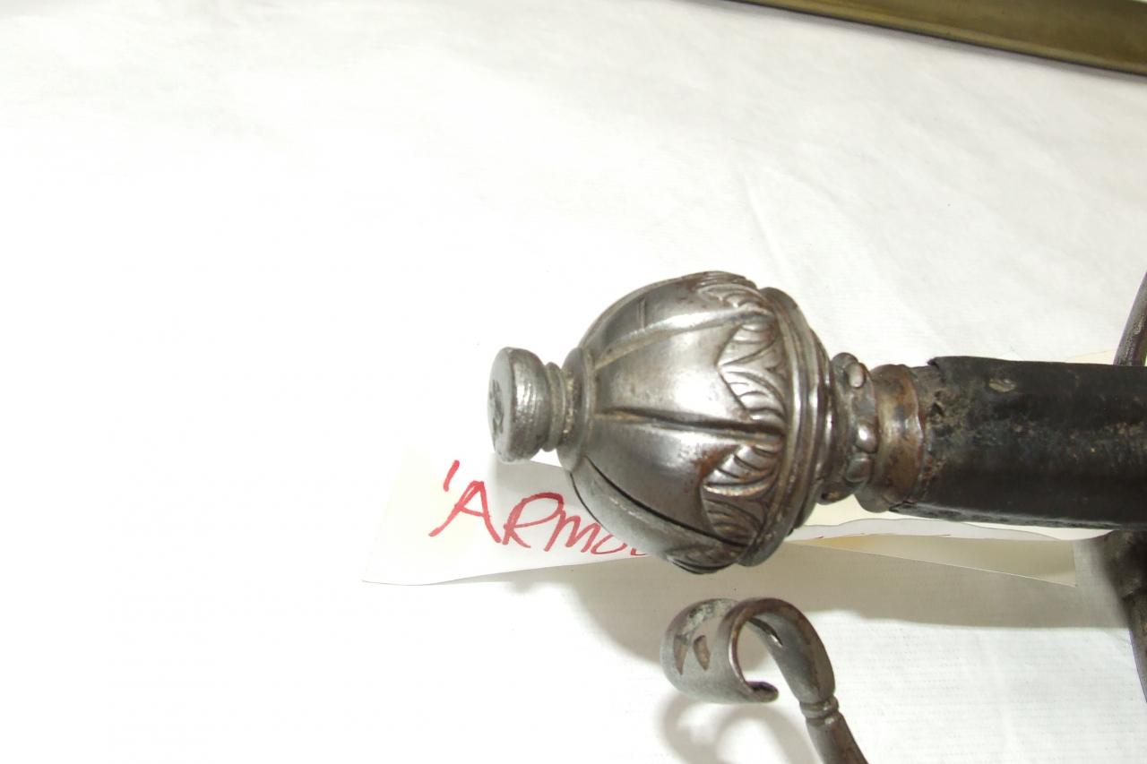

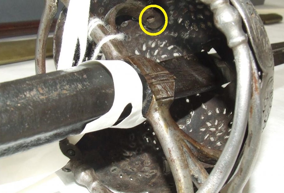

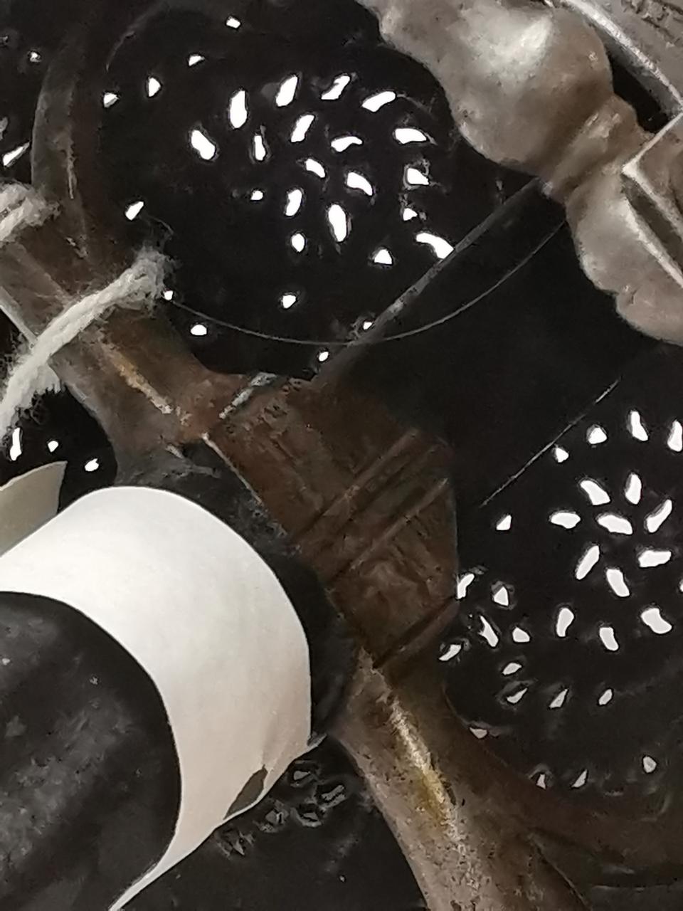

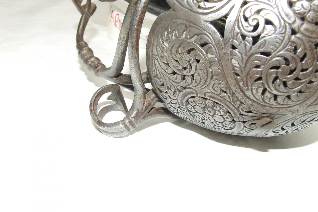

More photos as requested.
As far as my own impressions go I think the photos capture everything I observed. The museum got out 10 swords for us to measure weigh and photograph but they prefer to do most of the handling themselves. We were only scheduled for an hour and a half which we went over by half an hour thanks to keeping the curators interest with what we were able to identify just off the top of our heads. It still meant a bit of a rush though.
Robert

... Very good attempt I would say! ...
Jim, i am glad that you fully read my posts ... don't you ? Just kidding .
I mentioned a 'certainty' and an 'attempt'. The attempt was to guess that the 'TOL' letters could be a short for Toledo. And the certainty went for 'TORO' (the smith's name).The only letter that could look suspicious, the 'R', leaves no doubt when compared with the 'R' of Pero.

Fixation of the cup bowl by screws is rather common; so much or more than the system of welding the cup to the quillons. Screws with a modern look may (may) exist because the old ones fall off and people replaces them with the ones at hand. While Robert's sample has a modern one, is it my eyes or is also missing another in the fixation arms.
In looking into the late Nick Norman's fabulous book on rapier and smallsword hilts, he lists I believe seven methods of these kinds of affixation, so well noted on the use of screws. The old screws certainly may have been lost, or perhaps destroyed in the dismantling of components typically required in maintainence or refurbishing these swords experienced over their long existence.
You're right, another is missing inside the cup.
Still we need some member familiar with this blade (and marks) to show up.
LOL! YES, I do !! and usually several times to be sure I havent missed something as you include a good deal of content, and my attention span is not great.
It seems like that R in Toro corresponds to the other R, but like the loop is flat or missing. It has to be an R though.

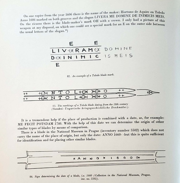

Here are some plates from "Cut & Thrust Weapons" (E. Wagner, 1967) which illustrate the Spanish omission of letters D and E in inscriptions to be replaced by sigils, glyphs or Hermetic symbols.

Good stuff Jim. Hortuņo de Aguirre, which he spelled HORTVNO DE AGVIRE in one sword kept in the Real Armeria, and inscribed ESPADERO DEL REY in another. The Aguirre family, Hortuņo the old, Domingo his son and Nicolās the grandson, used more than one mark, including the To for Toledo.
Interesting, the inscription in the blade shown by E. Wagner; FREE ME GOD FROM MY ENEMIES, per psalm 59.
It occurs that this kind of inscriptions may (may) not be of smith/s iniative but ordered by customers with religious vocations (read fears). We better digest a customer educated in Latin than a bladesmith.

Right Fernando,
I added these pages as key reference primers on this topic which seemed very pertinent in examining these rapier blade inscriptions.
I do believe as you say, clients had their own personalized choices for slogans, invocations and various inscriptions.
