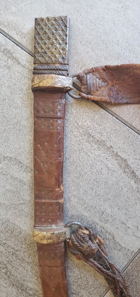

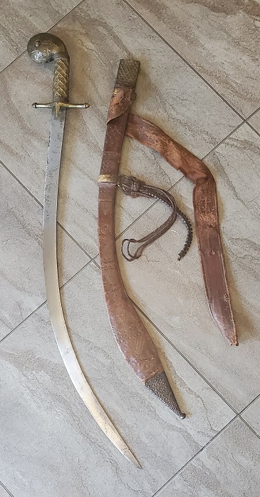

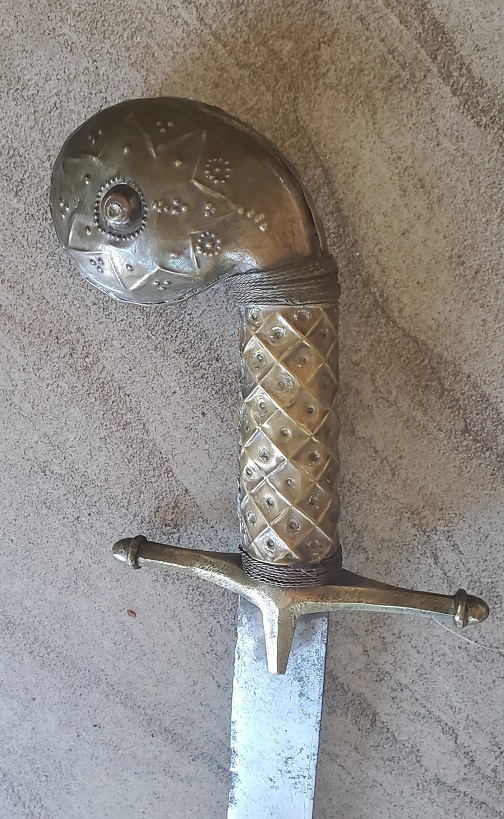

This is a saber which seems to correspond to Sudanese character with kaskara like langet, but the terminals on the guard of course seem Ottoman. The 'pistol grip 'of bulbous form as with Ottoman kilij/pala.
The diamond cross hatch is similar to these patterns on Darfur kaskara hilts of Ali Dinar period, and there were glass type festoons inserted at one time in each lozenge.

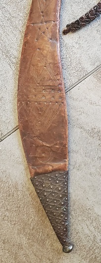

The flared scabbard tip is of course as found on kaskaras, but we see this feature of course on the sabers in Mali. The curved blade swords of takouba form in the Sahara are termed aljuinar, but do not have this feature.
Would appreciate any ideas.

Very interesting find Jim, thank you for sharing. To me it does indeed look like a Sudanese interpretation of a shamshir with an Ottoman style hilt. We know such swords were quite popular in Egypt prior Muhammad Ali's destruction of the mamelukes in 1811. Some of the mamelukes in fact escaped South to Dongola, with the sultan of Sennar helpless to do much about them until they were finally wiped out in Muhammad Ali's conquest of Sudan. These mamelukes certainly brought a good number of swords with them, so there would have been examples for local artisans to copy. Alternatively, Muhammad Ali's invasion force consisted mostly of Turks and Albanians from the original army with which he went to Egypt, and many must have carried Ottoman hilted shamshirs with them as well. It is not hard to imagine a situation in which a shamshir blade needed new fittings and local craftsmen did their best to copy the original hilt form, while decorating in their own way.
Old 28th December 2021, 12:53 AM   #3
Posts: 7,366
I love the repousse work on the hilt and scabbard mounts. Nicely done. Not used to seeing this quality of work on Sudanese pieces.

Interesting sword, Jim. The heptagram (7-pointed star on the pommel is unique for me. It has symbolic meaning in all three Abrahamic religions as per Wiki below:
"*The heptagram was used in Christianity to symbolize the seven days of creation and became a traditional symbol for warding off evil. The symbol is used in some Christian branches such as Catholicism and Orthodox Christianity.
*The symbol is also used in Kabbalist Judaism.
*In Islam, the heptagram is used to represent the first seven verses in the Quran."
The blade looks flat with no details as if it may be sheet metal; surely not.

Thanks very much guys! I've had this for a very long time, but never adequately researched it. The blade I think someone said was Turkish 'bayez'? or some such form of Ottoman watered steel...I am a complete neanderthal at metallurgy, so cannot recall and cannot get more images of blade yet.
Teodor, spot on with the Mamluks into Sennar, and while they were effectively ended in degree by the Egyptian sultan, the Mamluk culture through descendants prevailed there as traders and artisans. I think this is where the notable convention of thuluth on blades and metalwork came from in the Caliphate before Omdurman as this was a Mamluk tradition.
As far as I have known, this is the only example of this kind of Sudanese 'saber', and would be thrilled to know of any other examples or supporting literature.
We know that Tuaregs who were of course keen on broadswords, did have curved blade sabers termed aljuinar (per Lee Jones )but this seems compellingly Sudanese.

Here is a shamshir from Gavin Nugent's sold items, which based on the python(?) skin cover on the scabbard appears to have been used in an African, most likely Sudanese context at some point. Persian arms were imported and imitated in Sudan, but as discussed German imported blades were preferred, probably because of the ratio of cost to quality.

This is purely speculation, but could it simply be an Ottoman (Egyptian or Hejaz) shamshir that has found its way south and has been 'sudanised' to local taste.
I would really like to know what is under that bulbous brass encased hilt. Is there any way of finding out?
It could be a pleasant surprise.

The scabbards shape for both your & CharlesS sabers are virtually identical including the reptile skin of the strap attachments. Also, the diamond motifs on both grips and the dress on your scabbard (raised diamonds) are inverse kin to the same motif on many later kaskara including those from Ali Dinar's workshop (raised center with dot). I discuss the diamond motif in my Kaskara in Silver Dress paper.

This one, I believe, has a rhino horn hilt, (and a blade with etched thuluth script!)
http://www.vikingsword.com/vb/showthread.php?t=349
I wonder if yours has a rhino horn hilt beneath the brass covering.

I see what you mean Richard, possible just a covering over the rhino Ottoman hilt. I have never taken apart one of my swords, so probably would not on this. It is an interesting suggestion though, and might have been done to add the embellishment.
