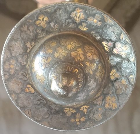

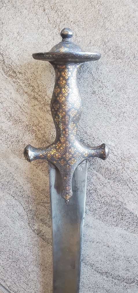

Default TULWAR for Comment and ID

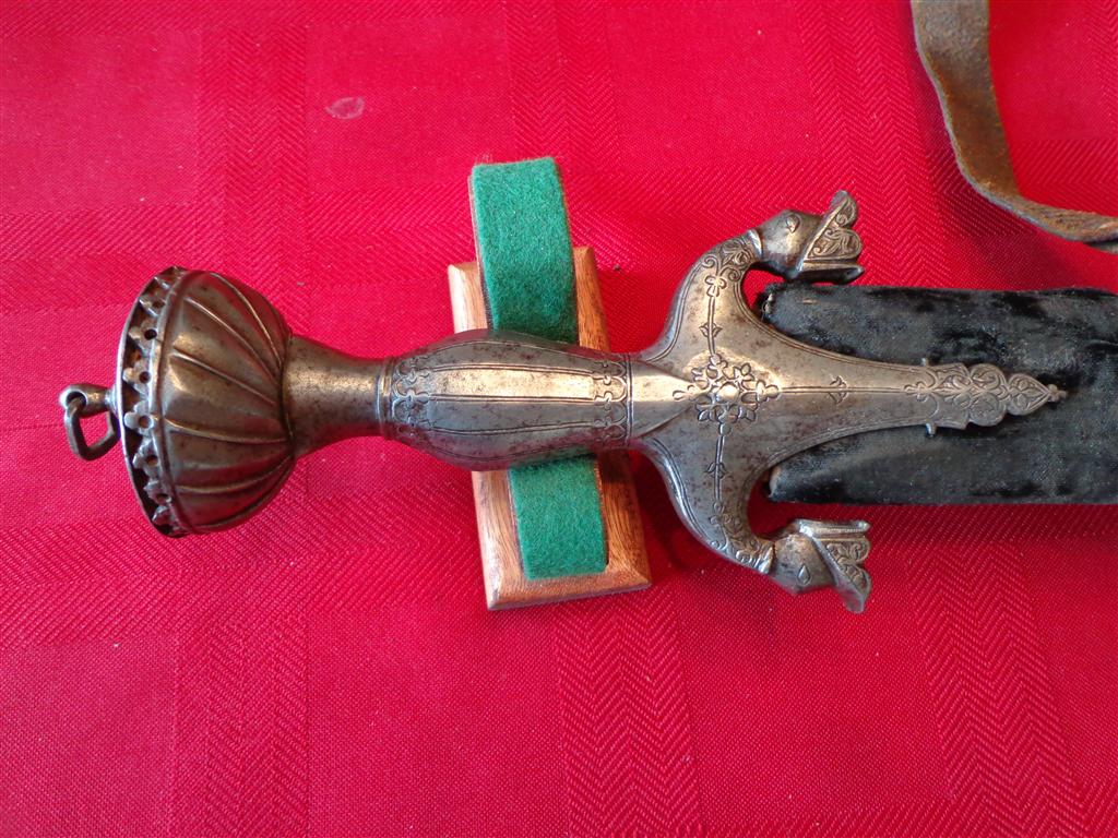

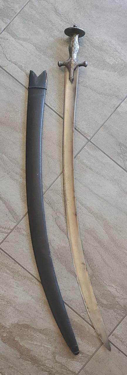

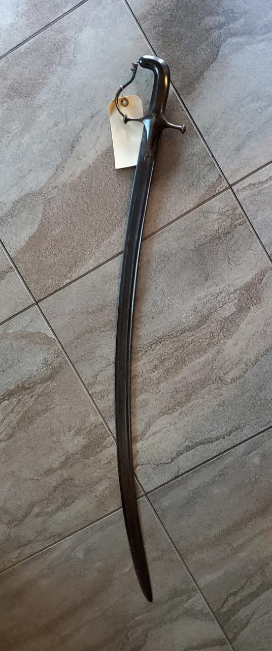

Can anyone please ID the origins of this Tulwar. The 32" curved blade (very sharp) appears of good quality and has no marks of any sort visible.
The hilt is what interests me in that it appears to have been cast with very nice decoration. Most Tulwar I have seen either have a plain hilt or have Koftgari decoration.
Any and all comments welcome.
Stu

Very nice. Ferrous hilts are usually forged in several pieces and brazed together rather than cast in one and the decoration chiselled in. Look carefully and you might find the brazing lines. If it is cast in one piece then I would think it a later piece rather than 18thC.

I will add here that based on how the hilt is decorated it is likely of South Indian origin. Of course, the blade could be from anywhere north or south.
Thanks David. Clear signs of brazing Had not thought to look before.

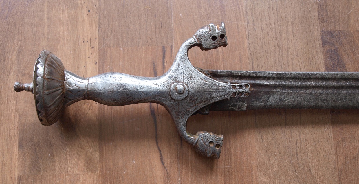

A very nice example Stu, and what I would consider probably Rajput, if considering the designs in the pommel bowl. The langet and general styling corresponds with tulwars from N.India, particularly regions near what is now Afghanistan, and south into Sind, Baluchistan, Rajasthan....noting that Rajasthan held most of the production centers.
It is extremely difficult to geographically place tulwars as these were used in so many regions, but primarily in India north of the Deccan. Tulwars did however follow southward through Deccan to Sultanates in south as far as Mysore with Mughals.
It is pretty much always safe to assess 19th century with these tulwars, though many can place further back into mid to latter 18th on occasion. Mostly they are mid to latter 19th c. Remarkable numbers of these were collected as souvenirs during the British Raj, and at the huge 'Durbar' events where sellers from many princely states presented their wares.
Tirri's book follows many writers in relying on the Pant classification system ("Indian Arms & Armor", G.N.Pant, 1980) where the author has categorized various styles mostly in accord with regions, and while useful as far as using the terms in discussion to specify, these classifications are not entirely viable.
For example terms like Udaipuri, Sirohi etc. are among numerous locations in Rajasthan where hilts and blades were widely produced, exchanged and exported. These hilts were maintained traditionally for centuries, and only decorative nuances and motifs can sometimes offer more specifics.
For example Lahore had distinct preferences for enamel on hilts, some locations used gold koftgari in a 'diaper' pattern , some used the silver over back 'Bidri' style. The floral or star shape on the guard on this one along with the face like langet remind me of northwest frontier (then termed India, but now Afghanistan, Khyber into Sind).

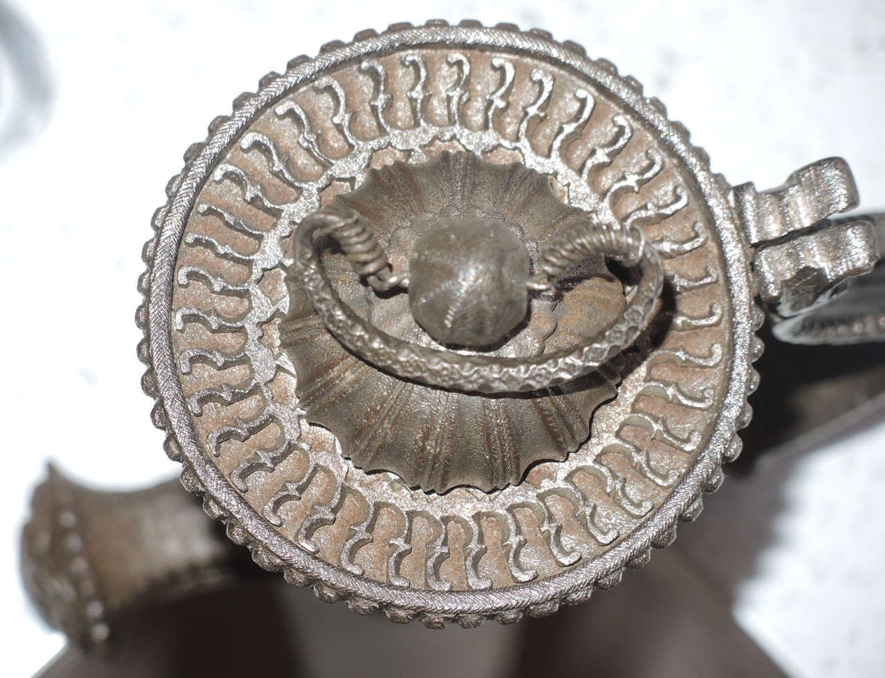

The designs in the pommel remind me of the kinds of designs used by Rajput clans, in this case solar themed.

My “sign” would be the dot ( or hemispherical ) protrusions on the edges all over the handle.

I am curious about the 'South Indian' suggestion as far as the style of this tulwar hilt, and I dont mean to dispute but understand just what region(s) of south India is being referred to.
The 'tulwar' , that is the hilt form generally termed Indo-Persian as seen here is as I have noted predominant in the northern regions I named.
The features I noted, the pierced langet, the decoration in the pommel disc interior, the four point star or floral motif on the guard, are all characteristic to northwest India, particularly into Afghan regions.
The paluoar, which is considered an exclusively Afghan sword with drooping quillons and the bowl type pommel, is often seen with the four point motif on the guard, and the pierced langet which somewhat recalls zoomorphic figures as on langets (the makara is typically known in north, while yali in south).
I would point out that it is generally held that the paluoar is actually a northern India form of tulwar (as described in Egerton, 1885) and its features influenced by styles from the Deccan (central part of India).
Influences from there into Afghan regions were cross diffused with the Pathan communities which developed in Kurnool, Cuddapah and Savanur regions in the Deccani sphere.
While the 'tulwar' (as described) was not used in any notable degree in the south, Tipu Sultan did have one (now displayed in New Delhi).
However I can see the feature of the 'beaded' edges on the guard etc. being regarded as 'southern' as this fashion does occur on katars and some other weapons of Tanjore (Tamilnadu). I think it may be reasonable to think that this 'convention' might have transmitted to the 'north' after Adoni (1689) where large volume of arms and armor were captured and taken to the armory at Bikaner (Rajasthan).
This might offer an explanation for the apparently amalgamated overall design of this very attractive hilt.
As has been noted, it was quite common to have hilts and blades stored separately in many armories in the princely states, and these elements were imported from various sources, often assembled as required. As with most ethnographic weapons, swords were refurbished, often numerous times, as local or individuals tastes specified. With this well known propensity it is hard to specify 'original' or homogenous state on weapons which were subject to these kinds of changes in their working lives.
The Great Exhibition in London very much increased the public interest in items from India and acquisition of many souvenirs imported, which undoubtedly included weapons. The interest waned in large degree by 1863 when East India House was closed, and holdings dispersed.
I hope this better explains my perspective on this particular tulwar posted by Stu, and on the disposition of these swords from 19th c.

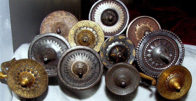

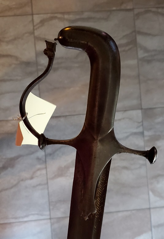

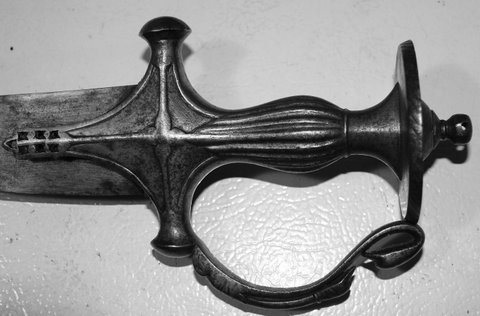

Attached are images of 'paluoars' (north Indian /Afghan tulwars 19th c) showing the langet and guard decoration I refer to, and a grouping of pommels from tulwars, primarily from Rajasthan centers with likely Rajput orientation possible.

Really love that pic of the Tulwar hilt tops!

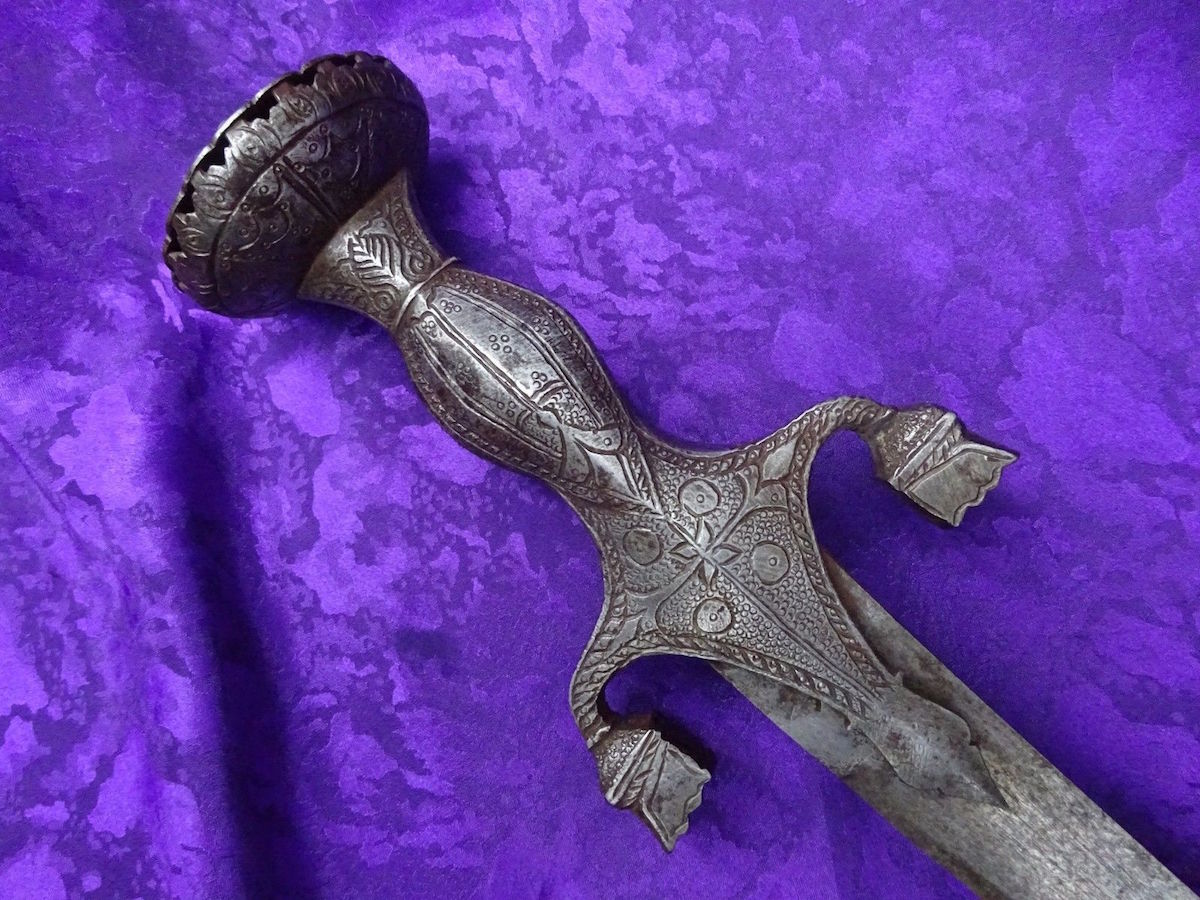

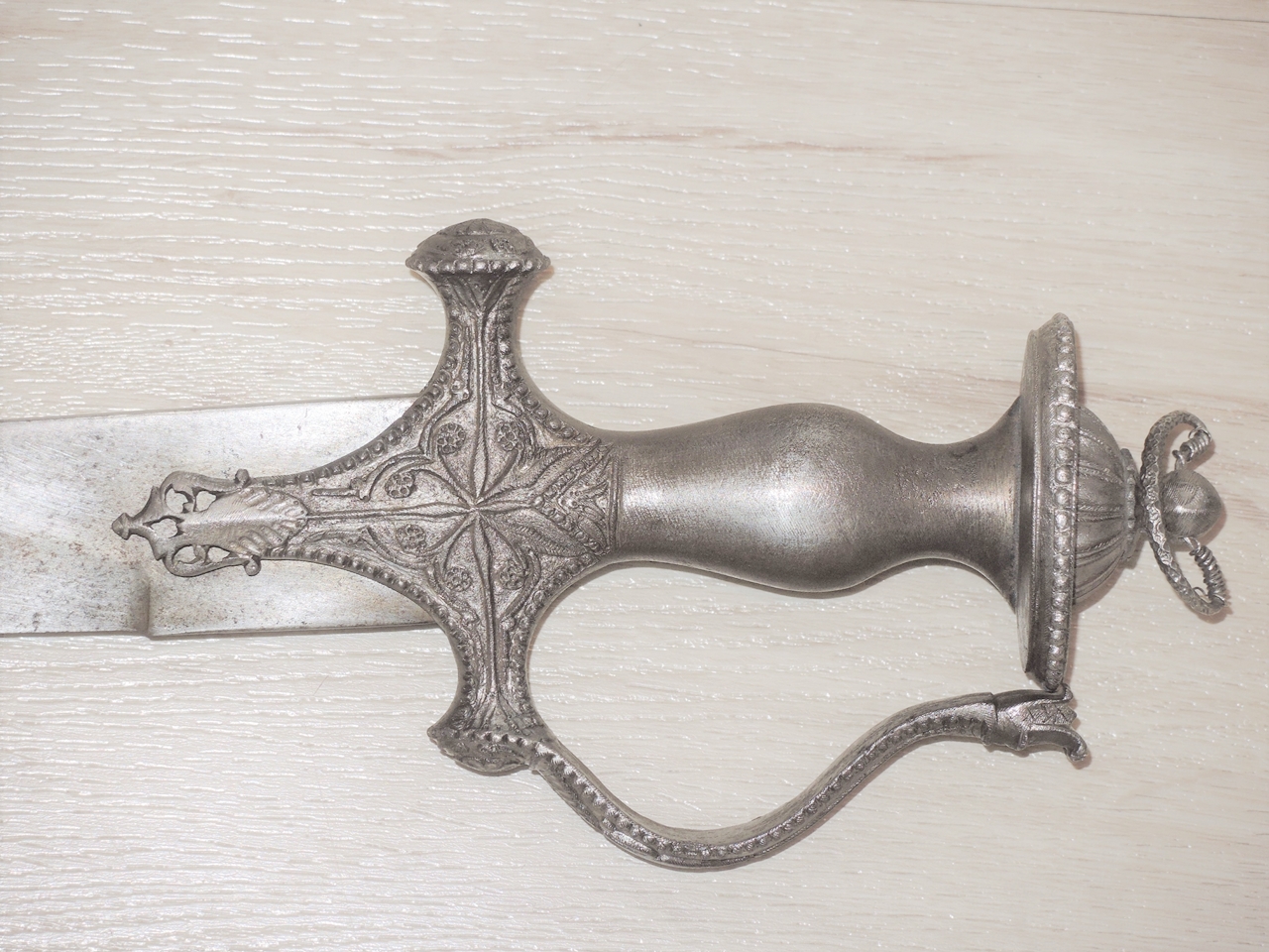

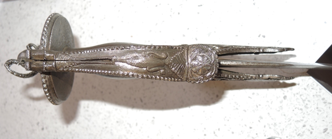

I wanted to add the 'Deccani' type tulwar mentioned in my previous post.
This hilt has what is termed 'Persian' style (=shamshir) hilt.
What I would note here is that 'tulwar' is an Indian dialect term for 'sword' in general, so here it is termed tulwar even with this type hilt.
What is interesting here is this one has a British M1788 light cavalry blade, and is an amalgamation likely from East India Co. in Mysore post Seringpatam (1800+).

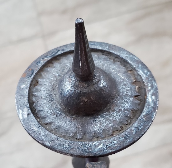

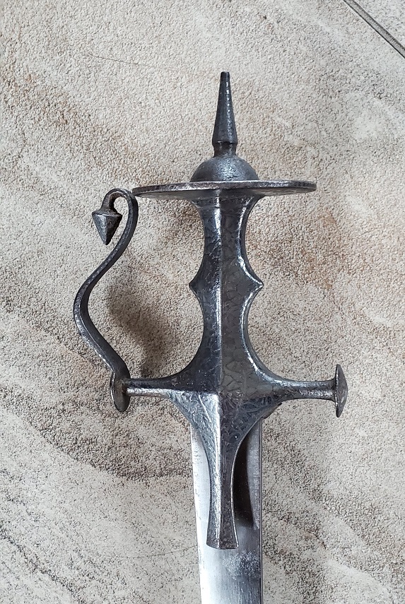

Next is the most familiar 'Indo-Persian' hilt as seen in the OP form, but here the styling with peaked midrif, squared elongated langet is a type regarded (Pant.1980) as Udaipuri (Udaiper, a city in Rajasthan state), and these probably may be considered mostly Rajput in use, though of course Sikhs and Jains also.
Note the 'stem' in the disc pommel, often associated with the longer stem on khanda/firangi also used by Rajputs (and of course Marathas), west central to northwest India.
Next is the 'Delhishahi' form (Pant, 1980) but without knuckleguard. This may be seen more as Mughal in form and as noted from Delhi in the north,but more eastward. These I have always considered more for 'court' wear, dress occasions.
This one unique in that it has an Osborn (England) 1796 blade, and may well derive again from East India Co. contact and Mughal connections between the south into Delhi in the north.
It is notable that Tipu Sultan of Mysore did have an Indo Persian hilt tulwar now on display in Delhi. Note the koftgari motif and floral pommel disc decoration, as opposed to the radiating geometrics in Rajput forms.
