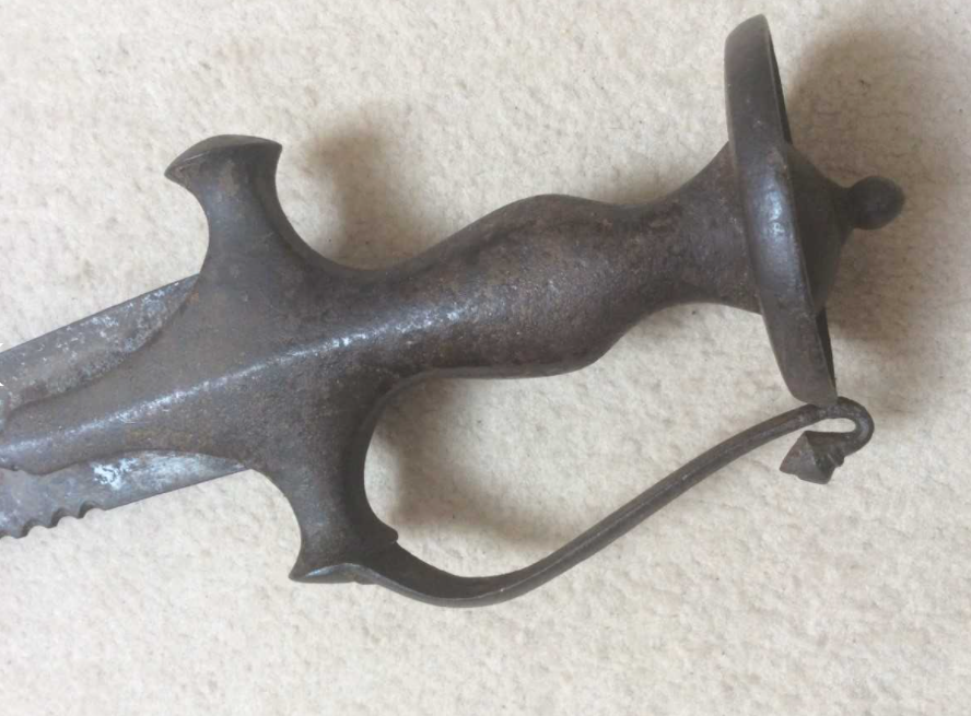

I finished some work on the attached sword.
it is of a type that has been discussed before
http://www.vikingsword.com/vb/showth...errated+tulwar
Looking at the handle and the overall sword it is pretty devoid of any decoration.

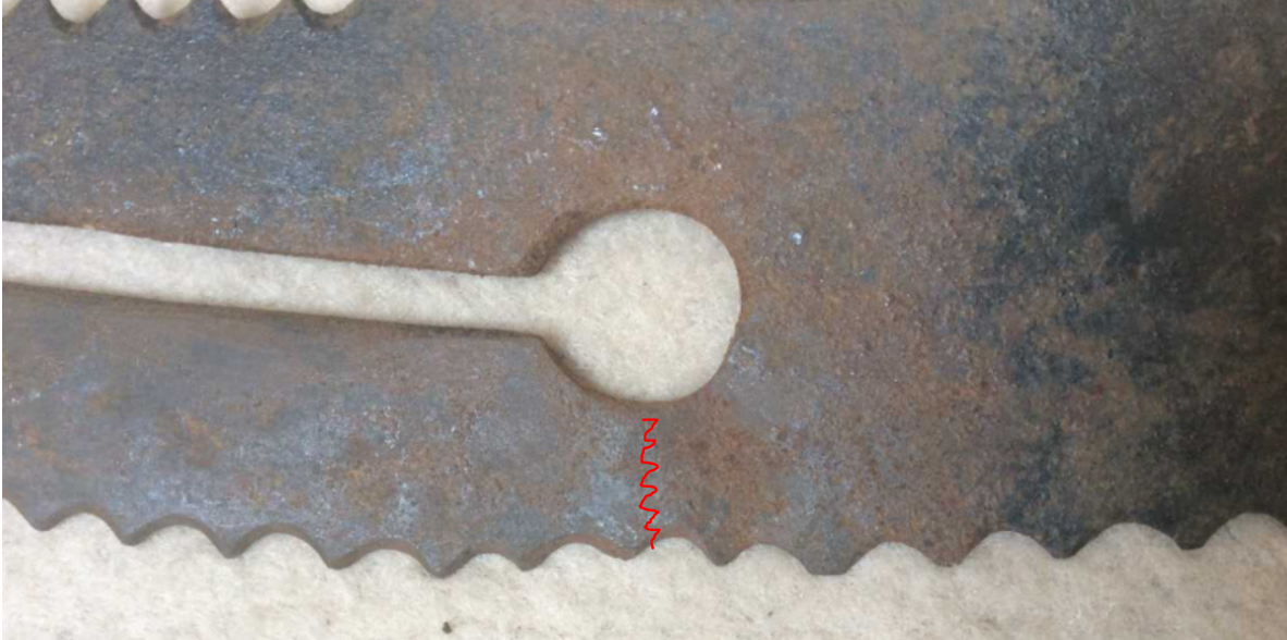

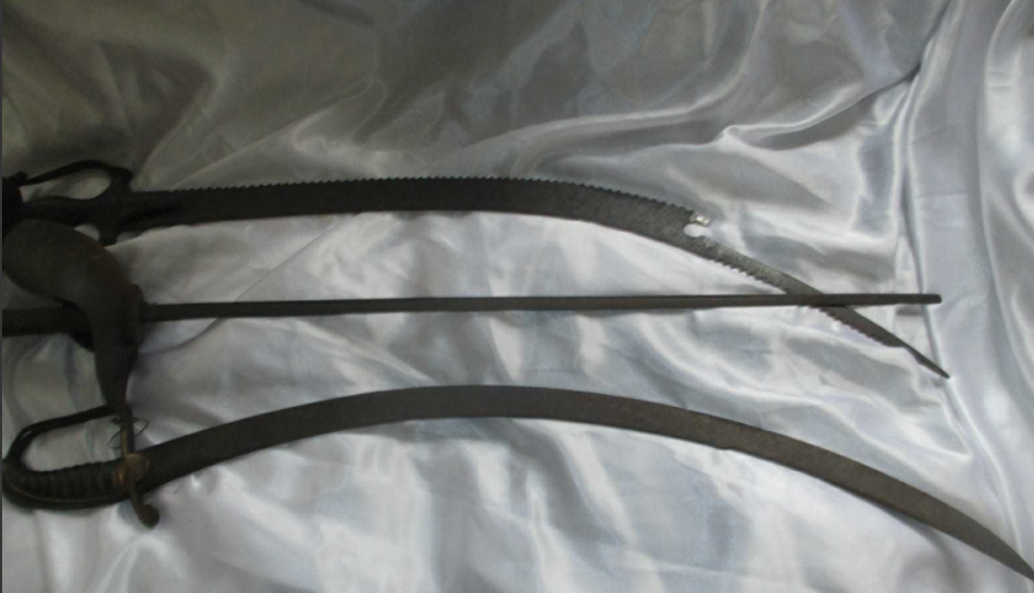

Now the sword cane to me with a lot of damage, namely the forward facing arm of the bifurcated blade was snapped at the central hole off and lost by previous owner.
I fashioned a 20 cm replacement blade part replacement from an old sword blade that was v v rusted and pitted and ground in the serrations and welded it into (place oxo acetylene)
I should have taken pictures of the process but I taught I was documenting a failure so I have no pictures of before.
I have included a close up of the failure point, I was not able to get the serrated teeth just right here but I don't think it is too noticeable, if I ever get a TIG welder I reckon I could do a better job but I am OK at Gas welding.
I am letting the red rust age the repair and once i think it is a good match I will clean and stabilise.

break was around here
I was not able to build up metal right to the edge of blade, serration troughs are approx. 3 mm to give you a scale
I was wondering if I did not point out the repair would you have seen or deduced it?
Ken

I would have seen the profile irregularity but I couldn't easily see the weld in the photo.

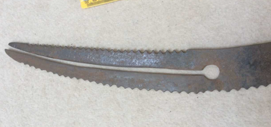

Picture before I started, found it on my phone message from when the seller offered me the some items.
I am very sorry I did not document the process but I did not think it was going to work out as well as I feel it did.
The process of bending the donor blade was quiet tricky and looked like it was doomed for failure but perseverance, a blow torch and swearing paid off!
when the blade initially snapped some one must have glued the broken bit on and had a splint of plastic at the joint, you can sort of see this in the picture.
Ken

There is a slight irregularity in the teeth, easily overlooked or explained away, so most likely not unless I was going over it with magnification.

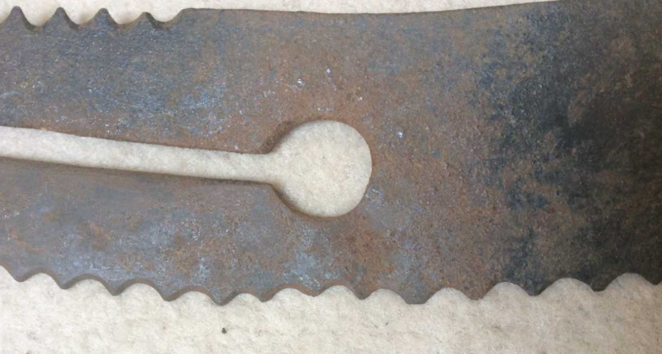

Impressive work. The steel of both pieces look nearly the same. How did you make the weld? What did you use for a filler? Maybe small pieces or powder from the blade piece you welded on?
Ed
Old 14th March 2021, 03:11 PM   #11
Kmaddock
Kmaddock's Avatar
Join Date: May 2014
Location: Ireland
Posts: 549
Hi All
Thanks for comments.
I used a Dillon MK II Oxy acetylene blow torch which has a lot of different nozzle sizes so you can really small Jet, nearly as small as a pencil nib for the jet of flame, it is a v v neat tool.
I want to get a tig welder but have not been able to investigate what is out there as a hobby usage one
For the filler rod I used 1mm Tig welding wire so I could keep the heat down low.
The donor blade was part of an old sword blade i got in mixed auction lot, had just the correct amount of pitting to suit the original blade.
Once i ground the weld and put in the serrations with a dremel tool and a file I cleaned the weld and browned the fresh steel in a hot mix of copper sulphate and nitric acid.
I then buried the blade with this mix on it for around a week in a shallow middy patch in the garden and heaped salt onto the mud and let it rust a bit more
Once finished oxidising I washed with boiling water after neutralisation with bread soda.
