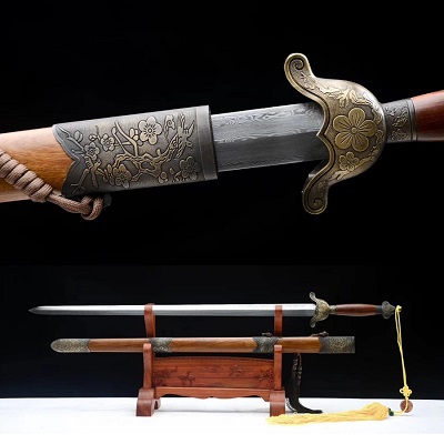

As this hilt has a strong resemblance to those of Chinese 'jian' swords, I would suggest this is done in that manner, and as noted, probably in latter 18th century in accord with the heraldic theme in the guard,.

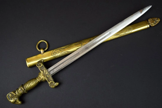

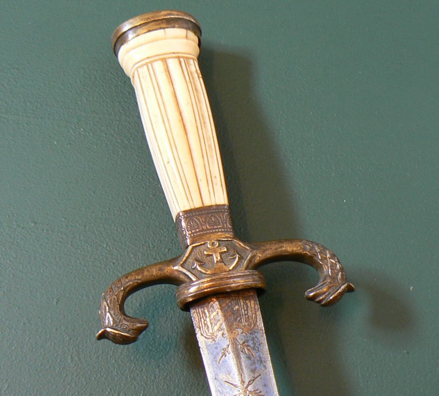

The hilts and grips I have seen more similar, however, are from the French napoleonic navy dirks. But this thing is heavy and measures 81cm.
