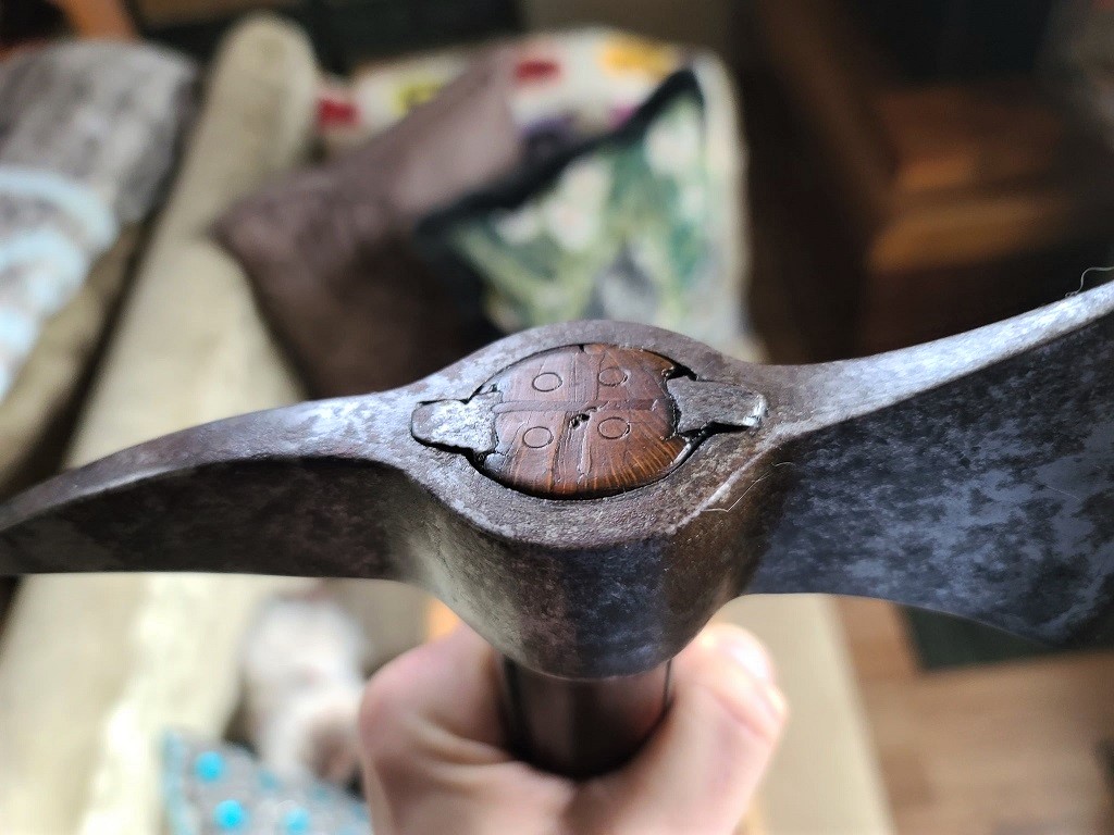

Here is what I believe to be a true 19th century private purchase naval boarding ax. I say 'true' because there are many mimics of such things, including fire axes and trench tools for soldiers. My example has a crescent-shaped (bearded) blade with a wicked 4-sided spike, forward/rear facing langets to secure the head, an early lathe-turned haft (based on the top of the haft cross/circle marks) and round eye. I make my argument that this is a legit boarding piece based on forging marks on the head (thus, an earlier piece), langets that are very primitive and awkwardly made ( not machined duplicates) secured by primitive uneven pins (versus screws) and early hand-turned haft. The rounded eye duplicates the British and American patterns while the bearded blade/spike and rear/frontward langets mimic the French patterns. This eclectic mixture of styles could indicate that it is a variant private purchase pattern meant for the Merhcantman ships or privateers during its period of use (perhaps 1810-1840- end of Age of Fighting Sail). It could likewise be from another nation than the typical naval powers at the time (Dutch, British, French, Imperial Russian, American). I have seen an East Indian ax/blunderbus combination weapon of the same period with a near identical ax head. The ax measures 17" long, head is 8 1/2" wide, spike approx 3", cutting edge is 3 1/4".
Boarding axes didn't start to even have set patterns until nearly the beginning of the 19th century. Prior to that, they were basically spike axes descended down from the 'battle ax' pattern of earlier times. Congruent with their development were the spike tomahawks of the fur trade coming into America. Boarding axes were used primarily as tools aboard ship to cut away fallen spars/ropes after a battle or storm damage. The spike end also was useful to pry free any impacted 'hot shot' (red hot cannon balls straight from the furnace fired by land installations into the hulls of ships to set them ablaze). No amount of water buckets could extinguish a molten hot shot, which would smolder and set planking on fire! The ax men would have to run out in the fray and pick at the fiery shot in the hopes of dislodging it and heaving it over the side! Finally, the boarding ax was of course a deadly weapon in combat on the close confines of a ship's deck. Boarding parties of men crossing plank bridges onto an enemy vessel would often carry these type weapons.

I disagree with that being a 19th naval axe, either the design or the even the stick seems old enough, for me is clearly a 20th century axe, it can be a fireman's or something else, it's not something new so I will consider before 1950.
Sorry but this is my honest opinion.

It's OK, Bruno. As I said myself, I 'believed it to be' a boarding ax. This particular area of collecting is dicey at best and I'll take your opinion under consideration. Hoping to get a few more in before making a decision to keep her. I've owned it for a long time, so it is not a big deal either way. Thanks for your input-

I think distinguishing a weapon which is essentially also a tool with basic similarities which might enable its use in varied contexts, to one specific area is pretty much impossible without exacting provenance.
It is in a way like trying to identify a Civil War weapon as Confederate, when weapons of same types and makers were used universally by both sides. Usually weapons of rougher or cruder character are considered Confederate with the thinking that they had little industrial or supply capacity. Obviously this is not a necessarily adequate observation.
The boarding axe is similarly a dilemma in identification as most of them do have a similarity to the fireman's axe. However it must be considered that in function, they are primarily the same with a pike at the back of the head opposing the curved blade. The pike at the back was to dig out molten shot in ship fires, and to dig out burning embers in burning wood in general.
So basically, their primary function was the same, in fact the axes on ships were often termed firemens axes. These were kept typically near gun ports and a fireman was the job of one gunner, who also kept water bucket at hand. Accidental explosion of powder, burning wadding etc. were perils at hand in addition to enemy shot.
Gilkerson in "Boarders Away" (1991, p.25),
"... weapon and tool, the axe was carried to sea by sailors in time before memory, and there it has remained into the present as the ships FIRE AXE, still looking very much like its direct parent, the boarding axe".
p.29:
"...it should be observed that for specialized purposes men of war also carried other kinds of axes such as various kinds of carpenters axes as well as larger broad axes which were sometimes issued to boat parties when it was anticipated that they would have to cut heavy anchor cable. Boats also carried hand hatchets for cutting of all lines".
p.30
"...the private ships carried the entire panoply of battle gear including boarding axes, which were generally unmarked copies of naval styles".
p.31:
"...the boarding axe was a thing of the sea, and it was unhappy and useless ashore except when fighting fires".
It seems that the well known fire brigades of the 19th century and early 20th were more small community groups which may well have relied on the local tool suppliers much in the manner of those charged with supply of private vessels.
It would not seem unlikely that a tool with such commonality as a fire axe (aka boarding axe) might not have seen use in either of these contexts, nor if one transcended use in one area into the other.
Without specific markings or provenance we cannot unequivocably say this axe is one or the other, but safely that it is distinctly of a form that was used in both an axe on vessels as well as in fire fighting ashore.

It is a great axe but very hard to positively identify for all those reasons already expressed by Jim and others.
The evolutionary link to fire axes is well known. Early French personal fire axes were almost exact copies of their naval cousins - just smaller. There are Gilpin fire axes identical to the mid 19th century boarding axe that are marked to some of the first British fire brigades created earlier in the century.
Most surviving boarding axe examples tend to be military. I guess this is because they may have been returned to stores for re-use when a ship was scrapped or sold and also being well marked they may have been more likely to have drawn a collectors eye in later years.
But Mark is right we know much less about private purchase axes, they are much harder to identify and much rarer. Ship owners would have purchased spike axes made locally that could do the job or they may well have been supplied by the shipyard as part of the equipment. This would have included axes following military patterns but unmarked.
I can't be sure either way but I would tend to agree with Bruno in that it is probably a later axe.

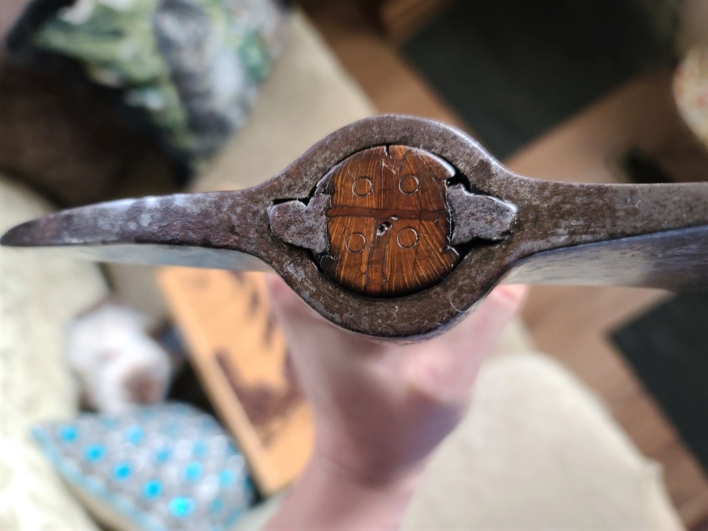

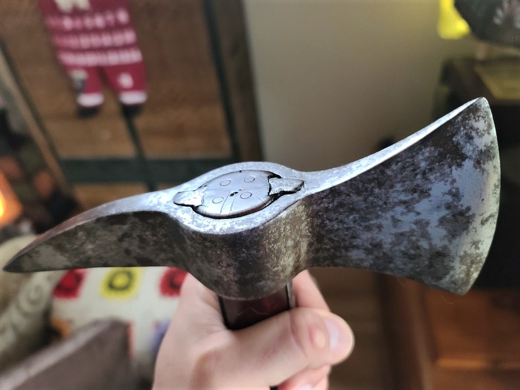

Unlike langets that are forged as part of the head, separate langets need a way to stop the shaft pulling up or down through the eye. Usually a step in the wood underneath and lugs over the top as in French and Scandinavian axes do the job.
It is hard to tell from pictures alone but the lugs on top are embedded in the head. A recesses need to be cut out in the head to accept the lugs - easy to do with machine tools a lot harder using hand tools. If they were just hammered over as opposed to into a recess it would be too weak.
If taking the trouble of making the top flush then there was probably a reason. Is there any sign of a way that a cap was fixed over the eye?

Thanks for commenting, David. I get it and have to decide if I can 'live' with an uncertain piece in the collection or not. Perhaps I'll just buy one of the known examples. I'm just drawn to some of these mystery pieces (private purchase)

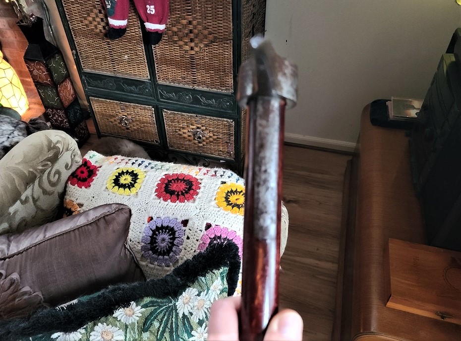

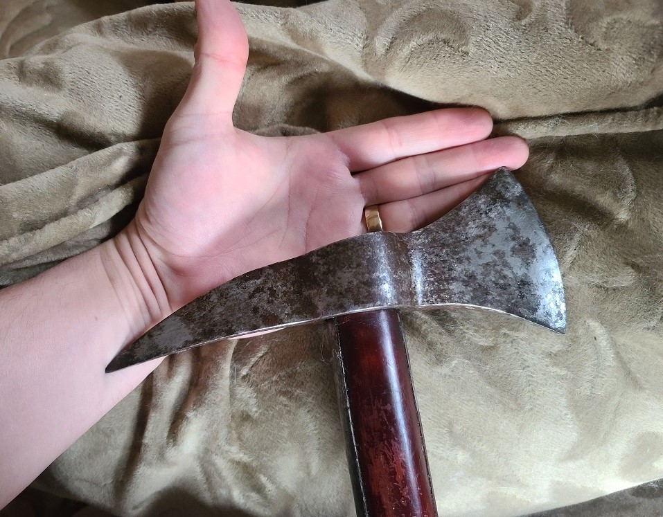

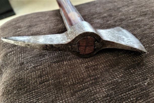

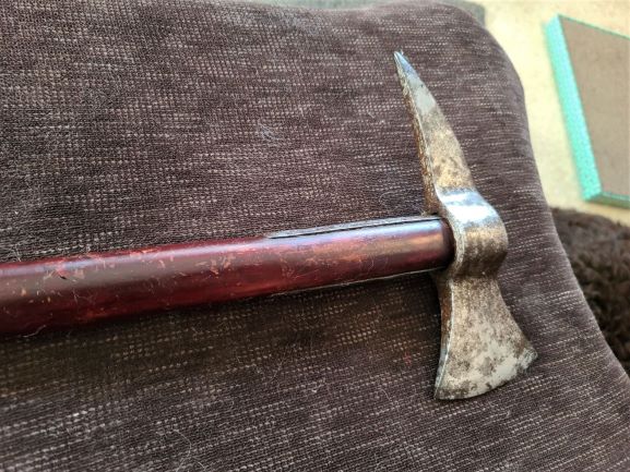

More pics to clarify (or muddy the waters further ) of the ax. Note that the langets are extremely rough at the eye. Likewise, they are not identical to each other in length/thickness and they are not straight, appearing to be more individually crafted. Still on the fence with this one-
I forgot to include dimensions- 17" tall, head total length 8 1/2", spike approx 4", blade length 3", cutting edge 3 1/4", eye width approx 2". This would seem too small for a fire tool? The haft narrows dramatically towards the end, which never had a cap, lanyard hole, etc.
