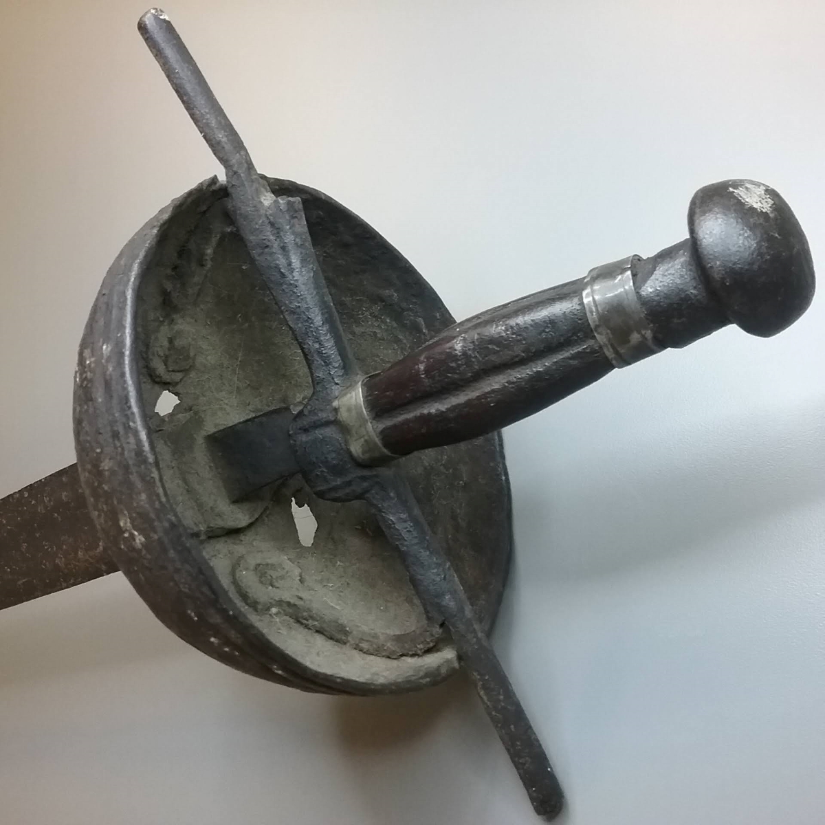

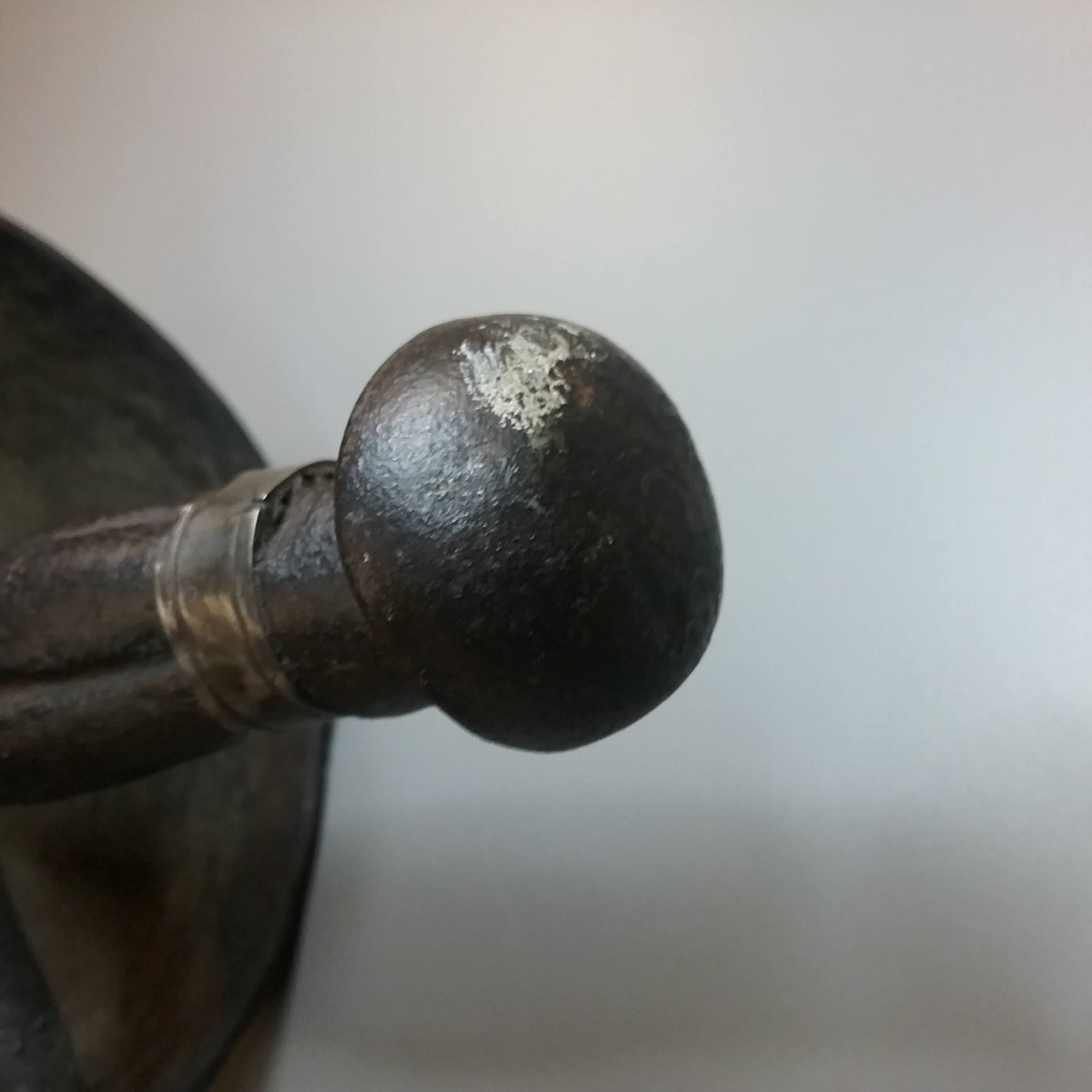

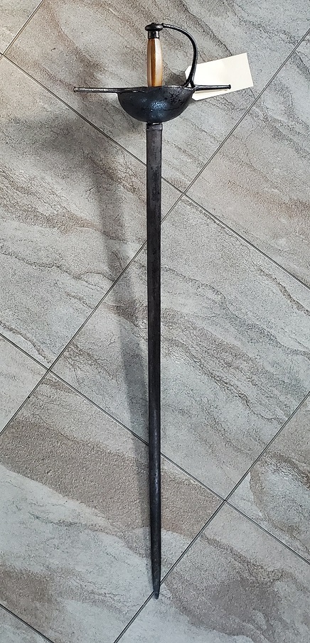

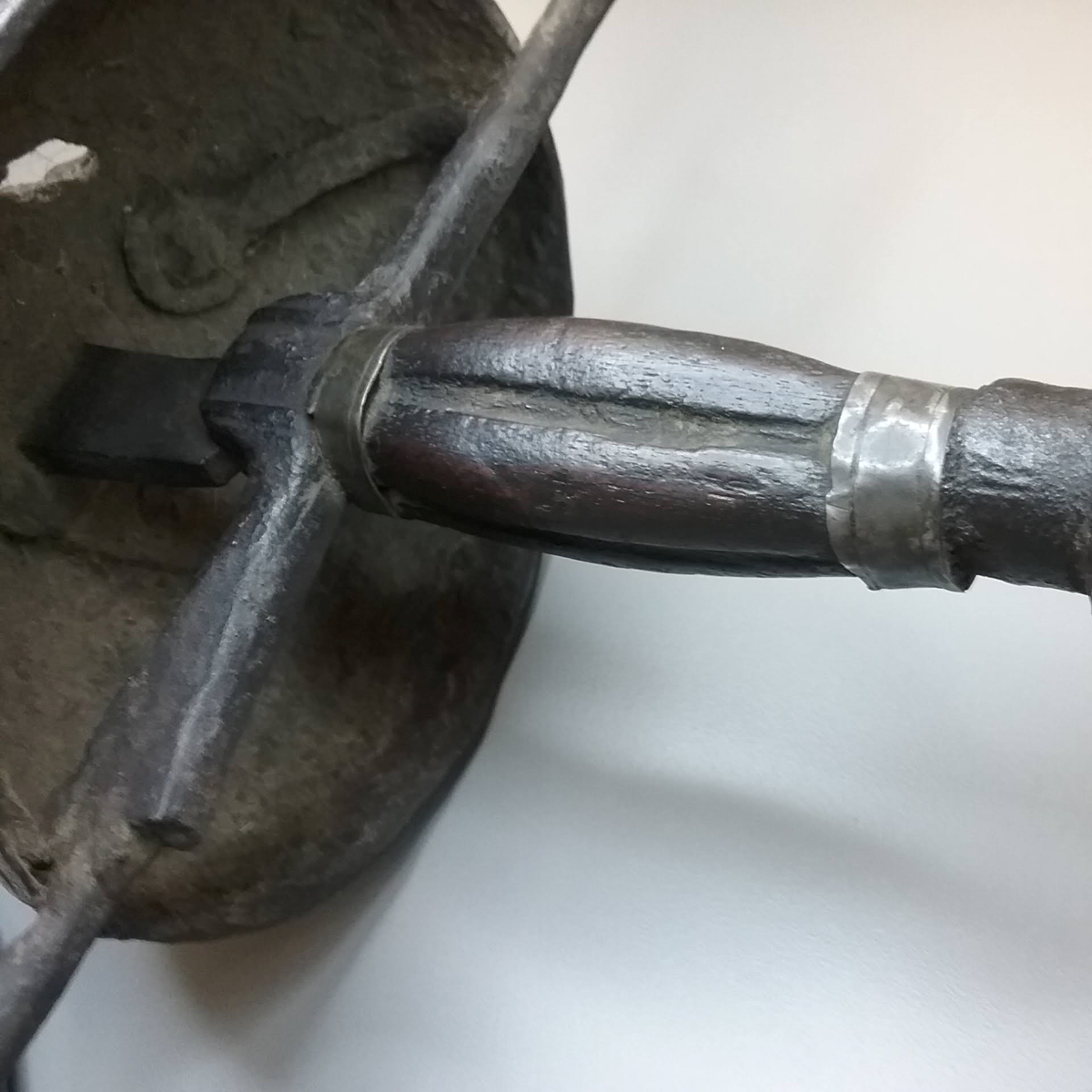

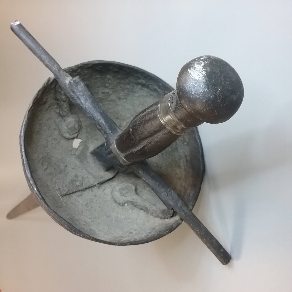

Well, I took another swing on an unnoticed (or dismissed) piece. I'm not sure this can properly be called a rapier, but it seems to fit the style/proportions for bilbo swords circulating among the Spanish colonies. It is well worn and, to me, this lends it a character that more pristine examples lack (not to say I wouldn't happily take any 'extra' pristine beauties anyone might have lying about!). I know many of you agree.
So, given my track record, I acknowledge there is a good chance this is not an authentic period piece. I will offer the elements that convinced me to take a chance, as well as those that give me pause.

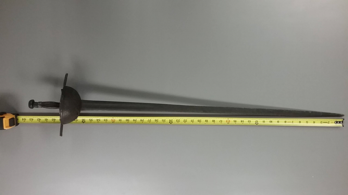

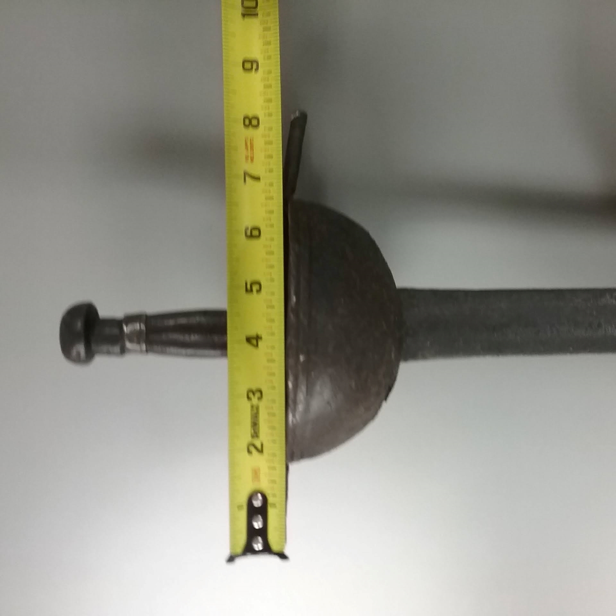

First, dimensions:
Overall Length - 43.5"
Blade length (point to guard) - 36"
Width of quillions - 8.25"
Cup diameter - 4.75"
The point of balance is right where it should be. The blade's original length appears to be intact.
What seems correct to me:
The blade appears correct and consistent with these mounts.
The quillions/quillion block appear correct. The fact that the knuckle guard is missing and the damaged remnants remain present suggests authenticity.
The grip appears correct, although missing the 'posts'. However, the detail of the grooves in the grip into which these posts would have fit is another detail that seems to indicate authenticity.

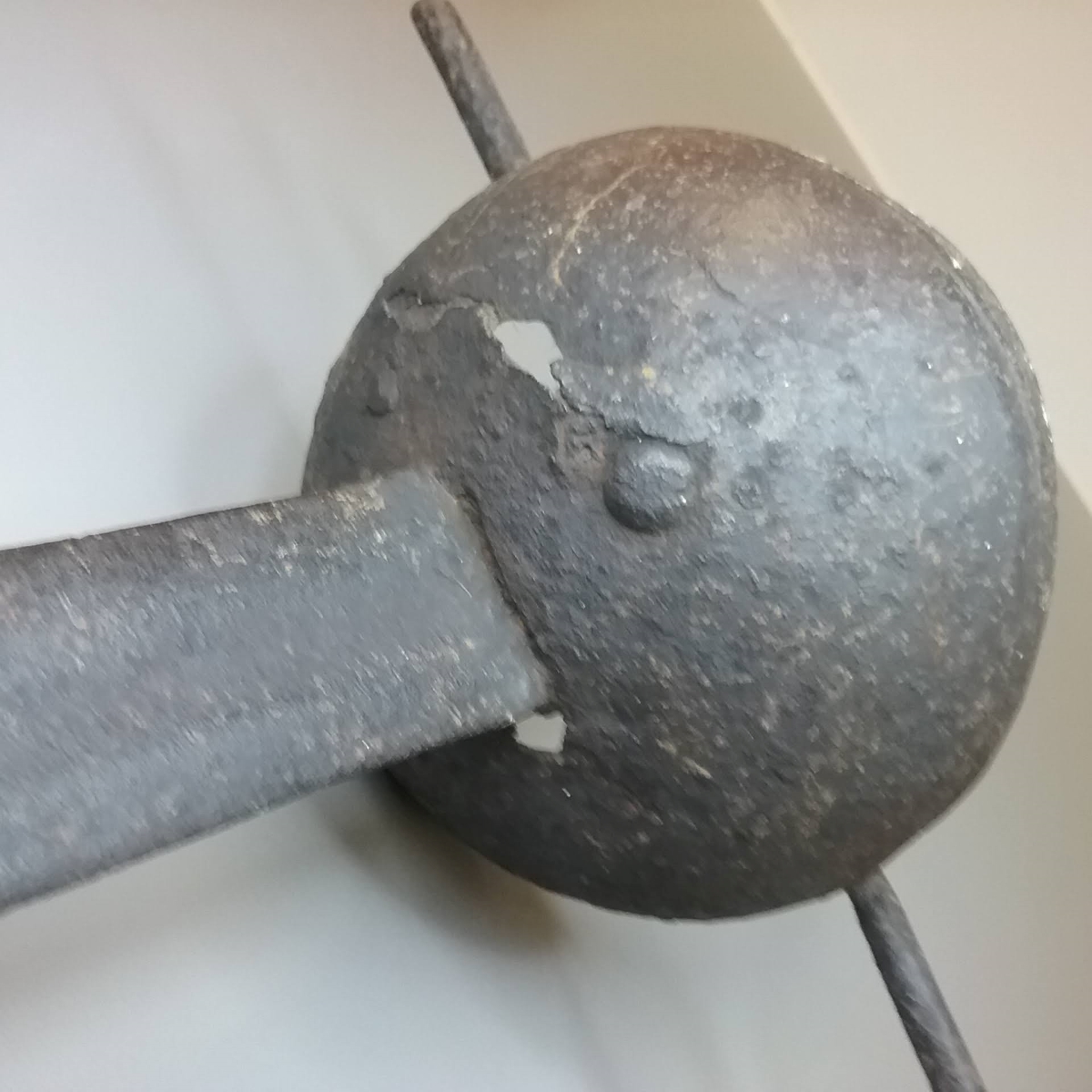

It also has what I think is termed 'guardo polvo', although this seems to strengthen the guard and would do little to protect against dust. Indeed, there is a good amount of dust from the previous owner evident in the pictures Given the damage to the guard, this extra bit of reinforcement makes a lot of sense in a proper fighting weapon.
What gives me pause:

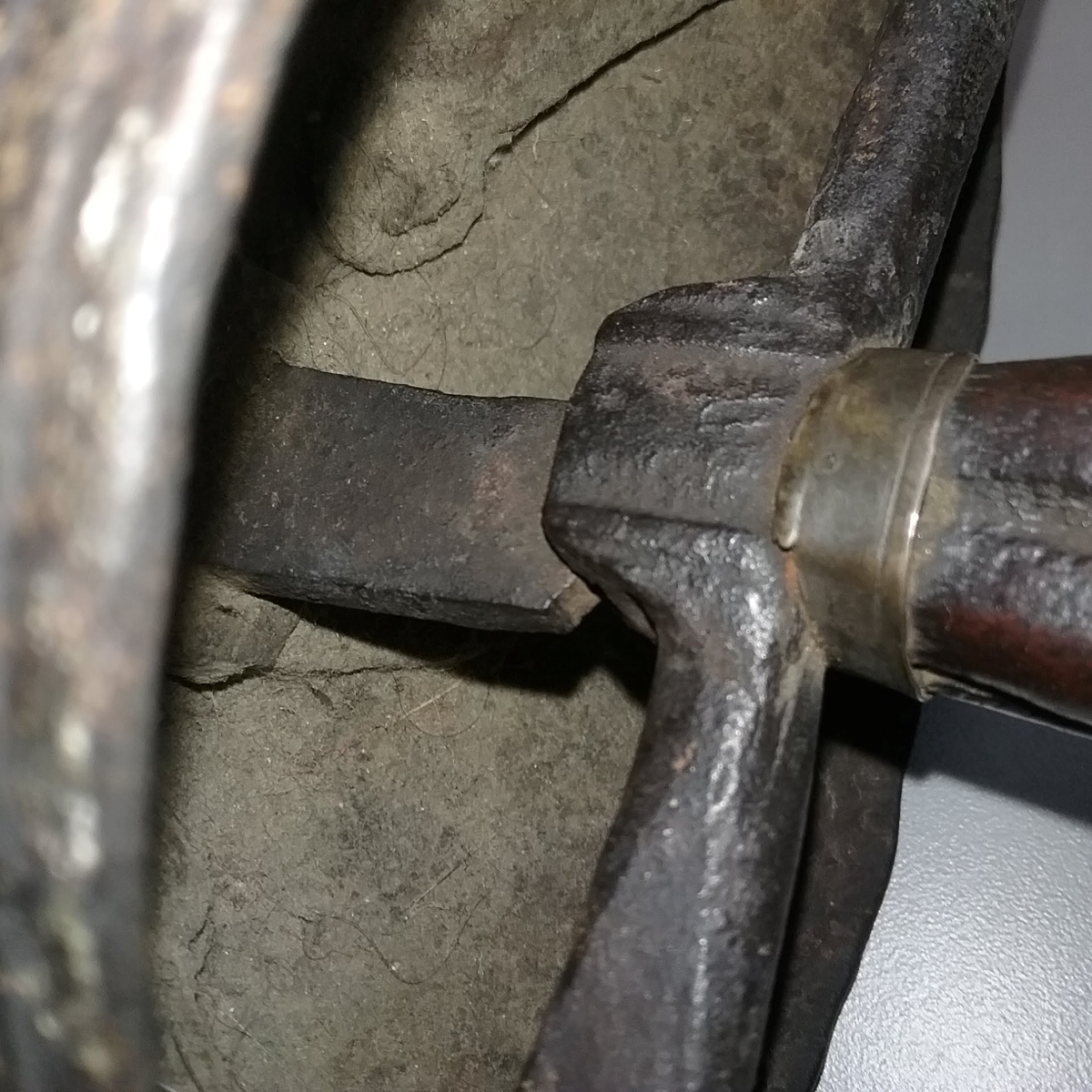

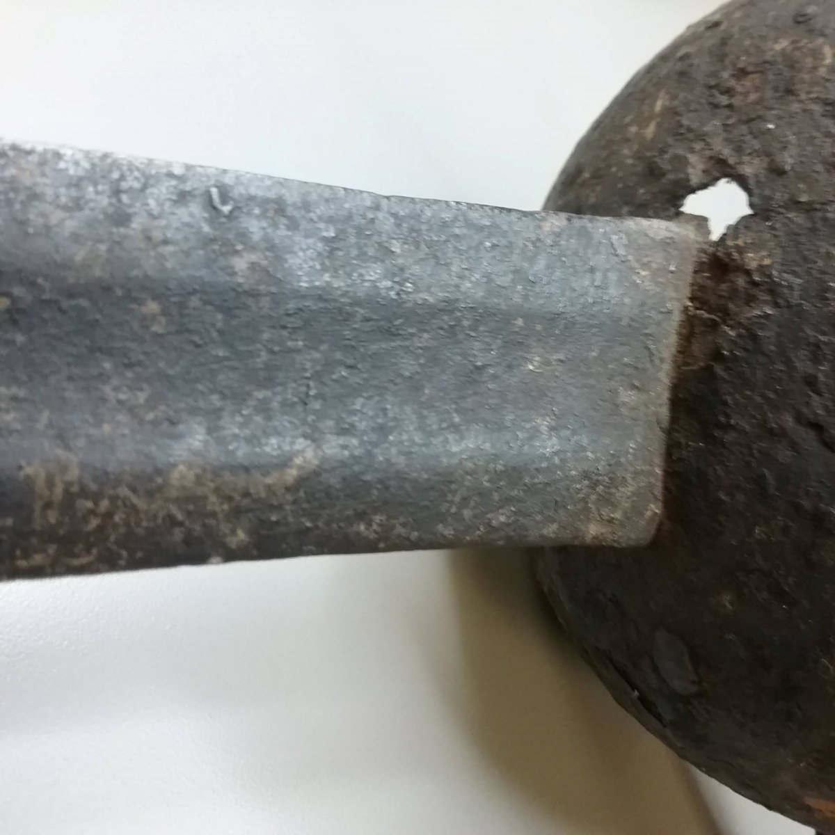

Looking at the ricasso, it is out of alignment with the grip. This could be the function of less than perfect colonial assembly. It could be dislocated due to hard use. Or, it is poor marriage of composite parts at a much more recent date.
The pommel doesn't seem quite right. Everything balances correctly, but the shape seems 'off'.
The ferrules at either end of the grip have little oxidation. The do seem to fulfill the appropriate purpose of holding the [missing] posts to the grip, but they don't seem to have aged consistently with the rest of the piece. Still, if a later addition, why add them at all?
So, for the most part, I think I did well here. As always I welcome your comments, and value your insights.
Old 15th October 2020, 04:48 PM   #2
Posts: 10,872
This is beautiful!!! and as you say, this kind of rugged charm is outstanding, a working weapon.
This is effectively a 'rapier' (obviously by the cup hilt form semantically associated in true rapiers). It is actually an 'arming sword' and typically used by Spanish colonial forces in the Caribbean regions and 'Spanish Main' (Central and South America off Gulf).
It is most definitely 18th century, probably earlier in century, and as with colonial weapons, refurbished over long working lives.
The wire wrap and posts are missing, and as you have noted this was an affectation typically on the 'bilbo' which was basically a 1728 'pattern' (though in use before through the century).
The guardopolvo (=dust cover) does not exist in these, they were a decorative plate at the blade junction inside the cup.
These were typically carried by infantry forces in the colonies and existed concurrently with the bilbo. As these colonial forces were remote they seldom had stringent regulation, and swords were more tradition than weapon as a rule.
Outstanding weapon!! and these are not often seen available, even less than bilbos.

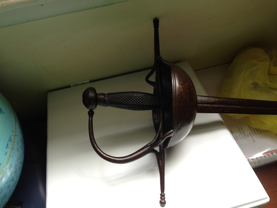

Posts: 10,872

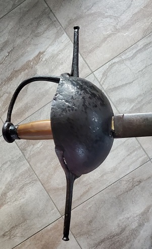

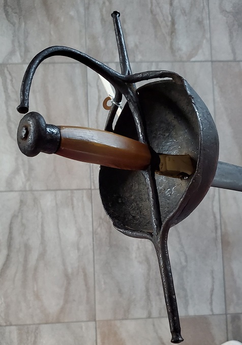

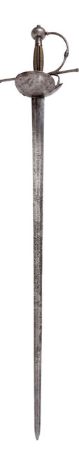

Capn, that is a SUPERB example!!!! Beautiful ebony grip, nicely turned quillon terminals and the edge around the cup a nice touch. I think one of the best examples of these I've seen.
Mine I am sure has been reworked of course as the ivory spacers reveal a circumstance in refurbishing, and as noted the hilt has been peened.
Still traces of japanning and must have had a long working life.
Yours is a fine example which likely would have been an officers aboard a vessel. Outstanding.
Victrix- great call on the 'Spanish motto' blade!!

Thanks, Jim. I was lucky enough to win this one on an eBay auction quite a while back. I had never thought about the subtle nuances in the decoration to this item. The 'refinements' do stand out from others I've seen. I like your thinking that perhaps it was an officer's grade rapier! I also truly like Shayde's rough and tumble example with saltwater-corroded blade. It just screams "Spanish Main" to me!

Also, I wanted to clarify - this sword DOES have the guardo polvo. YOu can make it out in the 4th picture of the original post. It is a simple diamond shape, and you can see on the exterior of the cup the large rivets holding it in place (transverse of the rivets securing the pas d-ans). Does this narrow down age attribution, or does this muddy things more?

With regard to these 'going to sea', it was virtually inevitable that many of them did in one way or another. The constant traffic to the 'New World' meant that these among many other forms of sword, particularly 'cutlasses' became present there with men off the vessels.
By the 'dictum' from "Pirates of the Caribbean', there were no 'rules' ......but 'guidelines' as far as swords, their use, etc.
Aboard ships of the line of course, the average sailors were not officially armed with edged weapons, but these were distributed out of arms lockers in the event of potential combat. With the ever present merchant ships, there was certainly more latitude depending on the owners and staff of the vessels, but still there would certainly be the option of having a sword or cutlass for various levels of staff aboard.
With the 'brotherhood' of 'pirates' of course, a broad spectrum indeed, it would seem these vessels were of course autonomous and the members of the ships crew would choose thier own arms.
From what I have understood, combat aboard the decks of vessels was not as common as portrayed in movies via popular literature, and swords and cutlasses were far more employed ashore by the crews at locations of destination or replenishing. In this respect the cutlass was more a 'machete' and used in that utilitariian sense.
The swords (i.e. cuphilts, bilbo's etc) were there in case of combat, whether defensive or offensive.
Well noted that most crews, sailors or other members aboard ships were certainly not typically trained in swordsmanship, while officers usually were in some degree. This factor would lead to the more instinctive use of the 'blade' in more a 'hacking' manner, and call for much stouter blades, as would be expected in most combat circumstances. Naturally, blades are designed for optimum conditions presuming they will be used properly so flexibility is always a consideration. Without it, a blade will inevitably fail at some point.
The long working lives of these swords, particularly the blades ,which often ended up being remounted or repurposed, is the most fascinating factor of them. The Spanish 'dragoon' blades were widely used in the colonies for other weapons beyond simple replacement on the bilbo's and cup hilts, and became present on the 'common' espada anchas in many cases, typically cut down.
There is so much history in these rugged Caribbean forms that its hard to not go on and on but Shayde, VERY well placed questions, and I hope any of this rambling wiill be useful.
On the hilt elements, the 'guardopolvo'is essentially a 'dust guard', though its actual purpose was more to firmly secure the tang of the blade in the cup.
My example has 'ivory' (?) placers wedged in from whateever refurbishing was done on it.
The 'rompepuntas' is the rolled edge around the cup, and theoretically was to foul the point of a rapier in a thrust attack, which of course falls into the sword catcher theory well known in arms descriptions. Personally it seems to me more a refinement in construction and execution of hilt design.

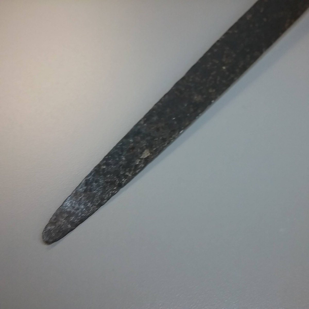

I do suspect there could be an inscription in the fuller, but I don't believe it could be uncovered without severely altering this blade, and with no guarantee that any inscription would still be present (if it ever existed).
Jim, as for the rompepuntas, not that my example has this feature, but I believe these were a very pragmatic refinement. I know sport fencing doesn't have a lot of bearing on how historical weapons were used, but if I may digress, as an epee fencer I often made use of a technique of glancing my tip on the edge of my opponent's bell and scoring a touch on the hand since there was nothing to stop the point from sliding off the guard and striking the fingers/wrist behind. I have to imagine that this was something that occurred frequently enough when using live blades that rolling the edge of a cup guard to 'catch' the tip made good sense. I don't presume that this allowed tips to be snapped off, or served as 'sword catchers', but still useful.
Also, regarding the guardopolvo - I didn't know this term until I started researching my new acquisition. Initially, I couldn't figure out why something deep in the guard would be called a dust protector. However, I may have come to a conclusion that is plausible - Given the frequency with which guards, hilts, and blades were swapped and interchanged, these components wouldn't be crafted to tight specifications, but rather with some tolerances to allow for greater compatibility. The ivory wedges used as shims on Jim's piece shows the need to marry parts that don't exactly fit perfectly.
For a cup guard, the guard itself is not the easiest component to manufacture. It doesn't take a master, per se, but still, it takes time that could be spent elsewhere. So, if one wanted to make a guard that could be used on multiple blades, or one has a guard that doesn't fit snugly to the blade, the smith could craft a simply plate that both serves as a spacer, AND closes any gaps between the blade and the guard. Functionally, this would prevent dust and debris from falling into the cup and then making their way through the gap along the blade into the sword's sheath. Cup hilts would have been particularly susceptible to this problem because the cup is essentially a funnel for all matter of gunk. I can't think of another hilt design that would allow for so much debris to be channeled right into the scabbard when sheathed. Hence, the name 'dust guard' for a simple plate that serves as a spacer/shim, reinforcement for the guard, and yes, a dust protector.

The way the corrosion looks in the fuller suggests there could be font there. However, I cannot get it to photograph in a meaningful way, and I'm not sure how to gently get down to that level of the metal to be able to determine. I'll see if I can play around enough with lighting to get the faint trace I think I see to appear in a photograph. Of course, I may well be chasing a ghost...or a phantom that was never there to begin with
Also, thank you for the details concerning weapons use on the decks of a ship. Following your posts over the years, I know you've built your knowledge and have become something of an expert in this regard. The insights are appreciated!
The patina looks quite attractive as it is. Perhaps something appealing about having a look of something salvaged from the salt sea water.
You could try looking at the blade from different angles and direct a torchlight on it. Another trick is to put a blank piece of paper on it and rub a pencil or a charcoal on top, although the surface might be a bit uneven for that.
