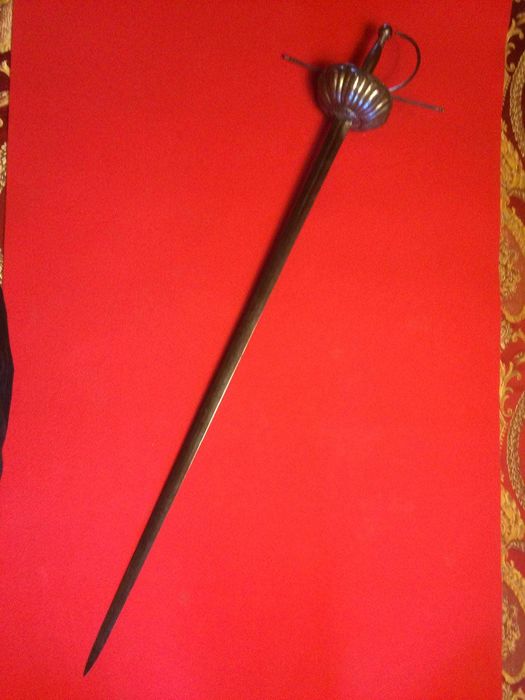

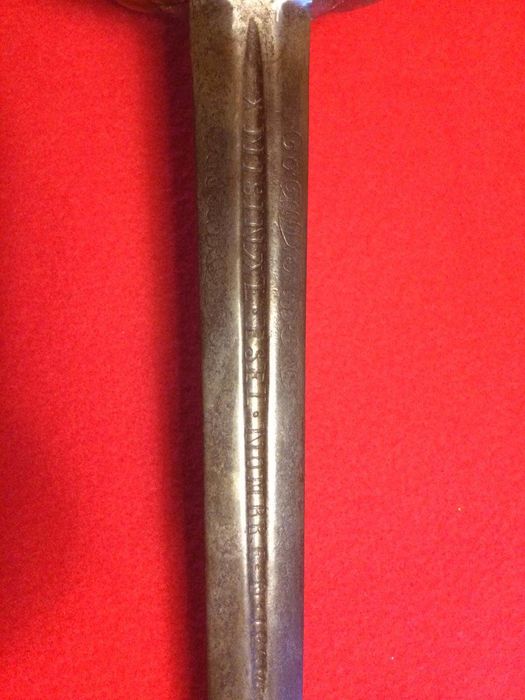

I just got a nice cup hilt with a military blade. Similar blades with the inscriptions "xESPADEROxxENxxALMANIA" and "xMISINALxxESELxxNOMBRExDxIESU", can be found with cavalry officer swords of the 1728 model, although I suspect they could be mountings with older blades. I will put tentatively this one in the period 1670-1690. Grip is metallic and it has a nice point breaker and a simple "guardapolvo".

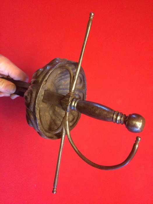

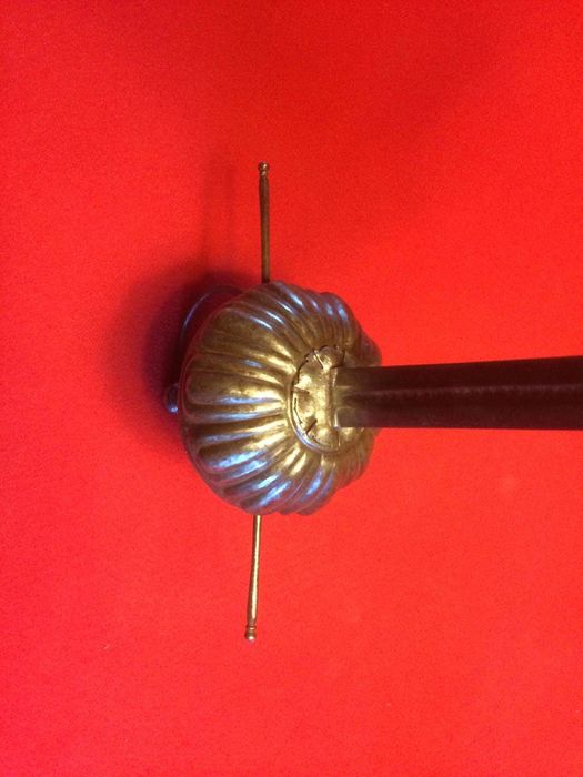

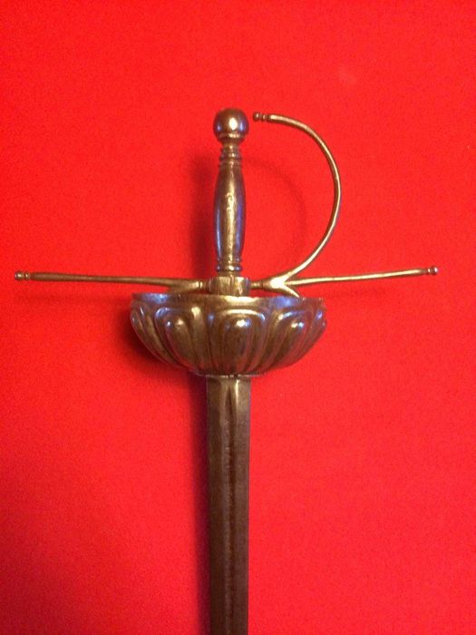

There was something strange with the upper part of the cup, the border is too irregular and the gap with the quillions too large.
I suspected it could be due to a missing decorative silver or brass band at the rim, and having the sword in the hand, now I think this is the case. Also something could be also missing at the root of one of the quillions.
However, I cannot find any similar examples. Maybe you know of some. Silver/brass decorations are not unusual in newer examples, especially with a colonial background.

Hello Midelburgo. Beautiful cuphilt and I'm rather surprised no one has commented on it yet. I am but a novice when it comes to these, but I think you are on the right track when you mention a possible colonial connection. I know this always gets some dander up when mentioning such, but I feel it is a distinct possibility. The cup is very fine, but lacks the blade catching rim (I always forget the name!) and the brazing of metal to secure the quillons (pas d'ane, etc) are often seen in colonial settings. The grip is also a simple affair, not the double knotted copper wrap/turk's heads often seen, but again, this could still be a 'munitions' grade piece, but if so, why the fancier bowl? The m1728 blades with motto were shipped to all of Spain's colonies and are find on ship's rosters and also on many a shipwreck found in the New World. In either event, she is a real beauty and I'd love to have her for my maritime/pirate collection should you ever decide to include me in your will-

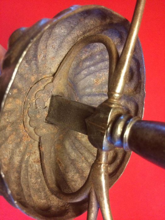

I agree the cup must have had a substantial rim. Seems likelier it would have been iron, and friction fitted rather than riveted? Wondered if there are any rivet holes; none visible in the pics.

No visible way of attachment. A possibility is that the rim was sawed off, for whatever reason, but there are no clear signals of that either.
