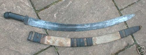

Just purchased this sabre, the blade is 26 inch long seems to made of good steel, and has a broad fuller each side. The handle is leather cover. The sheath is made from canvas, fur and leather. Searching on the 'Anthropological Collections' website I found a sheath that is identical to a sword from the Ivory Coast.
I haven't received the sword yet, but I am wondering whether this sword has a European blade. I thought that generally speaking 'African Sabres' tend to be found in the North, or is that a gross simplification?
The seller suggested 18c , but if he is right, could this be a relic of the slave trade era. (ah ..the romantic thoughts of a fool)
Comments gratefully received ( about the sword...not my sanity )

The blade looks European, maybe a cutlass blade? When you recieve it, is it heavy, how thick is the back? Is there some engraving or something on the blade by the hilt. If it is a cutlass blade I would bet somebody knows where it was made.

Thanks Tim, I had started to think, it could be an old Naval cutlass. With the slave trade on the West Coast, the European Slave/Trade ships, and the recuitment of local tribes to capture 'fresh stock' or for cheap labour.. It does seem possible that a European blade could have been easily obtained and 'Africanised'. Obviously, if the blade could be dated, it could help to prove/disprove this theory. The scabbard apparently is canvas backed, possibly another connection to the sea/tall ships. Have you encountered similar styled scabbards from other regions? Or do you think the design is definitve to an area, region or Tribe?

As Tim has very astutely observed, this very heavy blade does appear to be a naval cutlass blade. It would seem this blade most likely from a French naval cutlass, probably the M1792, though the blade is interestingly a bit more parabolically curved. It would not be surprising for suppliers to the French after the Egyptian campaigns to have been inclined to such feature.
See "Boarders Away" , William Gilkerson , R.I.1991 (p.78, fig's #20,21) for examples of this pattern, typically mounted with three branch guard.
Obviously, during the 19th century, the coasts of West Africa were heavily colonized by the French, and these naval blades found thier way into native armouries. The blades were of course remounted many times, well into the 19th century. The history of these regions, the tormenting and unfortunate tragedies of the slaving, and the rich culture later imbued into the Americas does indeed include romantic tales.......and it seems quite likely this blade in its more recent mounts most probably has some of its own!!!

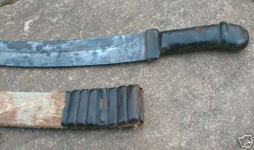

Finally .....the sword has arrived. Nice solid feel, nice balance and relatively 'heavy'. Some deep pitting and nice patination on the blade. I can't find any markings at all.
Taken a number of measurements.... hoping that someone may be able to identify the European (?) blade. Thankyou
The spine (back) is 4mm thick, then at approx,18cms before the tip it thins to approx 1mm.
It has a broad fuller, both sides (18mm wide) and is 38cm long which follows the curve of the blade. Because the photos do not show this clearly I have applied tape to show position.
The blade is 48mm wide at handle, slightly tapering to 42mm approx. 15cms before point, then tapers again to 38mm just before point.
The blade measures 70.5cm, following the curve (of the blade), handle is 15cms long.
