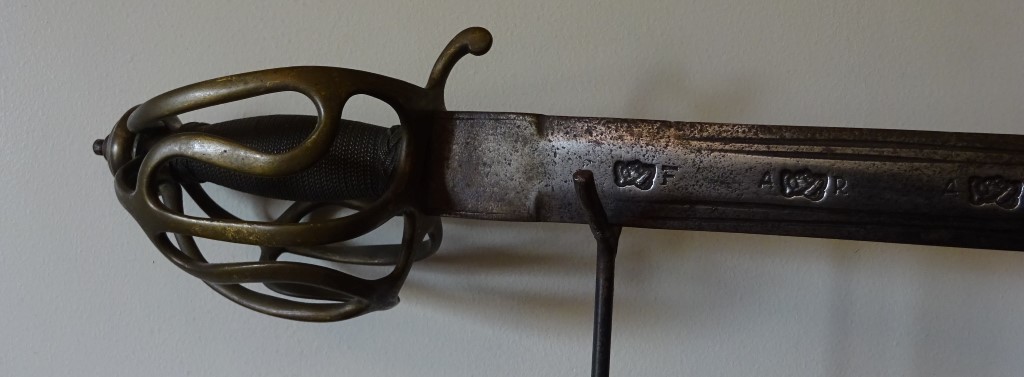

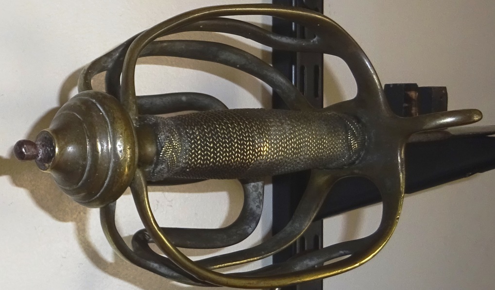

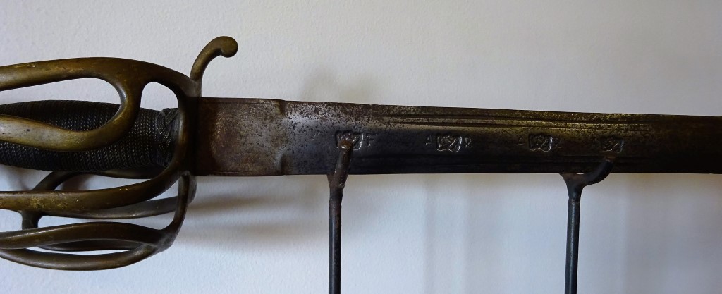

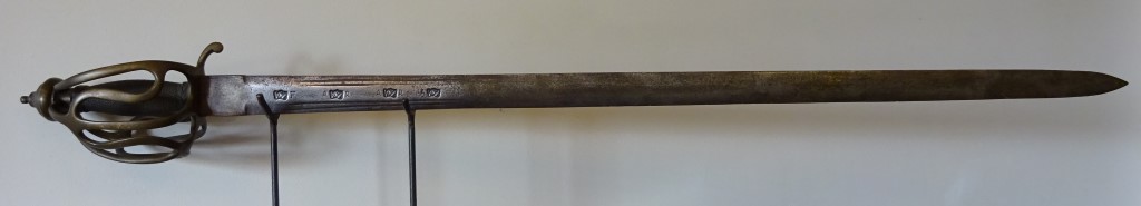

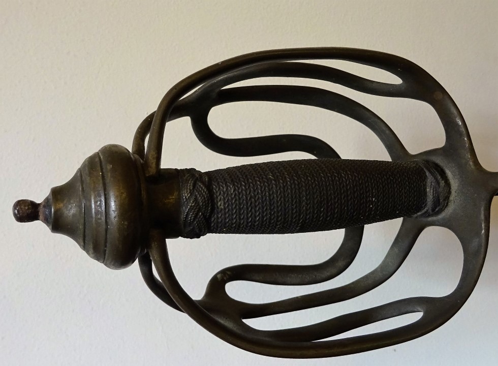

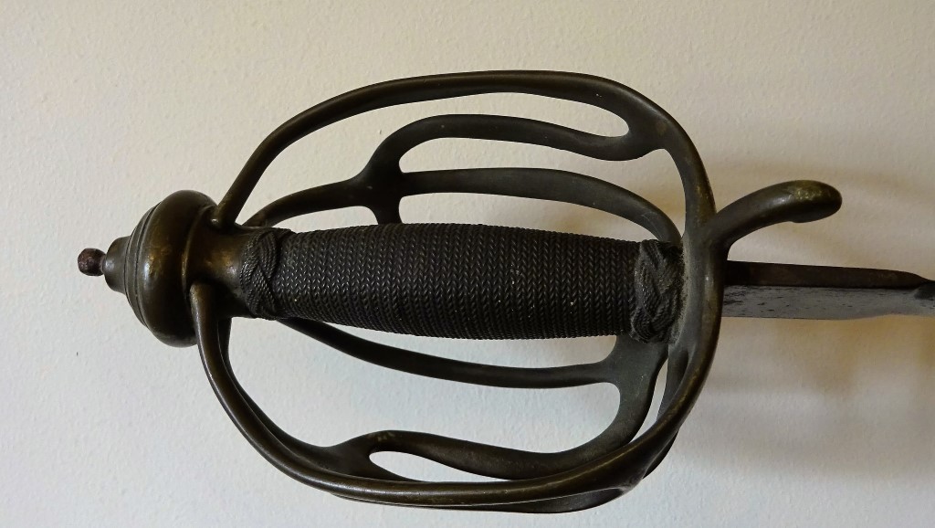

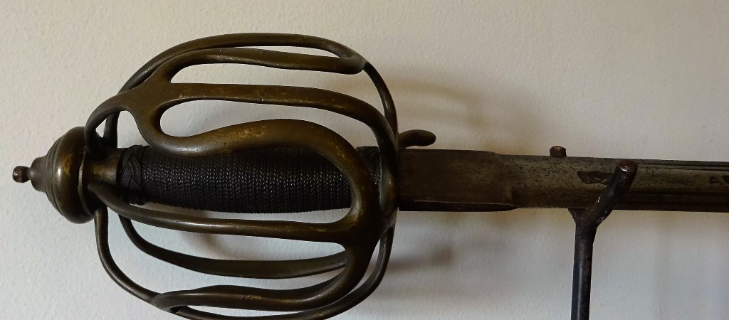

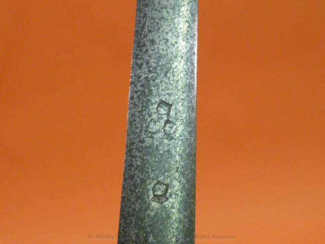

I know next to nothing about these swords. But for a couple years i was fascinated with this one; perhaps because i had seen it in a fellow collector's house and i knew i could manage to acquire it. So i did and it has just arrived.
With its four kings heads interspersed with the name ANDREA FARARA, i realize this is a genuine blade forged by Johannes Wundes but, what do i know ?
The 'unusual' bronze hilt with a brass wired grip and turks heads look consistent ... to me.
The double edged blade measures 87,5 cms. Sword total length 104 cms. with a width 37 mm. and thickeness 6 mm at the forte. POB 8,5 cms. from the hilt guard. Weight 1110 grams.
Could i have some help in analizing this sword, please ?

Most interesting basket hilt, especially this blade.
Certainly appears to be of the style of English dragoon swords of 18th c. but the wire, turks heads and pommel suggest we might check elsewhere. Perhaps Sweden or the Continent and officers sword?
The kings heads of course are normally associated with Wundes, but these used as punction amidst the lettering for ANDREA FERARA profoundly atypical.
Worth a look into Mazansky, European Markings (Kinman) and some of the other references on marks might be helpful. Looking forward to other views especially Ulfberth and Jasper.

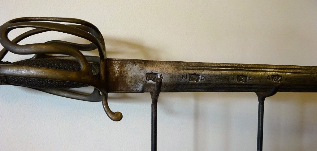

Hi Fernando,

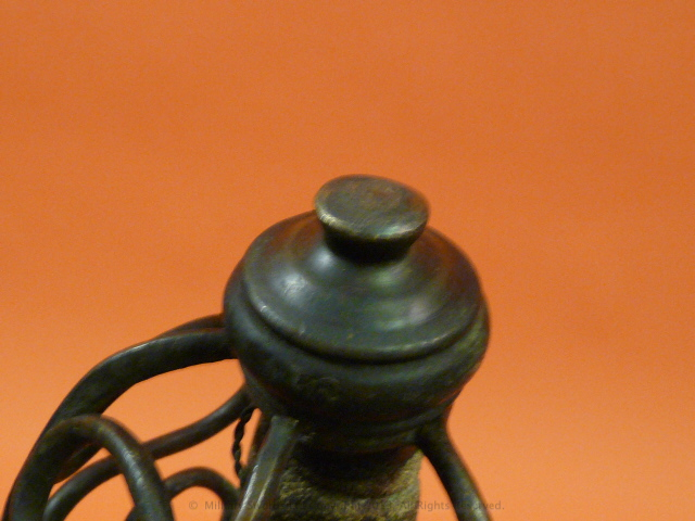

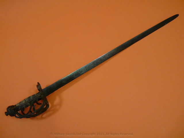

First let me say that there is no doubt that this is an Original sword and all parts belong together, a untouched and pure sword.
Im no expert on basket hilts but my first impression was English mid 18th C. it could be European to.
Here is what I found, ( see pics ) its not the same but it does have the kings heads and brass basket hilt. Altough the blade is in the style of the late 16th C , I believe this could be a German 18th C blade for export, including the Ferara name for quality or economical reasons, this is of course speculation.
kind regards
Ulfberth

Mea culpa Nando, what I 'should' have said is that the grouping was unusual to me, as clearly you found another example quite readily. I suppose I am simply more accustomed to seeing the kings head grouping in threes as seen on the example posted by Ulfberth.

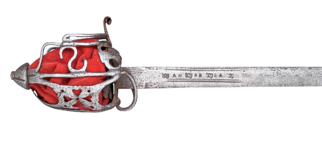

I would note that the example you posted (in #3)is a basket hilt of 'Stirling' form c.1715 (Darling, 1974, p.82) so interesting to see blade so marked in that time frame.
If I am not mistaken, the hilt on your example discussed in this thread is brass. It would seem that dragoon swords were produced in brass in Glasgow around 1720s (Mazansky, 2005, p.108).
I think Ulfberths inclination toward English character is correct though I had also thought this might be a Continental piece. In checking Danish and Dutch sources I found nothing in this type basket corresponding, and the pommel redirects to British. It is actually a combination of Mazansky typology IV and VI, with somewhat taller oblate form (Mazansky, op,cit.p23).
I am inclined to think this is indeed a British dragoon sword, but with the wire grip and Turks head to an officer. The blade is most certainly of c. 1715+ and Solingen, and as shown with these kings heads intermittent with the well established ANDREA FERARA name which catered to Scottish market. The kings head with beard do not correspond to the early Wundes form and are facing opposite from examples shown. The bearded versions are of Johannes Wundes the elder 1560-1610 and later Wundes group had no beard and more stylized.
The blade is of course far later than that type kings head of the early Wundes.
The 'different' application of these kings heads as punction with the ANDREA FERARA name suggests to me (as noted by Ulfberth as well) that these blades though from Solingen were produced with spurious kings heads alluding to the Wundes makers (Weyersberg did not adopt the mark until 1774) and obviously commercially gauged, in numbers unclear but of the period shown.
Most dragoon sword blades of this period early 18th century were backsword, but officers had the option to broadswords. Many of the Scottish units in British ranks, particularly officers had brass swords in the post 1715 period and later of course.
This again looks like an officers sword, probably 'garrison' made in either Glasgow or Edinburgh, more likely Edinburgh c. 1715-50 .

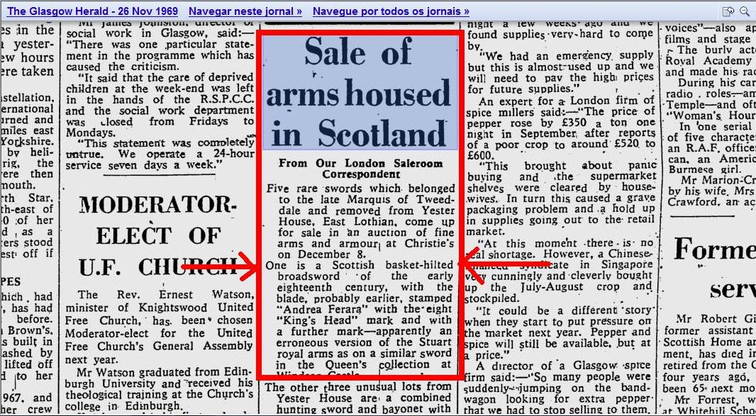

One of which i have just recalled having kept in my hard disk, concerning an announcement in the Glasgow Herald published in Nov. 1969, in that an auction to be held at Christie's would include five rare swords that belonged to the Marquis of Tweeddale ...
Well Fernando I'm speechless

I am with Ulfberth , speechless on this tidbit on this sword.
Wow, '69, the summer of love ,man!
So we have EIGHT kingsheads, along with Andrea Ferara. Maybe these became a kind of talismanic or quality symbol, and the more kingsheads the more mojo.
I am now compelled to find more of the kings head phenomenon data, and to discover how many variations and configurations can be catalogued

Wait a minute, guys .
By eight kingsheads, they mean four on each side; as Andrea on one side and Ferara on the other.
... Or am i missing something here ?

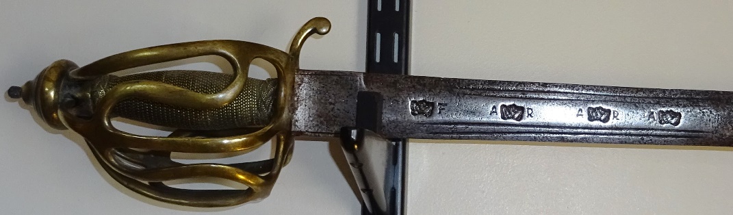

Great Basket, you must be very excited to acquire it. Unfortunately with basket hilts the blade don't help us much as they where rarely of local manufacture and everyone wanted some version of Farara on them.
This brings us back to the hilt, which at first I thought British dragoon variation, however having now become aware of the popularity of Basket hilts in France I am leaning toward s this one being French or continental. Haven't found one with these elegant rounded bars in my data base yet so I will dig into my library and see if something pops up.
The wonderful thing about basket hilts is the variations are endless and keep up guessing. As I said great sword, wish it was in my collection.

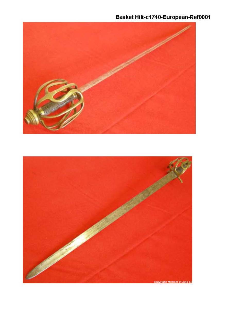

Default Found one Similar
Hi Fernando,

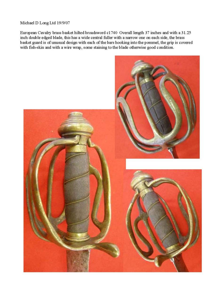

found this one in my data base, very similar with a plain blade. Michael long had it listed as a European Cavalry sword.
Cheers Cathey and Rex
Cathey is offline   Reply With Quote
Actually no, but here is another good lesson in accepting data from a 'news item' verbatim as accurate. In the reference you posted from 1969, the text reads the blade is marked with " THE eight kings head mark" and does not specify that the number was inclusive from 'both' sides of the blade, but suggests seen as one group. The article does not specify that ANDREA and FERARA were on opposing sides of the blade either.
I guess its kinda like using art to research weaponry , in a thoroughly riveting concurrent discussion on another thread. Always need to verify!!
Cathey, thank you so much for the outstanding reference to this European example! as well as cross referencing to your excellent thread on basket hilts which thankfully maintains fantastic momentum. It is great to have this expanded view of basket hilted forms elsewhere in Europe.

Excelent, Cathey ...
Thank you ever so much for the great info and convincing pictures.
The fact that you wish this sword was in your collection is for me the best certificate of quality.
So French it will be.
