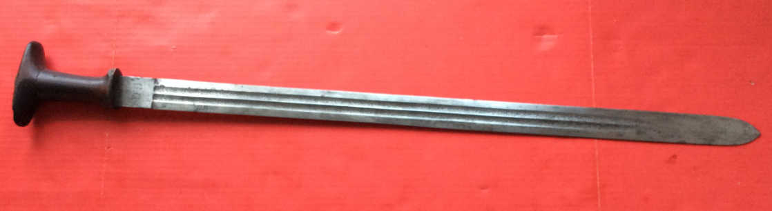

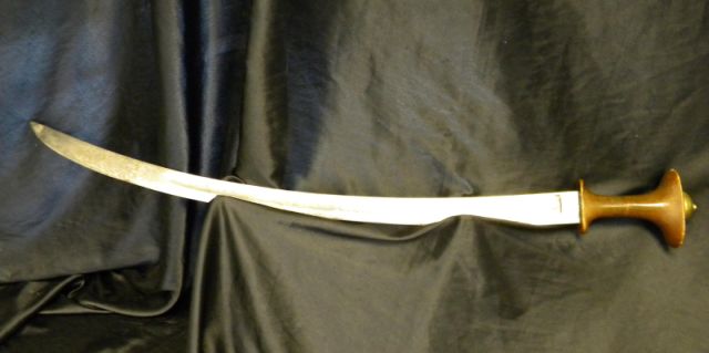

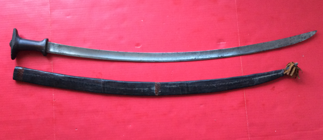

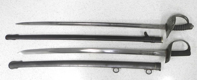

Gents, I bought these East African swords at a swap meet recently and researched that they are Ethiopian. Are these hard to find relics?
There is not much to find on the web about them and I'd appreciate help in better understanding them.
Bill

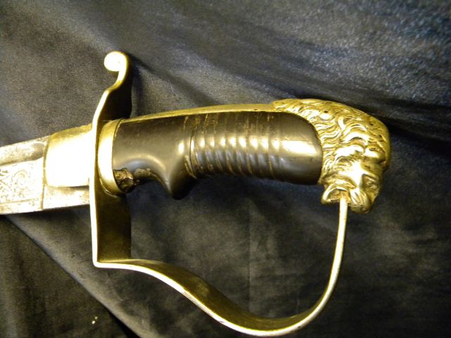

These two swords (very nice BTW) are indeed Ethiopian.
The one with the lionhead is a stirrup hilt sword of military type and appears to be Italian. These seem to be from the 1890s going by the George V blade, which is extremely nice by Wilkinson, who was of course in London and supplying blades to Abyssinia (Ethiopia) in these times.
The sword itself is termed a shotel, and the distinctive hilt was typically of rhino horn. The enthusiasts here are better at determining what type of horn this is but probably rhino.
These were turbulent times in Abyssinia with the Italian occupation and the Mahdist campaigns going on in adjacent Sudan with British forces.

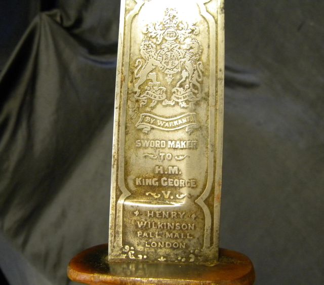

George V was on the throne from 1910 to 1936 so the Wilkinson sword must be post 1910.

Both swords are very typical for Ethiopia/Emperorīs times. They are in a very nice condition. The handle of shotel is of rhino horn. (Now you would not find it in Etrhiopia complete - only blades without handles or with some ugly wooden replacements. I looks like complete swords with rhino handles survived in the hands of collectors only ...)

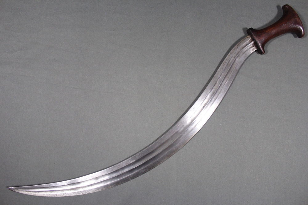

I believe that the term SHOTEL to which you refer to is not in fact the correct description to the subject sword (with the horn/rhino hilt). The correct term for this particular blade shape is in fact GURADE.
The term SHOTEL refers to the "double" curved blade also found on Ethiopian swords and shown in the pic attached.
As an aside, Wilkinson and various Solingen makers made and shipped many hundreds of sword blades to Ethiopia which would have been locally mounted. A large % of these bore various inscriptions in Amharic language as shown on the Wilkinson blade above.
Also attached is an early advertisment from Wilkinson for Ethiopian blades.

Actually I appear to have made compound errors here, and somehow I misread the correct period for George V.....who reigned as noted 1910-1936.,,so thank you Dave F.
As Stu has noted, Wilkinson Sword Co. had supply contracts to furnish blades to Abyssinia into the 1930s.Some of these, as well as those from Solingen earlier, were indeed the dramatically parabolic 'sickles' which were termed shotel. Burton (1884, p.163) described these with considerable disdain , and notes the blade tapering to a point, which "...can hardly be used". The commonly held lore is of course that these sickles were so curved so that the warrior could reach around the shield and stab the opponent.

As far as I know SHOTEL is not an Amharic word, rather it is from Tigrai and what is now Eritrea and it means BIG KNIFE. Amharic for sword is GORADE (actually spelled with the "O" and not the "U").

Well, my friends, I for one go a very simple rule when it comes to Abyssinian swords: shotel = sickle shaped; gorade = single edge curved sabre; se'f (saif) straight blade (including kaskara). This is accepted internationally by researchers and collectors. Then the unsolvable problem of the "Imperial Guards" swords. In Menelik II's times they were all over the place in terms of design and "European" origin. The most common one, and probably the "real" one, is the one with German blade with the inscription MENELIK and SAINT GEORGE. Locally made scabbard. In Haile' Selassie's times we start to see more identifiable pattern for which there is, at last, photographic evidence. THIN STRAIGHT blades with a peculiar inscription (LOVE YOUR COUNTRY - HONOR YOUR EMPEROR); lion head pommel with MULTI-BRANCHED guard and steel scabbard. Other patterns were used by the cavalry. Cheers.

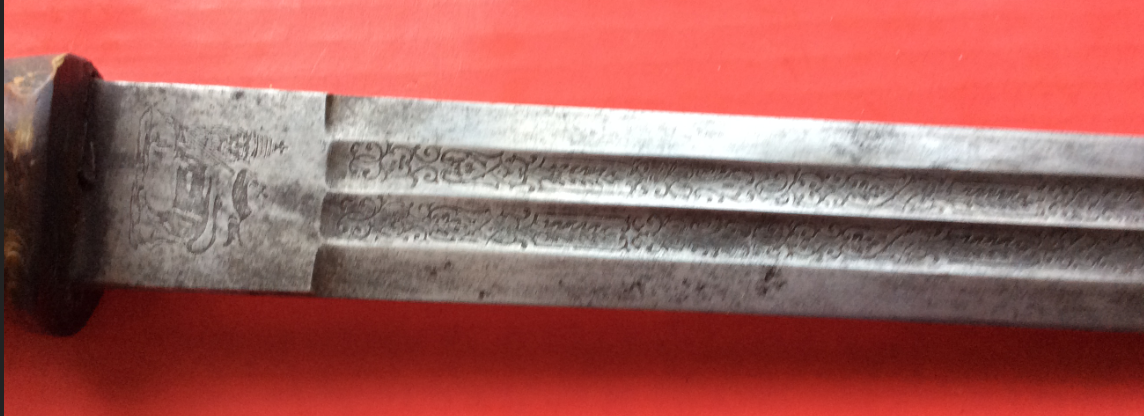

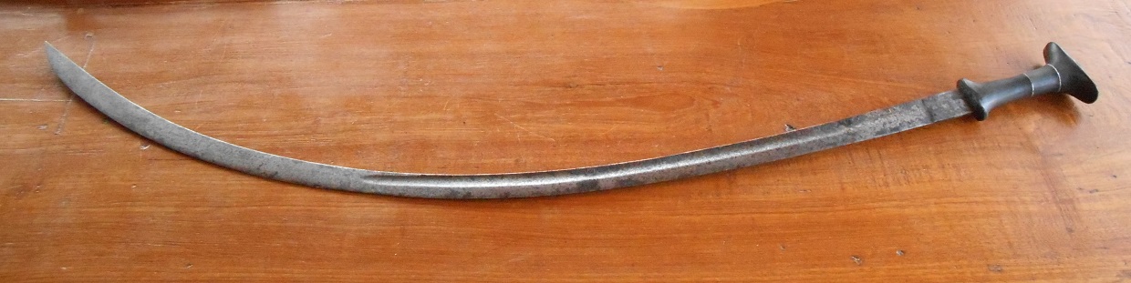

I have one who doesnt fit in the typology.
What should i do? Bin it??

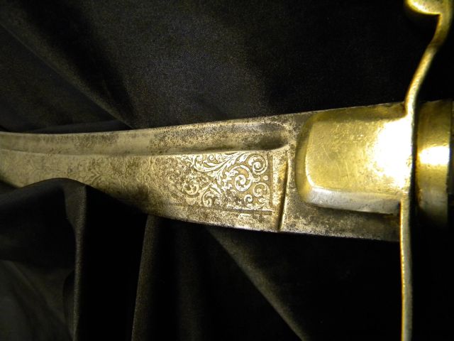

Can we have a close up picture of the ricasso? Is there a "star" stamp?
roanoa is offline   Reply With Quote
Old 4th April 2020, 08:45 AM   #23
No. I have the king on one side and the lion on the other.
It's the reason why i think it's a Solingen blade.

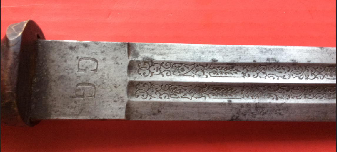

Here are mine. Both with original scabbards.
Neither are of my primary area of interest, so I might have missed important details.
If anyone needs additional pics, send me a PM and I post more pics here, for everyone to see. Same with questions. I just do not want to overload the topic with unnecessary entries.
Start with the one carrying German blade

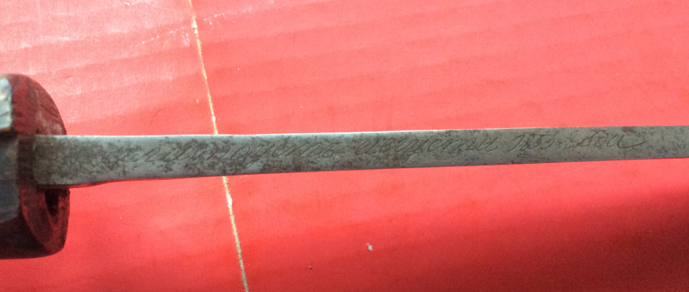

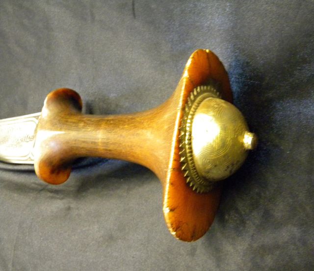

And now- with a Russian blade. Imperial Russia ( IR), as always, tried to align herself with faraway nations. Ethiopia was a Christian land surrounded by Islamic nations, a seemingly ideal target. Thus, at the end of the 19th century, IR sent surplus of good old blades there together with " volunteers" and " advisers" ( similar to today situation in Syria)
This blade carries an engraving on its spine " Zlatoust august 1853 year"
