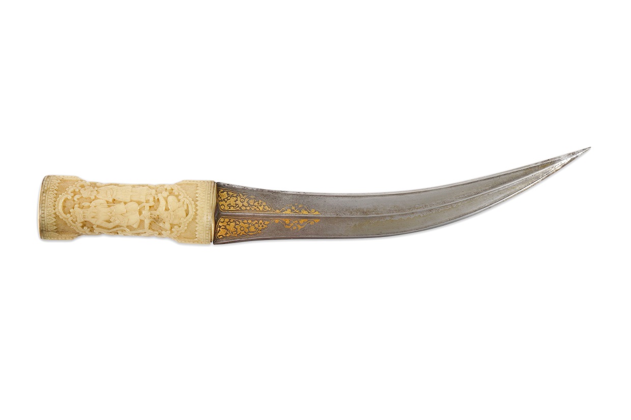

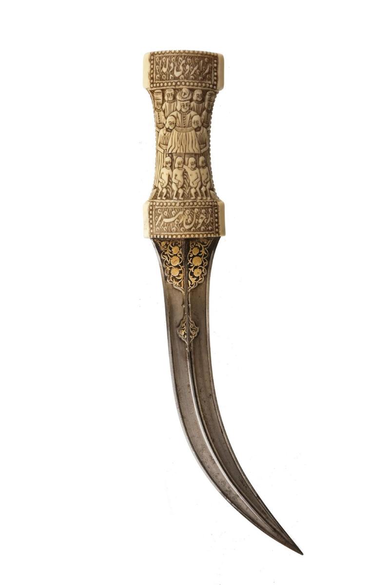

I have this large (52 cm; 20.1") Ottoman hancer. The blade is wootz and the hilt is walrus ivory.
I believe it to be Turkish but I would like to hear other oppinions.
I would also appreciate if somebody can help me with the translation. (do I see the year '295 - 1878?! )

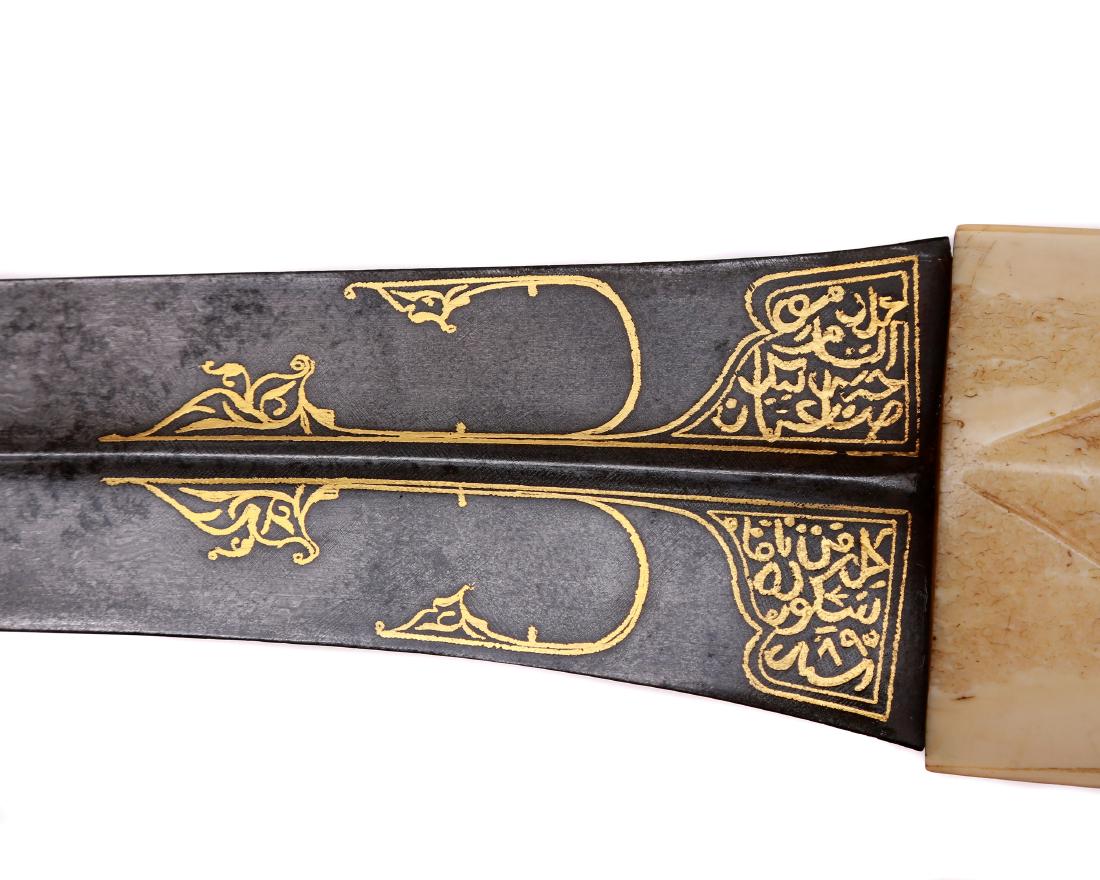

Very nice! It looks older then 1878 to me, I dont really see 295, more like 695 or 195
You're right! More like 695...
Thanks!

No I think you are right Marius 1295
For sure it's not 1195; plus the other number 1695 doesnt make any sense.

Yep, '295 makes sense, but the 2 is written wrongly. Here below are the Arabic numerals from 1 to 9 and 0.
١٢٣٤٥٦٧٨٩٠

I think it can only be [1]295 even if it doesn’t look like a 2
The upper cartouche reads
عمل دمشق الشام صاحبه عثمان بيك
"Work of Damascus, Syria. It’s owner is Osman Bey.”
The lower one with the year is an Arabic saying, I’ll see if I can work it out

About the date: I really don't know what you think reasonable or logical, but it clearly is 195 and not anything else. Whether this makes sense or not is beside the point.
For the date you have hundred of Ottoman dates where the 2 is inverted and looks like a 6. I think you have some on this forum...

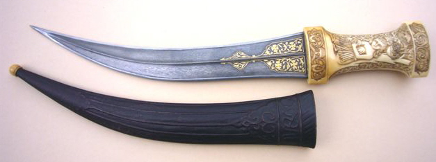

like the attribution to the so called ottoman "court daggers"... for example (that in Turkey are called Kama - see the fragment of a photo from the Istanbul Military Museum - pointing out clearly to their Persian/Caucasian origin).
Well court daggers with straigth blades were Bosnians, on your photo its an old Turkish dagger and the kama is a kind of kindjal if i'm not mistaken... So we are talking about 3 different things...
Nope! They were not!
They were Turkish, and inspired by the Persian/Caucasian Qama... which is the same weapon like the Kindjal
Qama called in Persia, Georgia, Turkey
Kindjal called in Daghestan, Azerbaidjan, Russia
Pretty much like Khanjar in Oman and Jambiya in Yemen... but essentially the same weapon.

As for the date, most of you think these daggers must be from the 19th century. Still, the blades do not look like Persian, they are made of high quality wootz, like the court daggers. Does anyone know centers of wootz production west of Persia? To me, the numbers could be (1)195 = 1781. Then it is what it looks like. Inverted 6 is possible if this is not a date, because (1)695 is still in the future.

It does not really look like a 1 or a 2, but it must be surely meant to be one or the other. I would go with whatever stylistically fits the piece best, but I can see already that that is contentious.
It’s likely to indeed be a date as the word underneath appears to be سنة meaning ‘year’

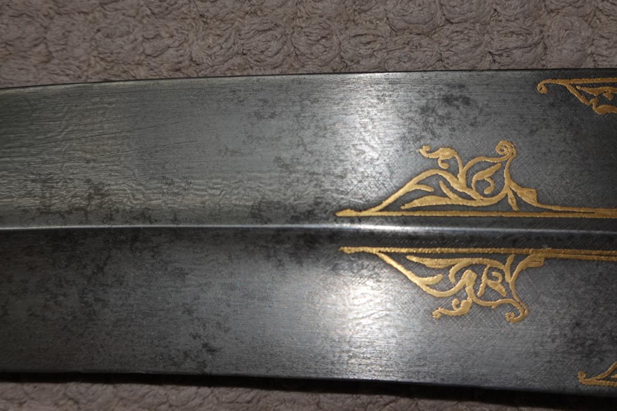

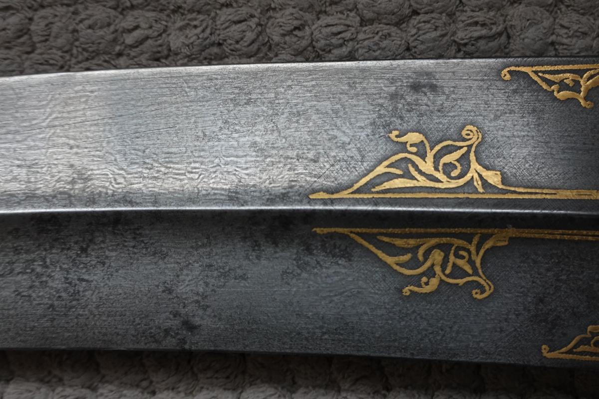

PS: The blade is of wootz Damascus steel but it needs some cleaning and re-etching.
The absence of documented evidence that wootz was produced West of Persia does not mean there weren't any. And even if wootz was not produced West of Persia, I am certain that Turkish and Arab smiths knew how to work wootz, whether it was produced locally or imported from Persia/India. And this blade is a clear example of this.

... "just want to cast doubt on some conventional notions that have little evidence in support and to demonstrate the problem of" Albanian identity.
Moreover, as you said, many of them are sporting nice wootz blades which are NOT known to be the work of any Albanian smiths as wootz production was pretty much restricted to India and Middle East...
... and, again as you said, they are NOT the high contrast Persian wootz, nor the finer patterned Indian Wootz but a lower contrast wootz of uncertain origin... that happens to be very common in some Turkish blades.
see another example of such lower contrast wootz at the link below
http://www.vikingsword.com/vb/showthread.php?t=25477
Now, how many examples of such daggers do we have with certain (not anecdotal) Albanian origin?!
And even if production of wootz has stopped in India in early 19th century, does it mean it stopped everywhere... at precisely the same time?!
Or the disappearance of wootz production stretched over more decades as old wootz ingots were still abundantly available, and there was a pretty large pool of old wootz blades that could be reworked.
PS: Even if they didn't know to produce new Valyrian steel anymore, they were still capable to rework old blades... right?!

Just because "most people think that this type of dagger is Albanian" does make it necessarily true?!
Also, stylistically they don't have almost anything Albanian or as a matter of fact from the Balkans...
(yet they have very much Persian influence in shape, decoration an script).
Yes Marius we are on the same page.
As I wrote "These daggers were very popular with Albanian mercenaries Bashi Bazouk. You can see many paintings and engravings with them carrying these daggers".
But I don't recall any book saying that these daggers are Albanians. I think it's a collectors / dealers thing only...
I disagree with you about the script and decorations, they are Turkish Ottoman.
Last but not least I have no idea about the blade, yes you are right it looks like a Persian blade with a central ridge but then what about jambiya are they also Persian?

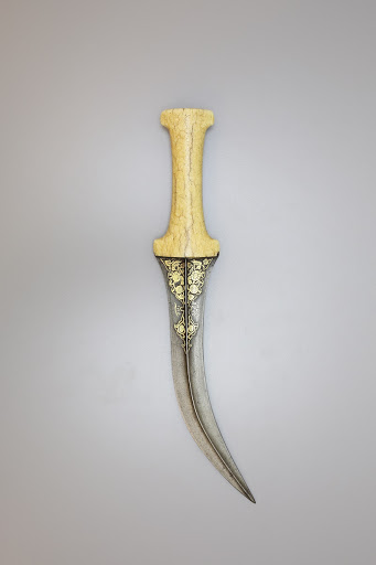

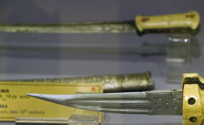

Old 17th March 2020, 09:48 PM   #28

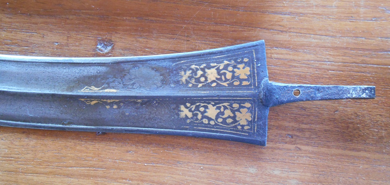

I have a blade like that but i don't think these blades are similar to your Syrian piece.
Old 18th March 2020, 01:59 AM   #29
mariusgmioc
mariusgmioc's Avatar
Location: Austria
Posts: 1,914
It depends how do you look at them.
They all have strongly curved blades with central rib.
They all have similar koftgari, in terms of geometry and style.
They all have similar I-shaped ivory hilts...
... so they are similar.
Mine is much larger and has a broader blade.
Mine has on one side some writing.
Mine has a hilt with some strangely oriented protrusions...
... so they are different.
Take your pick!

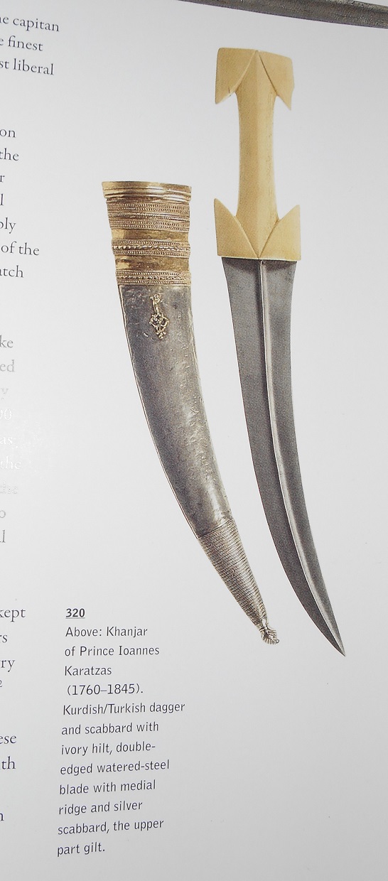

Old 18th March 2020, 10:40 AM   #30
In his book Elgood said Kurdish/Turkish dagger...
By the way, not all the weapons in his book are from the Balkans nor Greeks...
