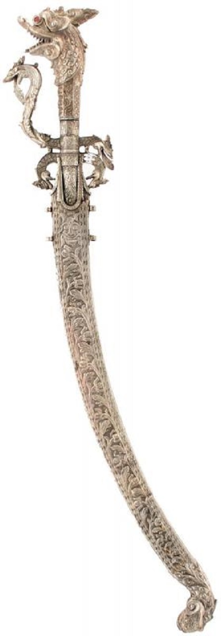

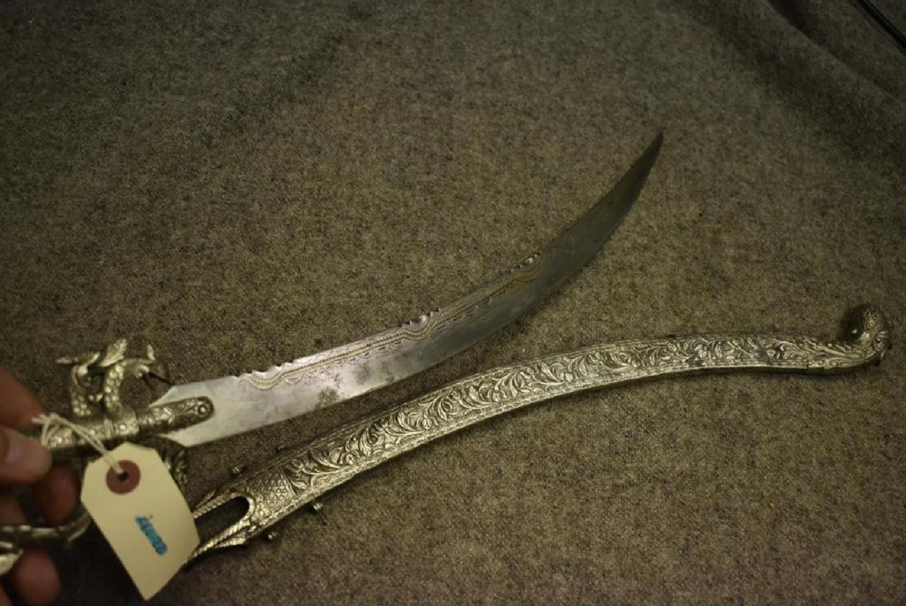

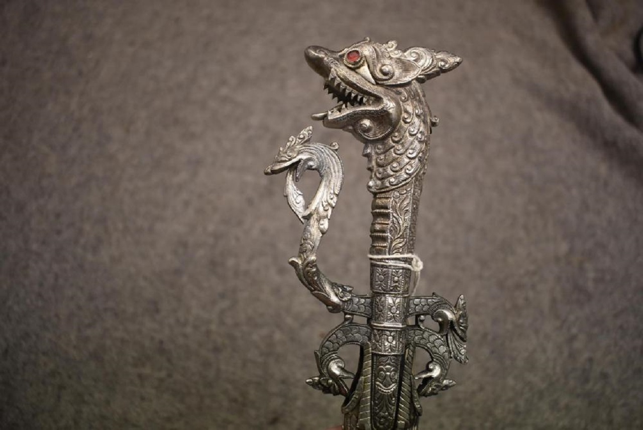

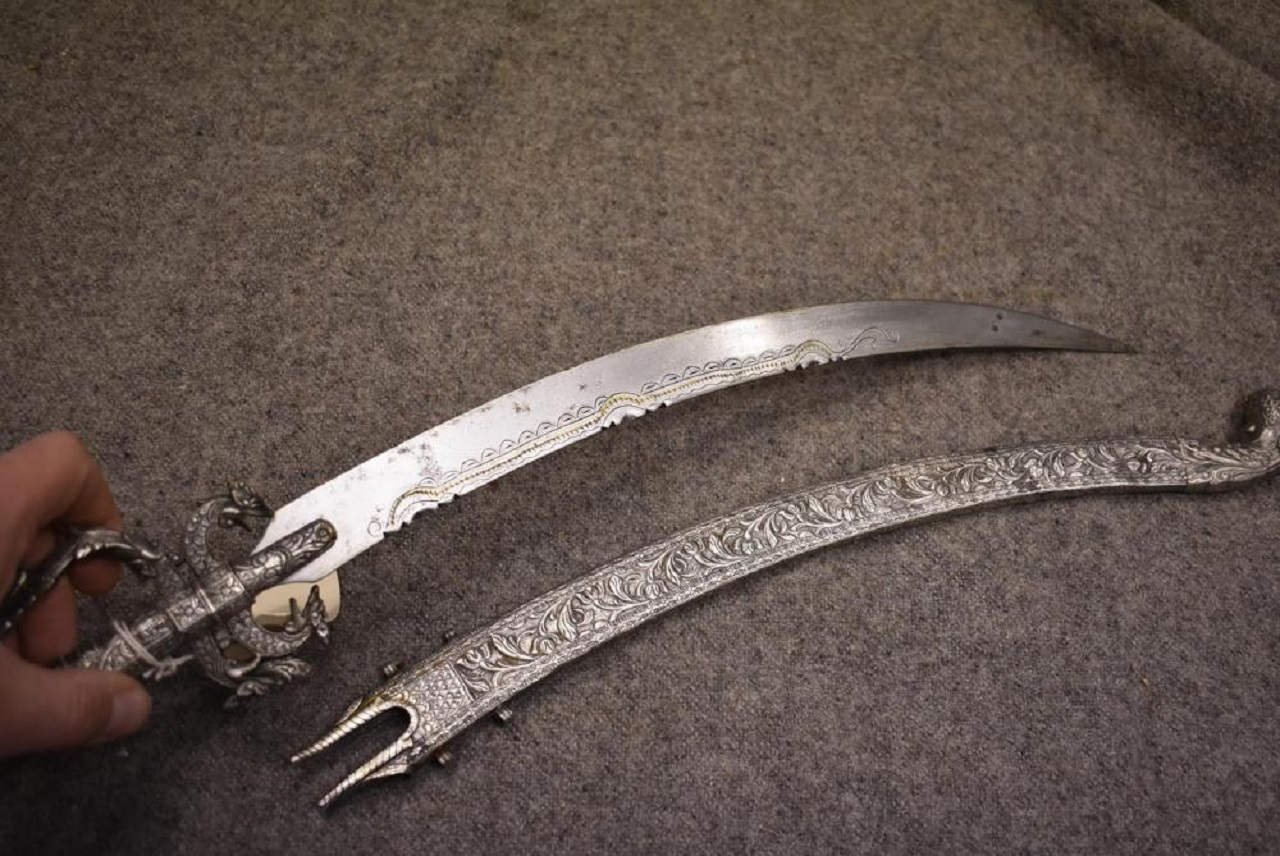

This Sinhalese Kastane sold at auction recently for a good price. It is not very old, late 19th or early 20th century. The interesting characteristic is that the blade is not the common local forged style with inlaid brass nor is it the older Dutch VOC imports often seen on early models. Rather the blade is a Berber North African flyssa style with geometric design and brass inlays. This type of blade was often seen on the "wedding" style nimchas or small ottoman influenced hilts with flyssa wooden sheaths sold at souks in Algiers in the early 20th century. This seems to be a strange marriage between sword and blade for the kastane. Possibly remounted at a later date?
(Note: I did not buy this item from auction)
Geoff

Here are some examples of the flyssa and "wedding" nimcha dagger blades similar to the kastane posted. Does anyone have ideas of how this North African blade could have made its way mounted onto a Sri Lankan kastane? Any other similar examples known?

Pay attention to the whole product: the tang did not go all the way into the handle. Crude job, but good enough to sell it to some naďf.
Geoff, I wouldn’t buy it either:-) Wise decision on your part.
Old 4th December 2019, 01:58 PM   #7
Originally Posted by ariel
Pay attention to the whole product: the tang did not go all the way into the handle. ....
Looks like it fits perfectly and was made for it, and othewr Kastane tangs look just like that. Doesn't look crude at all to me. This style seems more used on the later more fancy ceremonial ones like the OP's but not on the earlier ones meant for actual battle use.
