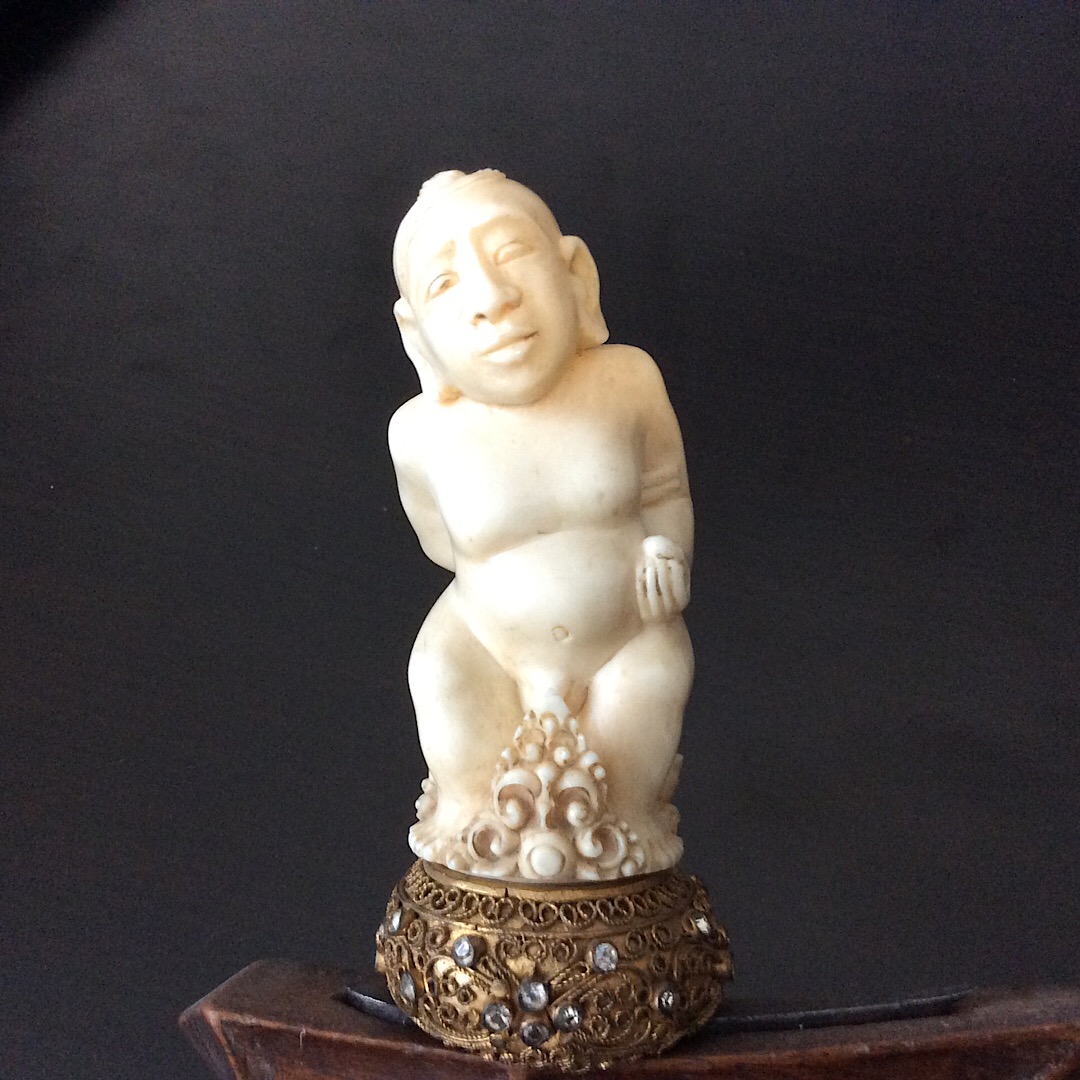

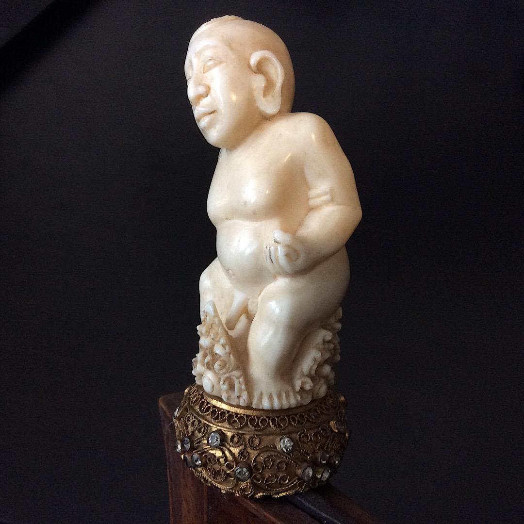

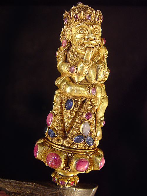

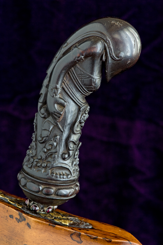

Here are a few examples of figural hilts that i believe display what can be taken as mudras and at least one that seems like a yoga pose (one leg up). Though it would be extremely helpful if Mickey would upload images of his own keris as well since they would be most specific to his line of questioning.

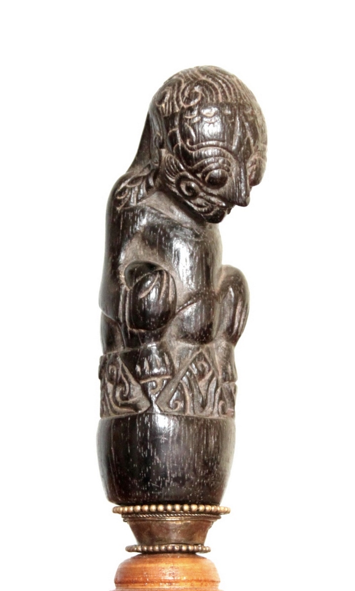

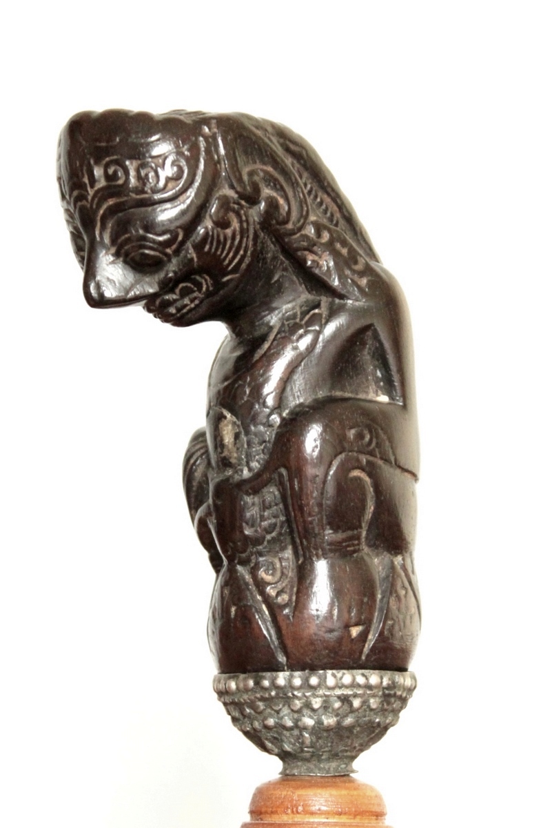

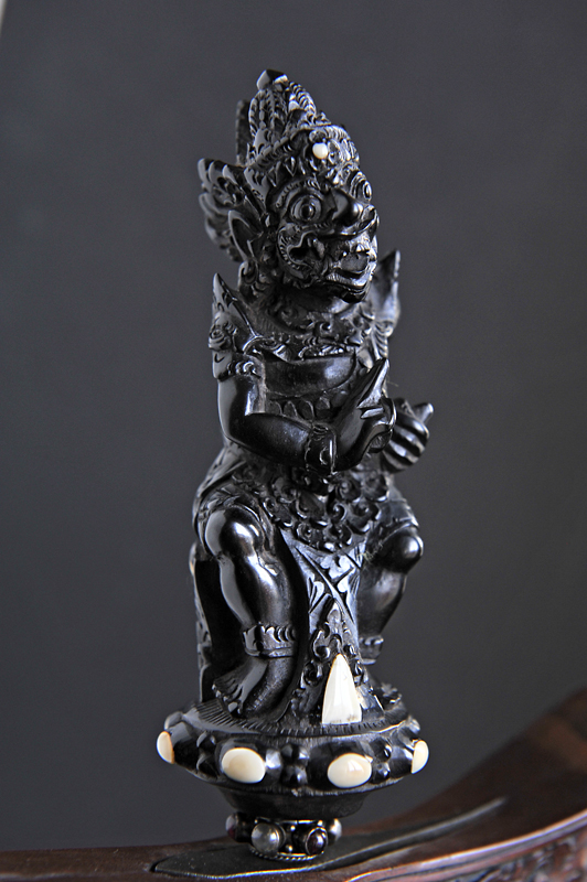

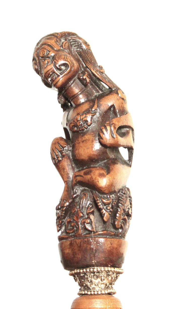

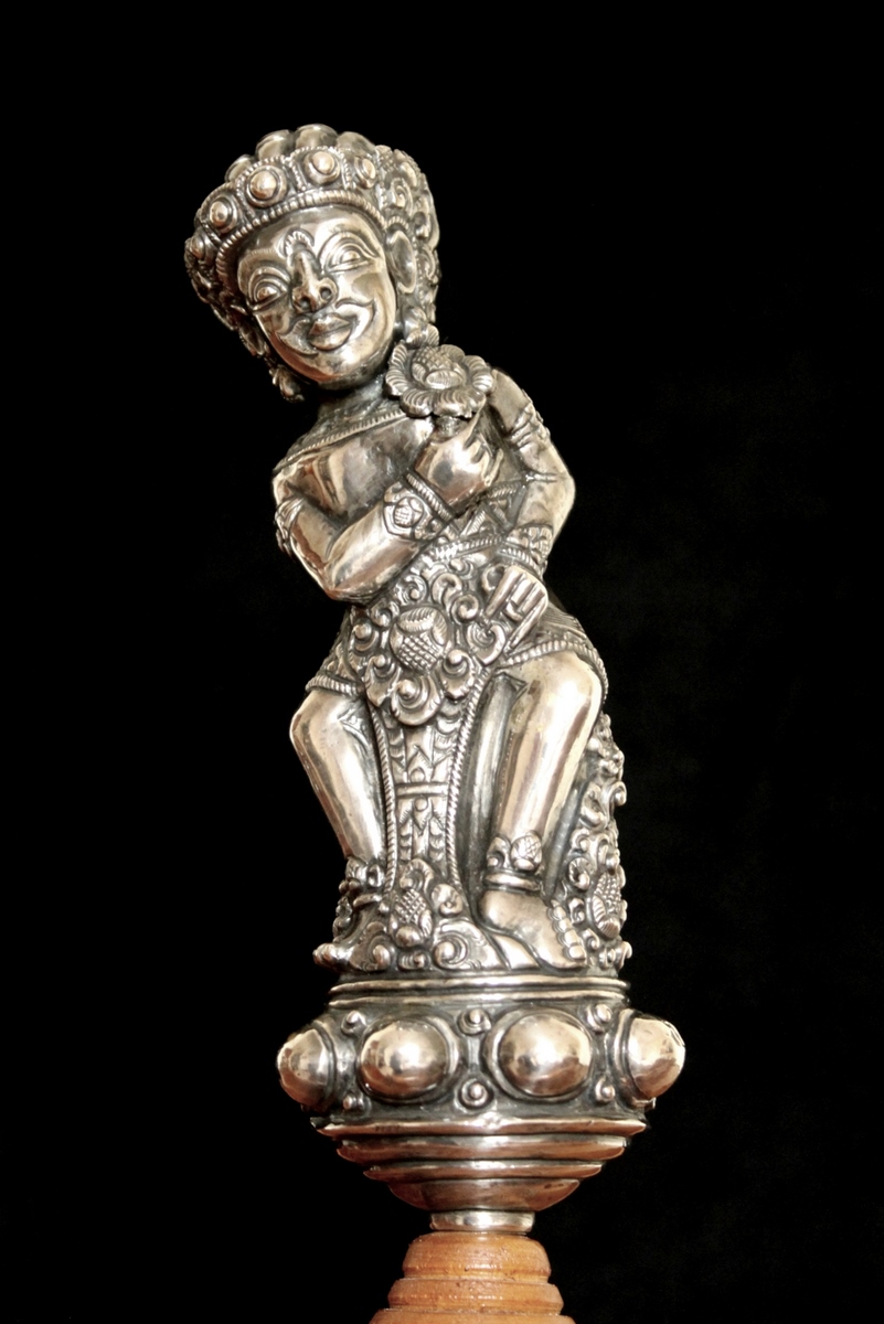

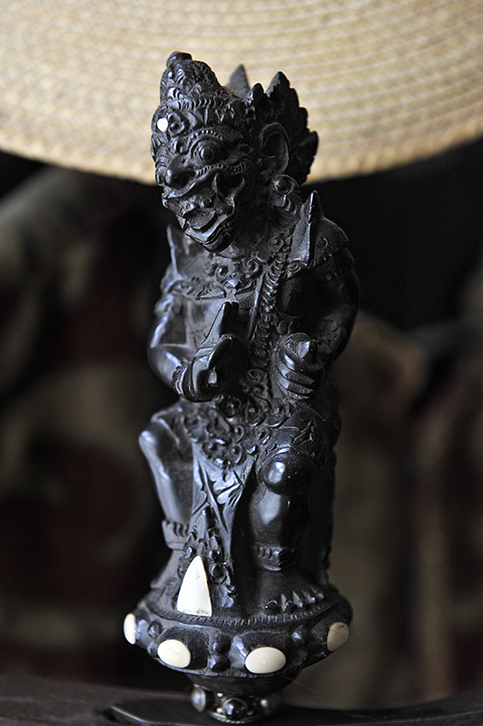

Hello Alan,
I was faced with this issue while writing my hilt book and the main author of reference who addresses the subject is Karsten Sejr Jensen in his 2 books: Den Indonesiske kris and the Krisdisc. He does not mention many mudras but several aksanas (figure positions?) related to the antique Javanese hilts, namely:
. Pralambapada position (the standard squatting position of the demon hilts from NW Java, which he extends to the standard position of the Balinese togogan hilts although it is slightly different). See the first 3 pics attached.
. Rajalilasana position which he extends to the Nawasari hilts from Bali, see 4th pic.
. Maharajalilasana or Lalitasana position with the left leg flexed, see 5th pic.
. Dvarapala position (temple guardian).
PS: Sorry, the order of my pics have been inverted on my screen as compared to the original?

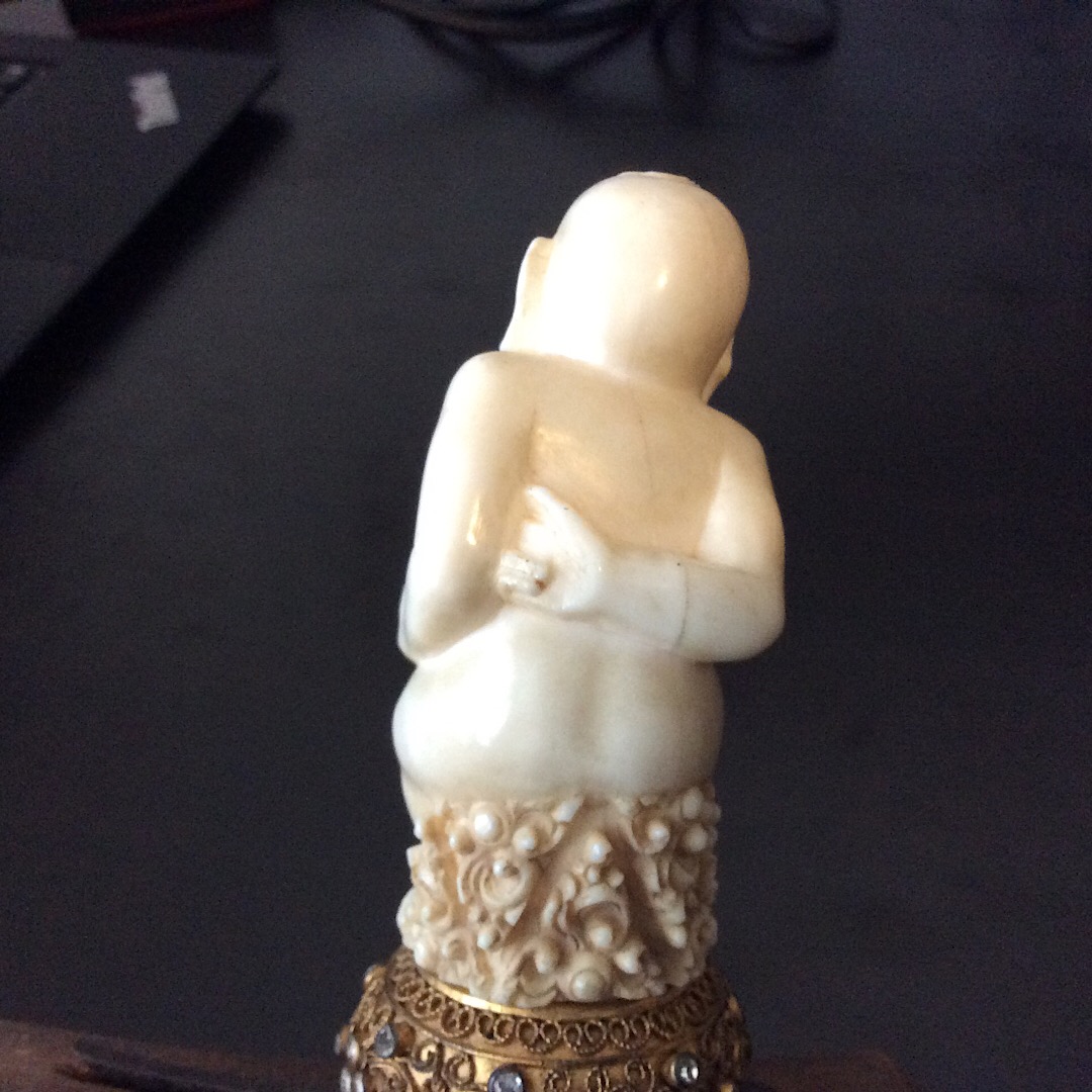

An additional reference for the picture gallery.
