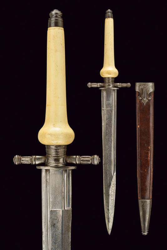

The auction house has described it as 17th century dagger, I personally doubt this age a little bit. What do you think? Or know! It's is 22,5 cm long.

Definitely not 17 century.
This is a 19th century dagger. I am also inclined to say it is Spanish but it is more a hunch than educated oppinion.

It could be French but the type of construction, materials and etching on the blade are somehow consistent with 19th century Toledo factory works.
Yet, it is of a rather classic shape that would be very difficult to precisely locate.
On second thoughts, noticing the small size of the dagger, this might be what is called "prostitute dagger." You may Google this term for images and will see some similar ones but also with disputable origins.

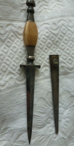

I am not an expert by naval dirks but can't them similar small? Look for example this beauty which get sold by ebay recently: https://www.ebay.com/itm/VINTAGE-GAR...p2047675.l2557 It's with 8,25" (approx. 21 cm) a little bit smaller as the dagger in question.
Hello Detlef,
The EBay description says "Garter" dagger/dirk. Garter meaning Strumpfband in German, so again pointing towards "prostitute dagger"...
Dirk is nothing but a longer straight dagger.

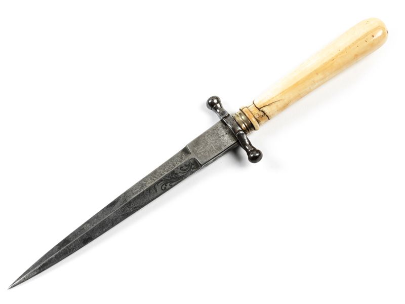

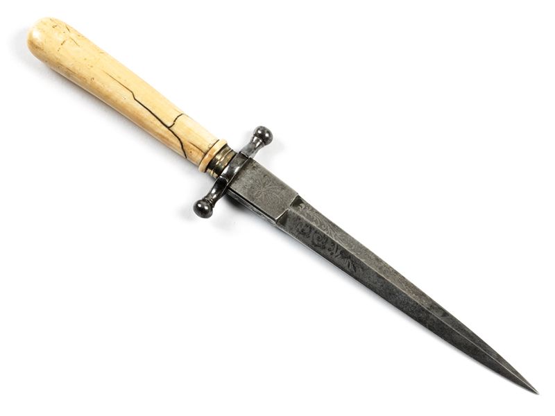

Gambler's dirk or prostitute dirk as carried in their garter. I'd say third quarter of the 19th century. I've handled an number of naval dress dirks, but this one strikes me more as a Western-type dagger (many of them were Sheffield-made and sent to the American SW. They fit in nicely with Old West collections). Note this old Cowens auction below. The quillons on the guards of these are typically spherical.
https://www.cowanauctions.com/lot/iv...led-dirk-52302
