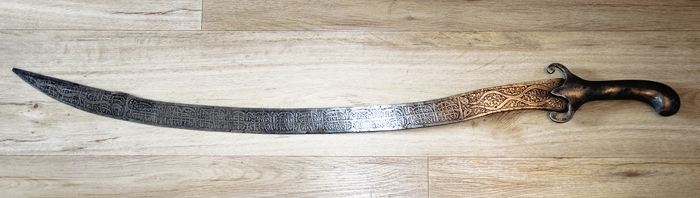

Default QAJAR "REVIVAL" SWORD for Comment

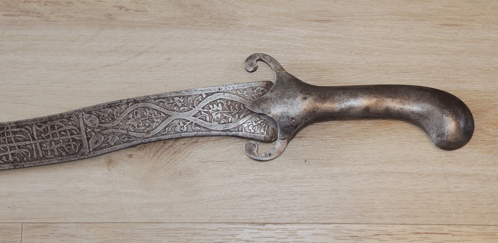

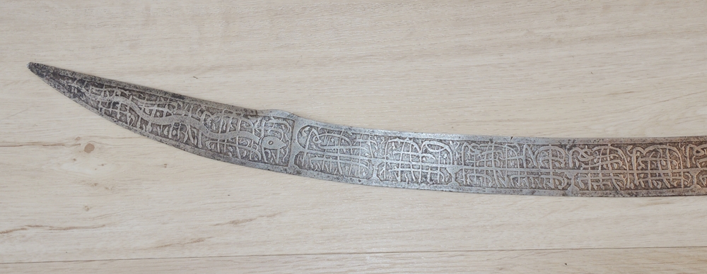

Another snip from a local auction. I believe that these are popularly referred to as Qajar "revival" swords, and date from 19th century sometime. The blade is heavily decorated, and is both flexible and sharp. I can see no reason why these would not be a useful weapon.
Perhaps one of our Members can be more informative regarding these swords.

It might be Indian as well, the hilt is not typical from these Persian swords.
Clearly very end of the 19th if not very early 20th c. 1880-1914

Unless YOU test the sword in similar conditions to those of real battle (or very close to those conditions) YOU cannot know if it is good or not. And when I say "YOU" I do not mean, you Jim, or you MForde, but "you" in general.
All steel has a deformation threshold from where elastic deformation stops and breakage or plastic deformation occurs, and for a steel of unknown composition this threshold can only be determined by testing.
So, the blade can look and feel strong and elastic and you can bend it 5 degrees without any bad effects. But, then if you bend it just one degree more, it breaks, or much more often, becomes permanently bent.
The Qajar revival blades were not thermally treated and were made of low carbon content steels, so are nothing but purely decorative weapons.
It is something completely different from battle ready blades that have decorations applied later.

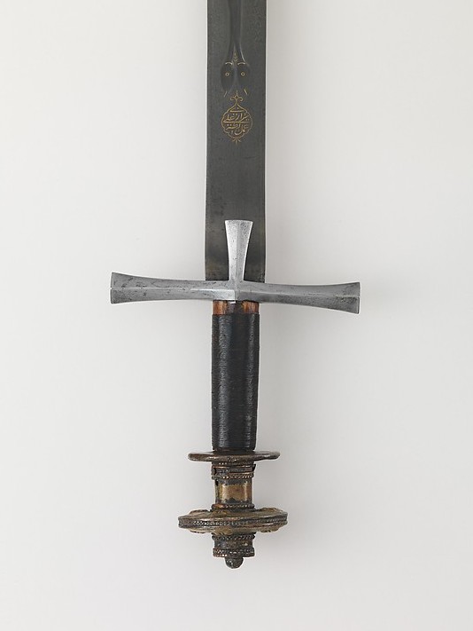

Look at this MET sword (I have one from the same maker with a revival hilt...)

some of these blades are signed by sword makers from the 19th c.
Well... nope! This is actually a confirmation that you have an older blade that was re-hilted.
Then...
1. How do you know the signature is of a 19 century swordsmith;
2. How do you know that the blade wasn't originally meant for business/battle;
3. How do you know that the signature wasn't added at the later date?!
There is a significant difference between early 19th century, when swords were still made and used in battle, and late 19th century when swords became more of a fashion item.
My two cents.
PS: I am not aware of any documented 19th century Persian swordsmiths that produced wootz. I would appreciate any information about this topic.

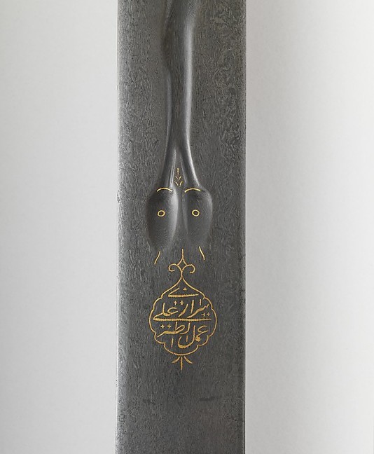

PPS: I do not have Rivkin's book but as soon as I got home from work I checked the Metropolitan book, and it seems the answers to my three questions are:
1. The signature is fake and is of an early 18th century swordsmith (Lotf Ali Shirazi)
2. The swod you posted is NOT a "revival" sword but a honest battle-ready weapon. The fact that yours has Qajar revival hilt does not make it a revival sword.
3. There is no evidence the other inscription saying "Nasir al-Din Shah Qajar" (ruled 1848-1896) was not added later on an older blade.
I already feel better!

Citing from "Arms and Armor from Iran," page 201, column 1, e
"The double-edged, straight swords with downward quillons were by no means a revival movement specific to the Qajar period. There are a number of Iranian straight swords from earlier periods kept in Russian museums as discussed earlier. Hence, the tradition of making double-edged, straight swords in Iran goes back to the Timurid and Safavid eras, meaning there was a coexistence of straight and curved swords during the Safavid era [...]"
Further down the lines Mr. Moshtagh discusses briefly the Qajar straight swords stating that even some with highly decorated blades were fully functional.
So it seems I was wrong twice
1. saying these swords are not mentioned in the book, and
2. in my previous assumption, as I underestimated the qualities of the decorated Qajar "revival" swords.

"Highly-decorated" was my expression. To avoid any further ambiguity, I am posting herewith a photo of the last of the two pages discussing these swords. Two pages out of about 750...
I have handled several of these swords but didn't keep any as I judged them to be purely touristy crap (exactly as described by Ariel, with flat blades like cut from sheet steel, with no - or very poorly shaped - cutting edge and fairly poorly executed etching).
So, in my uneducated oppinion (based on personal observation), many, if not most of the "Qajar revival" swords are purely decorative and probably don't even belong to the Qajar period but are much later (20th century).
I also believe the text in the book refers strictly to the genuine Qajar period straight swords and not to the vast majoity of touristy crap that invaded the markets in the 20th century.
